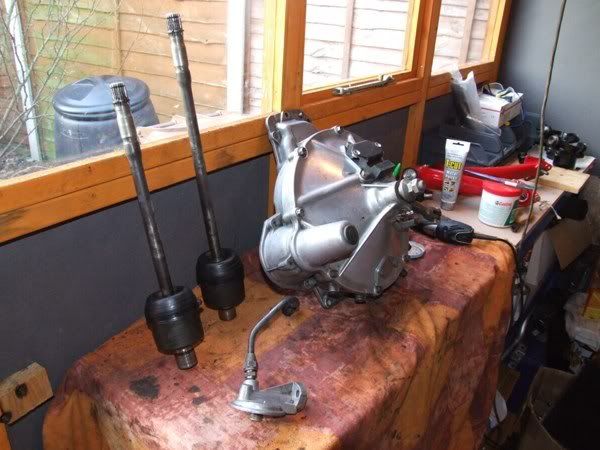

Driveshafts cleaned up, reunited with pot joint outers and fitted with new gators. The other bit of the clutch cover (or is it a flywheel housing?) cleaned up along with the oil filter housing and feed pipe.

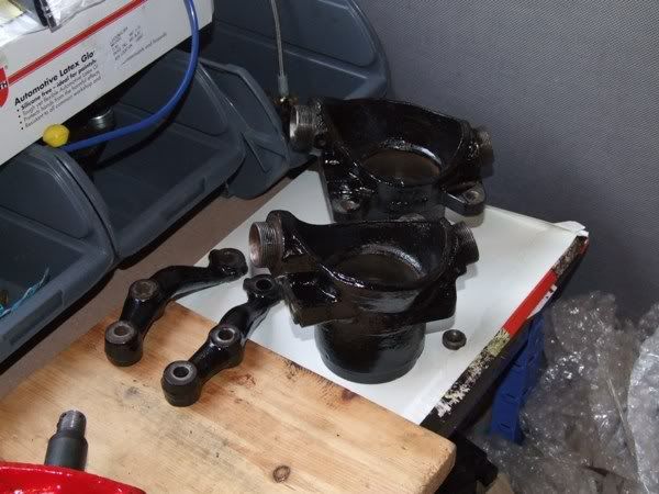

Disc hubs and top arms cleaned up and painted. New bearings due to land soon, ball joints are in a box somewhere along with the new CVs. . .

Hubs rebuilt with new Timkin bearings and ball joints. The ball joints were a right fag to do. I used all the old shims and all the new shims that came in the kits. It just worked out alright shim wise.

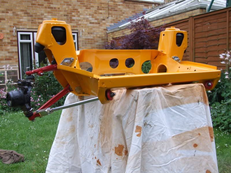

Update, update, update! Been a busy bee today . . . for a change:

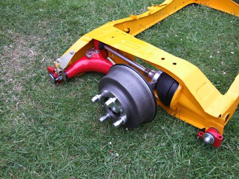

Hubs are just for show. They need modifing to fit the Fiesta brake calipers.

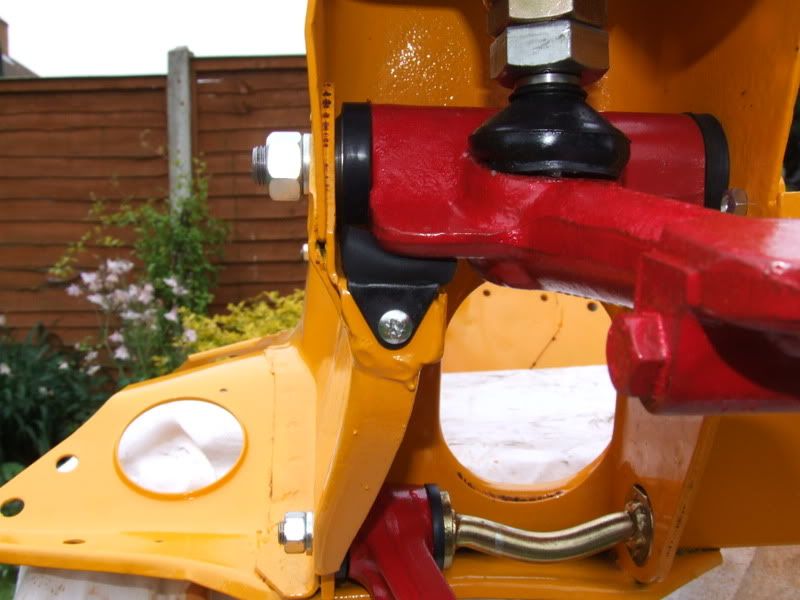

Hi-Los wound right in and no suspension travel available at all. At least I got an engine to weigh it down in the car.

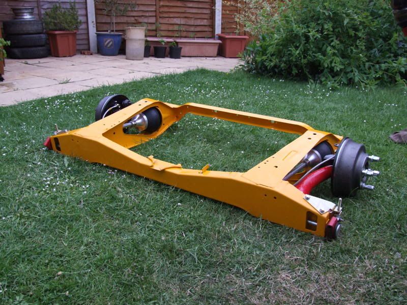

Rear sub in the same colour scheme.
Adjustable camber brackets, Hi-Los, spacer drums and SC handbrake quadrants. There is a anti-roll bar to fit on there as well but when I offered it up it was about 50mm short in width.
The rear drums were a nightmare. New wheel cylinders, drums and shoes and it was a right struggle to get the drum to turn once all fitted.
TOP TIP: Fit the front rubber cones before the top arms on the front subframe. Guess how I found that out. . . twice :D

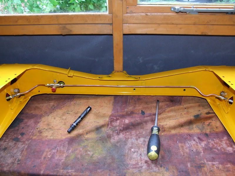

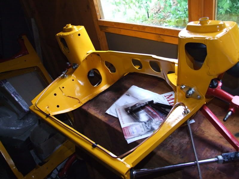

Today I did my least favourite job. . . brake lines. The longer ones always come curled up and it takes loads of faffing to straighten them out and in the past my sad attempts always looked messy. Anyway, four hours later I have nice looking shinny brake lines with ergonimic curves that match my thumbs/wrist/left knee/right elbow. . .
(the exploded diagrams in the back of that MOSS catalogue are so much better than the crappy pictures in the Haynes)
One of the rear drums was still locked solid so I took it apart, refitted some old shoes I had, and put it back together and it now spins freely. Wierd. Both set of shoes looked identical.
