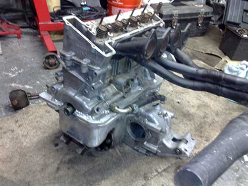

sorry to hear about the project, i have 2 sujestions that i have looked at that im sure will work, firstly a hilman imp engine on a mini gearbox, or a fiat punto head on an a series block.
just to temp you a bit more heres the imp block on a mini gearbox,
that engine was built for another car but it would be so quick and very retro, plus the carbs you can run on that aluminium monster thing there called stormberg carbs.
