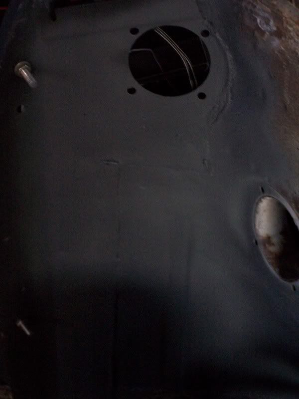

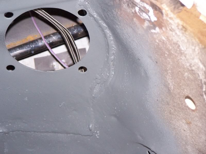

Okay back to the thread...oh I better upload my latest pickies...okay while photobucket takes them. I didn't update the thread last time because I forgot pictures and then it slipped from my mind. So last week, we took out the rear of the front n/s wheel arch and the scuttle. The scuttle support corners came off in two very different ways; the drivers side one I leant on missing the main scuttle (the wing was already removed) and it came off there in my hand as a nice lump of chicken wire and filler, the passengers side one was virtually gone already with the exception of the mounting points and cigarette paper thin metal, so off that went.
After the scuttle came out the wheel arch was cleaned up and welded in a bit of a rush, we also found that the metal beyond what you get with a filch panel under the scuttle wasn't worth its weight in scrap paper.
This week I remembered my camera, however forgot that I had remembered it until we'd already shifted it back into the unit so...

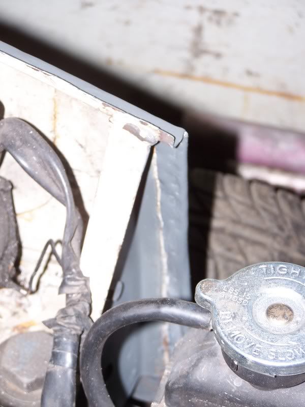

We pulled back the flitch panel we put on last week and gave it a healthy coat of primer, cleaned up the whole wheel arch and then gave it all a coat of primer, aswell as a few old welds as they'd been dripped on by the previous weeks weather thourgh a broker window and had developed a little bit of surface rust. We also had some fun re-remembering why you NEVER buy non-gen flich panels as we had to make a choice between the fresh air vent being in a weird place, or the door being mounted at a 20 degree offset between the top and bottoms, in the end we decided that it would be better without a gaping gap between the door and the sills.
Karl also tidied up where we'd cut the inner wing last time by folding it back around itself to the inside.

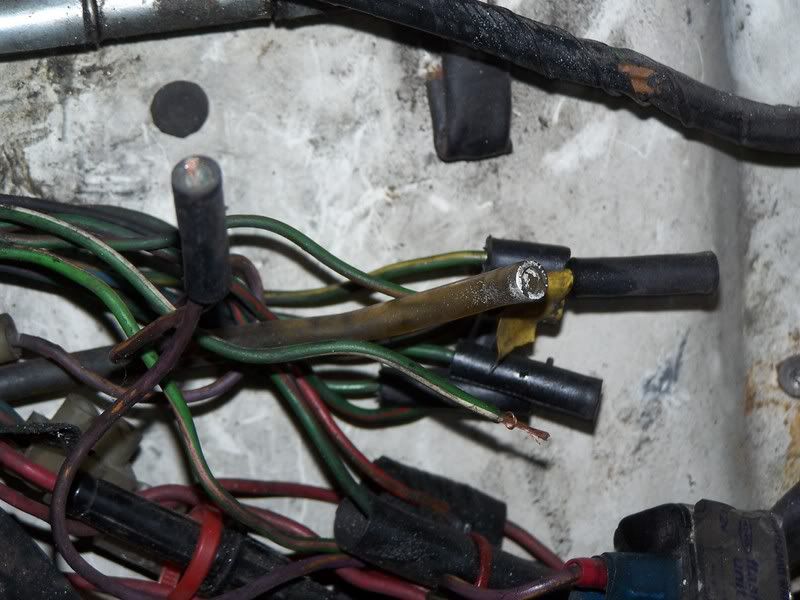

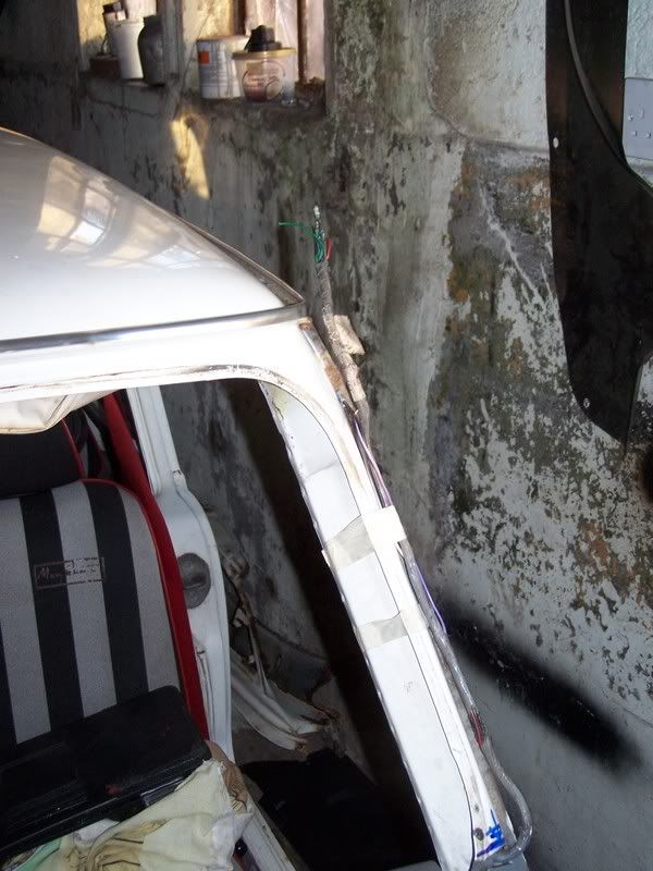

Karl also discovered much to his shock (I mean that litterally) that we had accidently nicked the rear wiring route when we chopped off the scuttle previously, thankfully we discovered this before it resulted in Karl having his hair permantently in the Einstien style and before the car decided to y'know...set fire to itself. so now I'm looking for a 9-wired molex to replace it, thinking maybe a couple of USB2.0 connectors from a computor, does anyone know if this would hold the volt/ampage that it used by the rear clusters? or does anyone have any other molex suggestions that would fit in the pillar?
After discovering that shocking (okay I'll stop with the puns) twist we disconnected the battery and were resigned to pushing and pulling the car in and out of the unit from now on >.< I'd wanted to keep it mobile for aslong as possible for obvious practicallity reasons.
