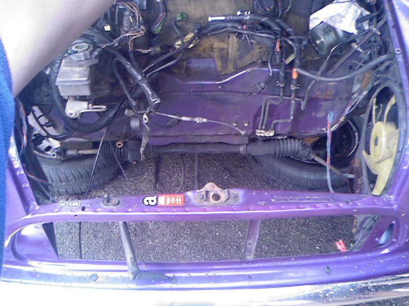

Well i got it out with the help of my dad, brother and mate on saturday morning, 2 1/2 hours and it was out all went to plan and thankls to COWBOY's advice i disconnected the brake line quickly and the biggest problem was seemingly an endless supply of electrical connectors to disconnect
then its gone pear shaped as after getting frame in the garage i have discovered that when the car was in a crash early this year and the previous owner took it to MINIMINE for subframe replacement, they although having charged for the frame have instead cut it bent it out and welded it up >:lol: :dontgetit: needless to say they are getting a visit from me this week with the trusty recepit in hand :lol:

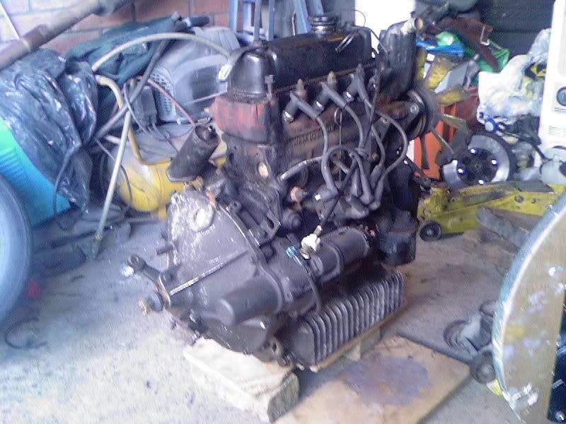

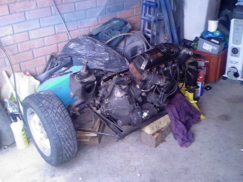

sitting in the garage as a complete unit
surprisingly it only took 2 1/2 hours but i will add at least an hour of this was getting rid of all the SPi gear which seems to have been chucked in wherever it will stay
next day feeling brave i got the engine out the frame myself :xxx:

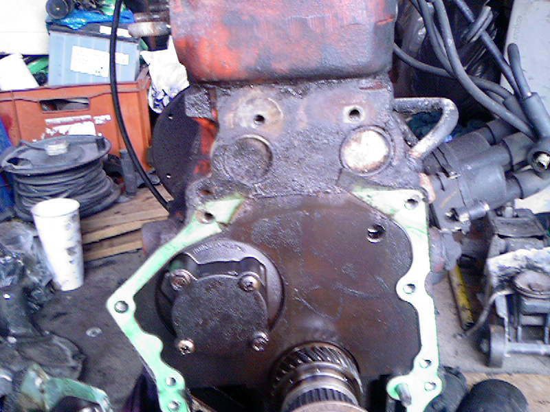

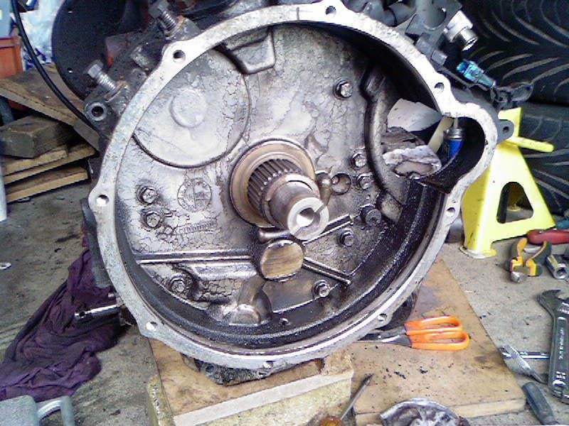

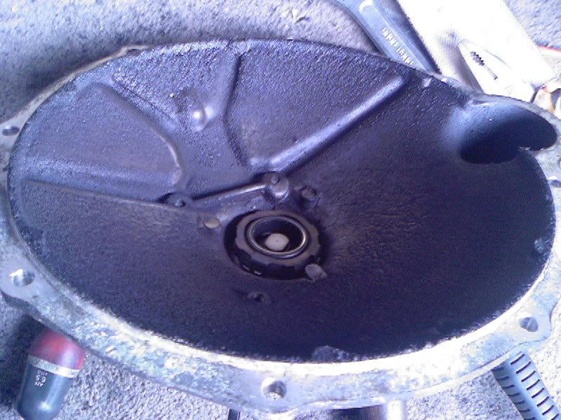

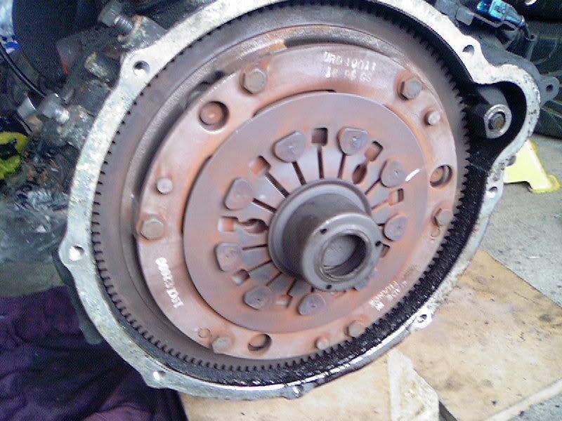

Clutch cover coated in oil so a seal has gone definately
Clutch and fly looking ok, started to get p's off as couldnt find anything wrong :xxx:

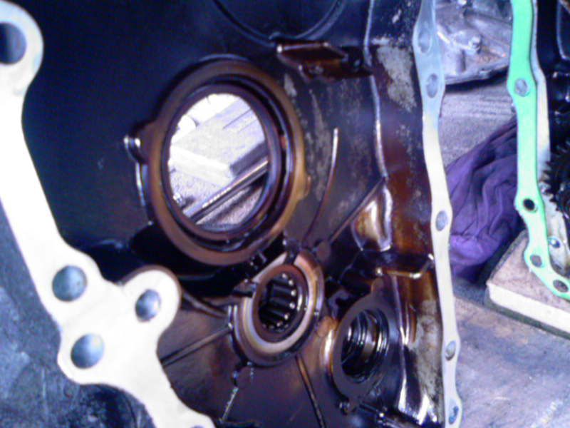

2 days later and with help of my mate i got the fly off but in the process he tripped over my spanner set, knocked over my set of alloys, knocked off a bumper and sent a set of centre caps flying, as can be seen though behind flywheel, again is coated in oil

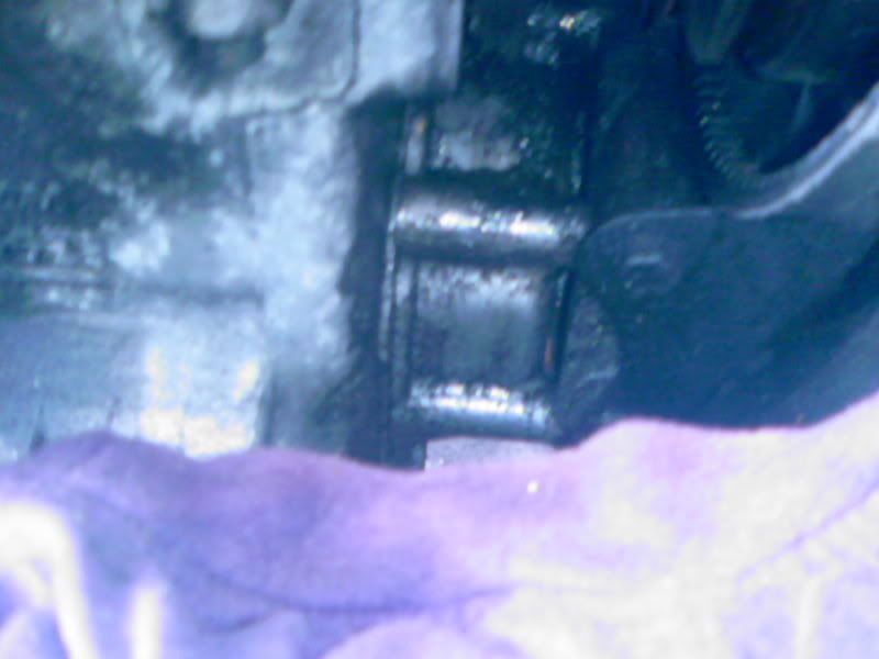

cover off and near the bottom on right hand side you will see a little groove, something i thought quite odd

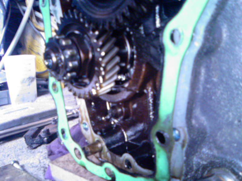

as can be clearly seen the transmission case gasket has blown through quite heavily

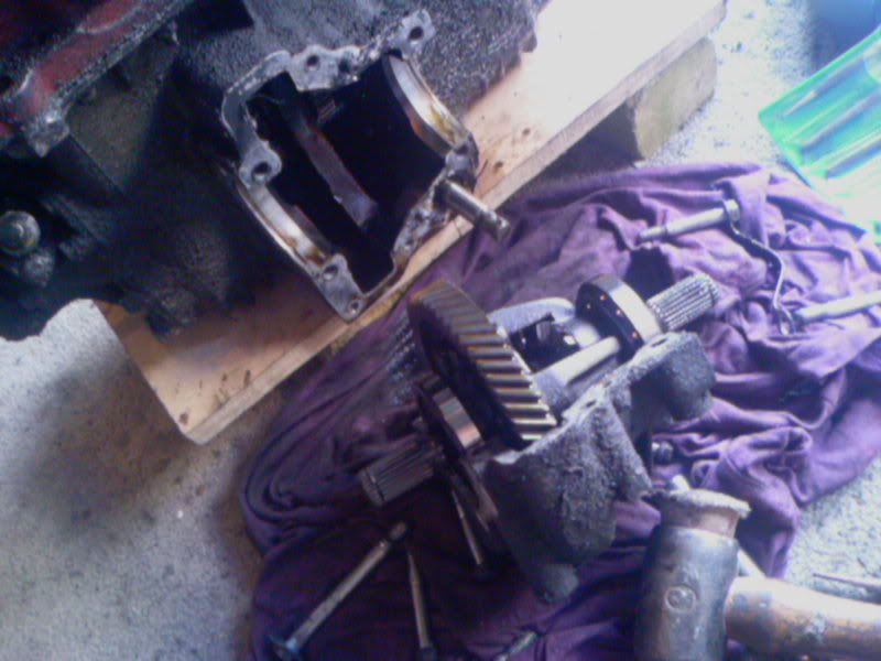

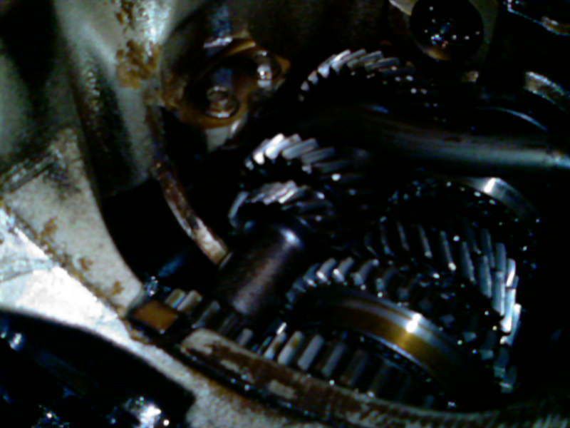

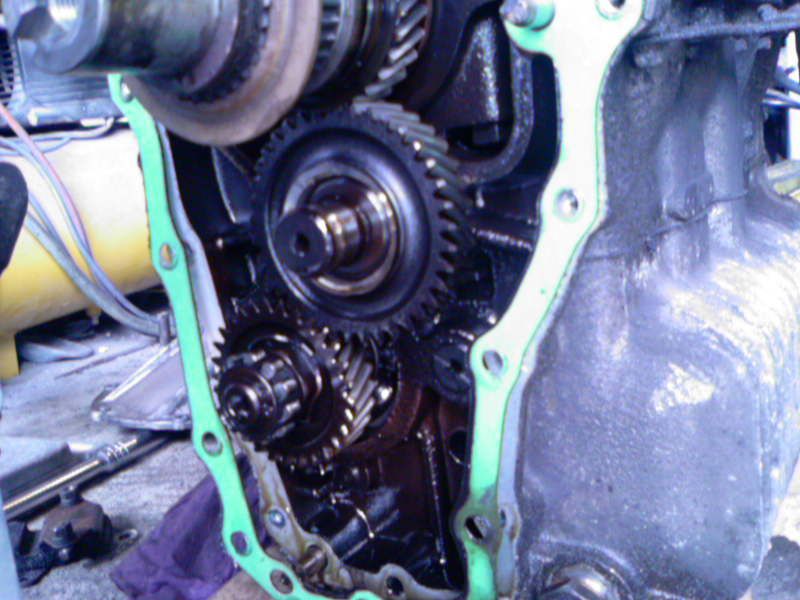

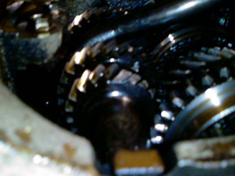

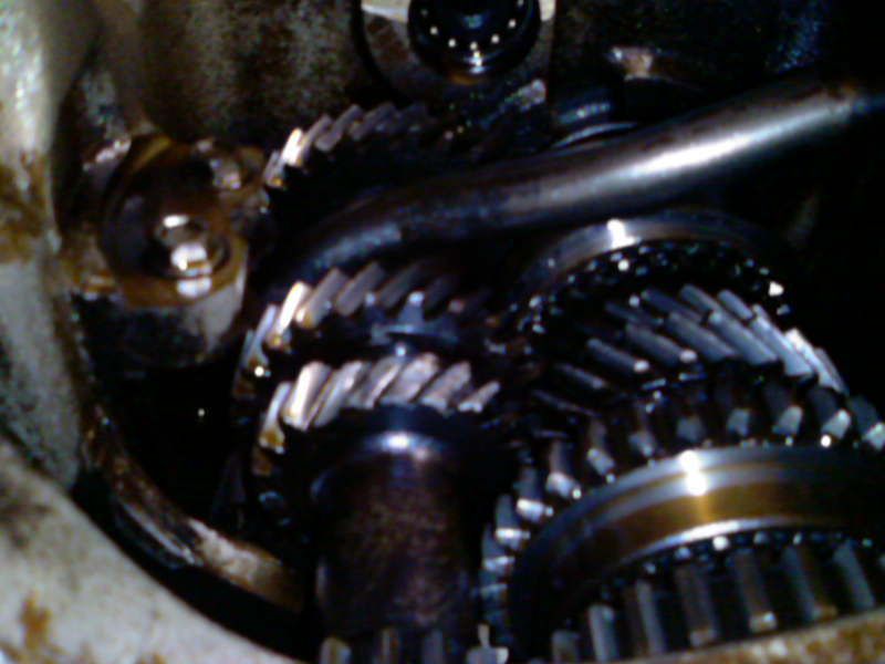

next night with gearbox finnaly lifted off with help of dad, as i found it surprisingly havey on my own, my dad noticed the problem immediately
4 and a half teeth have totally gone missing on the shaft on the left, quite odd i think as i dont rag the car, its never had any gearbox problems and gave no warning signs
anyone got a box for me? and do i need something specific?

#18 Guess-Works.com
Guess-Works.com
    Gearbox Guru
  • 19,838 posts
Posted 13 August 2007 - 06:53 AM
Nope, nothing special, just reconditioning...
#19 Sprocket
Sprocket
    Great on Injection faults
  • 7,266 posts
  • Location: Warrington
Posted 13 August 2007 - 08:39 PM
Check to see if the plastic cages of the two large main bearings are still intact and whether there is any slop in the frist motion shaft. Chances are thats whats killed it????
