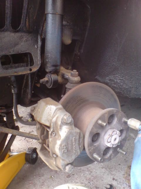

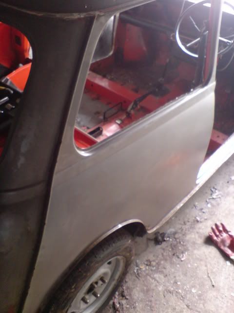

getting wheels off
some good looking brakes
we bought an mpi carpet that needs a good clean for our baby :dontgetit:
drivers rear panal is goooood!
thats just a quick update x

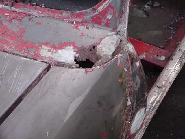

how do i fit this without replacing entire panel ??
x
#51 Retro_10s
Retro_10s
    Moderator
  • 10,139 posts
  • Location: Bromsgrove
Posted 25 September 2007 - 08:45 PM
You take the wing off, and fit a scuttle corner repair panel...
#52 mini93
mini93
    He's just too casual!
  • 8,615 posts
  • Location: Warwick
Posted 25 September 2007 - 08:49 PM
try keep wing intact, clubman pannels are expeeeensive!!! £300 for new steel front end.
is there anyway can be cut out then new repair corner jiggeried into place hmm

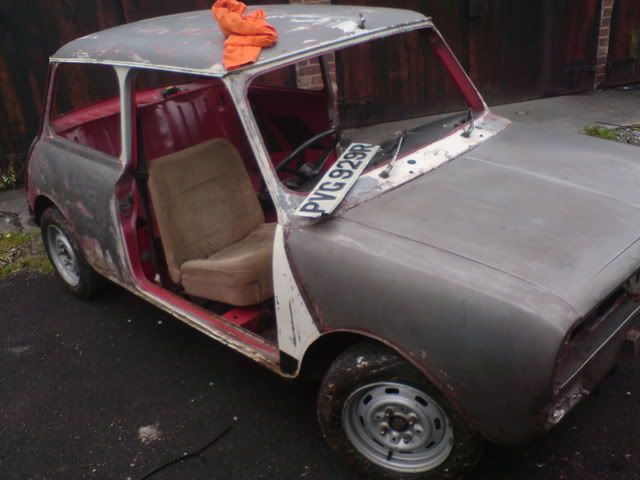

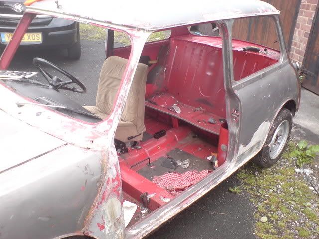

so this week to do:
finish getting the rest of the paint off
collect the doors
buy some new a panels & scuttle repair corners
buy a car cover
fit the doors
replace the a panels & scuttle corners
whack some primer on him
get him ready for the spray guys
need to clean out the garage, to allow us some space.
so its all going on.
i just wish the rain would stop!
gonna buy some bits & pieces during the process though. depends on what £££wage i get this month!
wish us luck!
:lol:
x

i know its a bit late now but a trick with the paint stripper is to scuff the paint, apply the paint stripper then put cling film over it. this seals the chemical in and is so much more effective. but it looks like you have done most of it
#56 sheree&the-gt
sheree&the-gt
  • 909 posts
  • Local Club: Leeds MOC
Posted 11 October 2007 - 03:43 PM
think i'm gonna buy some cling film tonight!!
roll it out, douse the bits left, cling film it, tidy the garage up, then take it off!!
thanks for the idea!
x
i hope so! don't really fancy taking the wing off!! but the a panel need to be replaced to, so we'll see!
x

Posted 22 October 2007 - 04:14 PM
UPDATE
found a few holes in the roof corners, wings are looking good :wacko:
thinking of a fibreglass bonnet & an innocenti bootlid - if i can get hold of one!

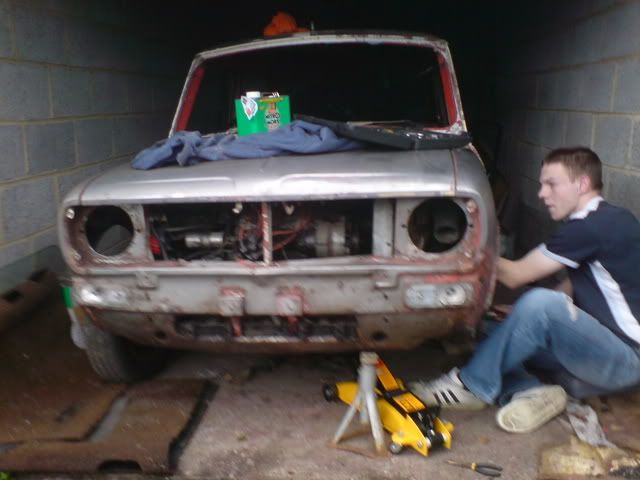

found a spray place & a nice bright red colour - gonna hire a generator & an engine hoist, get the engine out.
get it primered this week, buy all the parts needed to put through the respray ..... slowly getting there.
