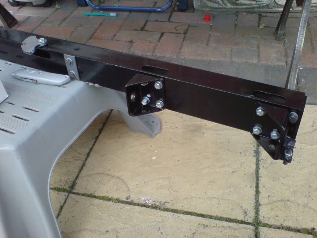

also order MORE panels well re-enforcement plates and sills so i had to get them (there goes going out at the weekend this week!)

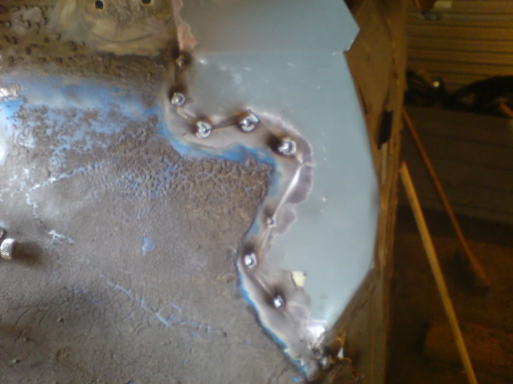

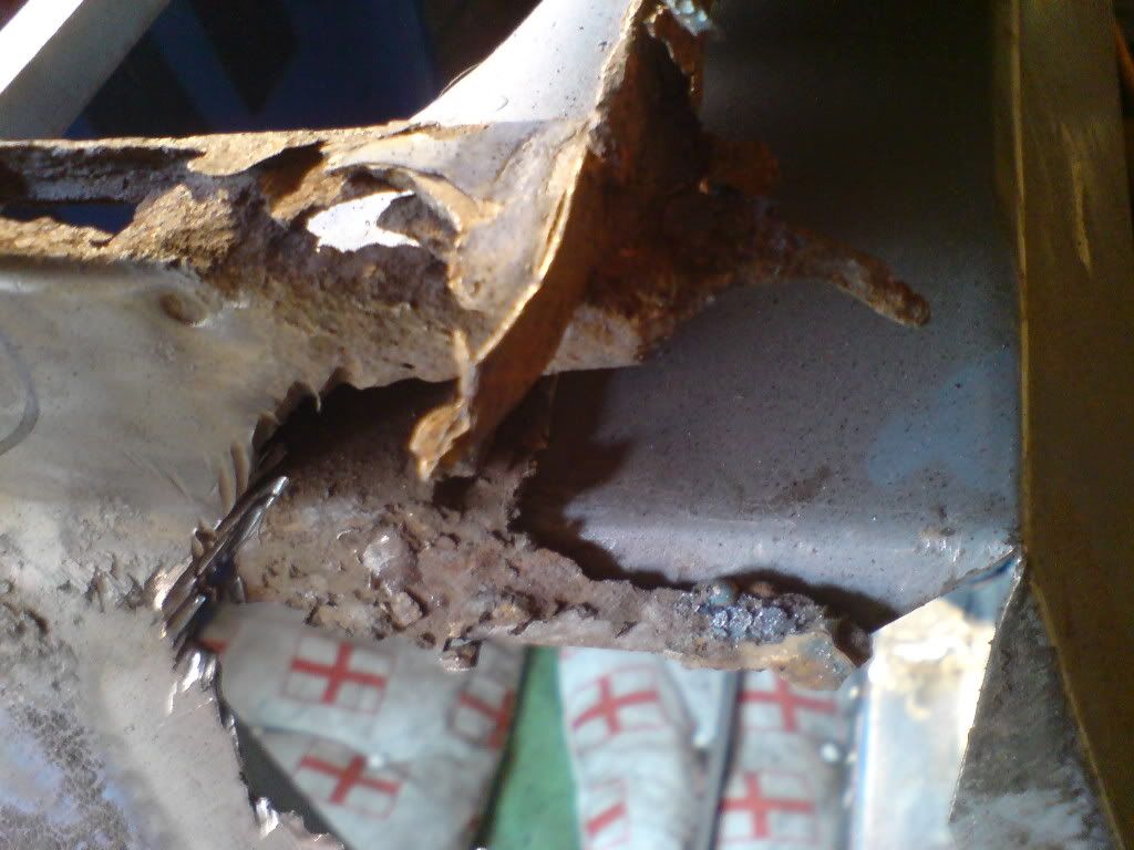

well moving along to the front now it's the passenger bulk head inside the wings seen as me panels wont arrive till later or tomorrow..... then they did arrive! lol
i may have to replace the door hinge mounts as they were rusty!! so more panels to order again! :)

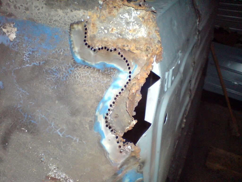

drill out an outline and cut the lot out easy :P
cactus i reminded myself to clean the metal :o it made the difference :P
tacked
i decided before i weld that piece in i cut my toe board out abit more as i could still see rust in-between the panels (you all get me :dontgetit:)
so a quick repair patch made up to go in its place
and tacked in

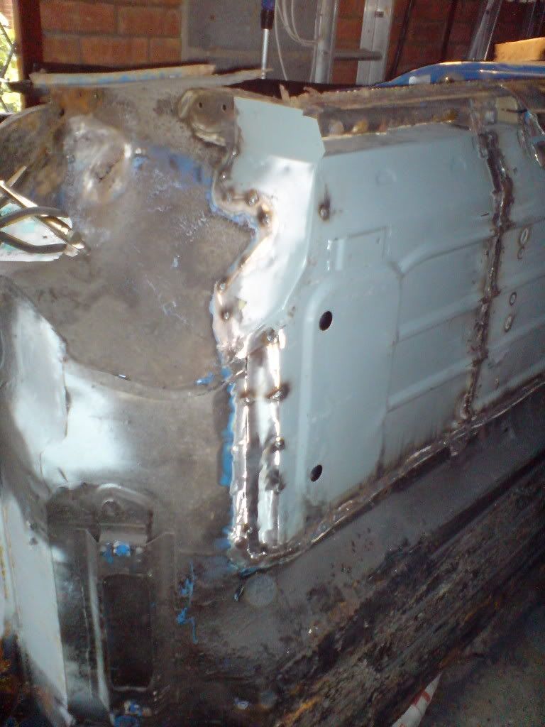

all going well so far ready to weld the lot in

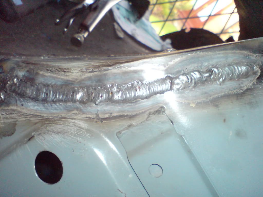

first weld of the day and it's my best yet on the car!! buzzing!!
TWO panels on the car today best yet :ermm: and best weld day ive had yet (i admit there was a few blown holes but were easy to repair :P )

I got a cheap auto-darkening one off ebay, but it doesn't turn on when i weld :turtle: Infact the only time i've gotten it to turn on and stay on is to hold it half an inch away from the tube lights in kitchens. Either its my welder not being bright enough or the mask can't sense dimmer things. Shame really as it'd be damn useful.
Ontopic: Looking great! You're progressing with it pretty quick there, nice clean looking welds too :-

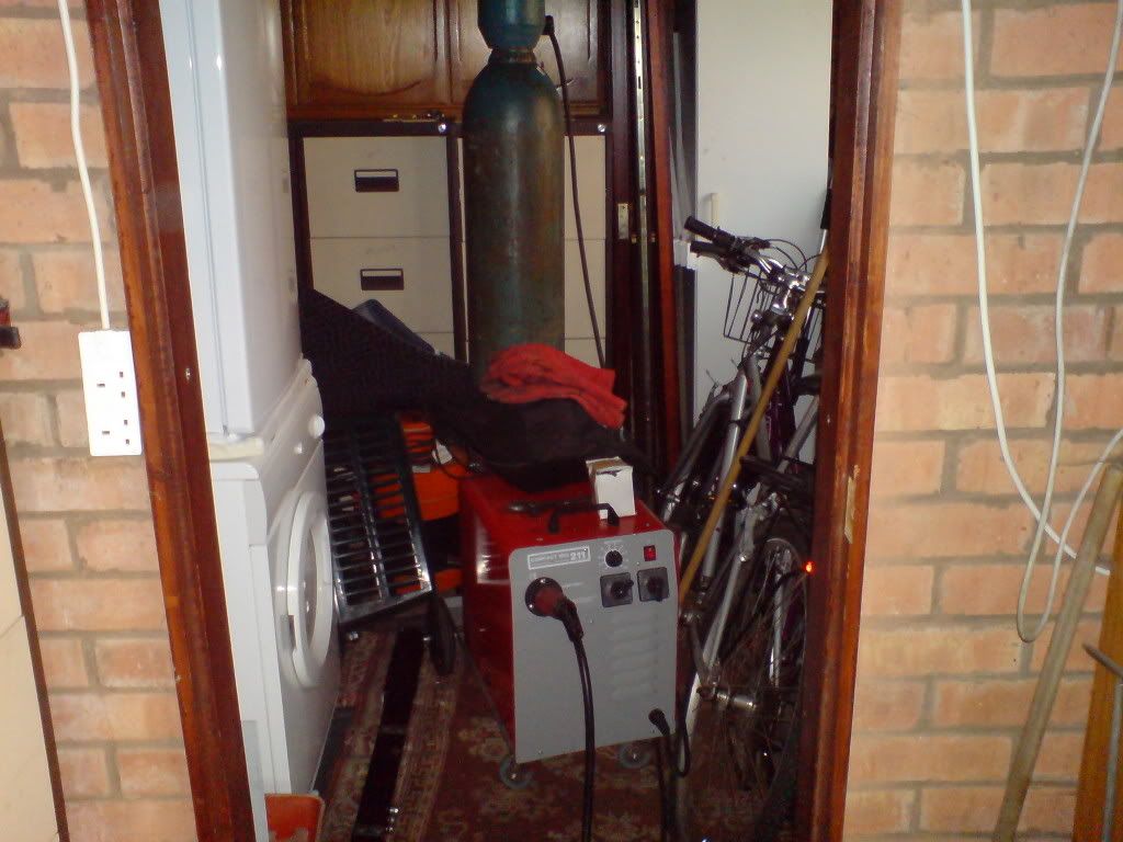

i've got my mates welder which is for industrial/garage type business and can go from a stable low 30amps to 200amps i believe dont quote me on that but its around them figures.
it cost him alot of money i know that for sure!! anyway he picked up some free gas from him uncle but he gave us pure argon :) we wanted argon/co2 but hey its free and can't complain!

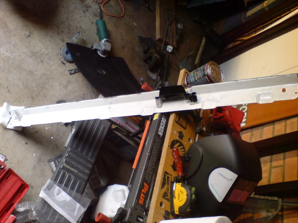

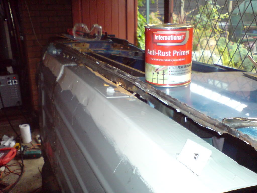

anti rust on to the floor so protection is added when the inner oversill will go on

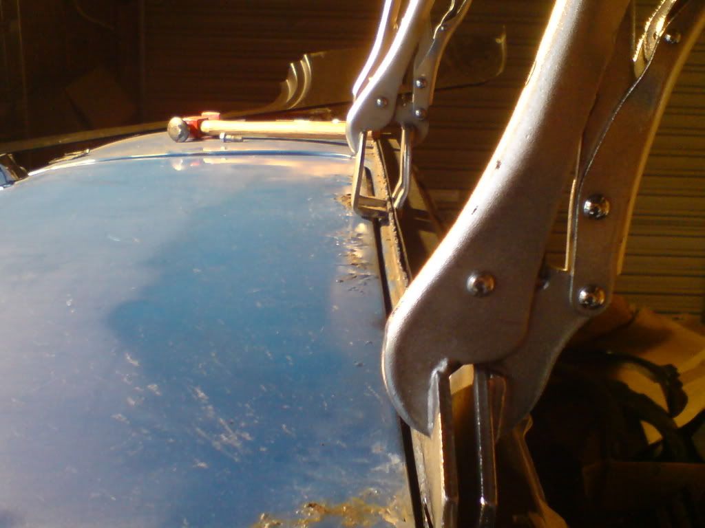

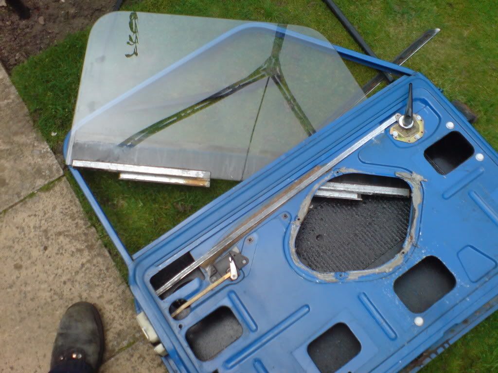

sill clamped (also go the door back in)

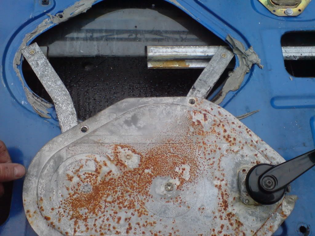

easiest way to get the front windows out

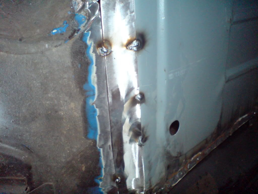

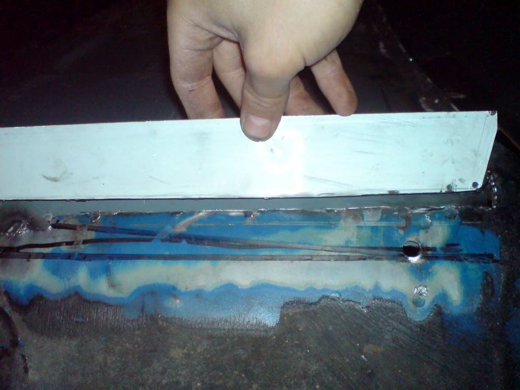

ok so before i put the inner oversill on (i think its called that lol) i wanted it to last
***********PROBLEM! AAAAAAAAAAAAHHHHHHHHHHH***********
How do i close this gap?? is it going to be what i think it might be just tack weld it down and hammer it flush on the floor :unsure: it would look a right mess (even though it will be under the outer oversill)
grimmy here's the welder i am using :lol:

Looking good so far mate, keep up the good work :dontgetit: I closed that gap by hammering it closed personally, but wouldn't recommend it if you can avoid it- wasn't happy with the result!

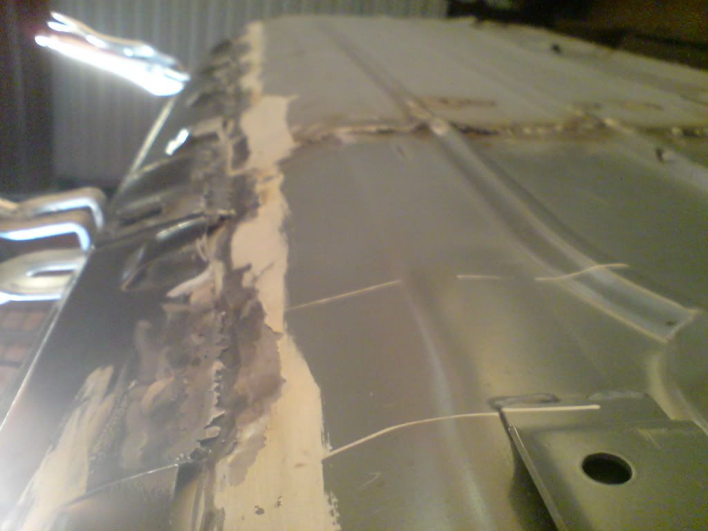

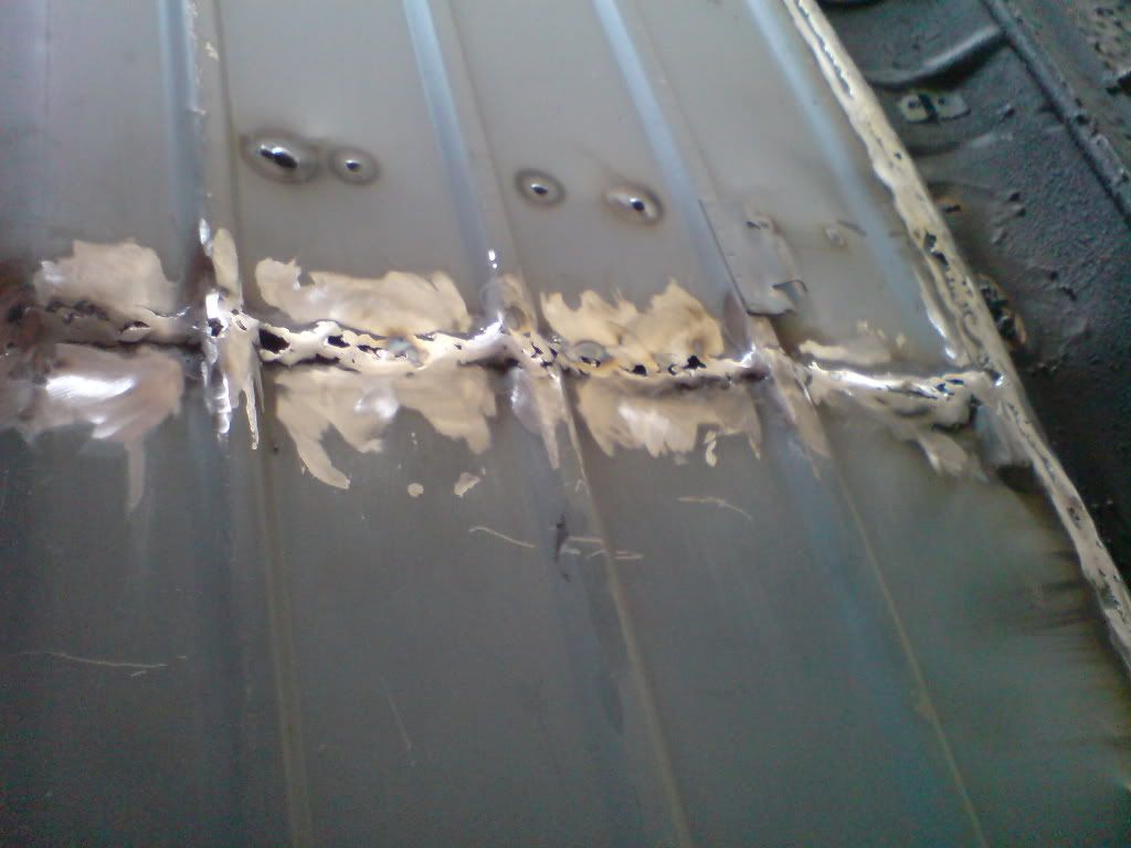

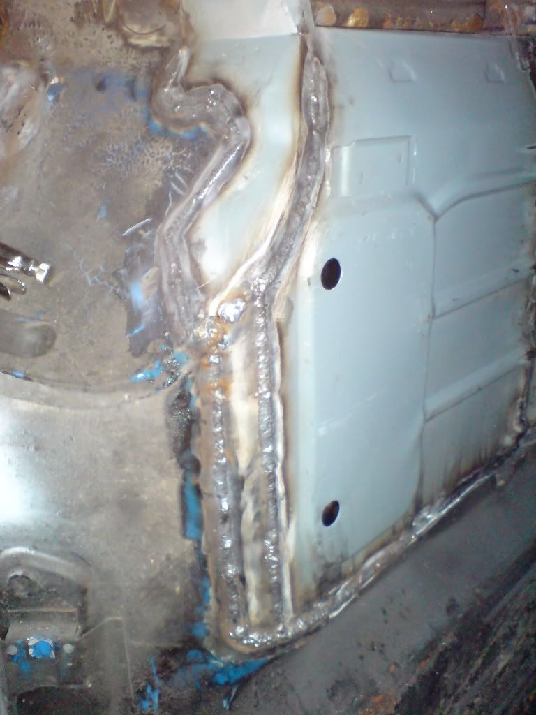

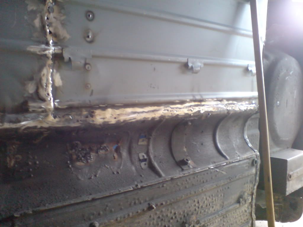

doesn't seem much was done but i've finally found out what costs rebuilds so much! it materials, i wore one flap disc out already and the second has had a hammering!
anyway these are the results of just grinding them welds down
needs more attention but i think neighbours wouldn't be happy with the grinder constantly going for more than 3 hours....
little by little she's getting there and now i'm back in the mood to working on her :ph34r: found my balance, few hours at a time.
Pitcrew cheers for the message, i'm using 20 gauge sheet of metal but the floors are repair panels from somerford mini (NOT THE BEST INVESTMENT I DID, going to buy a complete full length drivers side genuine panel.) it's all guess work lining panels up (mostly beating and cutting alittle back to fit, takes alot of time!) love your mini in ya avatar nice colour! :(

Hi..!!..Dave your doing a grand job with your mini, try turning down the ampage on your welder and turn up wire feed and more gas, as gas helps keep metal cool and stops you burning holes ,try it out, good luck.......... :P

how would someone aquire a bottle that big!

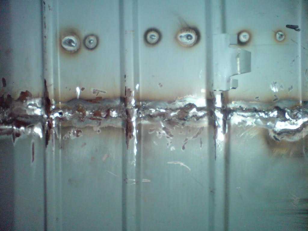

trying to tidy the welds up more.... thinking of ripping the whole floor out and redoing the lot with a full length genuine panel then i think i might aswell cut the whole lot out and buy a full floor........ we'll see

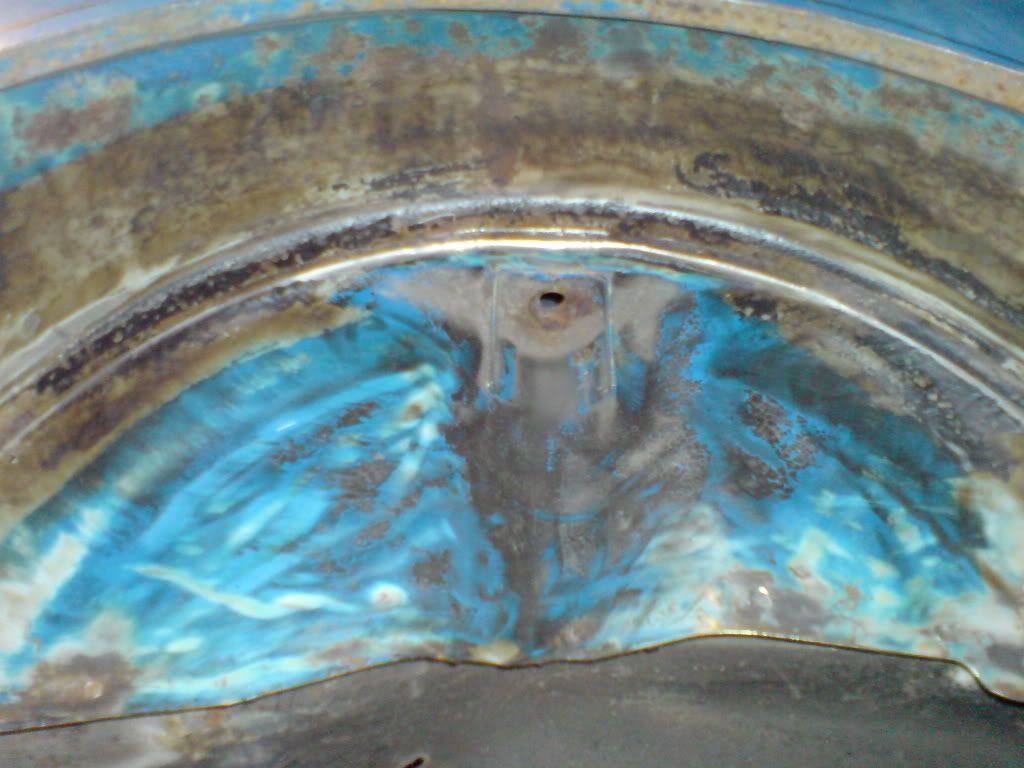

so i went on to cleaning the rear arches out.. this is how far i got
damn floor isn't straight and flat! putting these two repair panels together created more work for me!

Grimmy all i know it's me mates uncle who got the bottle and gas.......
