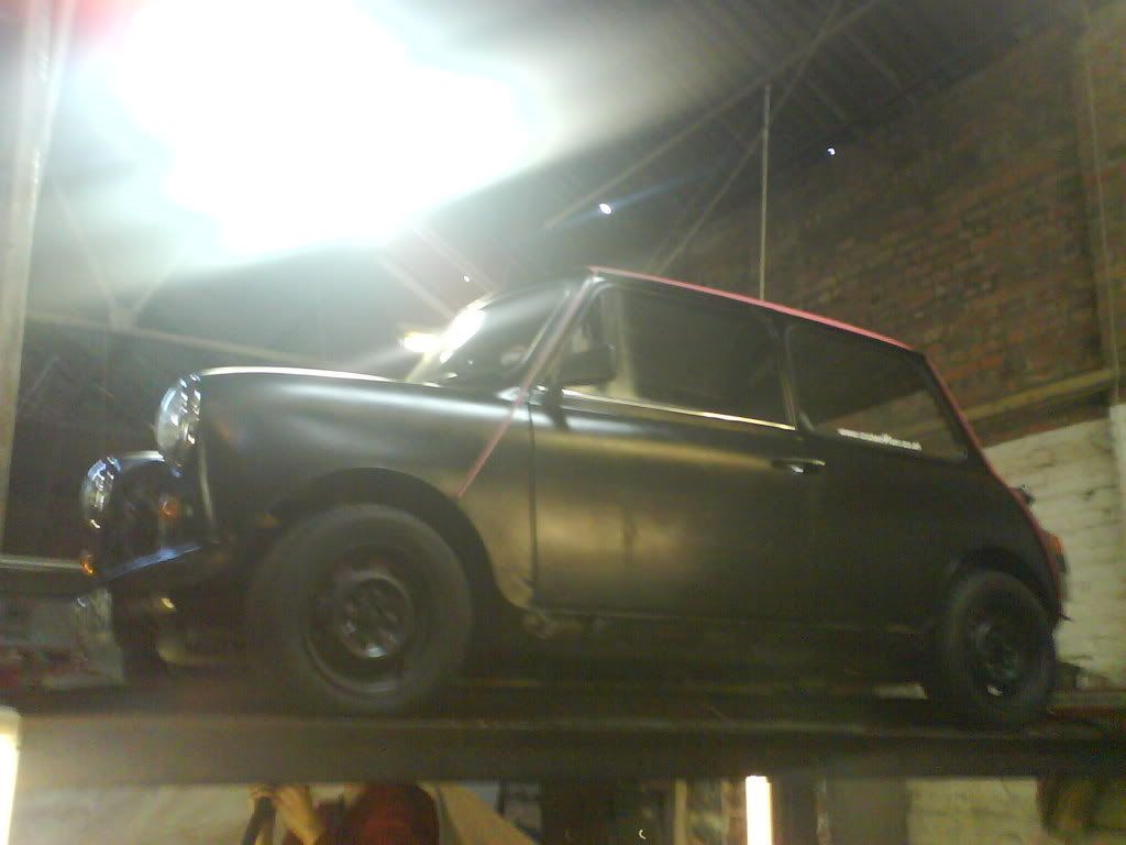

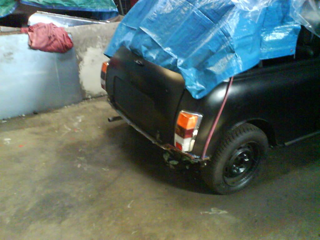

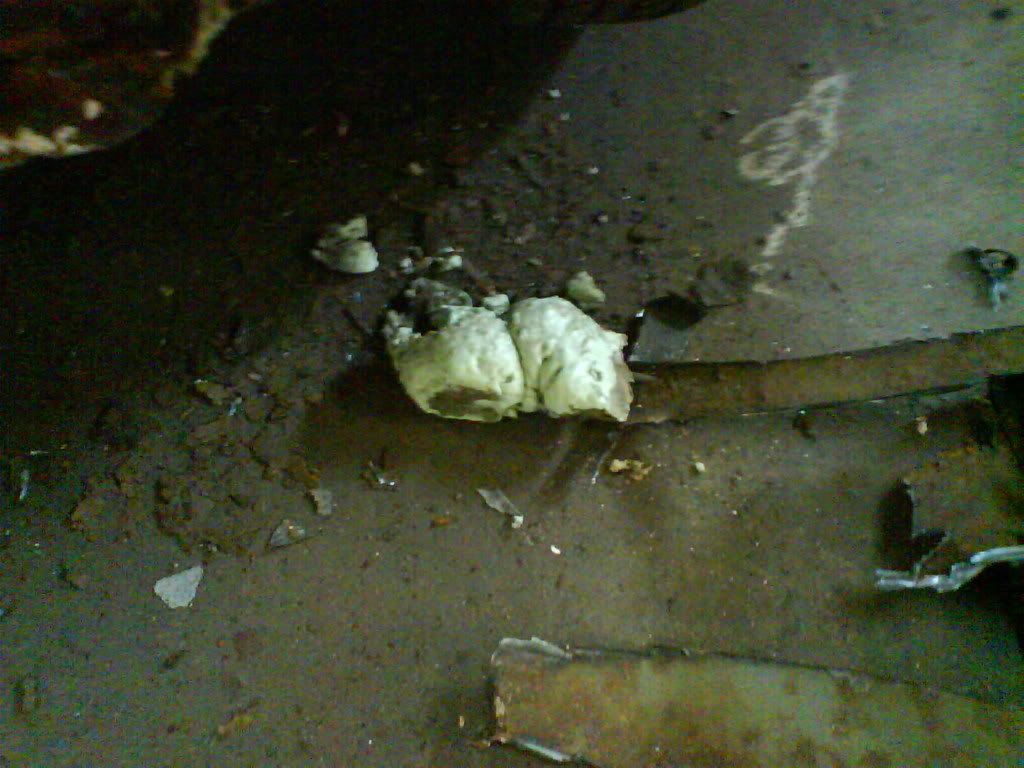

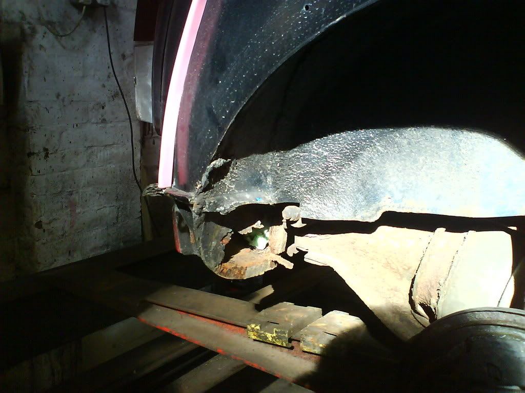

fibreglass and foam by the looks. Rear end is like it too.
I'll do a proper job on it though, new sills and valence etc to go on it.

Its just the front part of the sill and abit of the door step. Looks solid underneath which is a good thing.
Ill get the engine done 1st, then worry about the body work.

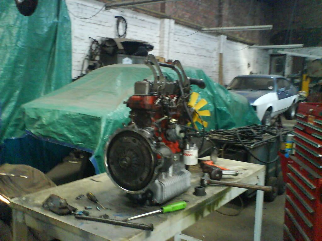

Engine ready to be lifted. Should have been out yesterday, but the gearlinkage rollpin is stuck solid, then my rollpin went inside the hole and got stuck solid too. Going to cut the linkage today (can get another for a fiver) so i can get the engine out.
Dont know if you can tell by the picture, I am using a proper engine removal bracket which I have the lend of.
Everything came apart pretty well, the suspension seems in good nick as I had to jack up the top arm to free the top ball joint. Should find out today whats wrong inside the flywheel /clutch housing.

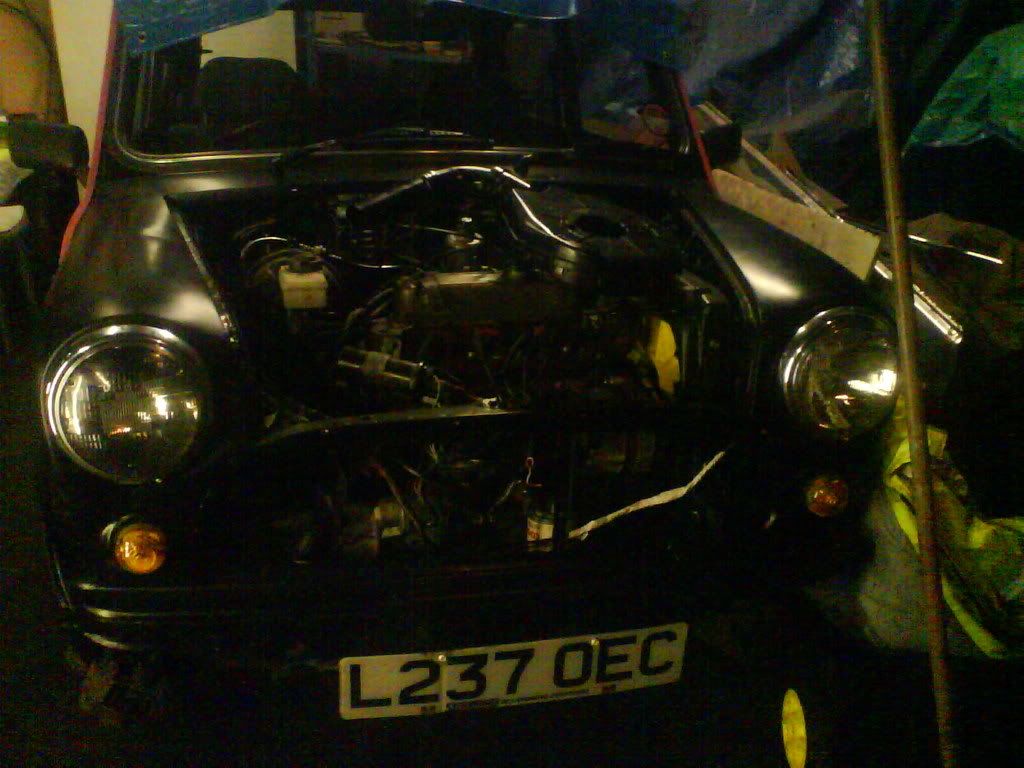

Engine out
Found this self destroyed clutch mmmmm
Fixed, back in and most things connected up again

Shame about the fibreglassed sills, but I've heard a number of people use expanding foam to infill the sills with.

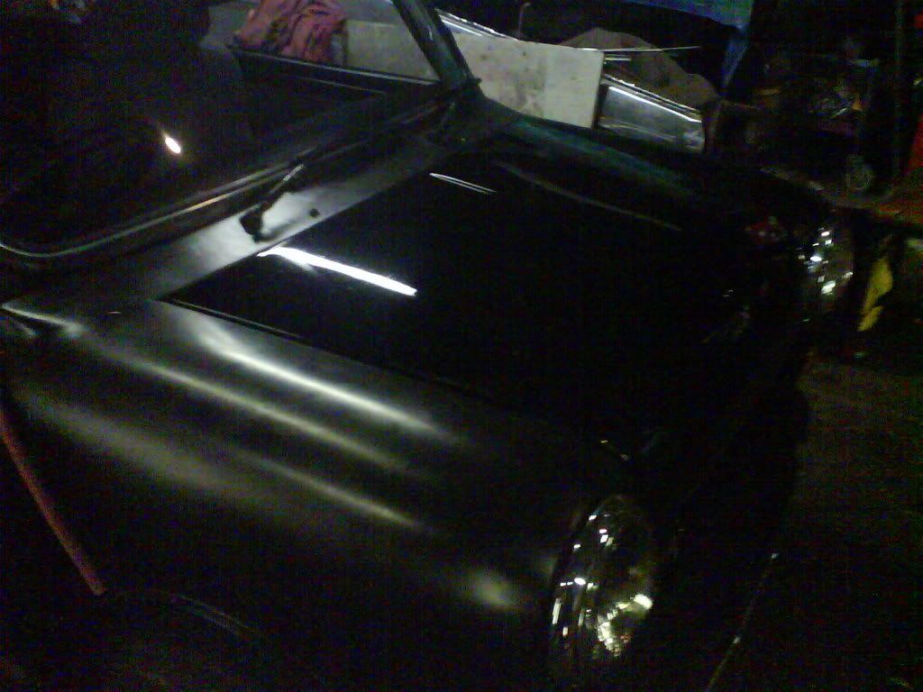

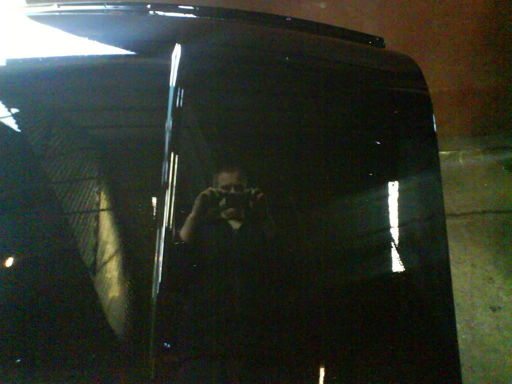

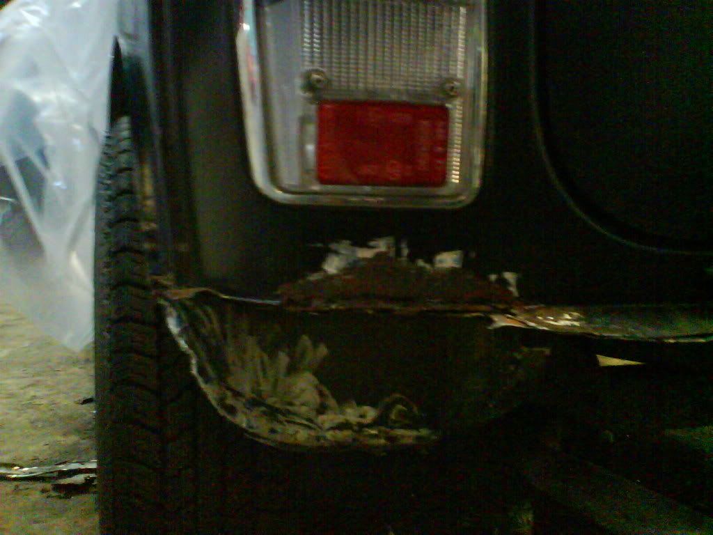

Posted 04 October 2007 - 10:56 PM

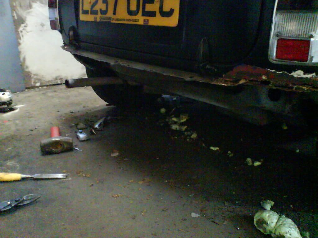

Another hole found, but i thought this so panels have been ordered allready.

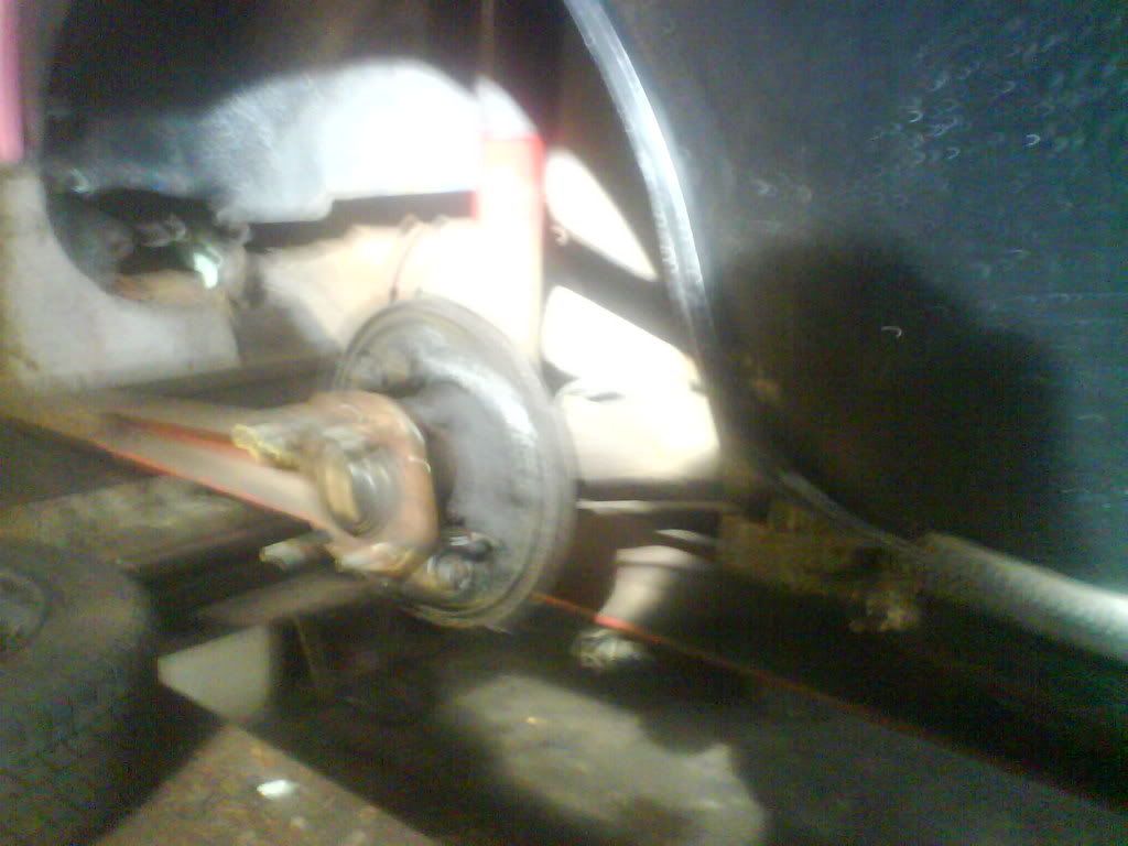

Fixing leaky rear brake cylinder, fitting shoes

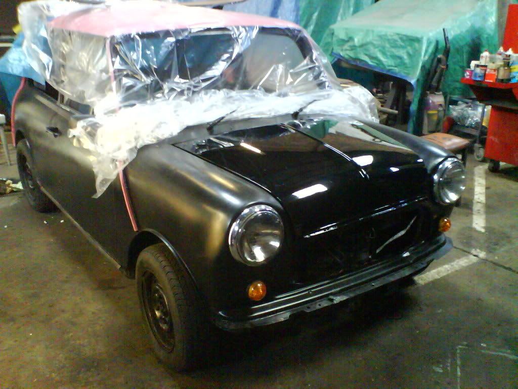

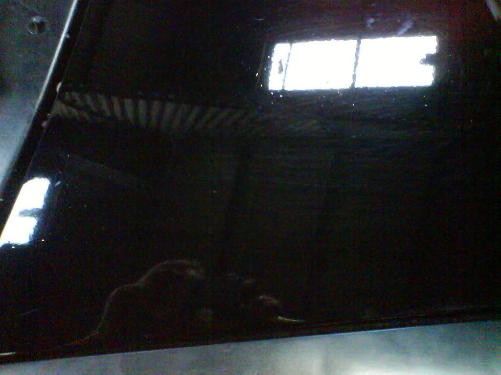

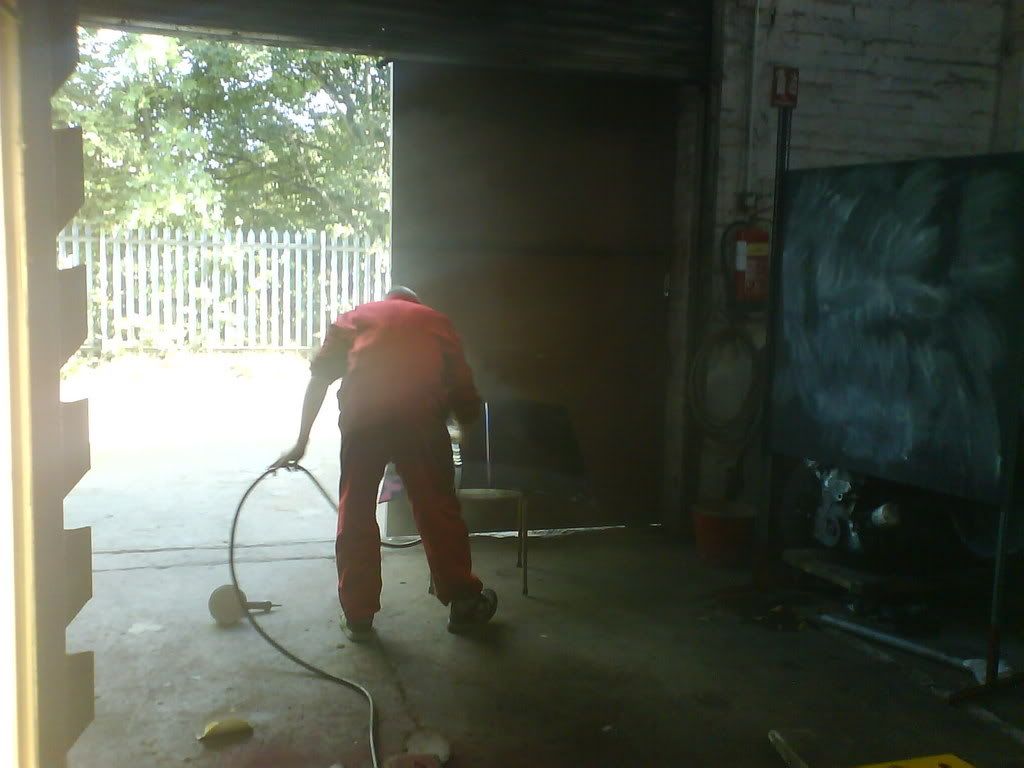

Stevie painting the bonnet in 2pac black for a test code (trial idea at this point, see below)
Just finished gearlinkage, bleeding brakes, exhaust bracket fitting etc
Hour or two after painting, reflection in paint pic. Note the dust etc doesnt matter, as it was only a test.
Compare.... (sorry bad light)
NOW THEN!!!!!
After painting the bonnet, we've decided to paint the whole car again.
Gloss black with a metallic silver roof
The windows are out, the N/S sill has been cut off and preped for replacement.
#41 Jammy
Jammy
  • 25,397 posts
Posted 05 October 2007 - 11:05 AM
Not that I don't like Matt black, it can look awesome on certain cars, but the gloss black looks much better!!

#43 Jordie
Jordie
  • 13,567 posts
  • Name: Jordan
  • Location: North East
Posted 05 October 2007 - 12:54 PM
haha, higher profit if it looks nice. So spend a bit to make abit, but i may just keep it.
Been chopping the rear valence and more bodge out today, but called in a early finish as its been a couple of full days so far.
TUKTUK, COME DOWN ON SAT AND HAVE A LOOK. LOOKS DIFFERENT WITH A SHINY BONNET AND PANELS MISSING ETC.

#45 Jordie
Jordie
  • 13,567 posts
  • Name: Jordan
Posted 05 October 2007 - 01:04 PM
Ask him if he will.
The paint we bought the for the bonnet was supposed to be matt black, but its not by looks. We are going to get a fresh 2 litres of glossy black from a different supplier, to make sure we have enough and so we dont need to colour match half way through etc .
So the 1st lot of paint is spare, so you can use that if hes got time to do it.
You'd probally have to do without your car for a day or 2, so the paint can harden and set in the spray booth.
