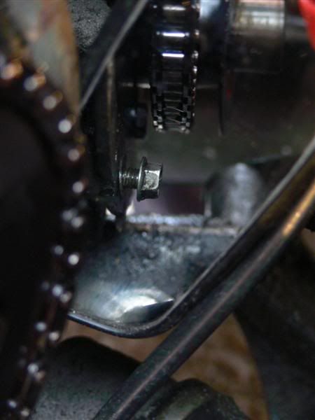

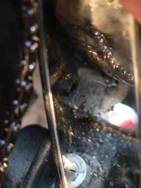

Reet...
This is as straight as its going to get:
It's in about 2 little turns and it seems like it will tighten up more as it's not stiff.
Is that straight?? I don't think it is, but it's a vast improvement on what it was doing before.
I don't want to tighten it more as i don't want to wreck anything, but then again, its as straight as I can possibly get it (trust me! I've spent 2 hours on this one bolt now!! :thumbsup:)
What should I do? >_<
That's the best it'll get, so am i buggered? >_<

Doing anything with the timing chain while you're at it?
You might be able to use a longer bolt 'n put a nut behind the backplate if it gives any more grief. You might want to use some gasket sealant if it looks like it won't pull up properly.
