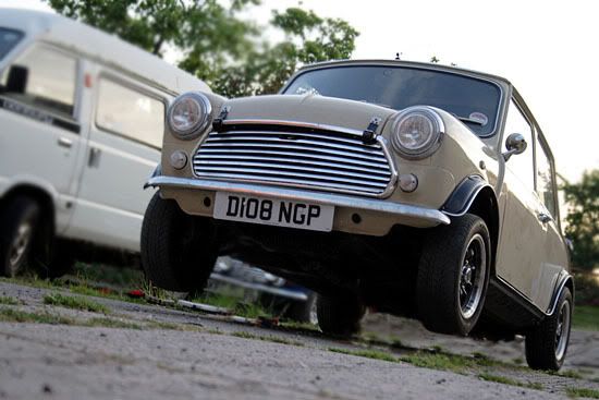

whoah wheelie!
x

O_O only took 2 mins wolfy
x

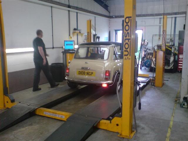

Well, he made it to the MOT on Friday morning! ...
And passed with flying colours! :P
MOT issued and no advisories! :P

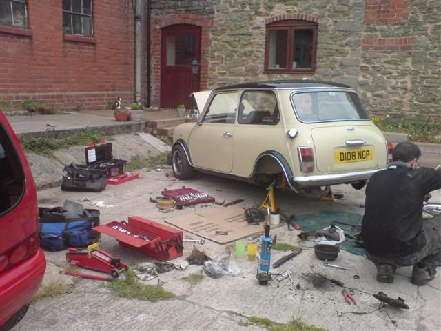

Kris and his Dad made it down to Hereford on Thursday and started work on Reggie! By tea-time, Reggie had a replacement radius arm, new brake cylinder, fixed wheel bearing noises, soldered wiring to the indicators and new bulbs!

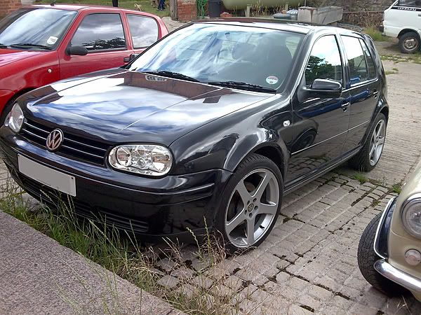

This is what I'll be driving! :lol:
Kris' GT TDi! :P

How shiny is that!
So Reggie is getting a well deserved rest and touch up, nice! Don't get too used to driving the GT though if you have ot give it back! :lol:

It's not shiny at the moment, lol :P
I can't guarantee that though, Charlie! :D Just come back from taking it to Hereford for a potter! :ph34r: 6 speeds and a turbo are yummy! :ph34r: :xxx:

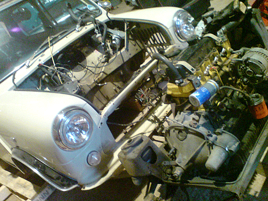

Well, in April, I got my Reggie back! :ermm:
He went on a few local runs and shows.. :dontgetit:
However, with ALOT of questions recently about where Reggie's gone, I thought I would let the secret out (Even though some people know, since SMD and IMM, when we turned up in K's Sprite!!)
About 4 weeks ago, Reggie's engine came ridiculously close to giving up on me. He had absolutely no power anywhere. Regardless of alot of work and countless mixture adjustments, timing adjustments and brand new parts, I couldn't get anything out of him at all... One slight hint of moisture in the air and Reggie would give up! (Even though he has brand new leads, plugs, electronic dizzy and brand new dizzy cap .... and weather shield!)
So..

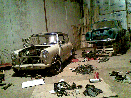

Out it came.
One of the other reasons for doing this now, is that Frankie (My Mini Van) has some huge bodywork problems (so much for a completely restored shell, eh?). However, before we discovered these problems, England_Expects had been down and put alot of work in, putting my engine together.
Now, I didn't want Frankie's engine to be sat around for god-knows-how-long. So, the obvious conclusion was to put Frankie's in Reggie's for the time being!
So, what is it? >_<
Having allowed myself to become familiar with the Golf's power, I'd hate to go back to a 998, wouldn't I? :P
So..
Introducing...
The new-improved...
1275 MPi Reggie! :thumbsup:
Now, I know it's not to everyone's taste (Thanks for the comments, people! :dozing:). But hear me out! :P
As this is Frankie's engine, and Frankie is my company car, I NEED this engine to be reliable. I need to be able to start the car up in the morning and not be afraid that I'll break down on the way to a photoshoot. I need this car to be able to handle motorways, but also pull enough to carry a full load (in the Van.)
I know people will hate me for changing Reggie from carb, but ever since Reggie cut out on me on the M1 because of the torrential rain, I've hated the things!
Currently, he's all plumbed up, wired in and brimming with fuel :crazy:
With a new ECU, alarm and fob setup. Paul Smith loom. Maniflow LCB without a cat. Brand new Lambda sensor (OUCH!!) etc, etc, etc...
And don't worry. He still has central clocks! :wub:
