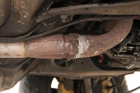

So, I took the exhaust off at the Y-Piece, cleaned up both that and the link pipe, put some paste on both pipes and then slotted it all back together and did up the clasps! Then just put some more paste over the join, just to be on the safe side! :P

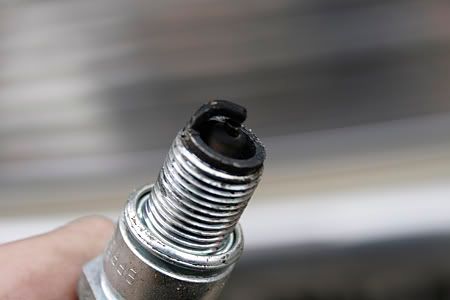

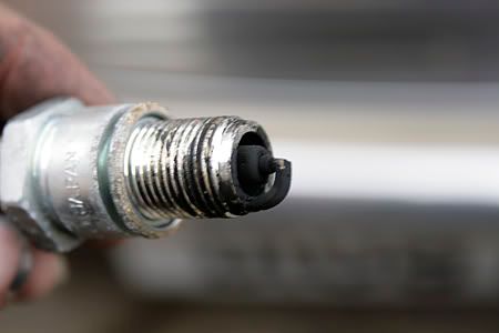

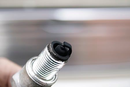

I've been driving him the 13 miles to and from work and in the last couple of days, I've used about £20 worth of fuel...! We worked out that he's been doing an average of 10-15 mpg! :ph34r:
When I re-hung his exhaust, I turned it on to see if the leaks at the Y-Piece had gone and Reggie spat a load of black ikky-ness all over the floor....
And all over my Fiat :)

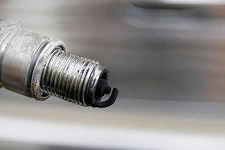

So I checked his spark plugs...
:D
So I've adjusted the jet and made it much less rich! Drove him home from work and the fuel gauge didn't move! :D

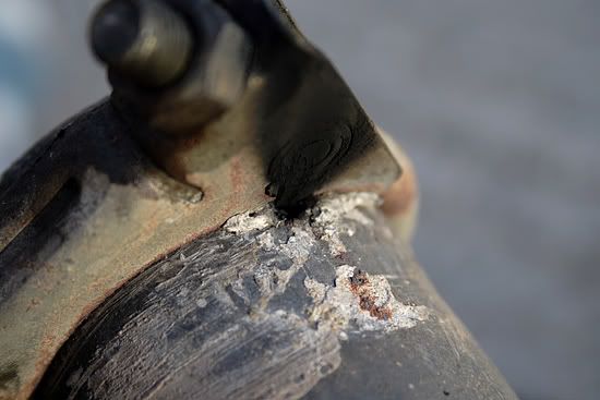

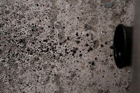

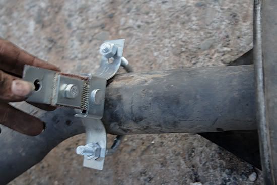

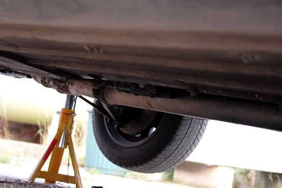

Reggie's exhaust has been leaking again! :(

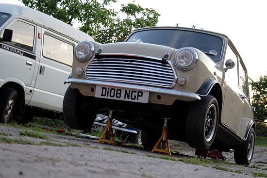

So, once again, he went up on stands for me to sort it out!

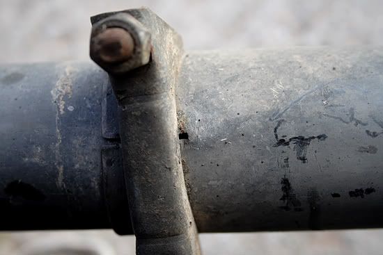

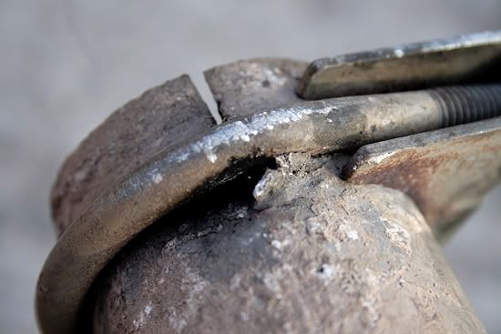

Take the exhaust off and find its not just at the y-piece this time!
It's here:
And here:
And here!:
Also, put a new bracket on as the old was pretty ropey!

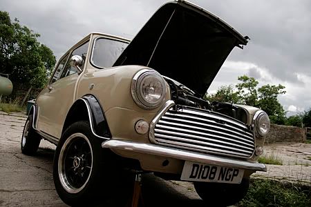

So, slotted the system back together and re-hung it!
But pillock here put the clamps on upsidedown! O_O But I wasn't going to take it off again! :D
And i had the camera, so got a bit carried away!
Isn't lens distortion weird? :P
