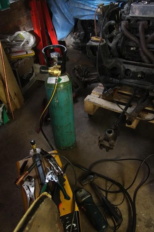

Today, I spent 6 hours driving 'round trying to find gas & a regulator! ... :dontgetit:
Eveeeentually managed to get everything I needed! :)

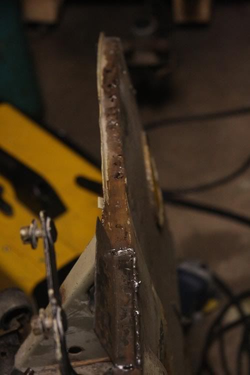

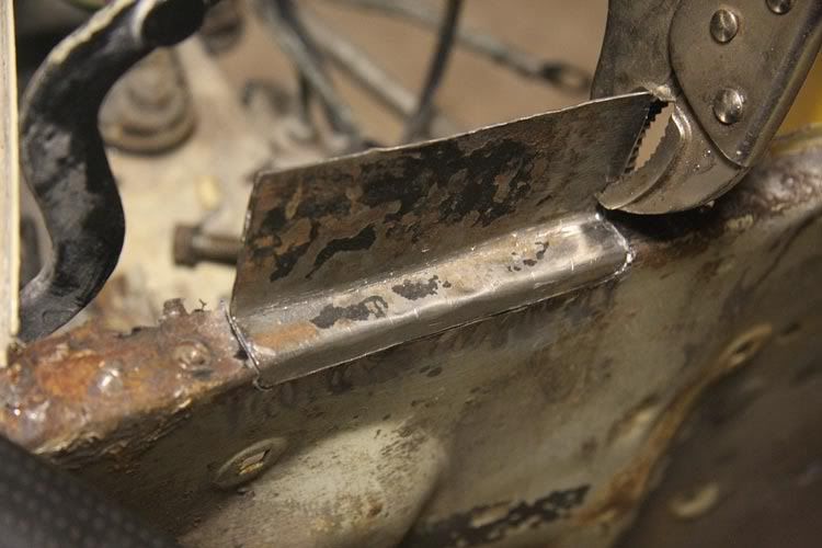

So - This is what I decided to tackle, today!
Figured that the sooner I get on to the car, the better - And also, that the inner wing was wrecked enough anyway - I couldn't really make it any worse! So thought I would practice putting some metal back on the car.
So, this is the adventure of my first ever weld on a car - My first ever hand-made patch and my first ever butt-weld. ;)

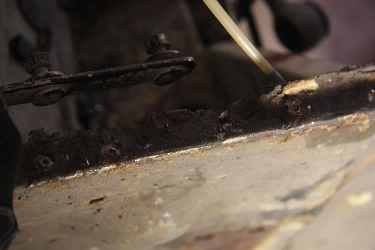

Firstly, I chopped out the rotten section:

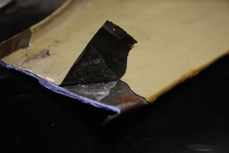

Then I took one of Reggie' A Panels & started stripping it down, ready to use for my patch:
(Yeaaahh - Really bad paint job shows again!)
I made my patch to do in the section:

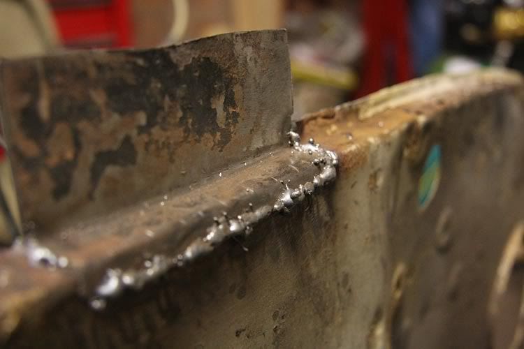

Then welded it up! :P

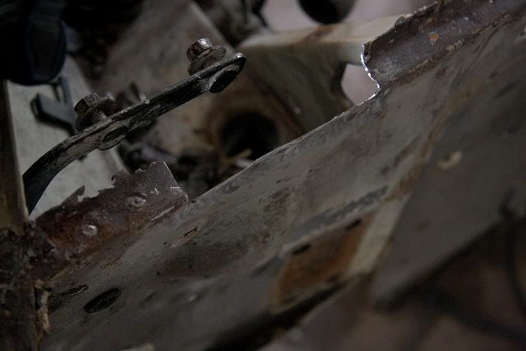

And it's mostly straight:
The area to the left, nearerst the scuttle, is a bit rubbish - the metal's so thin and my patch wasn't the best of fits - so it's not a great line up, so the metal blew straight through. I reckon half of it's OK, but the other half isn't good enough yet.
Still, I know it's not up to standard yet, but I'm really pleased with what I've done today! :dontgetit:

find yerself a bit of copper or brass to put behind it as a "chill".
