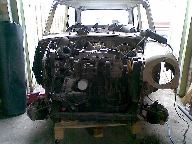

I've drilled out a lot of the spot welds on the other side, and removed a lot of gumpf that was in my way on both ... and removed the shock mount (which hasn't rusted through - Whoop!), and removed more of the loom.
Besides - I was being careful! :) And - look at the little amount of space that I had to work in, on the driver's side, lol. I was mostly wedged against the garage door, with all the spiders! :)
It's not that bad, no - But as you say - I did think that he'd had all this work done. But then, Chris wasn't too happy with the bodyshop that did it & I wasn't happy with the quality of work that mine did - So who knows. I guess it can deteriorate quite quickly, over 3 1/2 years, if it's not done properly in the first place?
The inner wing is bothering me though.

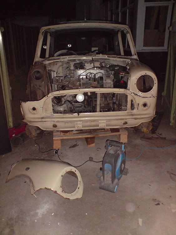

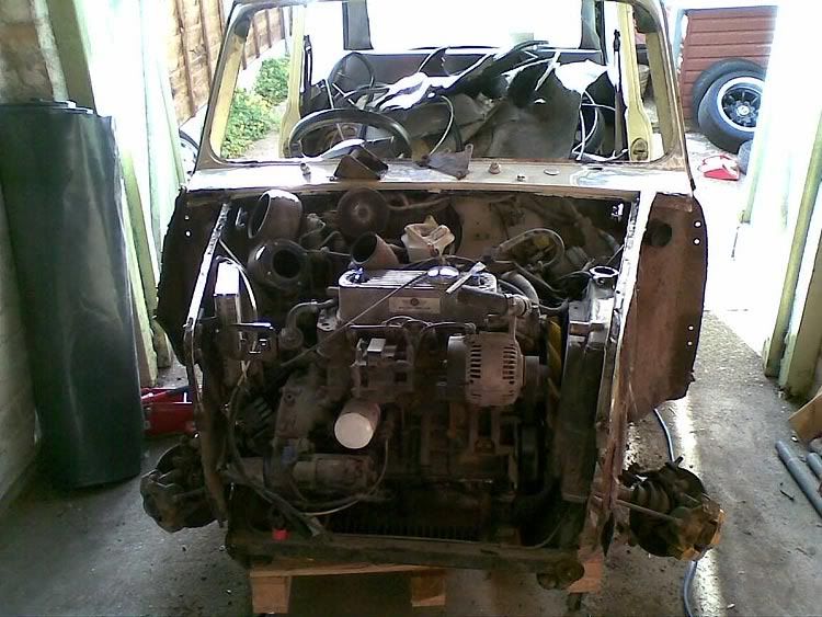

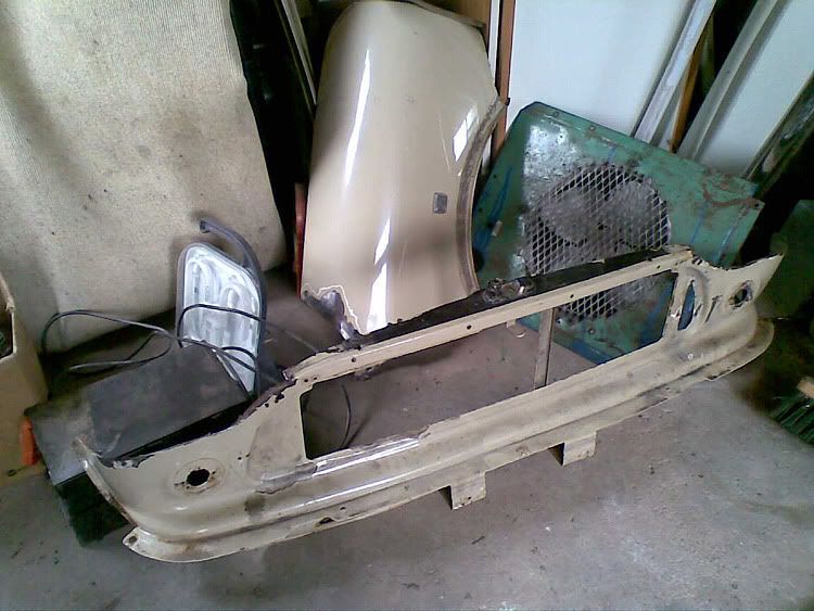

Photos! >_<
I spent aaages removing the front panel:
Nice and neat - leaving the other wing on.
However - As much as I wanted to save the wing, the edges had become very, very thin. They had rotten through slightly on the arch lip and where the wing met the front panel was in a bit of a state, too.
So I made the decision just to lop it off!! :P
Took me 2 minutes, lol :) Why didn't I just do it like that before? lol :thumbsup:
So, Reggie has no face!! :crazy: :crazy:
... I am now also sporting a bright red, rather painful blood blister on my palm :crazy:
Owwie! :cry:
