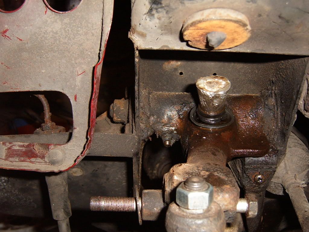

Yes jammy sorry if the OP wasn't clear. I have removed the rubber doughnut and sawed the trumpet so theres just like the lower third of the trumpet left in. I'll go take a photo.

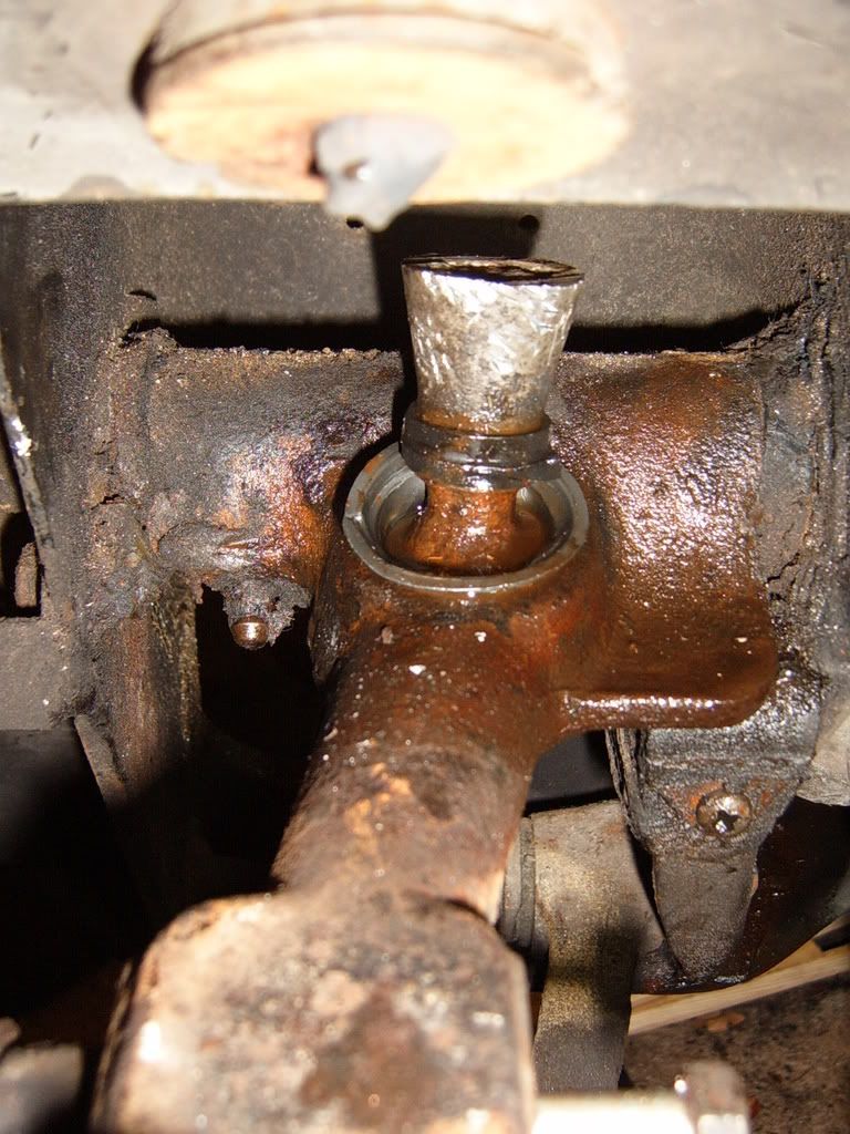

Here's some photos of my front trumpet mess as it stands:
& http://i243.photobuc.../S3700007-2.jpg

Couple of options spring to mind.
Drill a hole through the remains of the trumpet so you can stick something through it and lever it out.
Blow touch/cut/hack away at the old cup remains so there is enough room for the ball joint to slip out.
Maybe even both together!
heat souds good, if you get whats left of the metal very hot it will melt its way out of the plastic cup with a bit of levering :thumbsup:

Hmm I was going to try taking out the top arm drilling to break the vacuum and put it in a vice and take it from there. Because you can't really work with that bit of the front subby in the way ('bulkhead'?)
