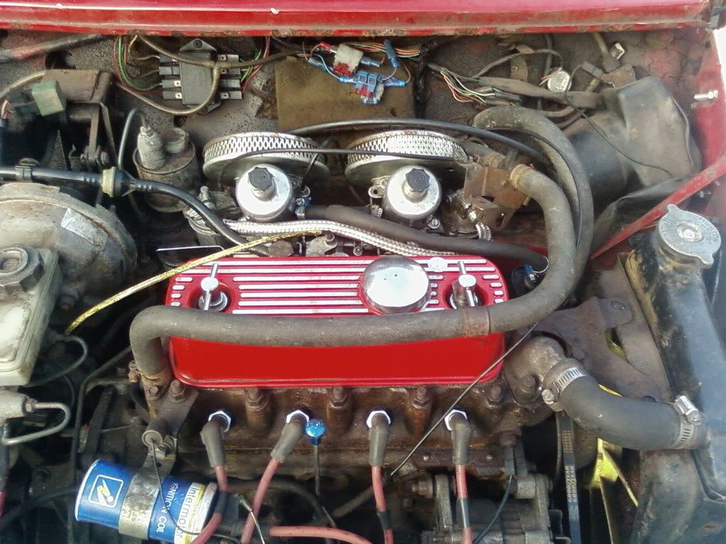

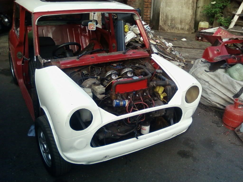

Random pics, new rocker cover on :errr:

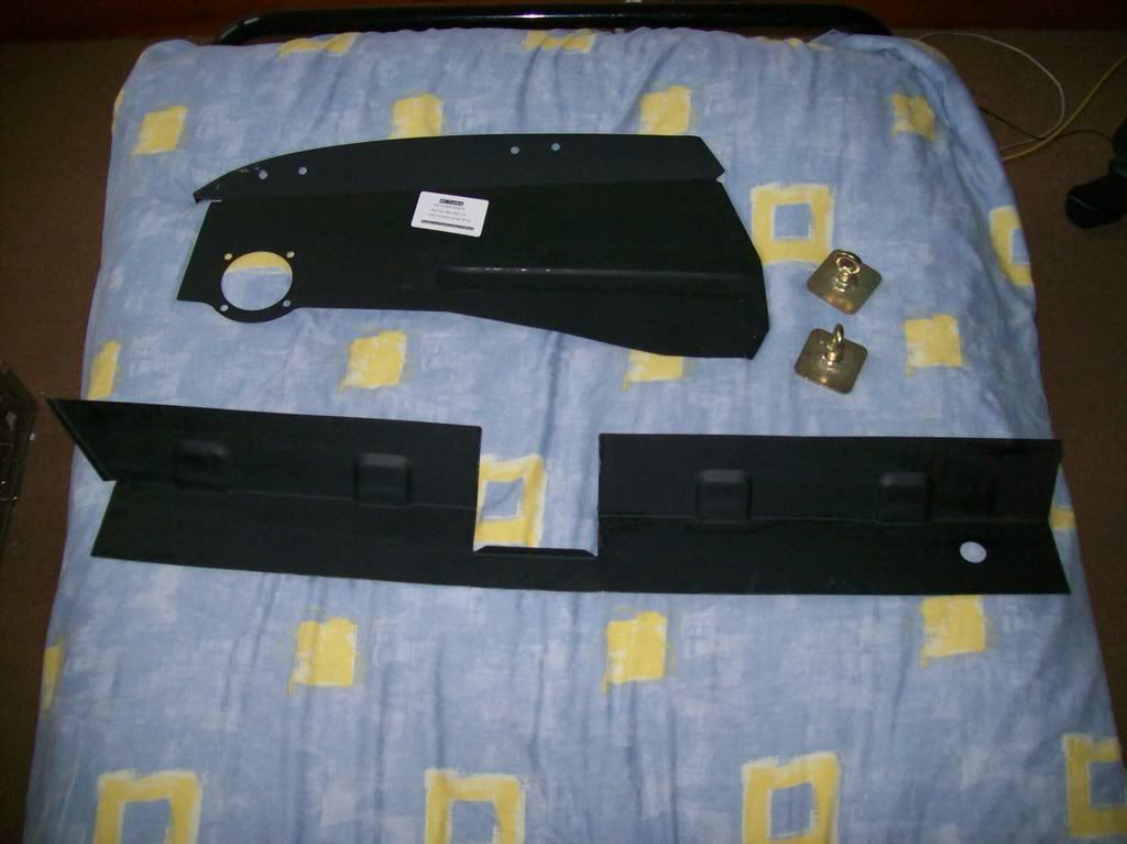

Got 2 panels today and eye bolts yay !

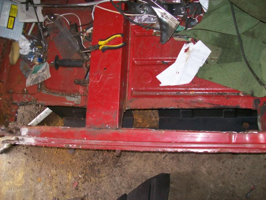

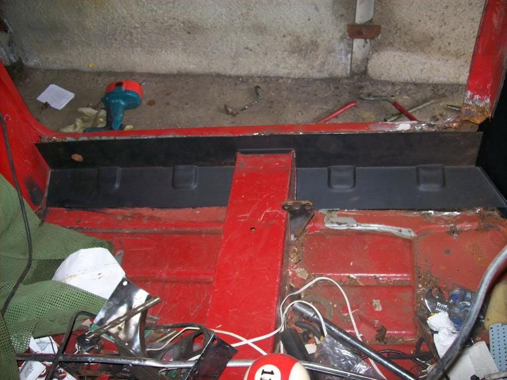

Inner sill

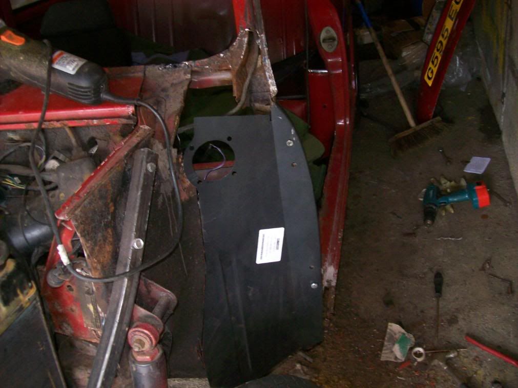

Inner wing

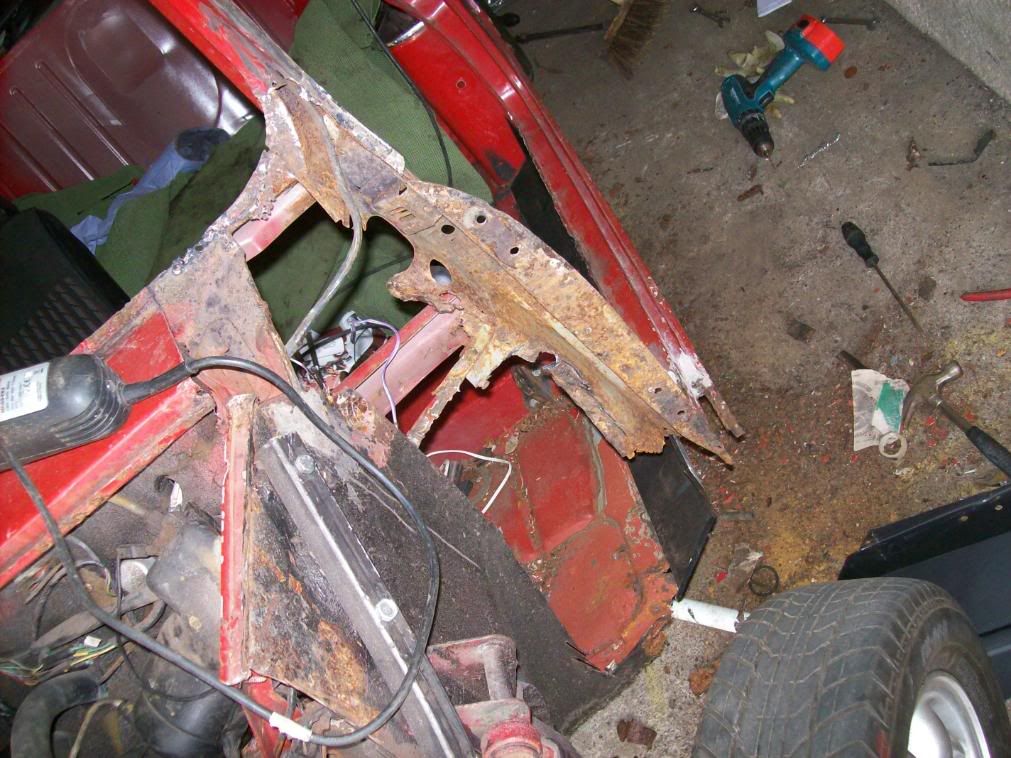

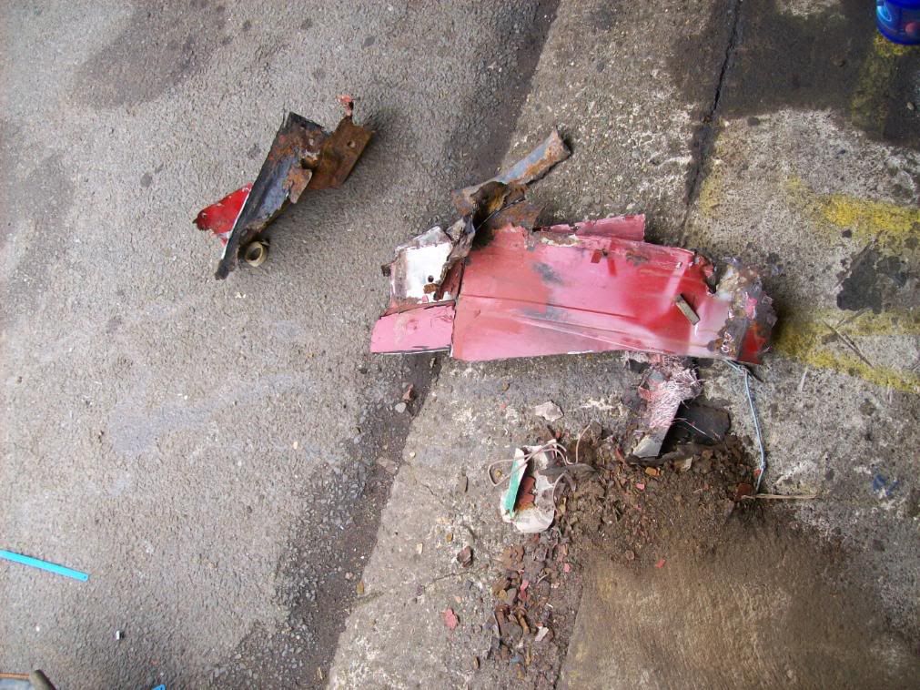

Been in the garage since 8 this morning :thumbsup: anyways got some bits cut off and panels ready to weld pics
Spot on >_<
Lost of horrible surface rust lol
And finaly all of the horible bits that came off
Posted Image lol
Found out whats wrong with the mini too lol the carbs need tweaking so when i get it allll welded and ready to spray ill take it to a rolling road and get the tweaked and all that stuff :-

Posted 29 June 2008 - 08:30 AM
you really want to think about taking the front loom out when you come to weld up those inner wings and scuttle repair pannels especially on the passengers side, other wise it will melt.. pluss another tip, id personally not be moving that mini about to much like jacking up etc because its not structurally sound with all those pannels removed if your not carefull it wont be straight again!

Yup i kinda noticed :thumbsup: erm well could i cover the loom up with some fireproof stuff or something like that ? because i dont want to hastle around taking the loom out ! ^_^ :o

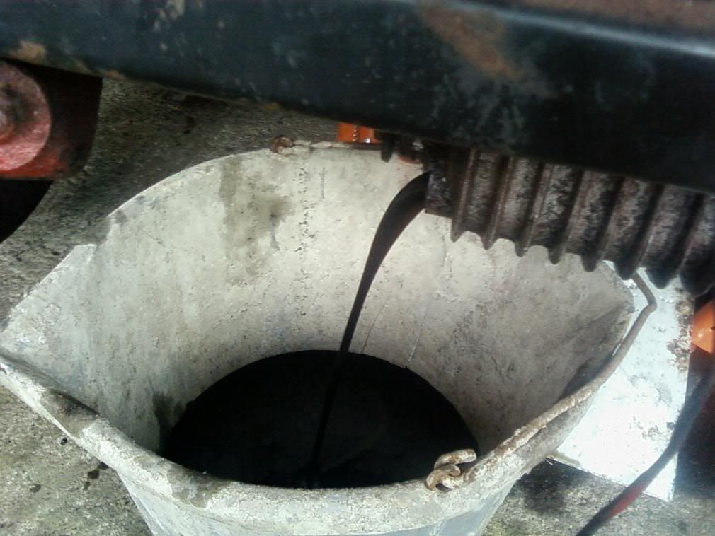

Got the oil drained on the mini today ready so i can replace the seals :D

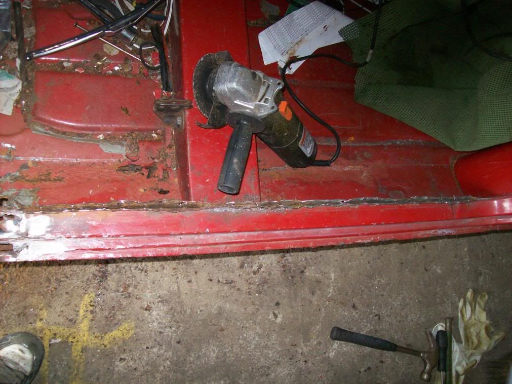

how did you replace your inner sill?

pushed the new panel up against it dreww around it and cut behind the line just to make sure :( but befor you do that drill all of the spot welds out or youll have a problem >_<
