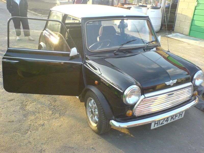

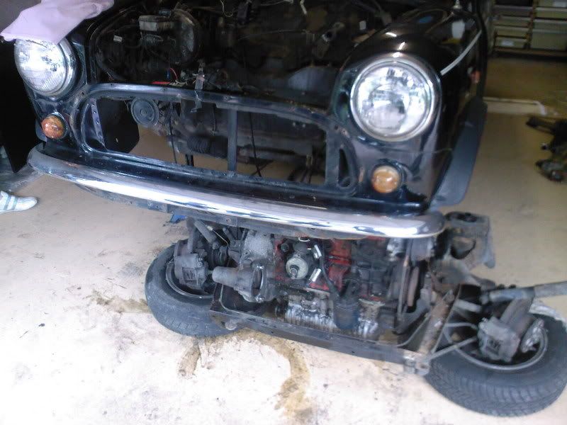

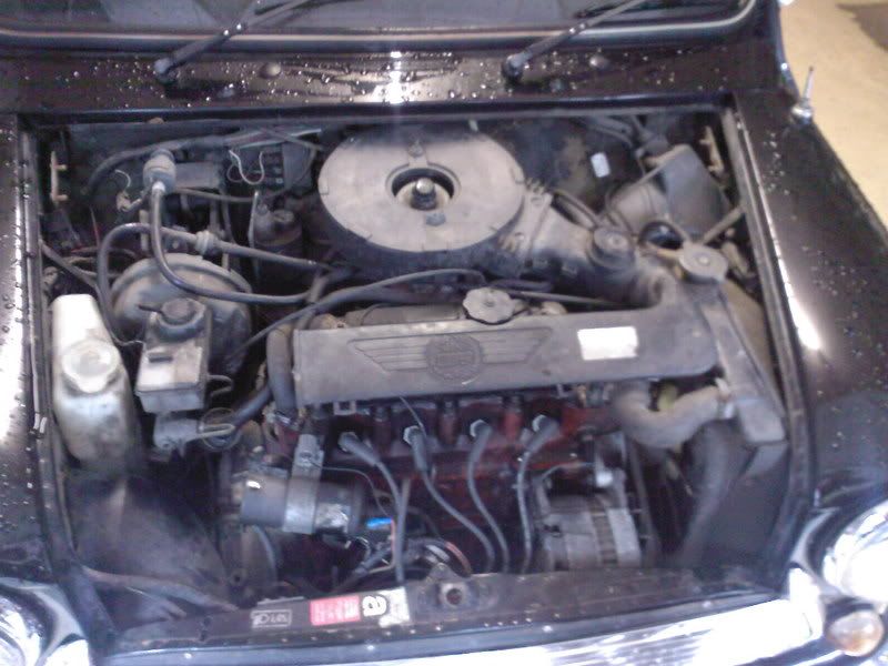

Heres how the car started, plain and simple 1275 Black Mini Cooper!

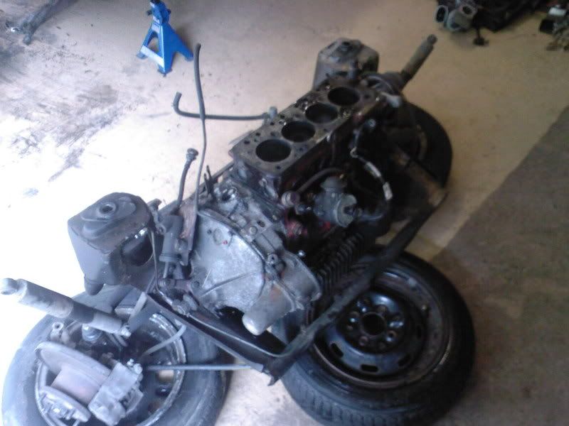

Firstly i took the engine out

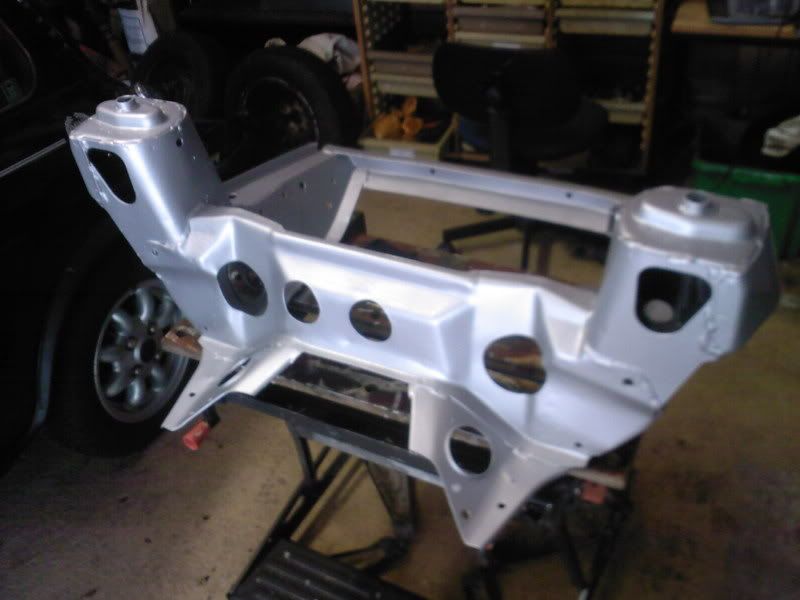

Next the front subframe got a refurb

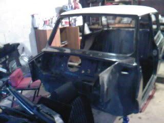

The shell was going off to be sand blasted so i had the strip it out! Also cut the front off for the flippy, bad move in the end as now its going to be a race car the regulations dont allow a full flip front! Whoops, oh well i didnt know i was going to race it then!
All that sound deadening had to go! ... Now that was boring!

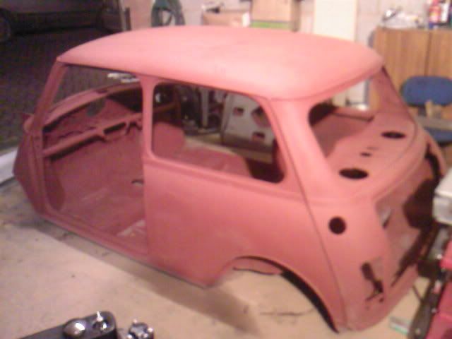

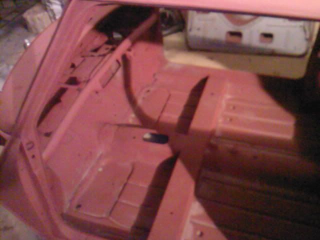

Sent the shell to be blasted, this is how it came back, in red oxide primer!
At this point it was still going to be a road car... then i went to a hillclimb at loton park and changed my mind! So from here on im building it to be a racer!

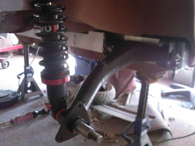

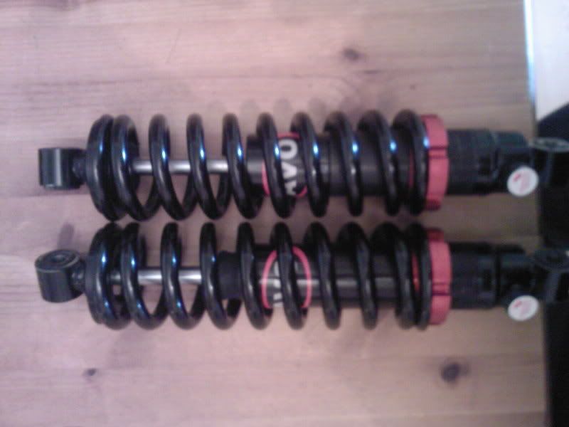

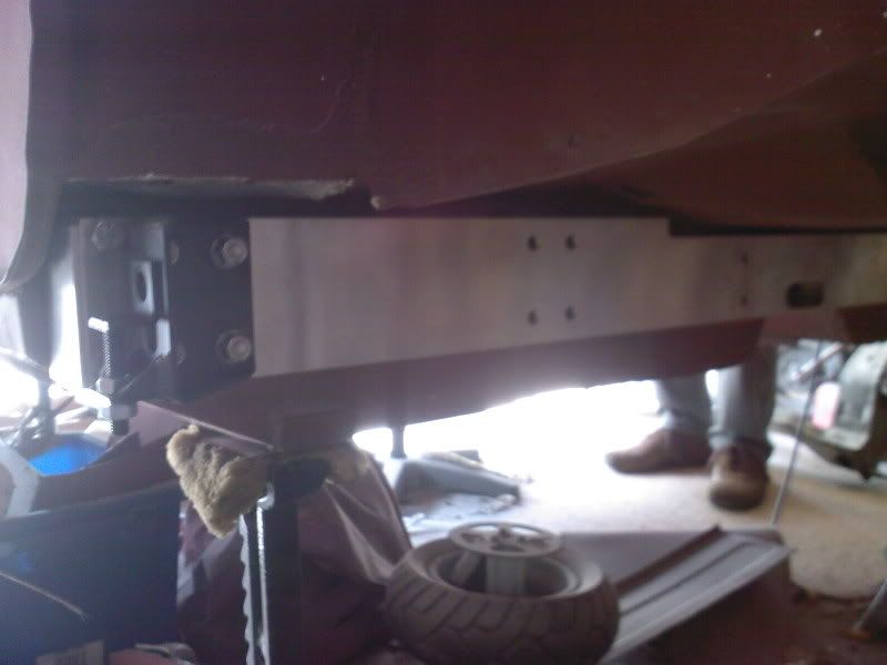

Front and rear coilovers from AVO.. they look amazing and i hope they work well too!

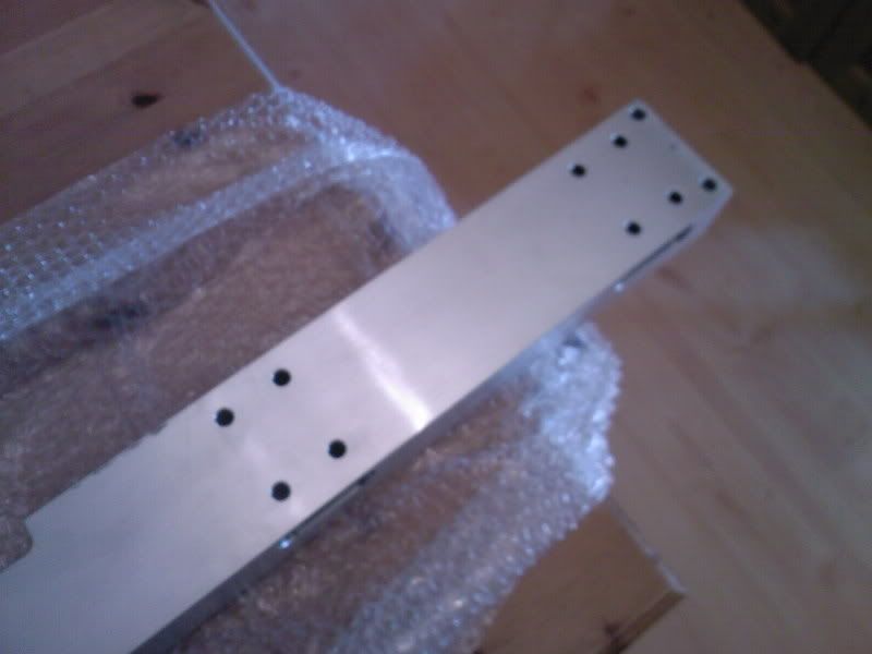

I then got a rear beam from Minispares
Got that on
With the radius arms a coilovers!

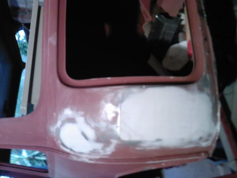

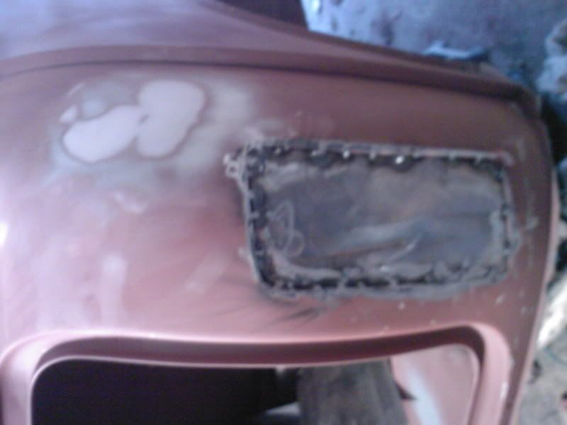

I then smoothed out the rear lights and made a boot repair

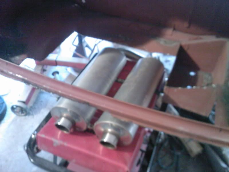

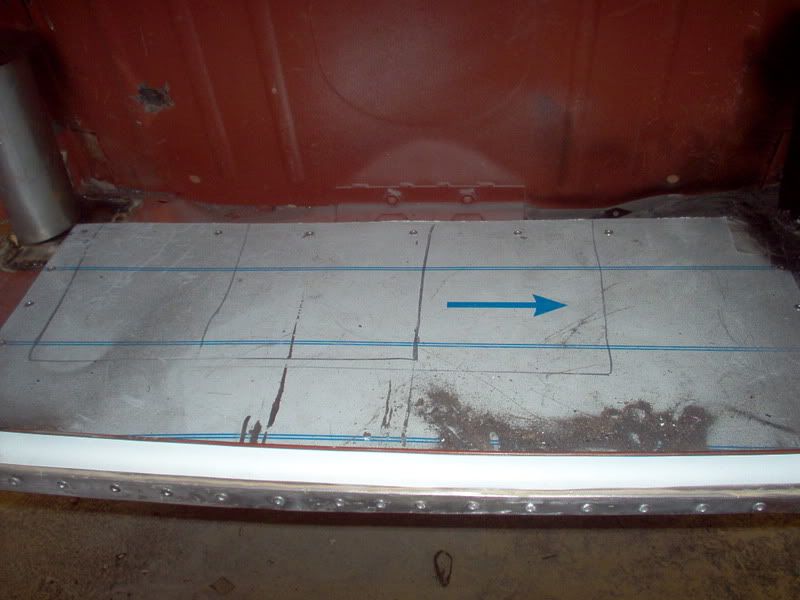

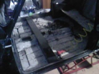

Quick pic of the rear valence removed along with the boot floor ready to put in the flat alloy boot floor for the tank, also shows the silencers im going to use!

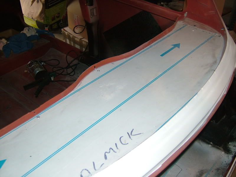

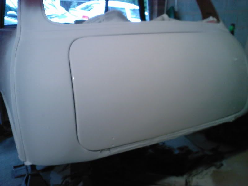

Finished rear end smoothed, primed and boot lid suplied by ABS Motorsport in place! Looks great and fits well! Note no rear valence to improve airflow underneath and just looks great!

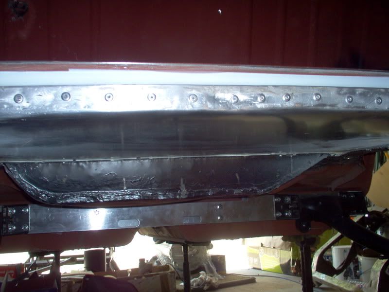

And the final bit ive got to is doing the boot area to clear for the Coilovers and flatten the boot for the tank (Which is custom and should arrive today!) and fiiting a crossmember to stiffen it all up!

Erm yer the boot floor has been removed and replaced with alloy and the rear valence is gone, as you can see in the picture.

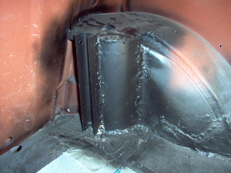

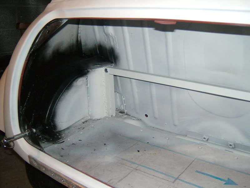

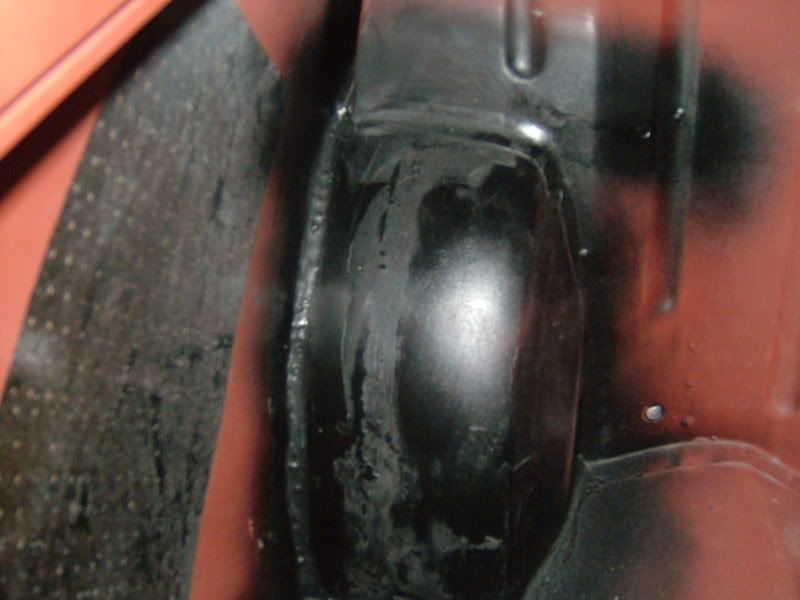

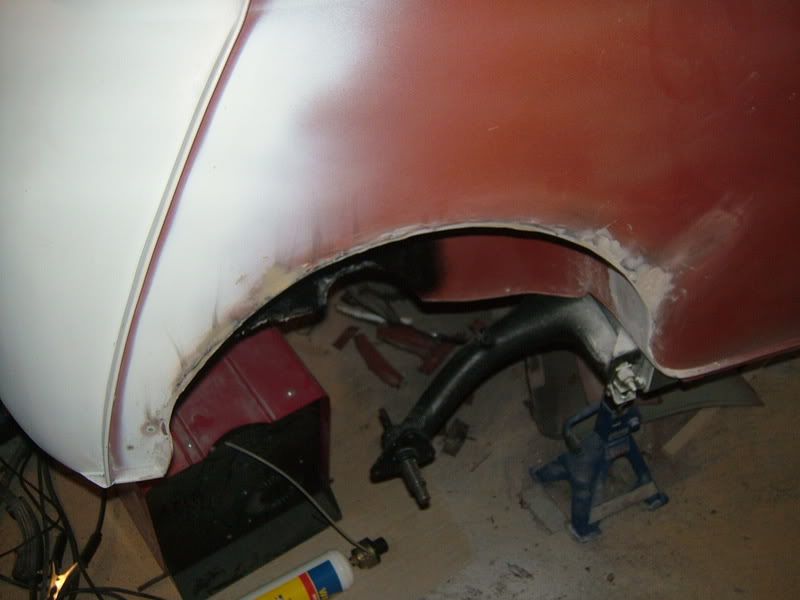

Been out tonight and opened up the rear arches to fit the coilovers... they fit like a glove now! Also strengthened inside and added a brace bar between the two inner arches to stiffen it all up!
Tank didnt come so it will be here tommorow, just got to get that in a tub the rear arches and the backs done.

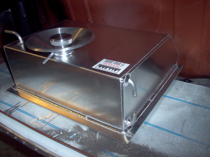

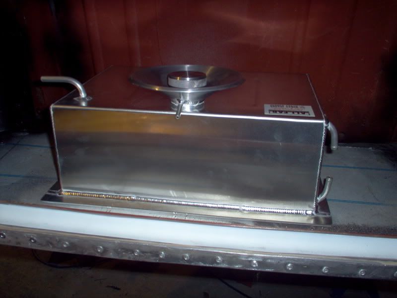

Hi all got the photos today, and my tank came!

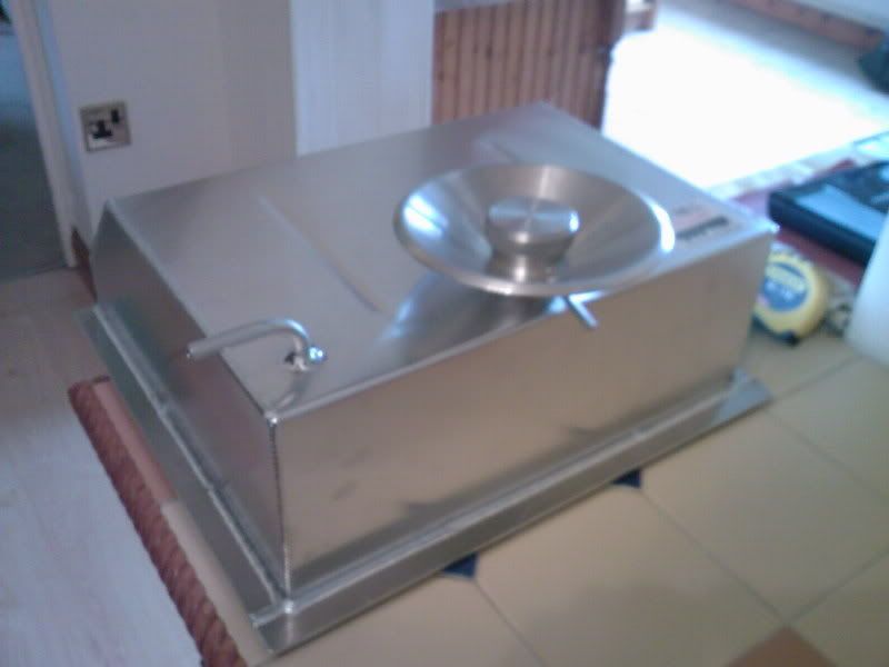

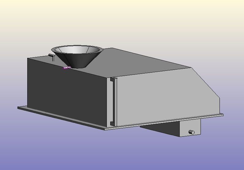

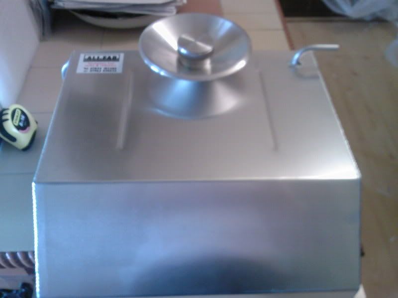

Heres the tank... i sent him this pic i did in pro desktop
and 1 week later....
He did a really good job, will deffo use him agian, the tank was made to my exact spec and foam filled for a great price i think.

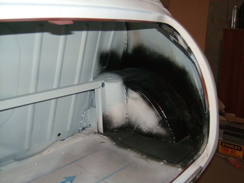

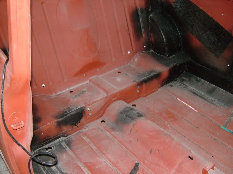

On to the boot, heres the boot floor pics from top and bottom as promiced

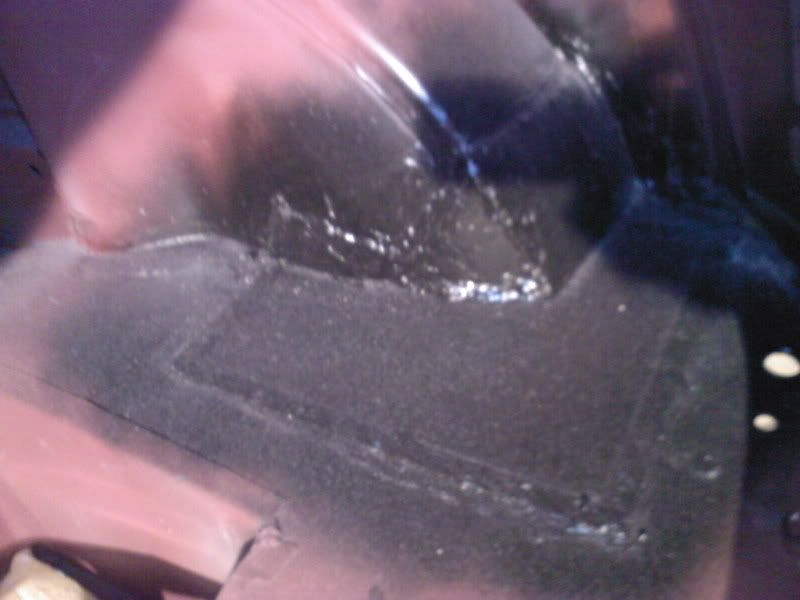

And the inner wheel arch widened and strengthened, the cross member hasnt been put on yet as i ran out of welding wire, will do that later and post up a pic!
Finally the tank resting in the boot!
Perfect... let me know if you like it or if ive done something really bad!

the Ali tank is that allowed for racing?
#13 01smartc
01smartc
  • 1,412 posts
Posted 16 May 2008 - 07:43 PM
Ye would like to see some other pics of the boot!
Erm yer the alloy tank is allowed as ling as it has a drip tray round the filler, as you can see, a non return valve in the breather and its foam filled, which it is!

the rules say that you can use a original tank or a safety tank but the good old alloy is not allowed, thats what I was told here at the last race meeting I went to. the rules are from spank my bottom with a limp cucumber Mosley.

Ive finished the rear, both sides have been extended for the coilovers and a brace bar has been fitted!
Then moved on and replaced the parcel shelf with an alloy one!
Next bit was to tub the rear arches, which took a while but its done
