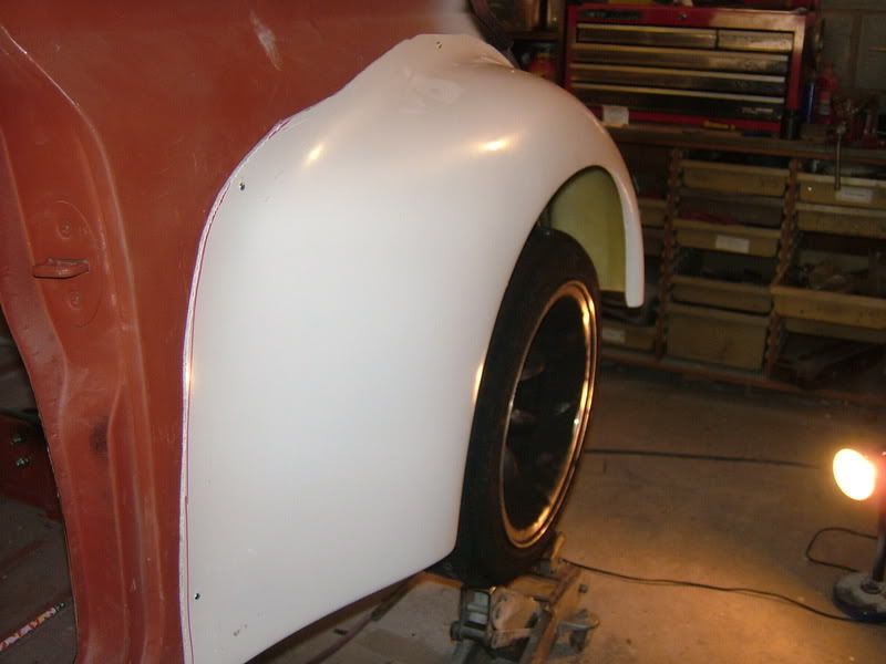

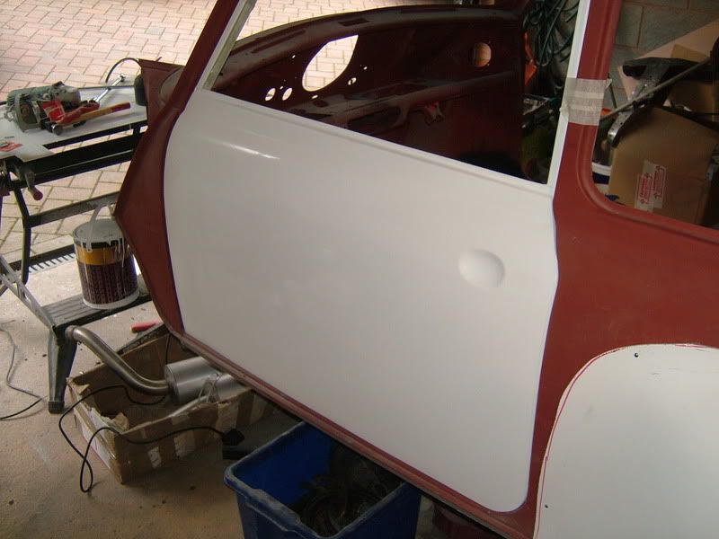

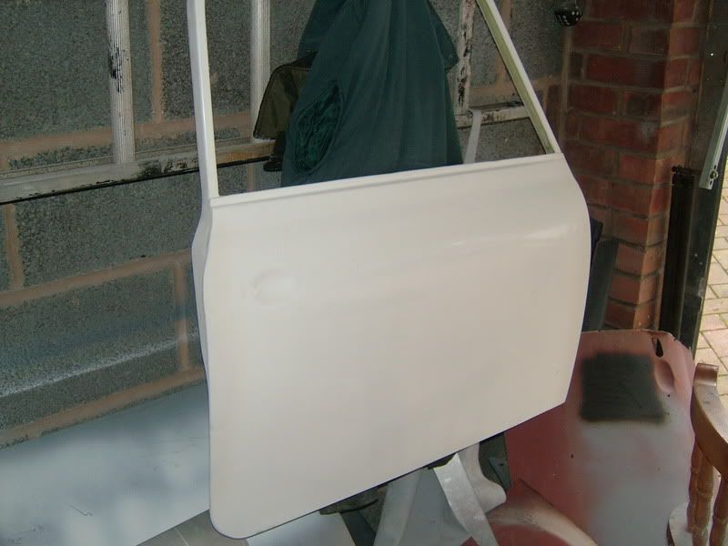

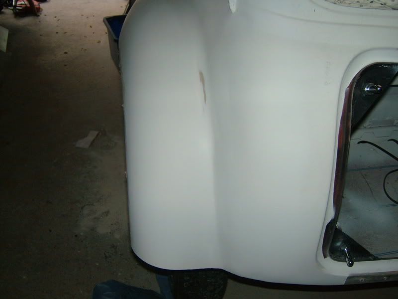

Moved on over the past few days and fitted one of the rear wheel arches. This is part of the fortech kit from ABS... i think it looks great! :lol: Others have said they dont like it, let me know what you think!
Also got the doors the other day. These are one of the new sets of fibreglass doors from Custom Minis! Very good quality and fit like a glove, if your after some doors deffo go to them :lol:

Oh by the way those arent the wheels that are going on it they were just to get the arch in the middle! ... before someone says there way too small for the arches :lol:

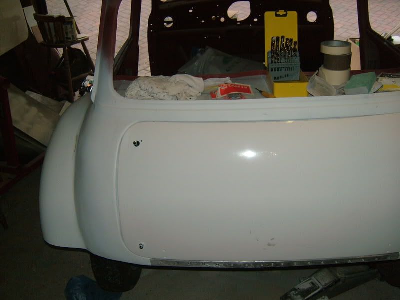

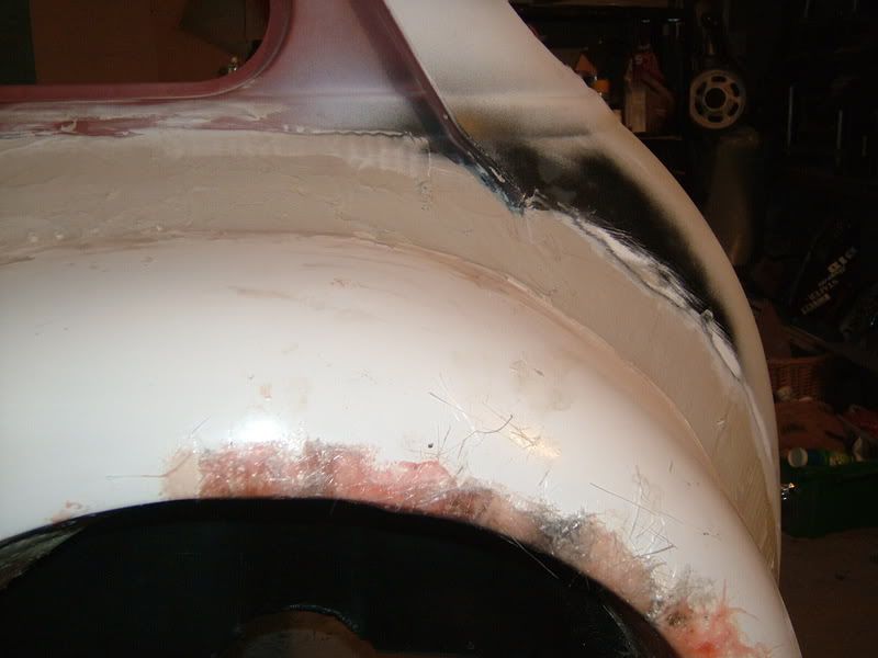

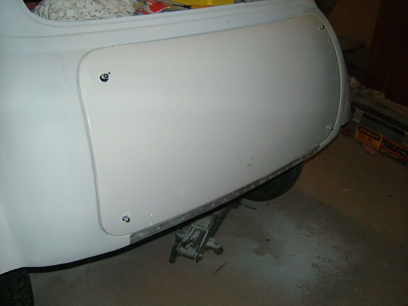

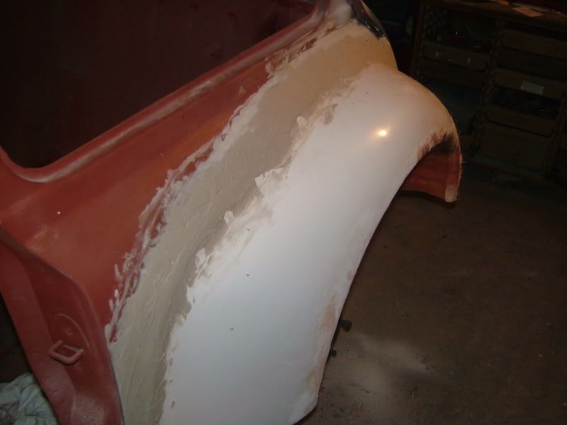

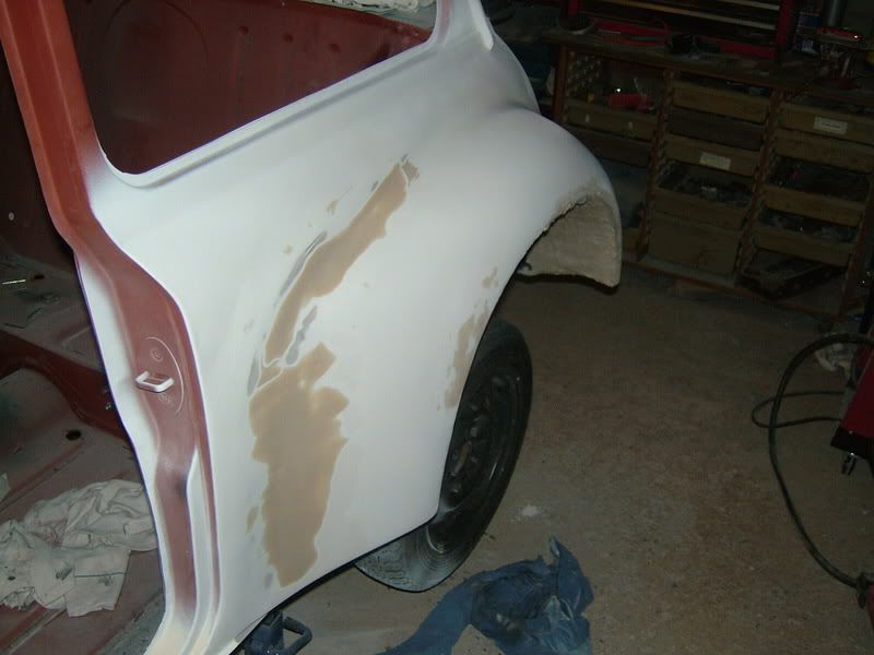

Posted 11 June 2008 - 08:11 PM
Right then, pictures of the arches and boot as promiced, quite happy with it all, just needs more time rubbing down then re priming ;D
Hope you like
Smart
