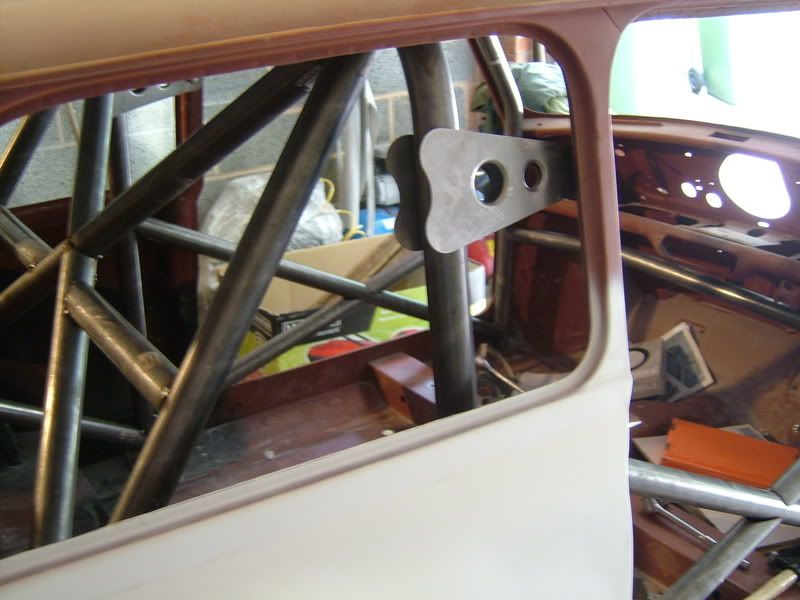

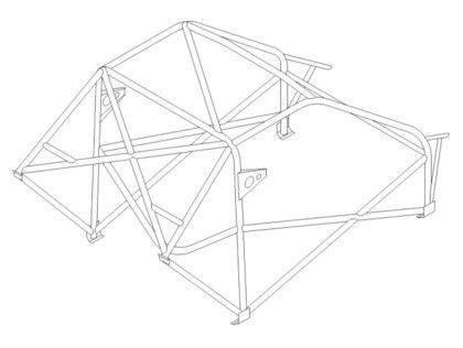

Hi all, bought the roll cage now, just started to try fitting it.. looks like doing a rubix cube in the dark with no hands but im sure i will crack it.
It looks like this :P

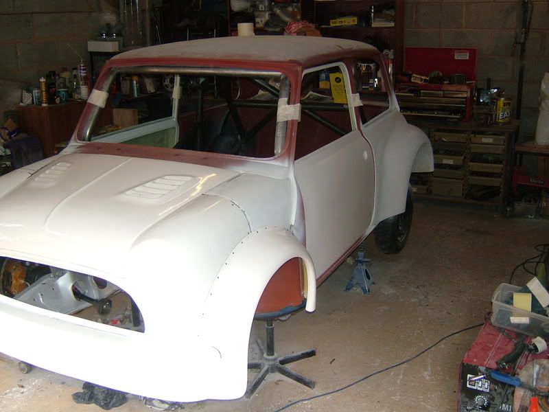

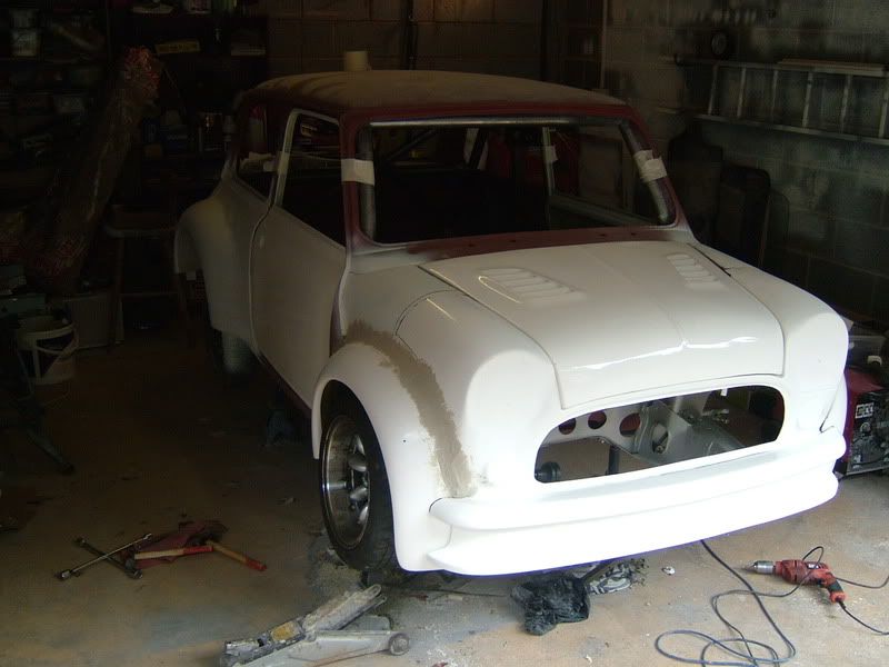

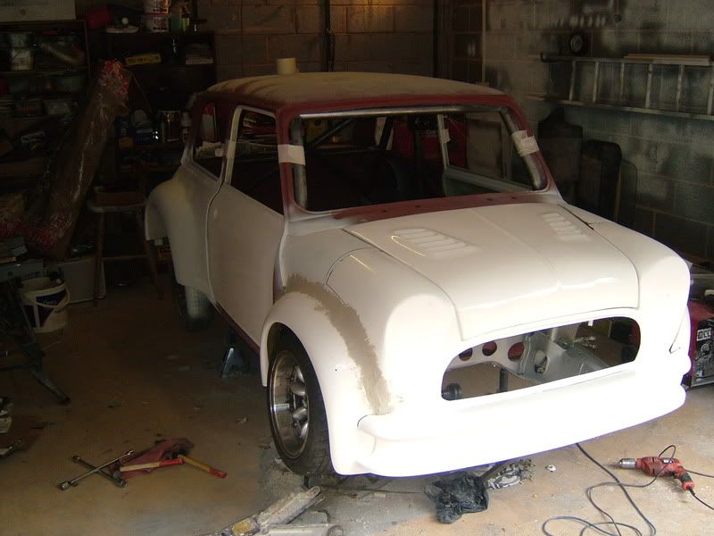

Right then.. long time no update! So here we go, theres been alot done :wacko:
Both rear arches are now on and smoothed.. look good I think!

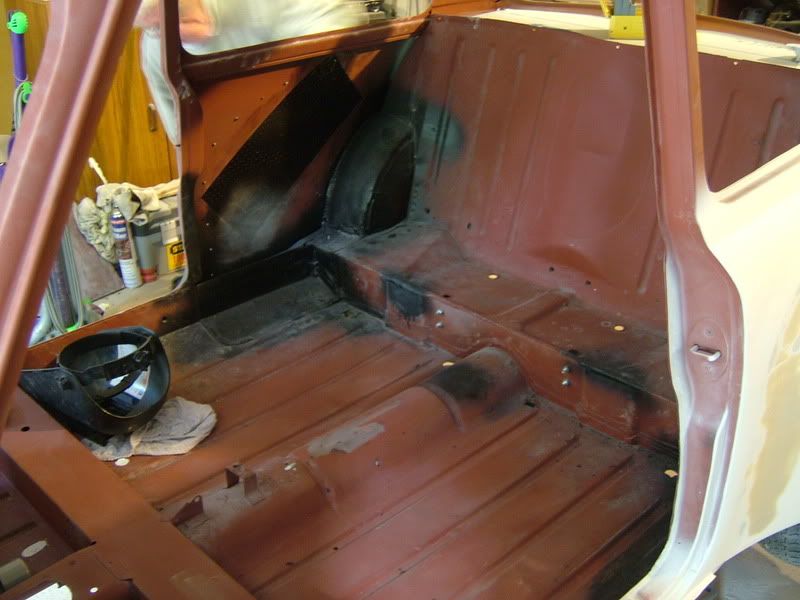

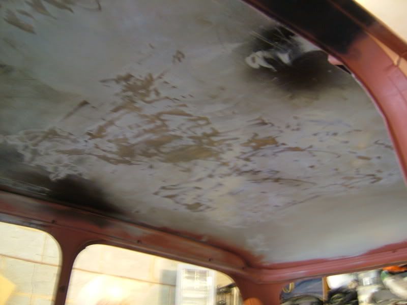

Next another job that took 10 millions times longer than you think, removing the glued on sound deadening on the roof! After hours of grinding and sanding, I ended up spraying it with thinners and then setting it alight to melt it all off :cry: That worked!

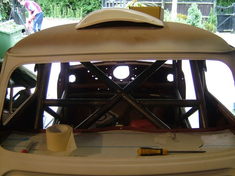

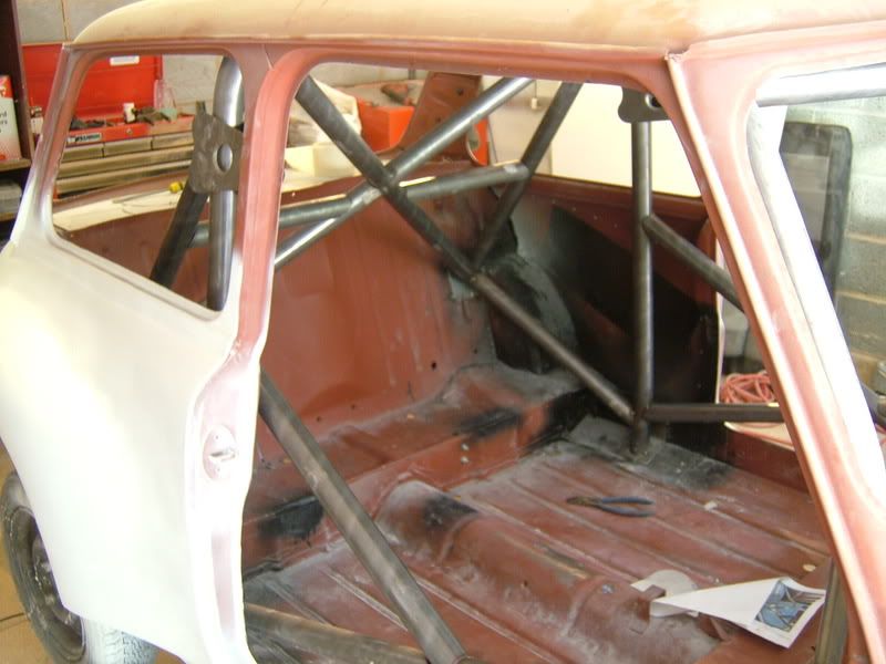

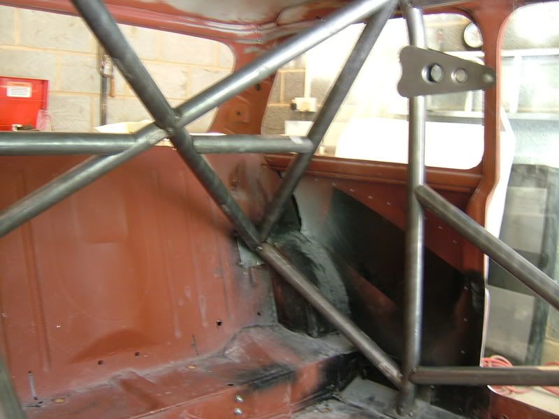

Now the roll cage...... wow this took alot of time, pain and effort, but its finally tacked it in ready to be fully welded in.
This is what it looks like, hope you like it, cus its gotta save my life!

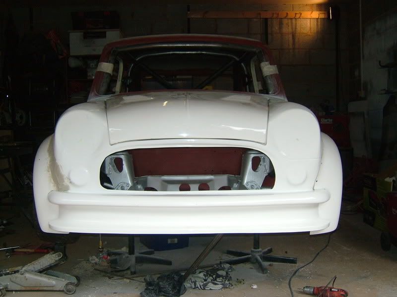

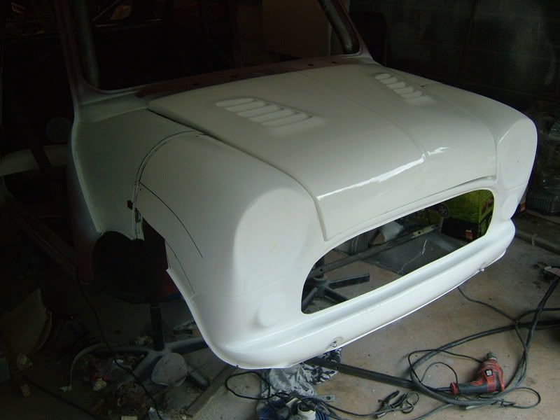

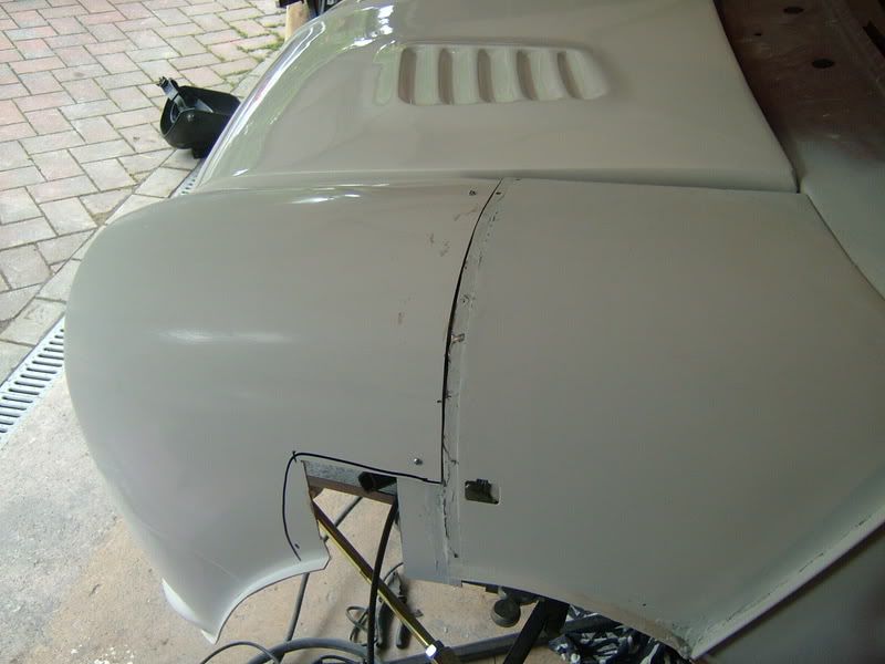

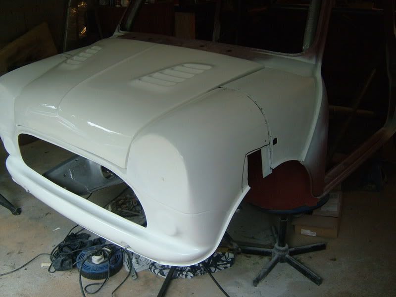

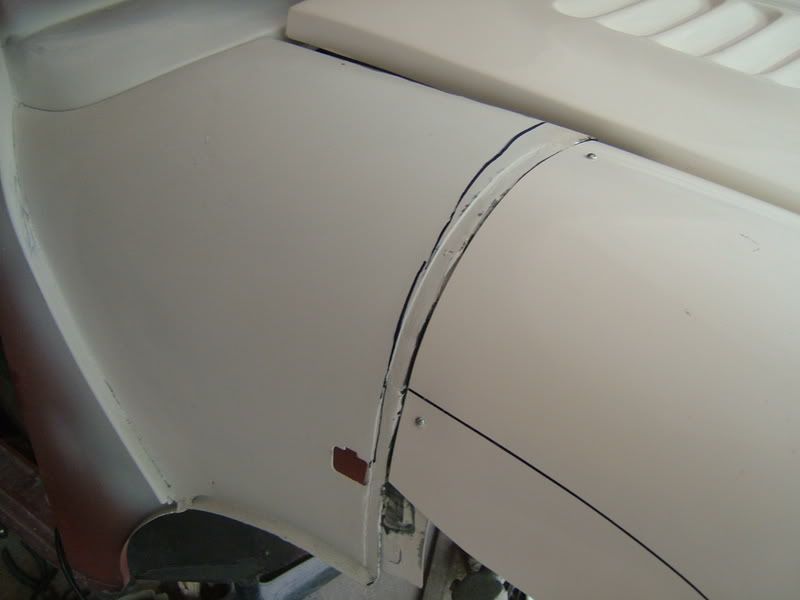

After this I have moved on to sorting the front... as you may know, the rules say i can only have a fibreglass front infront of the wheel hub centres, so where most other competitiors have just kept the steel front I have made a front that joins above the wheel hub centre!
This will be held in place with Dzus fasteners and come away from the car to allow acess to the engine.
The last thing ive done is fit the front arches and start blending them in, the front bumper is just resting in place for the photos but looks great i hope you agree. The arches will also split at the wheel hub centre. Oh and the bonnet has the vents cut out so they actually do summit rather than just look good :mrcool:
Hope you all like it... any questions just ask!
Cheers Chris

Cage looks sweet!
So Does the rest of the car, certainly coming on...
Did you buy that vage or is it custom made ?
#41 01smartc
01smartc
  • 1,412 posts
Posted 12 July 2008 - 11:06 PM
Bought it from custom cages.. its their Mini GPA cage... they do a historic and a miglia cage aswell, top quality stuff!

I'm building mine to run in Mod prod too and haven't really got a straight answer yet on whether you can get away with removing the door bins. Been looking at the GPA cage too but not sure if I trust myself to weld it in!

I'm confused,.. the arches look like they're riveted to the removable section and the rest of the car,.. making it non removable?
I think.... :thumbsup:
** Retro is stupid... you're gonna cut them up the middle yeah?
