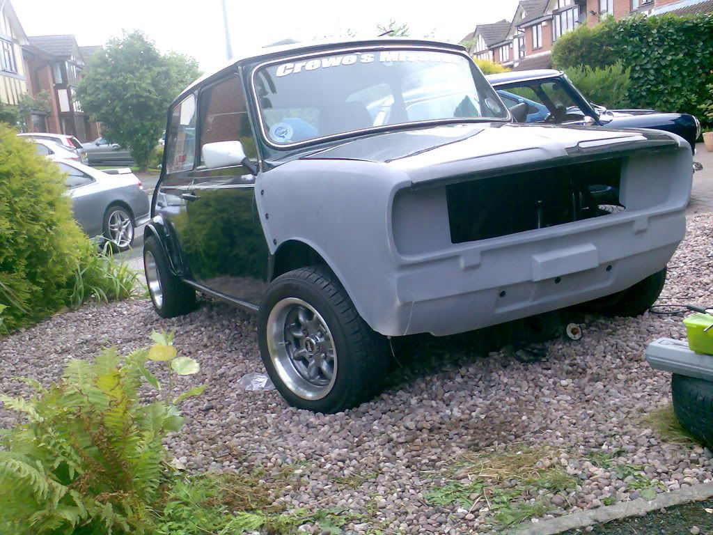

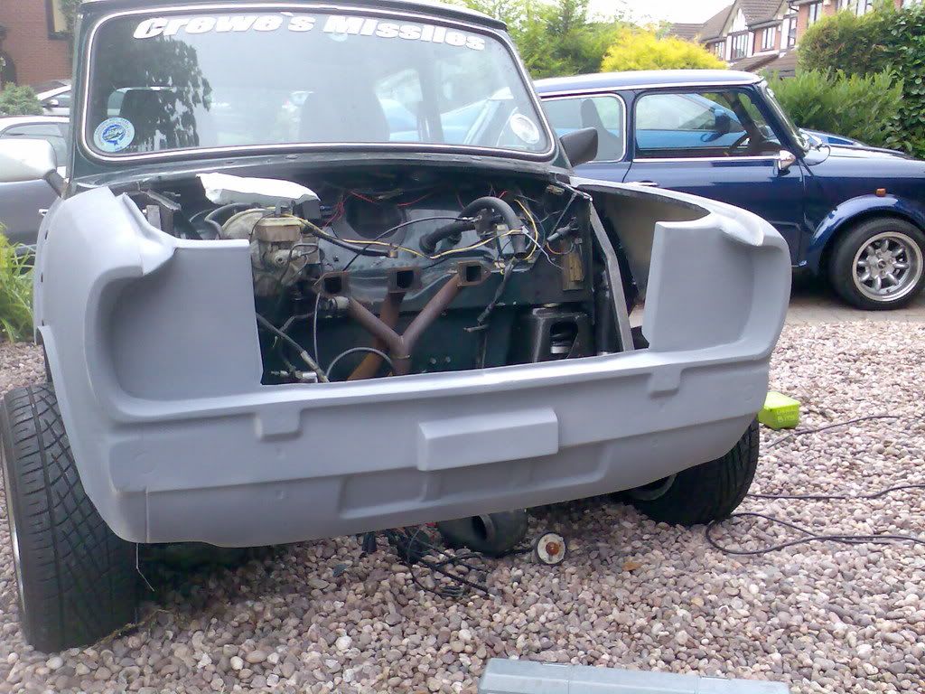

waaahhhhhoooooooooooo, an update! My front end is finally on, and it was really eay, I am suprised at how well it fits, my hat goes off to custom minis.
Here are some pics;
What do you think?
#37 AndrewJ530
AndrewJ530
  • 1,628 posts
  • Location: Middlesbrough
Posted 19 July 2008 - 04:28 PM
Personally ... i don't think the colour scheme works :) lol
Just kidding, looking good man. You gunna keep the same arches?

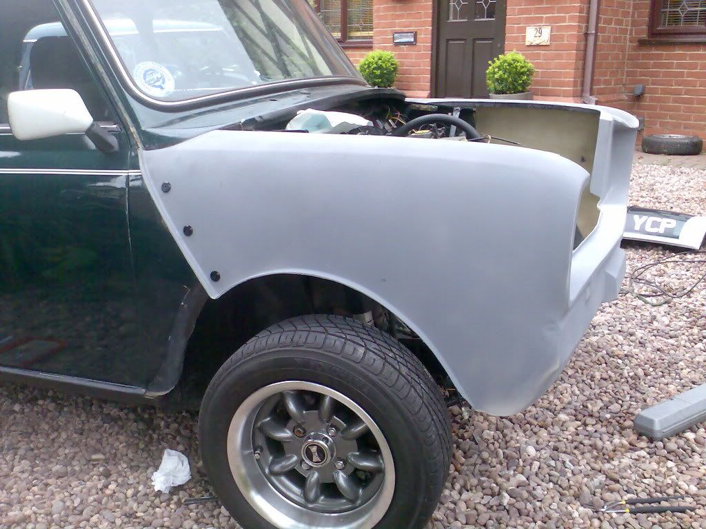

cheers buddy. Well been to crich today so not really got much done to be honest, however I did take my front off to give the tabs that I welded to the a-panels a little hammerite, they had rusted already just being out in the elements over night! Some piccies to follow a little later I suspect! :wub:

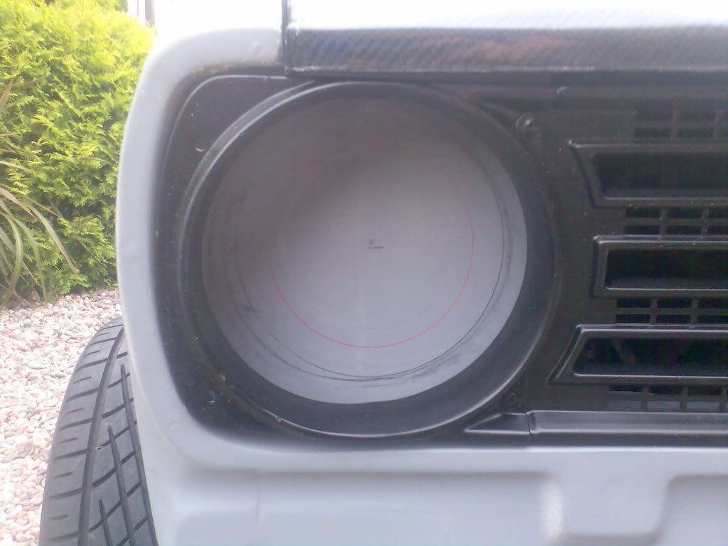

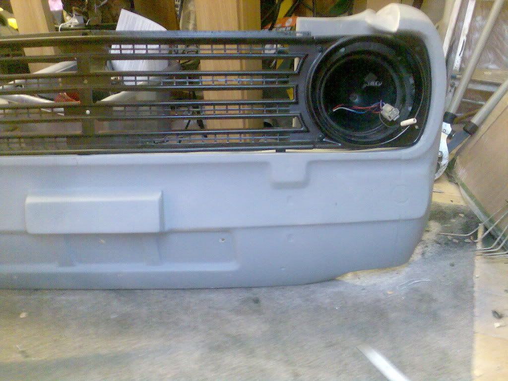

Not updated for ages so here goes again lol,

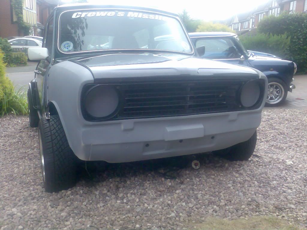

I cut out the gaps in the front so that the grille lips could sit in the front, then I testedthe grille to check the fit;
Looks quite mean I think!

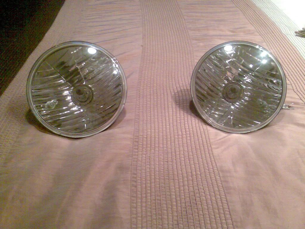

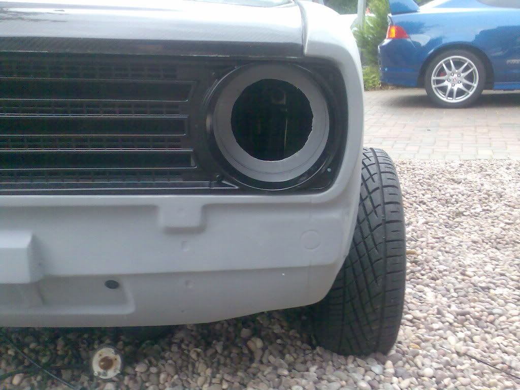

Then I had to tackle the headlights so I began by cutting the hole for the passenger side, deliberately too small so that I could file away what I did not need to make sure the headlight bowl fitted nice and snug, so i started with this;
then this..........
and now the bowl is in (as you can see my workshop is not in the tidiest of condition lol;
Tomorrow's job will be to cut out the other hole for the drivers headlight and then get my free forms lights fitted!
