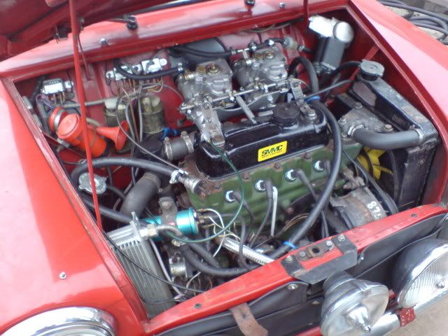

Split webers are the sex, something i plan to use on the next screamer when it gets finished. I think you'll find they derived from the works teams not for the rule against twin chokes, but the rule stating they had to use a standard manifold. The works teams wanted to use a weber, but because they couldnt fit a weber manifold, they 'not so simply' cut one in half and used a std twin SU manifold. The webers themselves had to be adapted, by cutting the flange off and welding one on that ment they matched the bolt pattern of the twin SU manifold.
Power gains are minimal, but i'd imagine - like when you have twin SU's over one bigger SU - the benifits are felt through much better throttle response.
Guessworks, you are in rugby are you not? See if you can get in touch with Southam mini metro centre speak to Rod or Colin, they might be kind enough to let you go down and take a peak at Pete Barkers mini (if its there - which it usually is) They recently converted a set of webers for him works stylee. But also if you're really nice you might be able to persuade Simon who works there to show you one of the many sets of longman spec splits he has.
Barkers car...
