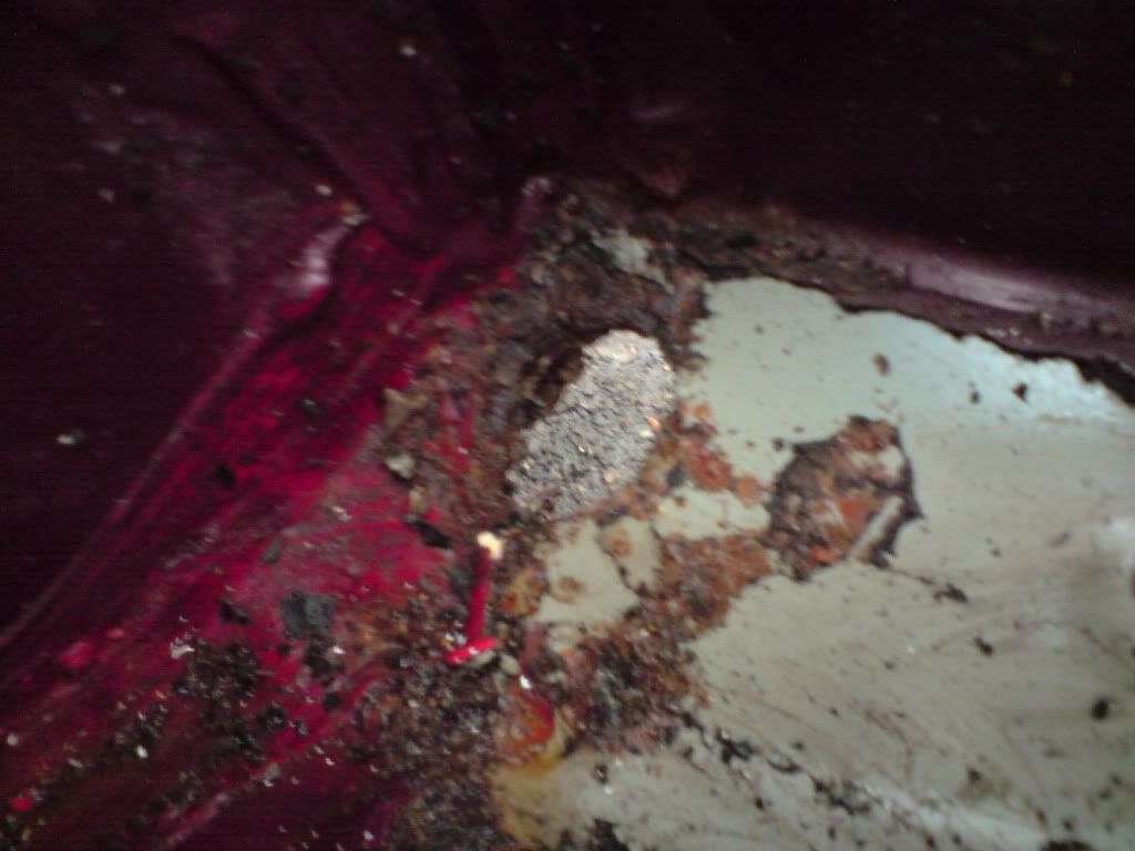

Went out to the mini ear to get some more sound deadening up and i saw abit of floor that looked rusty so i jabbed it with my finger and it went through >_< so now both footwells need some welding
