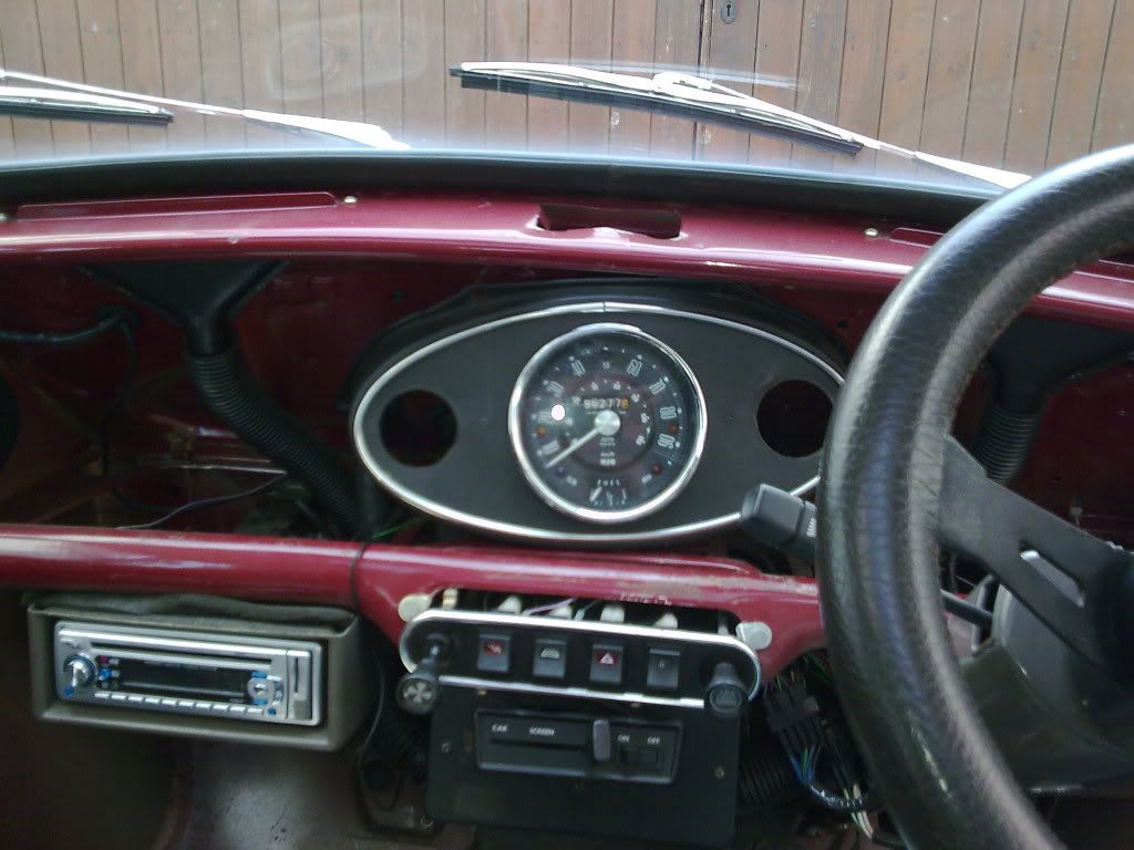

the interior as it is at the minute :dontgetit:

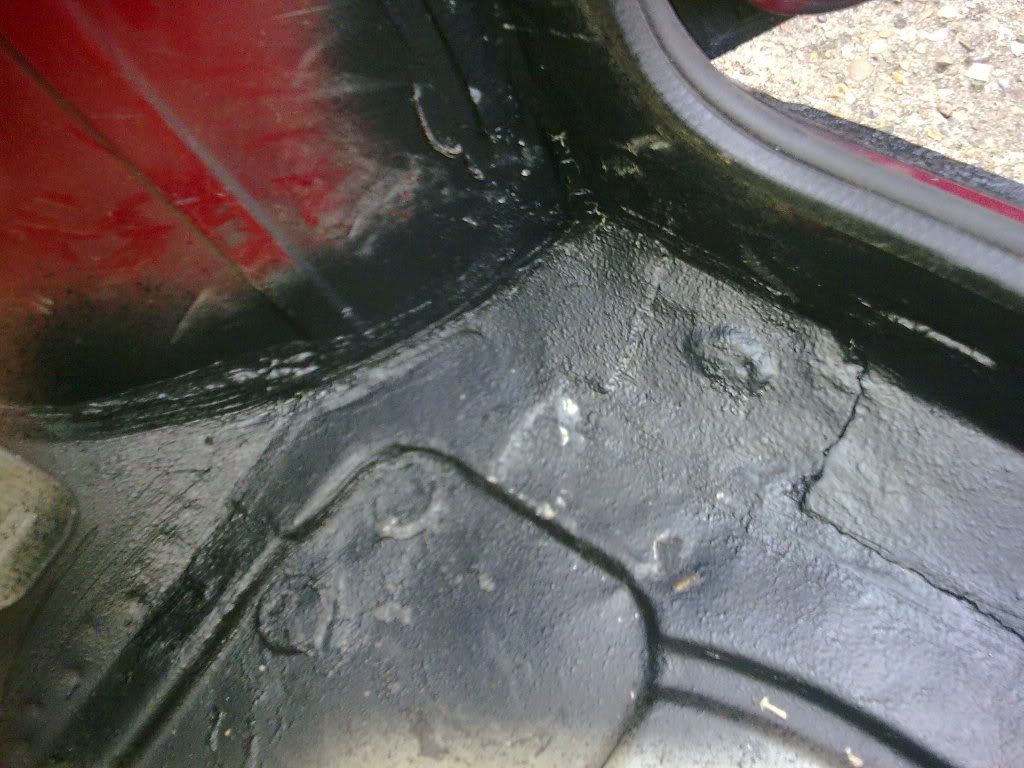

the welding (didnt get it all in the picture haha)

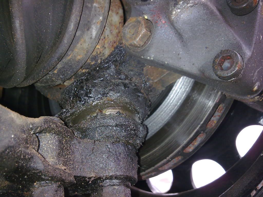

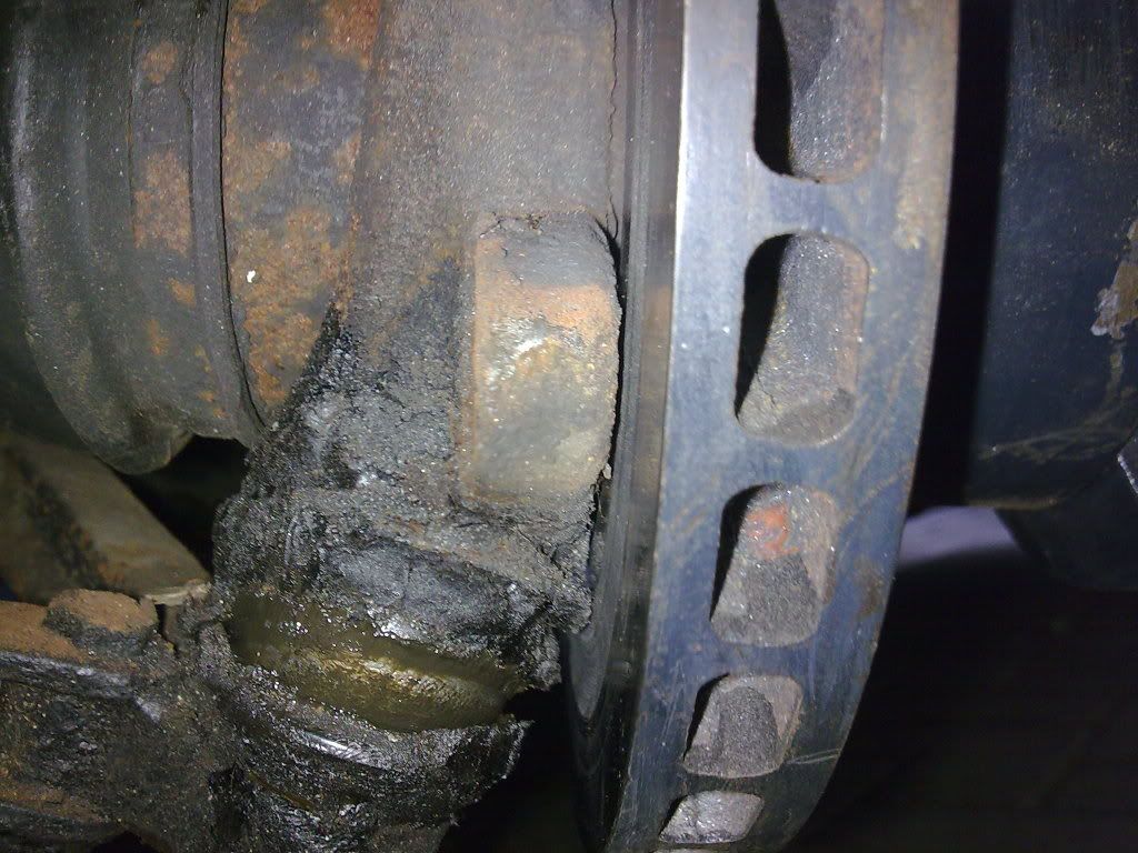

While mucking about i thought i would have a look underneath at the brakes and stuff
Looks like the bolt securing the caliper in place has made a nice gouge in my disc :) ( i think its the bolt didnt get time to look as i was getting shouted at by dad to help him do the garden :)

I know how most of those could be sorted but i dont know what to do about the brakes is there anyway i can space the discs out away from everything??
Luke.

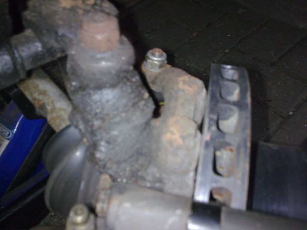

If the disc is catching on the bolt that secures the caliper, cut the end of the bolt off, use a hacksaw and you should be fine.
What did he mean by stains on the water pump, never heard of a car failing it's mot due to a dirty engine.
#641 sweetser
sweetser
  • 3,995 posts
Posted 24 April 2009 - 02:12 PM
Na he said its the track rod end or something like that which is catching the disc :/

Heres the piccy of the brakes
The bit the has done all the damage
How close the caliper securing bolt bit is to the disc
Does that look normal???
(sorry about poor pics )

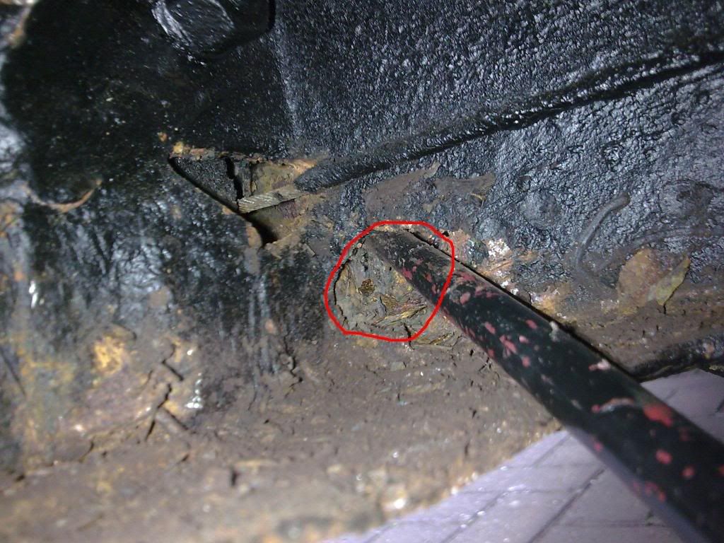

Heres a piccir of the hole in the subby (circled :lol: )
#645 mighty mini jack
mighty mini jack
    Mighty Before a Pint
  • 5,095 posts
Posted 25 April 2009 - 08:38 PM
:lol: Even my subby doesn't have holes!
