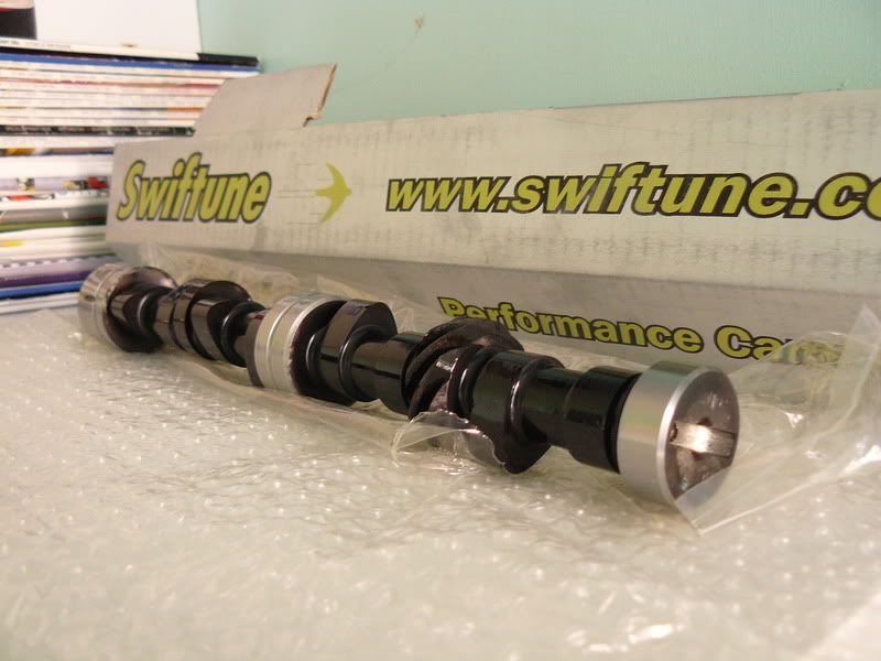

998 a+ pockted
Swiftune SW10
Swiftune Duplex

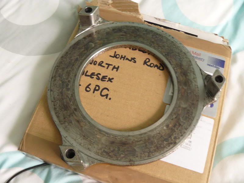

MED Ultralight backplate
MiniSport ultralight Flywheel
Orange Diaphragm

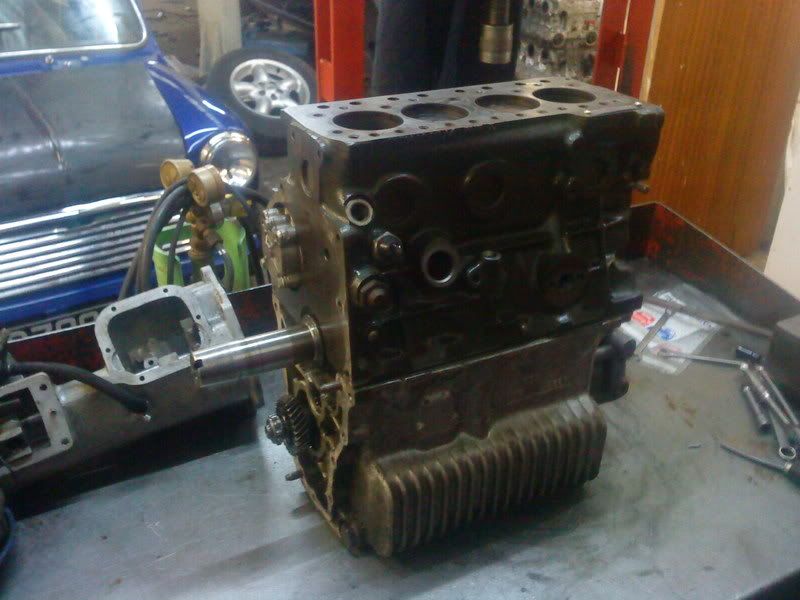

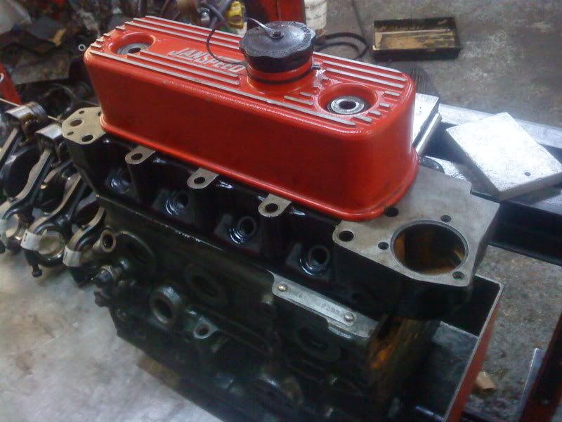

Started stripping it down on Friday at the garage,
When we used the puller to get the flywheel of, I dident expect it to just jump out at a million miles an hour, Ive heard they sometimes come off really quick but dident expect it to be anything like that :shifty:
Doubt ill be using this again for the road mini, it was a real pain in the ar£se on our race mini, lift you foot up even slighty in a gear and it would just stool(even worse when you not running an alternator)!! good help what the paddle clutchs are like..

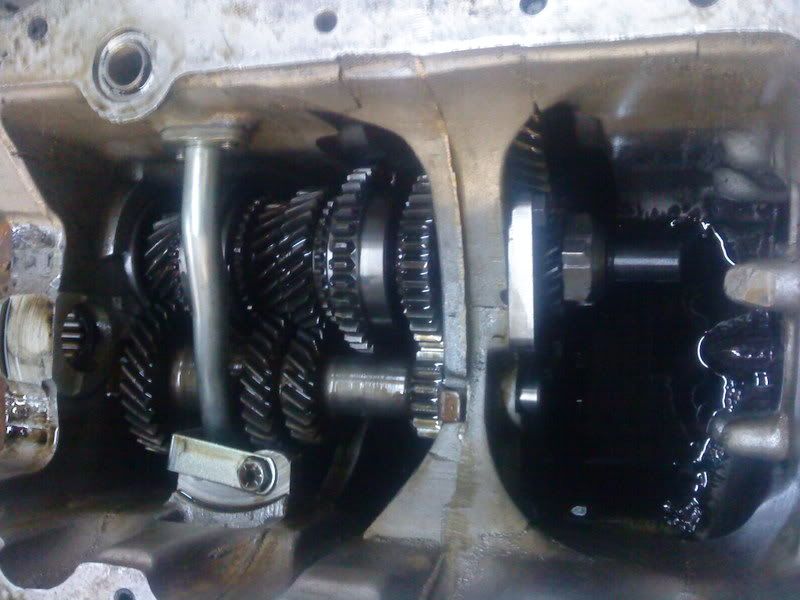

Gearbox was rebuilt back in '07 so its all generally sound in that department.

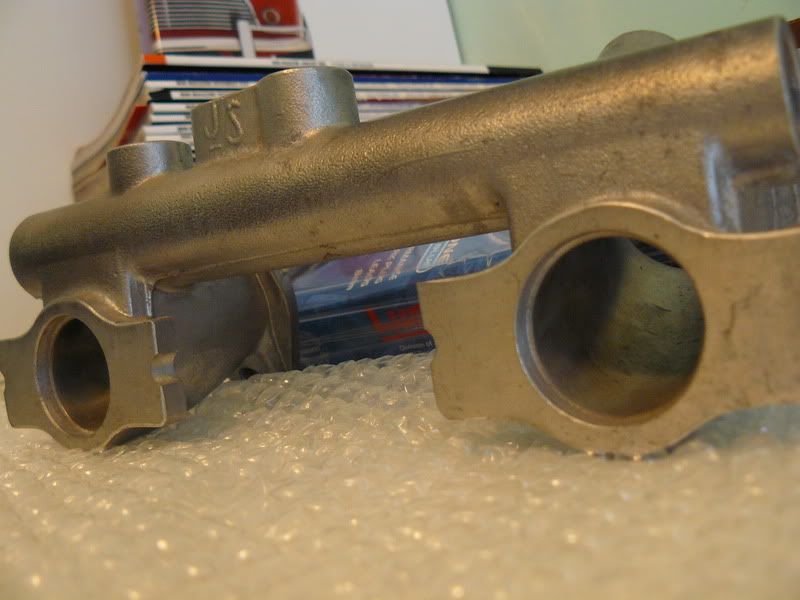

Heres a few of the goodies going in, my bedroom has become a spares department!
SW10
Janspeed Manifold
1.27 rockers
ITG Filter on HS2's

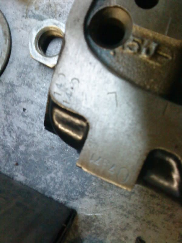

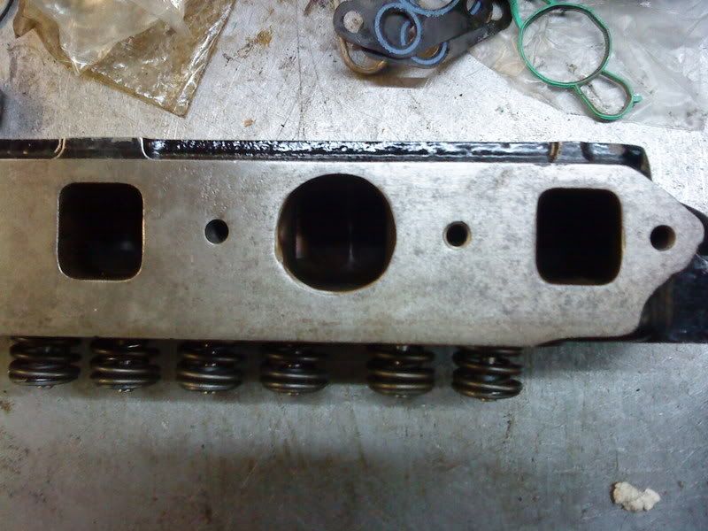

Got the head today, really happy with it for the price I paid, as it would have cost 3x more if i had got S.R.E to do it :)
Bit of an overkill head for a road eng - but why not give it ago?

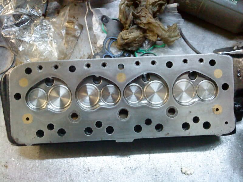

Heres to full spec -

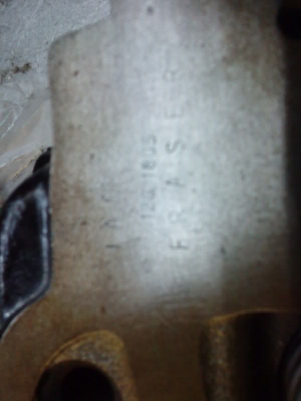

MK3 1805 Cooper S Head
ex Ian Fraiser Se7en
37x31mm
Rimflow Valve's
Full Race Spec
14cc In Head
Sleeved Push Rods
Huge Ports
Bronze Guides
Steel Top Caps
Double Springs
30 degree Seats
Comp should be around 12:5:1
:wub: I'd better get cracking with those pockets with my dremel ;)

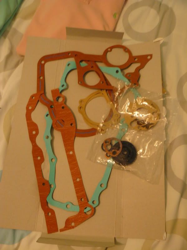

Also brought new gaskets for the engine, was going to get a comp head gasket untill i saw the price, think ill get my old man to pay for that!

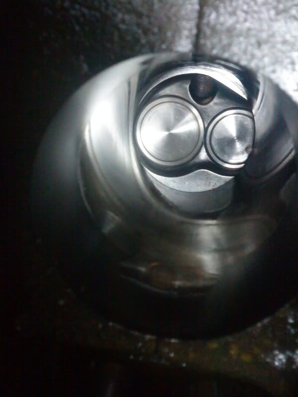

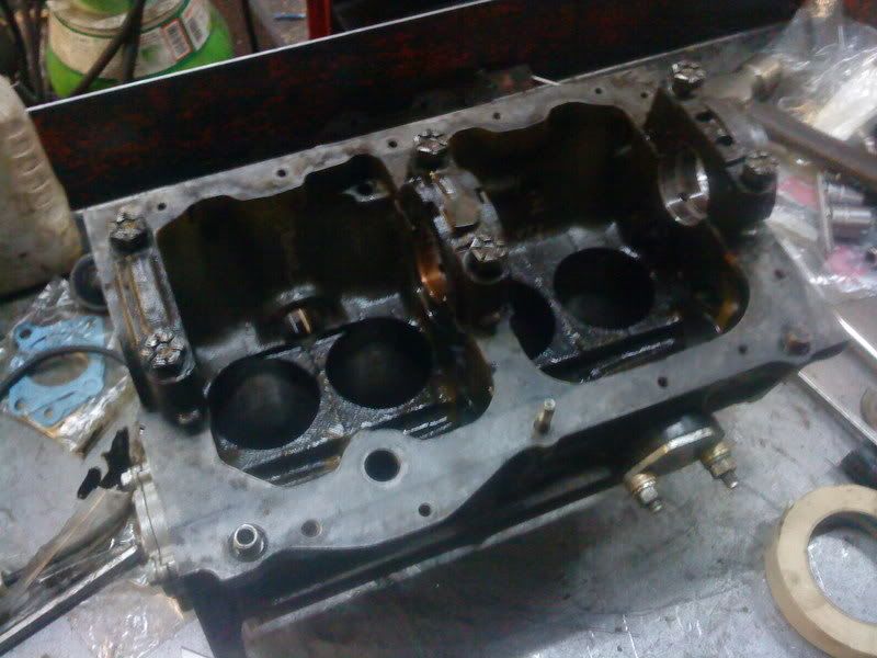

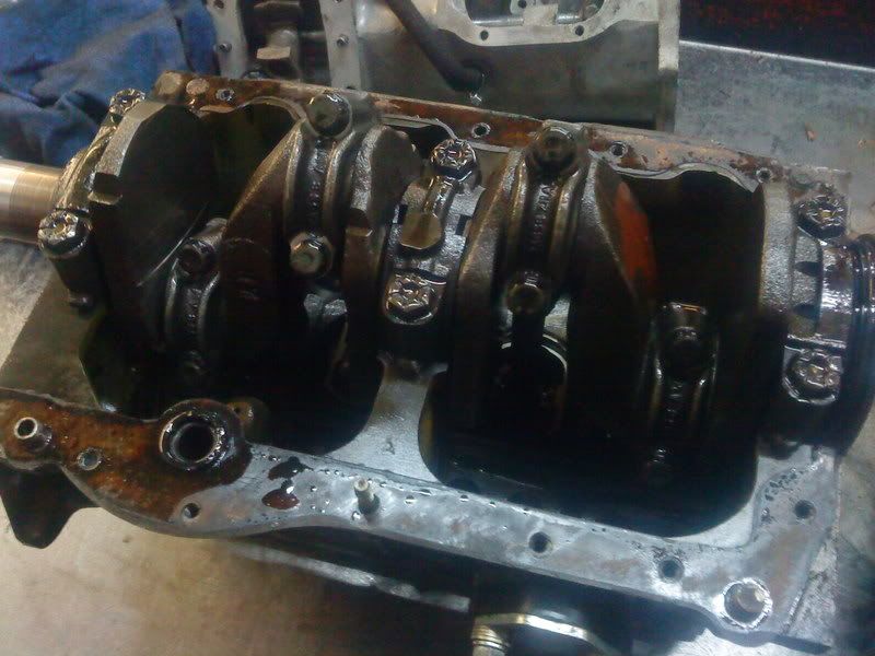

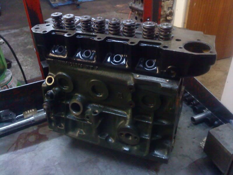

Got a bit more done today, got the crank and rods off, tried it first with a big leaver bar but no hope! So I went stright to the air gun and thankfully they came stright off with no problems :cry:
Place the head on to see how far over the ex valve is :(
I think black/green works well. lol
Hopefully will be starting to pocket the block on tuesday, Soo ill keep you updated! :)

Looking good so far bud. I'd pocket the block on the inlet port sides aswell. Would just free up a bit more space around the valve to let more mixture in. Don't think it should drop the CR ratio much at all.
Already worried about pocketing the block myself so don't really want to do twice the work, The inlet valve is pretty close but I think it will be fine :thumbsup:
Are you going to pocket it yourself?
Yeah I was going to get the machinest to do it while skimming the block.. But with that head and flat top pistons, I think it will high enough as it is :(. If I mess it up then that will teach me. Have been doing my homework on how to do it, but I doubt it will be perfect! :P
