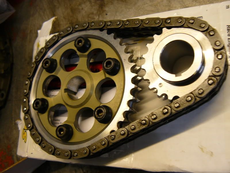

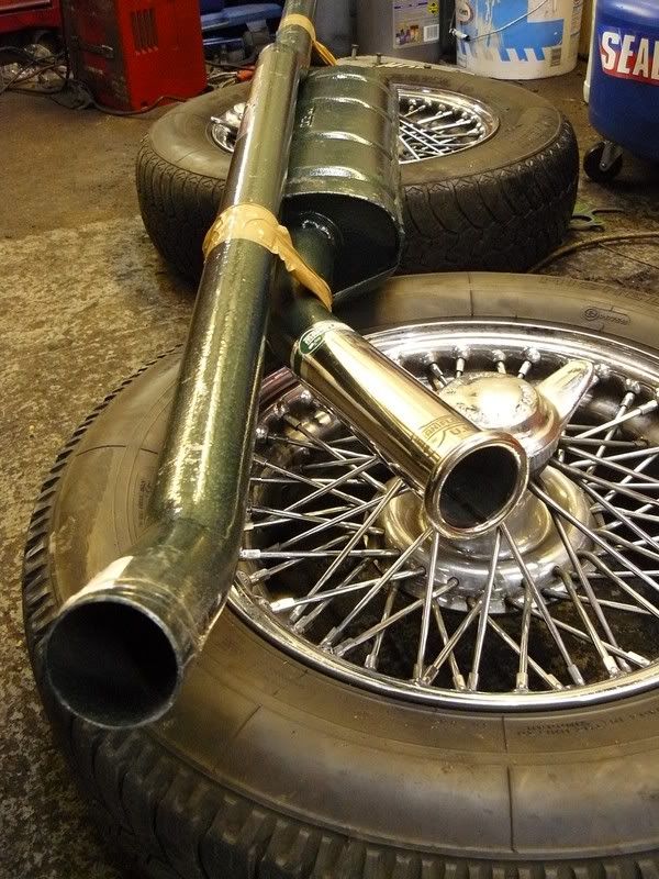

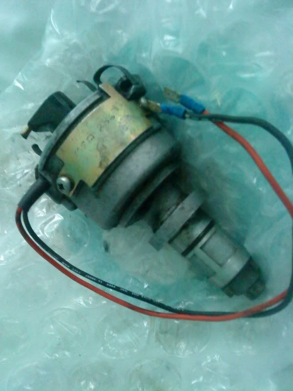

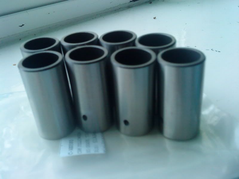

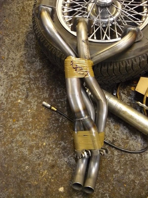

Heres a few piccies anyway, any excuse eh :thumbsup:
MED Race Spec dizzy without vac, fitted with leccy pack, should work well.
Isky-Type lightend followers
Swifty vernier
Maniflow single box + lcb
