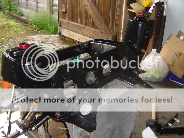

Right well little progress was made yesterday really, just finished stripping down the front subframe again and then finished painting up the hubs and steering arms. Then I remembered I need to grind down the steering arms abit, so will do that and touch the paint up again.

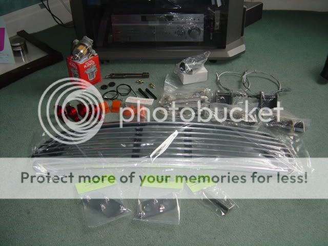

So what did I get today....lots to keep me busy, thats for sure :thumbsup:
-8 Slat Internal Release Grille
-Top Arm Rebuild Kits
-Swivel Hub Rebuild Kits
-Shock Mounts
-Late type Brake Cables
-Pre-Verto Clutch Slave Cylinder
-Pre-Verto Clutch Arm
-4 Straight Grease Nipples
-2 Angled Grease Nipples
-Poly Bump Stops
-Poly Rebound Buffers
-Toggle Switch Extensions
-Boot Cables
-Floor Plugs
-Steering Rack U-bolts
-67mm King Fuel Regulator
-Stainless Latch Plate from Smiffy Bits
-Stainless Bulkhead Blank Plate
-Stainless Bulkhead Plate with Hose Holes
-Red Alloy Rear Trunnions from DSN Classics

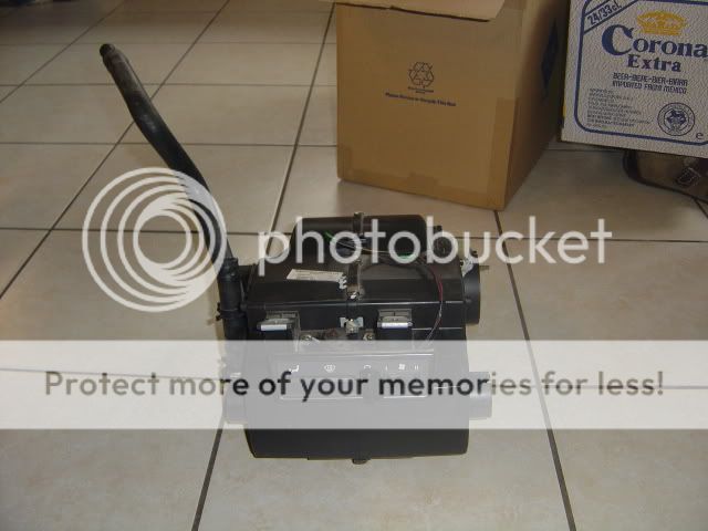

and an MPI Heater :withstupid: Its also got the hoses to accompany it.
Ive still got to get the 7.5" disc shields and fuel pump kit which im phoning Minisport about tomorrow. I'll also be getting a quickrack from Moss as they sell them cheaper than Minisport plus I get a discount there.

#227 analogue_radio
analogue_radio
  • 4,897 posts
Posted 09 May 2010 - 08:20 PM
Nice Chris!
I'm on the look out for a 2 speed heater, how much did that cost you? (if you dont mind me asking)

Posted 09 May 2010 - 08:30 PM
Nice Chris!
I got it for £100, I know there was one on ebay for £95 incl postage but I'd rather pay the extra and be able to see the condition before buying plus with the hoses I thought it was quite a steal really. It really does look like new :lol:

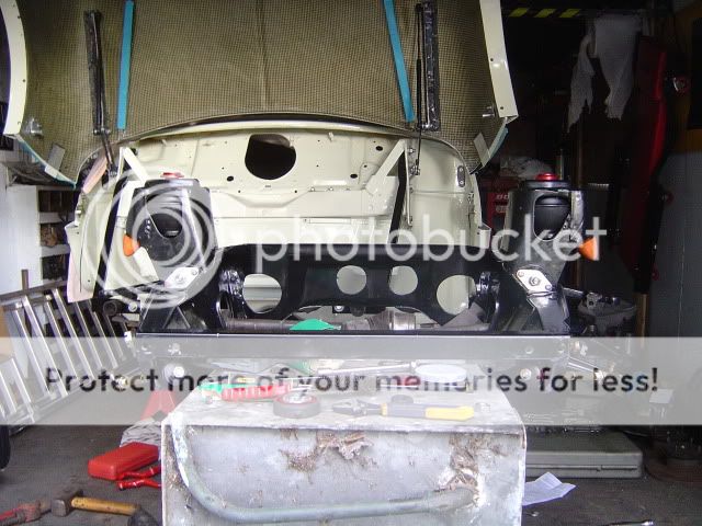

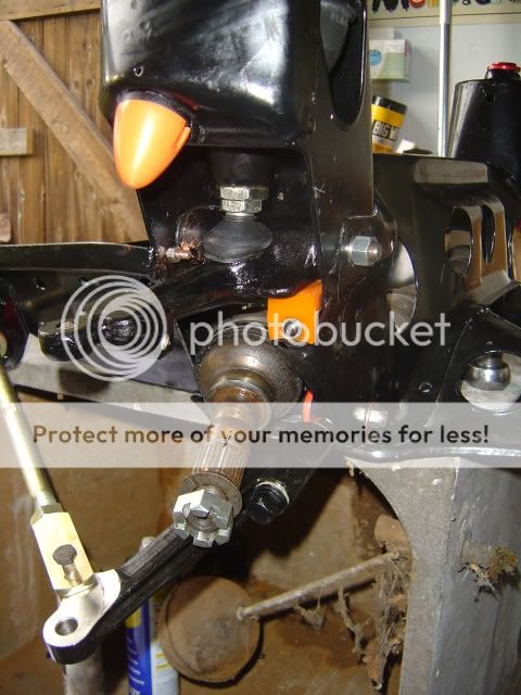

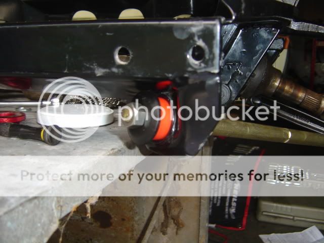

Overview of the works complete
Side view
Tie Bars connected up
The hubs reconditioned and ready to go on
Need to consider what im going to do regards getting the engine in because when I connect up the hubs with the drive shafts its going to restrict the pot joints, anyone's thoughts on this?
Alright mate, when you come to put the engine in, undo the top ball joint on one of the hubs, and then just eeease the whole thing away from the car a bit, should give you enough room to jiggle the engine into place :D
At the time of putting mine in, i didn't know this, and just got the shafts in the joints with brute force and ignorance lol, so yours shouldn't be too bad, good luck!

Thanks Paul much appreciated.
Been working on the engine for the past couple of weeks, just parts that I need that keep slowing me down as I can't do anything till I get it! The engine is now painted, together and the clutch has been converted to a pre-verto with a pre-engaged starter which involved changing the ring gear. So now the engine is ready to sit in the subframe and then rest of it can be built up and attached to the mini!
The pot joints/hubs aren't an issue with mine Paul as its just being built up from scratch, so the engine and driveshafts will be attached before the hubs are attached.
