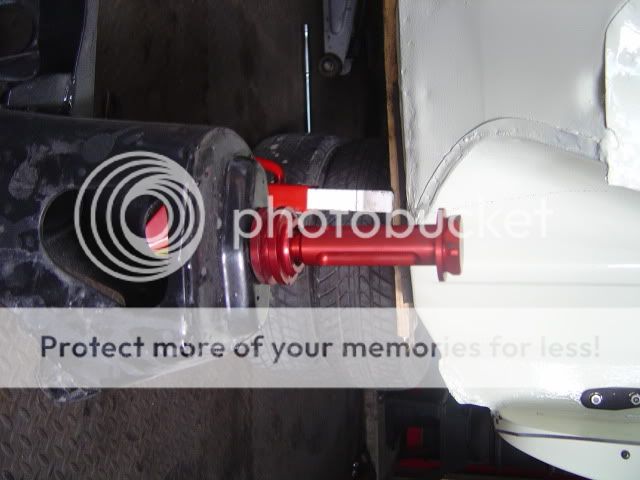

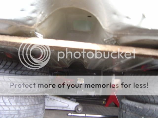

Well on Sunday we didnt get a deal done as we were getting my dads car ready for the MOT but when we were finished with that we dropped the front subframe and got the shell up on axles. The plan is to build up the front subframe seperately and then simply just bolt in, would be stupid not to with the flip front really.
Look at the underneath! (Sorry not the best picture)

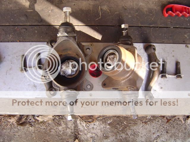

Im going to be reusing the existing hubs so ive given them a good wire brush down today, the bolts holding the steering arms on were a right *woman of ill repute* to undo!

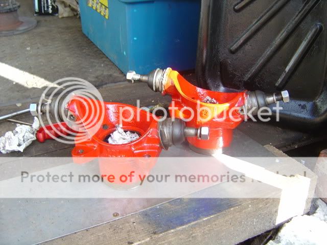

Im only part way through painting red them at the moment, waiting for them to dry to do the otherside is very tedious I found.

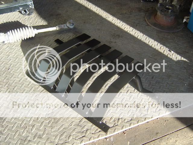

I also wire brushed my sump guard which I let get rusty in my old mini in a puddle of water on the back seat

one word of advice, the hubs you're using, if they are from an 80's car, i found that the steering arms pressed against my S disc setup and put a groove in my disc... you may have to grind them slightly, where they bulge where the bolts go though into the top of the hub... aparently its because they aren't 'S' ones.... I only had this problem on one side though.... it was odd... just check first!!

sump guard looks swish!
Ed
Found this aswell! something to check as it puts a weak point into the disc and could crack.
