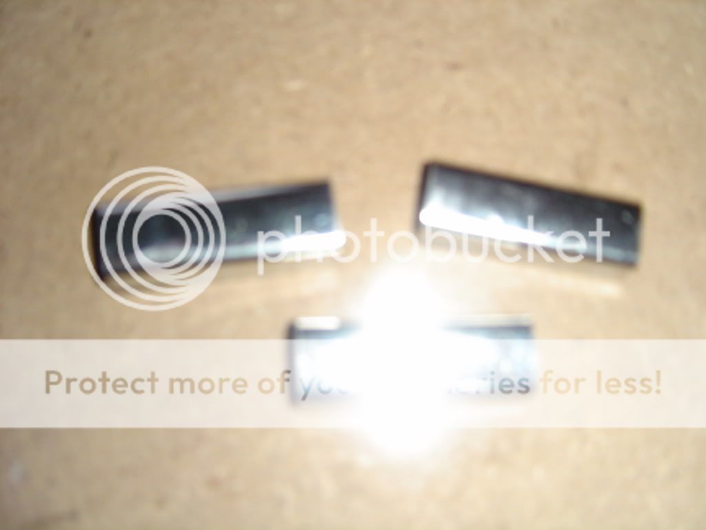

Got a few chrome finishers for the roof trim as there hard to get hold of

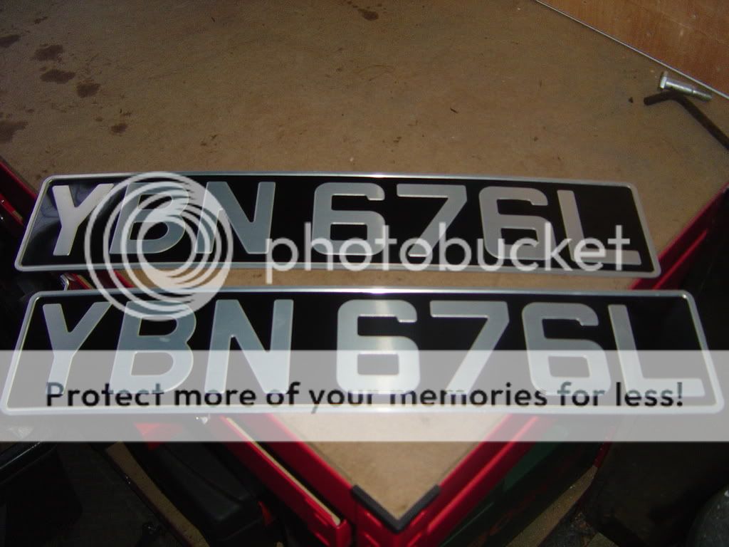

New numberplates for the mini :thumbsup:

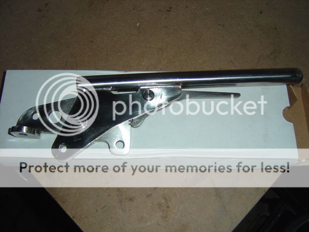

A genuine Trigger Handbrake :thumbsup: ;)

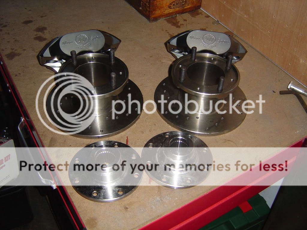

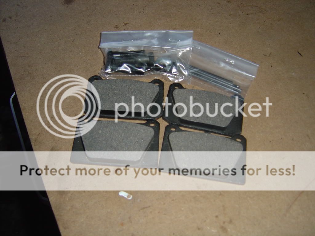

BRAND NEW 7.5" MINISPORT 4 POT CALLIPERS WITH DRILLED DISCS!!!!!!!!!!
Also got a new front subby (shotblasted and powdercoated) but forgot to get a pic. Also got new brake pipes and polybush set coming from minisport as they werent in stock. Fair to say i got a good discount for the amount i spent there :thumbsup: Cheers Mark

How much was the trigger handbrake?

£49 which is a lot but i had my mind set on it when i got the mini over 2 years ago so it had to be done :thumbsup:

Oooo nice, weres that from? there like £70 direct from them i think

I know at one point they were £50 direct when i was first looking at them. It is from huddersfield spares.

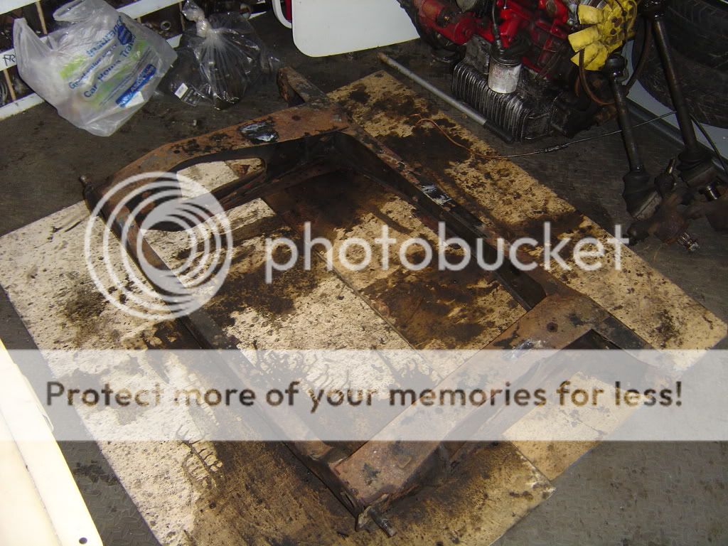

The engine is now apart from the old subframe and we've near enough stripped the old subframe of all the bits we needed. The engine was blooming heavy and we were working near the shelves so moved the subframe back, good job we did or we wouldnt have noticed the bottom engine steady, that would have been awkward if we'd found out mid lift :D

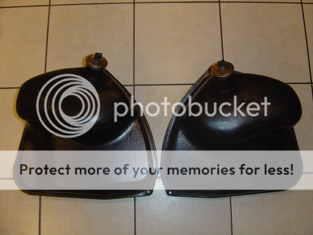

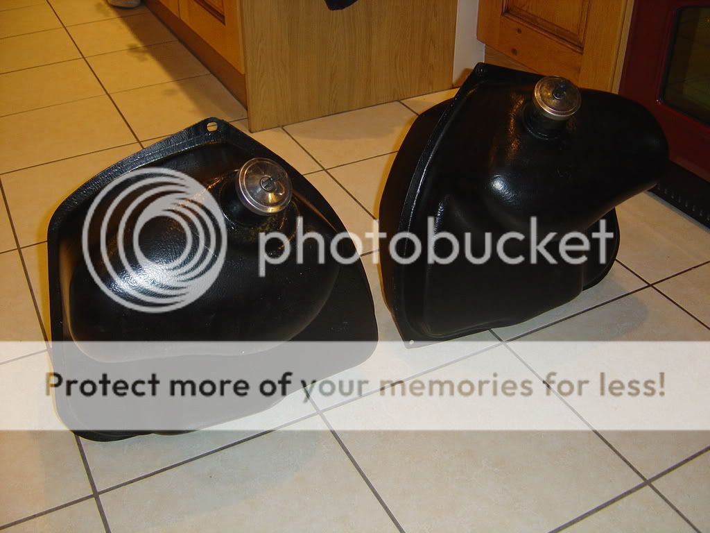

Tanks placed in, looking good ;)

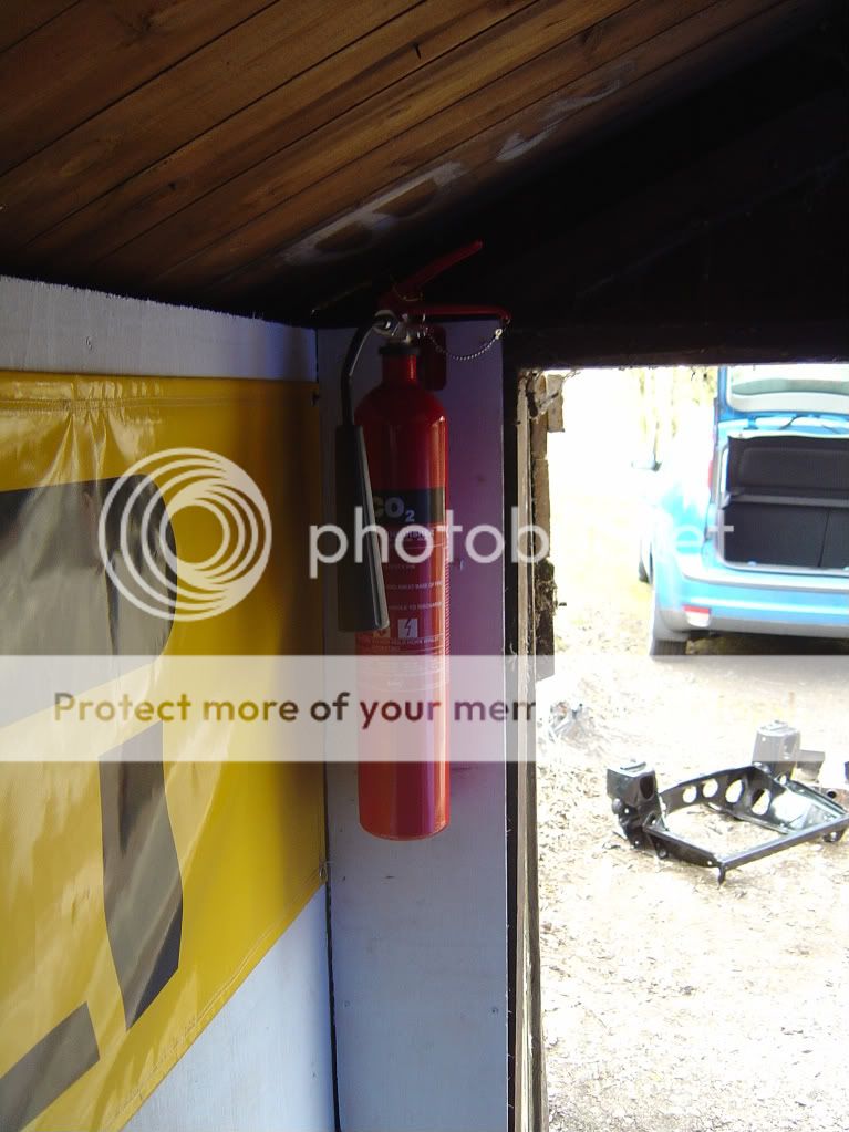

Acquired another fire extinguisher from work :P

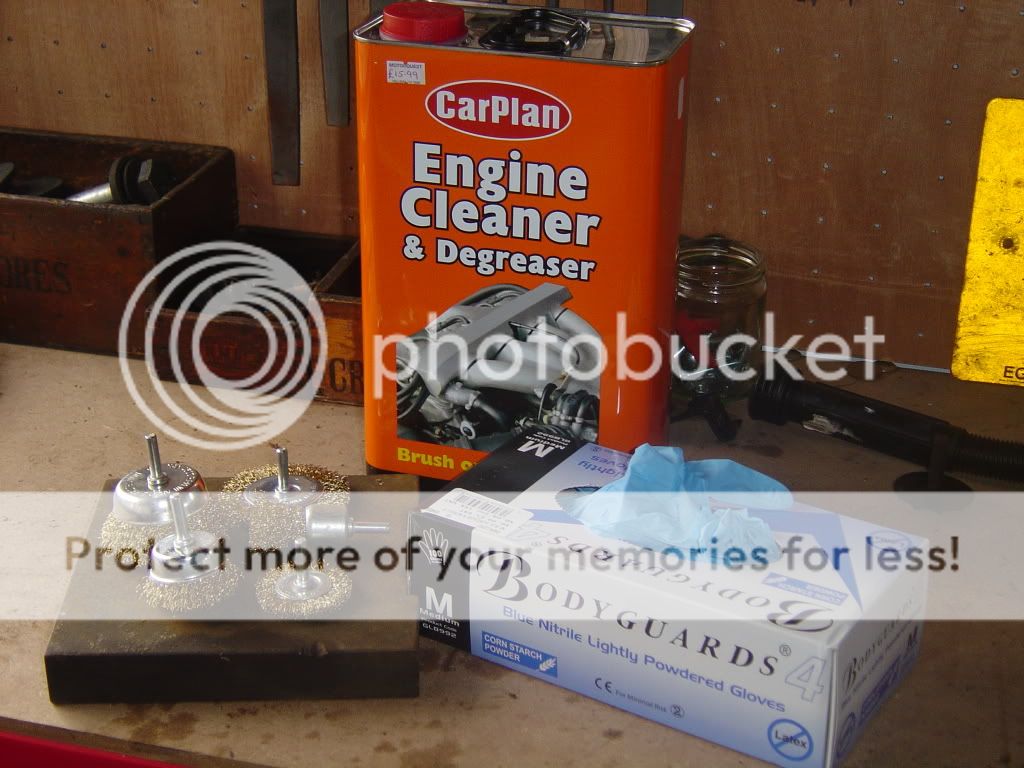

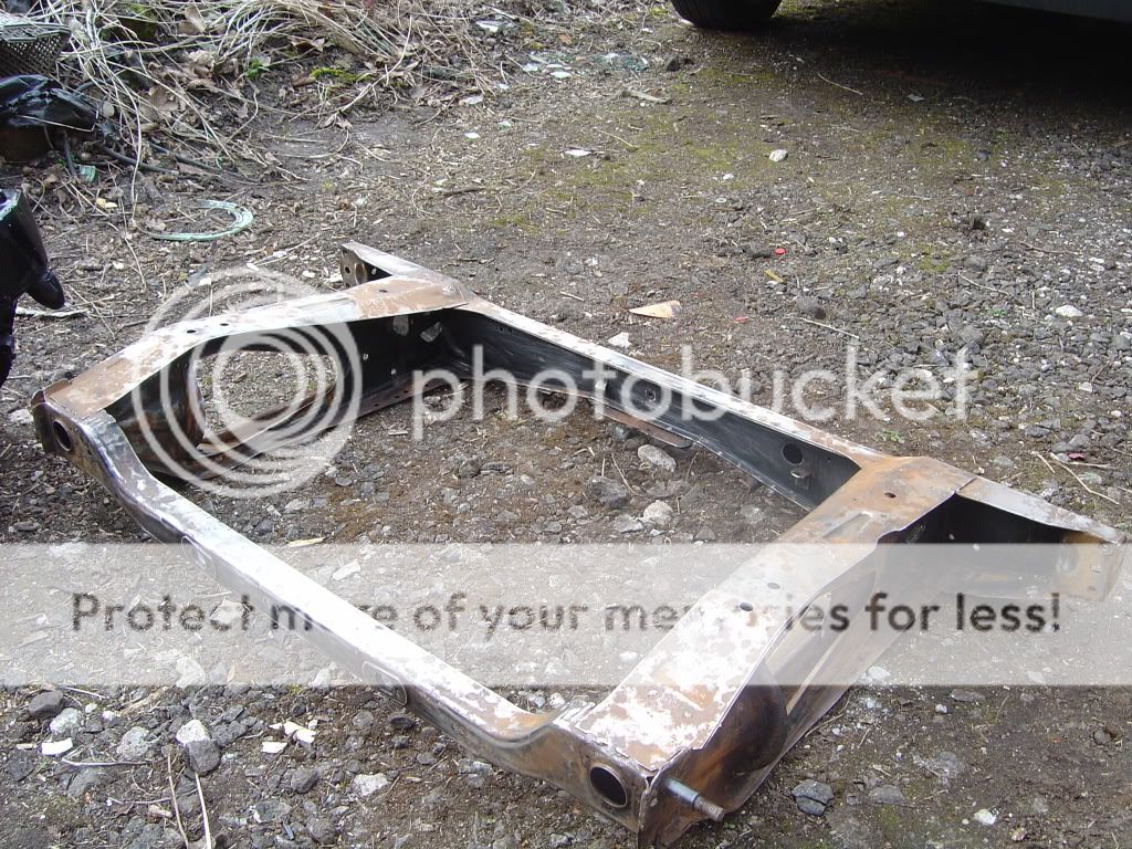

Now I started with refurbishing the rear subby by first stripping it and then applying gunk everywhere possible on it which helped get all crap off
Then i wire brushed it which took forvever but was well worth the effort, mainly used wire brush attachments on a drill
And finally sanded it down to clean it all up and get most of it back to bare metal
Now i need to get it covered in rust bullet and then clean up all the suspension components and powder coat them red :) will look ace i think, thoughts?

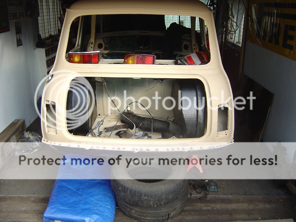

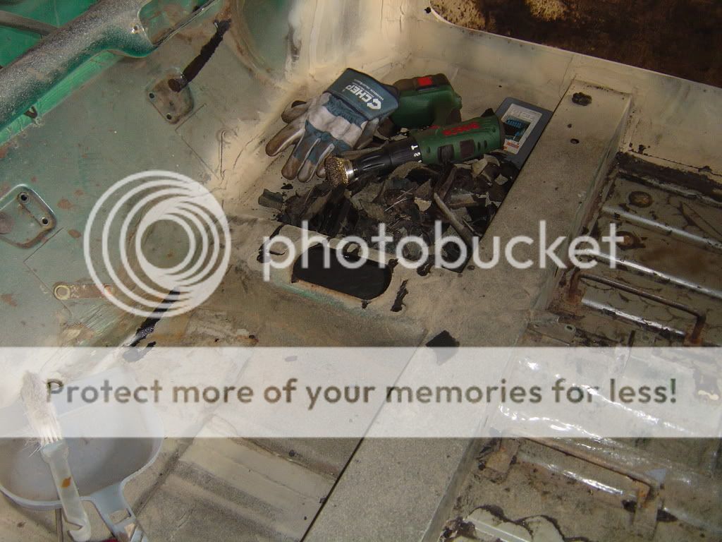

Got bored another weekend and after a few bad reports on the bitumen/sound deadening on the floor that they hold water and weighs a lot etc. I decided to chip away at it and get rid in which i will use another material in place of it when I get round to it.
Finished all the floor since then but still need to do the bit on the back bench and then I will scrape away at the bits that couldnt be chipped off, in which what i started doing was brushing on gunk then get a scraper and go over the floor panels, much easier than wire brushing.
So at the weekend jobs are finish sound deadening and then strip off POR15 which I not looking forward to but has to be done none the less :)
Thats it for now, feedback please :thumbsup:
