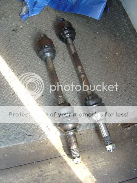

Although I have managed to partially strip down one of the drive shafts, clean all the components up and replace the the inner gaiter. I have also stripped down the other one but I needed an outer gaiter (which I now have) as I managed to split whilst stripping down, so thats the first thing im going to do tomorrow.

Task for today was finally get the drive shafts sorted, one has already been done earlier but we need to do the other, went swimmingly with changing both inner and outer gaiters, wack a fair amount of moly grease in and cable tie them tight job done :)
So I thought we had done them, but then we tried to put the hub nut on them both just so there together and we dont loose them, one goes on fine but the other doesnt :( Turns out the thread has expanded like someone had turned a hammer to it, but me and my dad didnt notice this when taking them off first time round, most likely because we were using a breaker bar and didnt feel resistance. Anyway my dad had a go filing the thread down a bit to see if it would give us some leanway but it didnt work. So now I need a new CV joint and outer gaiter :) but Moss arent open till Monday now so im going to have to wait.
Bit of a pain but if needs must. Tomorrow I may have a look at cleaning the engine and giving the rear subframe another sand down as it had got surface rust on it again. Plan after that is the possibly galvanize the rear subframe through a mate my neighbour knows.

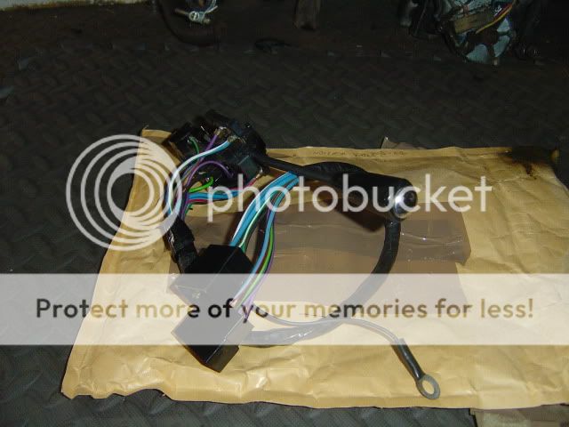

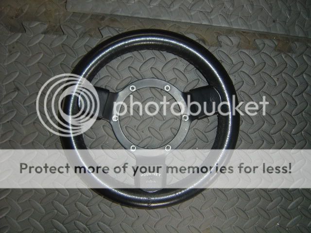

Well start off with a couple pics of the steering wheel and indicator stalk I mentioned earlier in the thread
I got the indicator with the chrome end off ebay, all the reproductions now just have a black plastic end, I got it for £15 posted which I thought was a bargin compared to £40 for a reproduction, looks like new old stock as well ;)

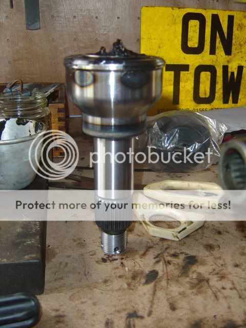

Got my CV Joint and outer gaiter from Moss today, had them in stock when I phoned up so they got put to the side for me. Can usually get a part for you in couple of days if needs be as well, very good company to use :dontgetit:
New CV Joint (packed with molygrease on top I put in)
Put that on, then forgot I didnt put the gaiter on before hand, tried to get the CV joint off and it wouldnt budge (obviously well made lol) after pouring with sweat for half hour in a boiling garage trying to get it off I decided to attack the other end where I had already put a new gaiter :) carefully removing the cable ties it came off much easier and I put the other gaiter on and put it all back together again. So after a fair few hick-ups with gaiters and CV Joints the drive shafts are done!!!!!!!! Glad thats all done, plan on painting the actual shafts red when I get round to painting items up, so they will look nice :thumbsup:
Guess which one has the new CV Joint lol
