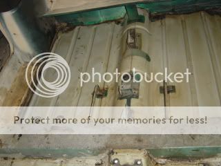

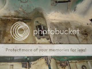

During the week instead of going to the gym after work because it was so hot and it had a metal cladded roof and wall, I went down to the garage instead for a couple of hours wednesday and thursday to finish off the stripping the floor of the bitumen and make it smooth using gunk to get all the little bits off, end result was this
I was pretty pleased with the result as its like new underneath!

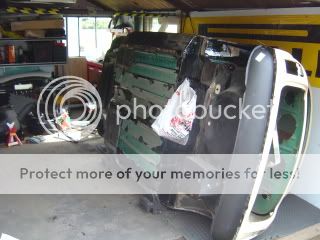

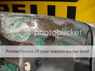

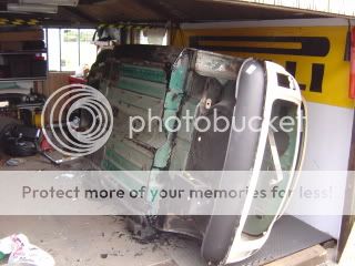

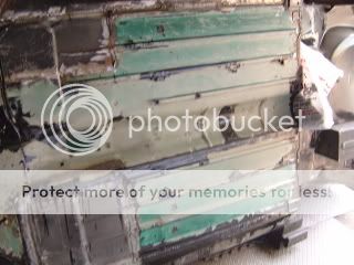

Today we wanted to start stripping the underneath of the POR15 (sorry britaxcooper!!!!) because the bodyshop said they've used it on a few cars (including their own) and after a while it webs and rusts underneath, so i wasnt going to run the risk on this mint shell!

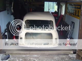

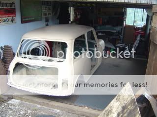

First cleared underneath the axlestands all the stuff we stored there and then removed the axlestands from underneath
Then we moved the shell to one side of the garage

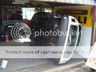

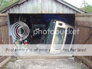

And then we flipped it, putting more foam pads where it was going to roll on to
Then we (i whilst dad put up the stickers) proceeded with stripping the POR15, it came off like paper! I just used my hands and picked most of it off, showing it would not have lasted if it was put to road use! Ths is what i managed to do with just my hands
The other bits werent as easy and required a scraper but this is where we ended today
And when we packed up for the day, I found it quite funny with the shell being on its side

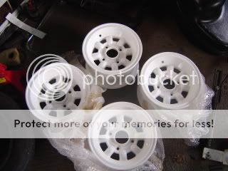

Picked the GB's up from Gumball, nice chap to say the least, have no worries dealing with him you ever come across him in the future
Well made up with the GB's, they look gorgeous! Had a little play with the callipers and disks in them later and there is a nice between the rim and calliper which is nice
Quick pic of the alloys as promised

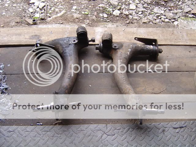

Besides the POR15 all ive done is stripped down my radius arms, but we had fun with getting the hub nut off, as nor me or my dad realised the left hand one had a left hand thread, but we did manage to turn it all the way round with our shear strength resulting in a nut with no thread (must get a pic of it), its perfectly smooth. Reading the haynes manual after was not fun reading

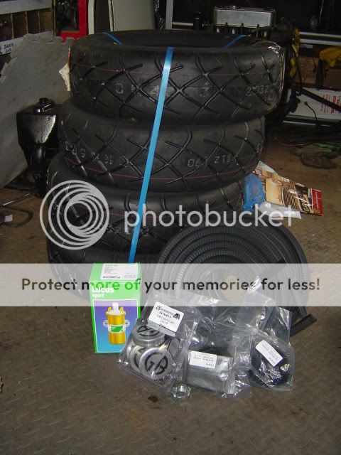

Bought some stuff at the show also, which is my last splurge since I got the bad news
Items bought were;
x4 032R tyres - £160 (bargin i reckon)
Set of reproduction GB centre caps - £15
Door Seals - £17 pair
Nut for left hand radius arm (for the mistake above obviously
Inner CV Boots - £5 pair
Lucas Sports Coil - £14.50
Wood&Pickett Headlight Rims (planned on getting them for agers, there the ones which were used on their limited editions) - £35 (pricey though because only they produce them)

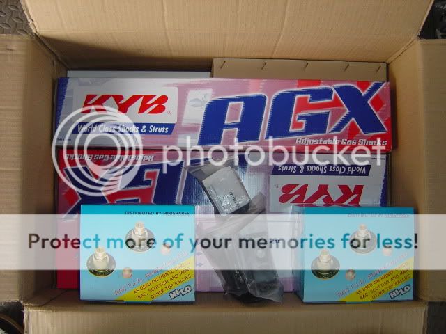

Also my suspension came from the TMF+ group buy a couple weeks back now
