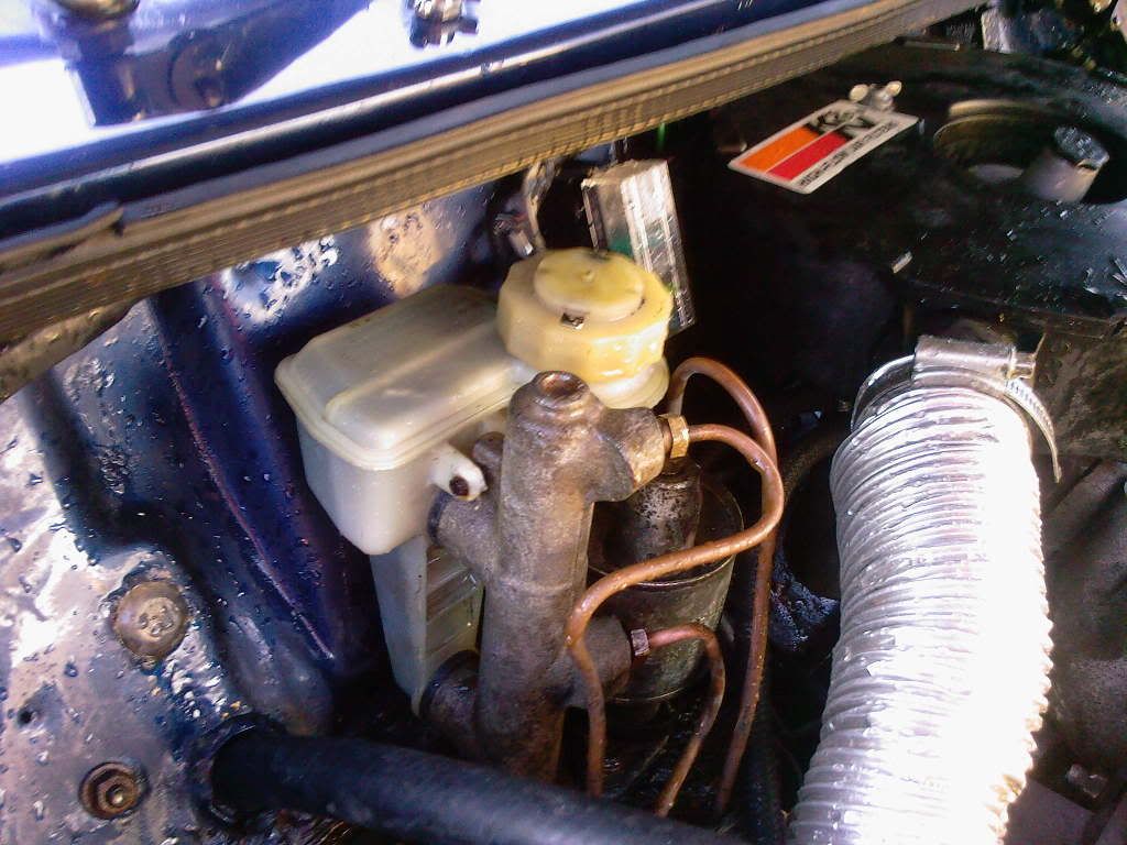

today has been very busy firstly i remove the master cylinder as it ws full of grime and genral crap from however many years of neglect
so removed the washer tank undo the pipes then disconneted the split pin which was a real farse had to get a friend to pull it out as a 6ft8 fram struggles in tight spaces lol
removed and found which what i can only describe as the contents of a smokers lungs black tar like snotty slime
so syphoned the fluid and then removed and looked at seals where all fine so i filled it with brake fluid and made with the shakin
then fluid drained out then repeated 4 times then got an air line and blew all the crap out and then another or luck
i then cleaned the ouside of the cylider with wd40 and made it look pretty and new i then cleaned the bulk head where it sit and put some instant gasket down bolted in place reconneted every thing fitted a new split pin and then filled with fluid

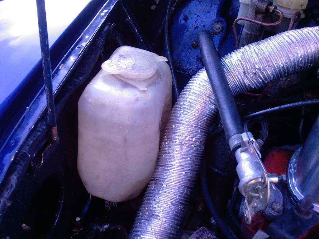

i then atempted to clean the washer tank which is eaiser said than done the majority of the crap is gone but the slime wont budge so a job for my wheel brush when i can be bothered
so refitted the bottle, i then lubricated the carb linkaged and i then did my k&n service trick you start the car and rev the engine whilst spraying wd into the air box this cleaned the filter and oils it, cleans inside the carb and the manifold and takes some of the crap off the valve seat and plugs

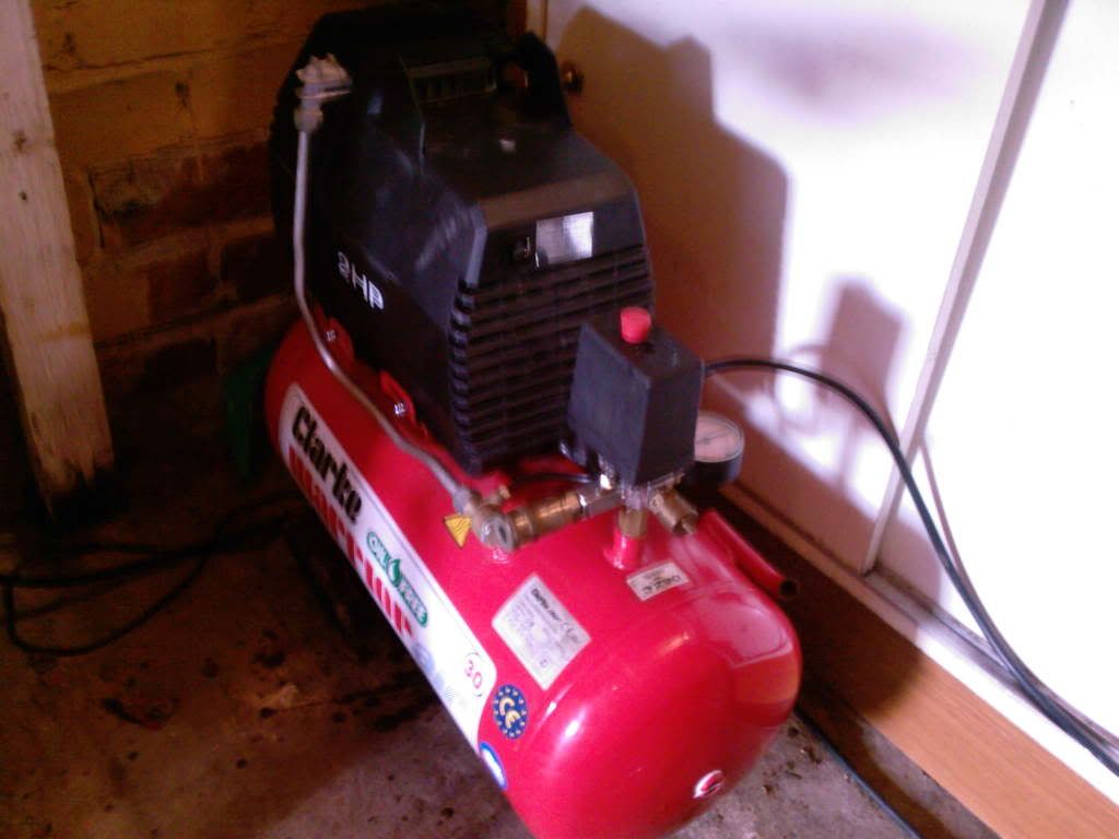

so i then went to take my air compressor to my best friend alan at woodfeild garage my old boss (and adopted father)
i had fitted a new pressure switch but that was it the rest was missing after alan made me a new link pipe, he made me a blanking plug, gave me a air coupling and a ball valve cleanned out all the crap rewired it and tested it (it works :crazy:)
so had a play with it and then went to by a safty valve and a pressure gauge i went to an air compressor company near st marys college blackburn and said i need a safty shut off valve he has a look and said none in ill need to order one will be £13 so i was prepared to give up i said ok then and went to drive off but for some reason i went back in and took the air compressor with me he looked at it and then walked the opporsite direction he returned 2 mins later with a safety valve and a pressure gauge he told me where to fit them i asked how much he said nothing u can have them for free from scrap parts bit anyway :crazy: :P :P
so i ran before he could stop me went to my garge and hooked up the freebies and to my joy it works :P reaches 120psi 8 bar cuts out when it drops to 6bar 100 psi the motorstarts again :P
so all in all my new 2bhp air compressor cost me £18 heheheh
lol hope you enjoy the update

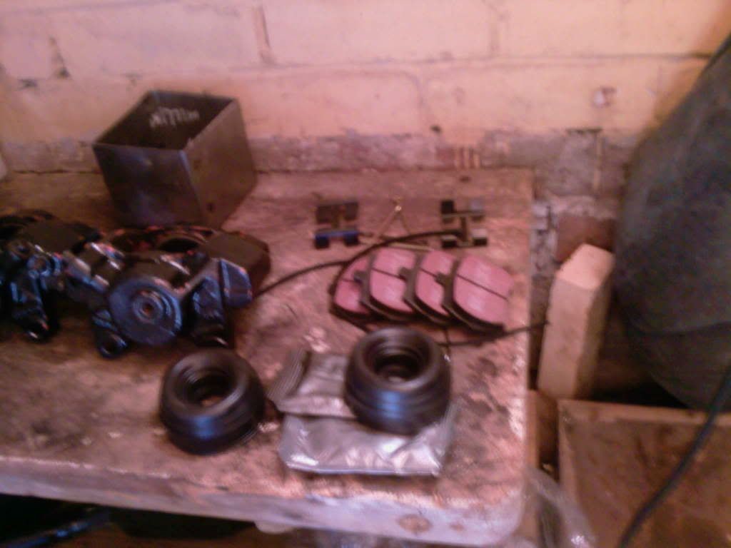

so had a very productive days got the new calipers on so time for pics of the calipers with the new pistons and seals
