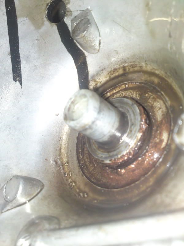

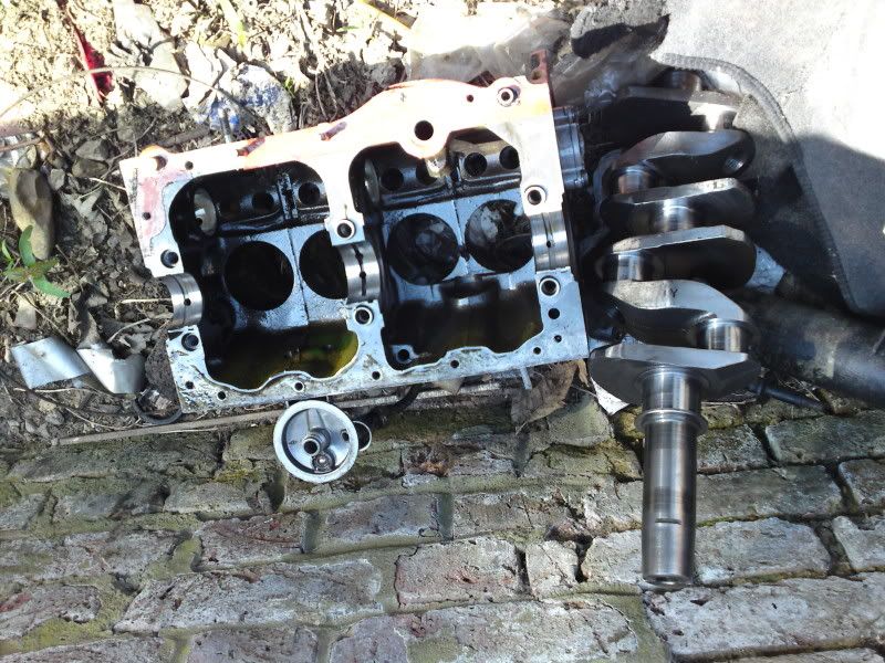

So what i think caused it to basicly blow up, consistent wrong grades of oil, not really run in as it should have been, thrashing it about to much around town at huge revs, doing 105mph at huge revs isent a good idea to. The release bearing and pivot pin where really worn aswell (see pictures) so wasent helping matters on the clutch side.

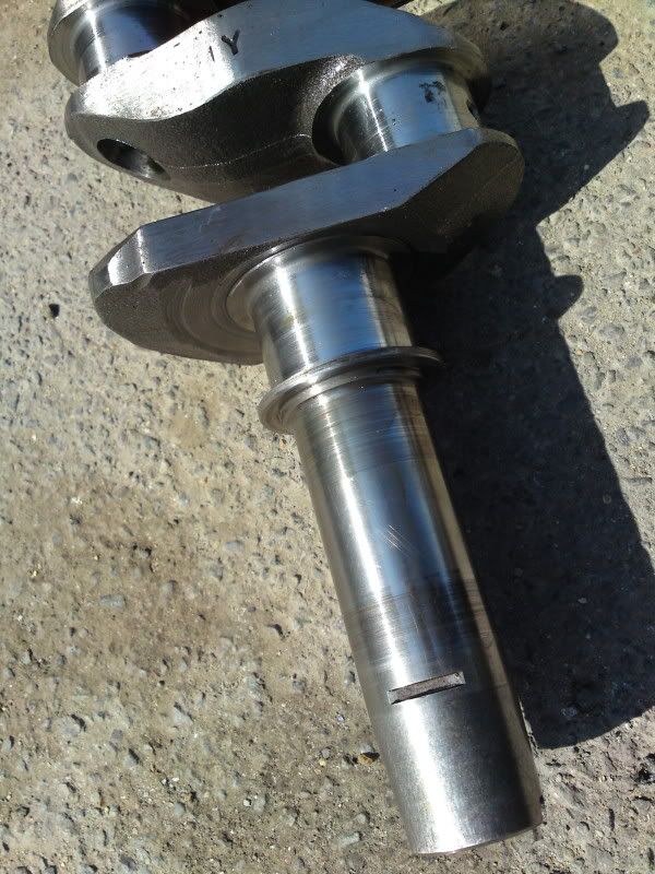

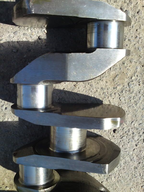

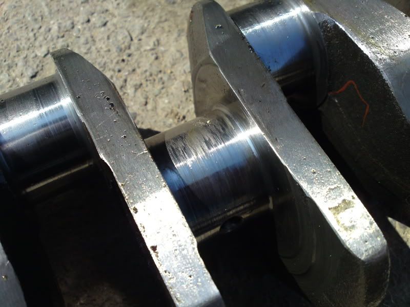

The primary gear wasnt the best to begin with either. But all the thrusts where in the right way along with everything else. The crank is scrap basicly because it has picked up really bad on the mains/big ends and its already on a high grind anyway and you couldnt save it, the block is scrap to where the thrusts have worn so much on the crank and block and has left nasty markings on both sides of the main. :wub: So are now both on the scrap, sad day.

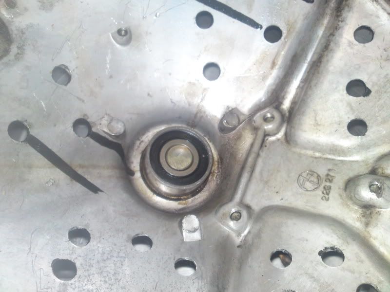

The anoying thing is the half moon seal was fitted correctly all that time!!, so still have no idea what caused the leak!!! But I think the seal was a crap one and was really hard prepared to the genuine one ive brought.
New, with new release bearing, hopefully this one wont rattle like a demon.
