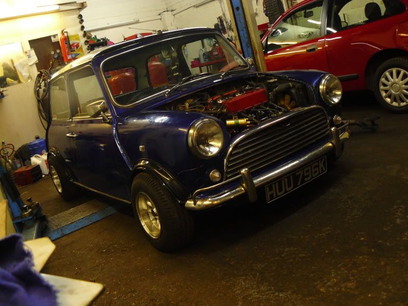

Thought I would up date this as its been a while! unfortunally i didnt pass my test on that day but i re done it last thursday and passed!! :D.

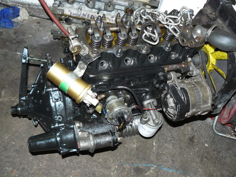

Past couple of weeks ive been building the 1061cc.... well i should have been!! ill quickly just say what happend.. basicly i started building it about 3weeks ago and went to put the pistons/rods in the block... done everything as you should, arrows facing the front etc. so fitted one of them and found that two of the pistons had been fitted 180* degrees out so when you torqued it up with the cap the rod hits the block due to the offset of the rods!! so basicly they f*%ked it up!! And as for me passing my test ive been in a rush to get a engine in the mini asap because I took the old one out a while back (didnt like the 3.2FD around town) so i then had to build up another engine using the 998block that was out of it originaly but with the crank, fly, cam etc that i brought for the 1061cc. (long story short lol)
So i got the 998 built up with the following parts..most of what where going to be used on the 1061 apart from the head.
998A+
- Twin HS2s, Ported Janspeed Inlet, ITG S/S Filter
- Janspeed Modified Head \'Stage 3 Spec\'
- Swiftune Billet SW10 Camshaft
- Swiftune Alloy Duplex
- MED Wedged & Backdrilled Crank
- Maniflow LCB & 1.75\'\' Single Box Exhaust
- Lucas Sports Coil + Lumenition Leads
- Isky-Type Lightend Followers
- ARP 9Stud Head Bolt Kit
- Competition Oversized Lead Bigend & Main Bearings + Thrusts
Clutch;
- M/S Pre-Engaged Ultralight Flywheel
- MED Lightend Backplate
- Orange Diaphram
- AP Bonded Rally Friction Plate
- Full Rotating Assembly Dynamicly Balenced By Classic & Modern
Gearbox;
- Rebuilt by Heathrow Transmissions
- MiniSpares 4Sync SC/CR Clubman Gearset
- MiniSpares X-Pin Diff
- 3.64 Final Drive
- Centre Oil Pickup
- KAD Quickshift

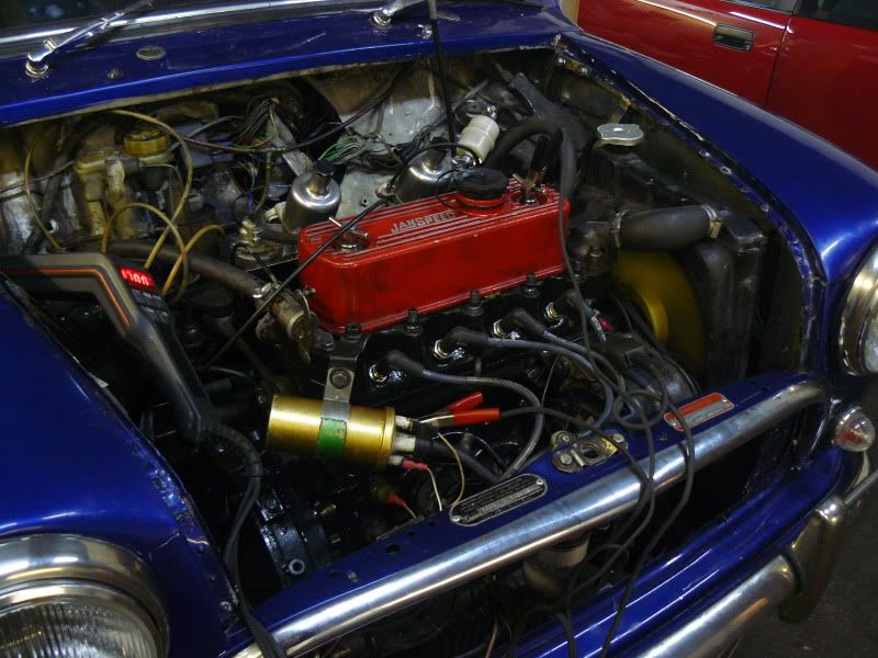

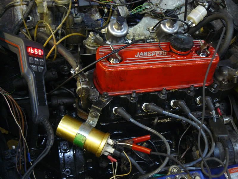

Got it all bolted in and running yesterday.. apart from a few troubles, the engine wouldnt sit in the subframe and was so tight! but got there in the end. also changing the start from inertia to pre engaged was a bit of a wiring night mare but completed it now. Once me and my dad had done all that it was time to fire it up! i was a little nervous as it was my first engine build and had thoughts running through my head have a tightend that up enough, or have i timed the cam up correctly... first we turned the enegine over without the plugs and waited for the oil pressure light to go out... seemed like forever but went out *phew* then timed the med electronic dizzy so its firing on no1. then went to turn the key and it didnt want to fire! so then took one of the plugs out to look for a spark but wasent very strong! so then went in the standard points dizzy, and then look at the plugs.. all where wet, so heated them up and put them back in... by this point i was pretty worried!! so tryed to fire it a second time and it burst into life!! think we mixed up the wires on the coil from the dizzy, but anyway it lives! then set went about running the cam in at 2000revs for 15mins.

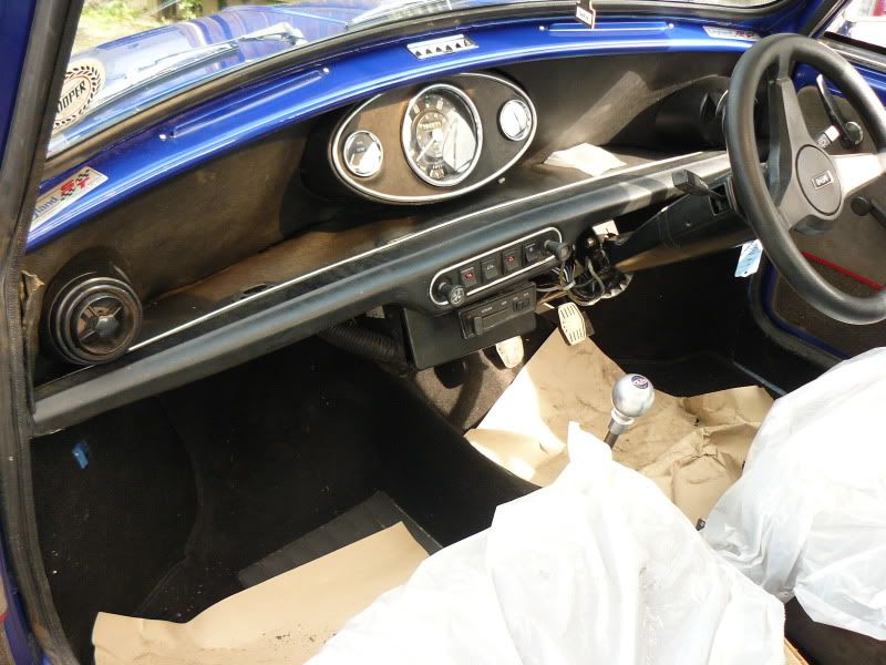

Quick picture of the new interior thanks to Retro Retrims, just need to get newton & comercial carpet then it should look spot on :shifty:
old;
new;
