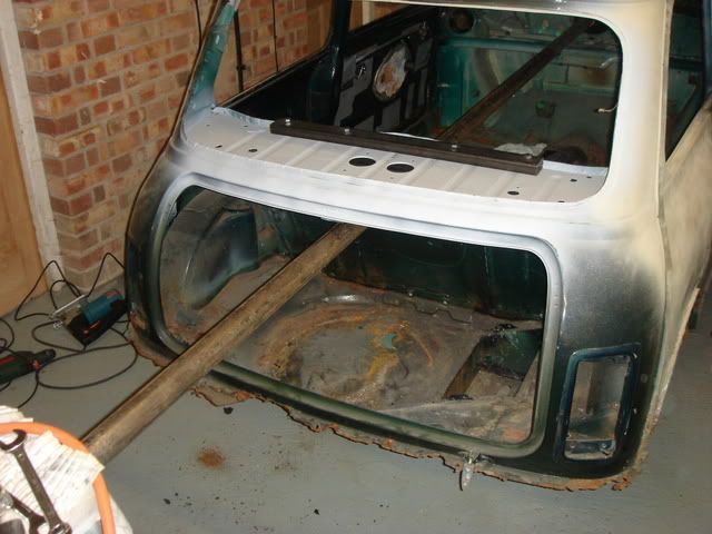

The spit is almost made up, everything is welded together and ready.
We just need to work on mounting the body to the supports that slot onto the long central pole.

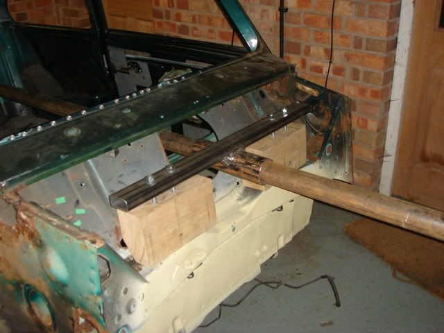

The A-frame made up (from yesterday)
I bunked off with my girlfriend today whilst Dad battled with the mounts and lost.. it seems I didn't clean the metal up on the front 'tie-fighter' and the weld has come loose.. so that's the first problem, the second is that it isn't at the correct angle and the pole when placed through hits the rear seat too low.
So we will re-weld the damaged 'tie-fighter' and clamp it with two u-bolts and straps of metal to keep things in place. And then pack out the wooden blocks at the front to give it more of a lean, meaning the angle increases and the pole with penetrate the rear seat in the right place.
This is the mount that Dad has been working on today :)
Holes have been drilled in the bottom of the cross member, which will be patched up. This is for extra strength and support.. you can just see the nuts poking out.

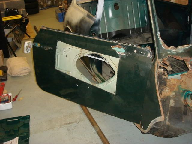

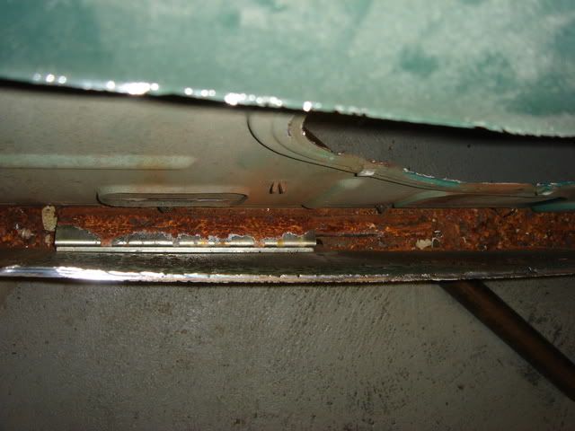

Ha nah, I've been dismantling the doors today.. the OS is the worst, it's too far gone.. the internal runners had rusted against the window, just a big mess. So I took an angle grinder to it and took the whole door apart. I've kept all the internals such as the door locking mechanism & the glass, all the handles etc.. but that door can't be saved.
That's inside the OS. The NS is a lot better, should be able to save that side.
