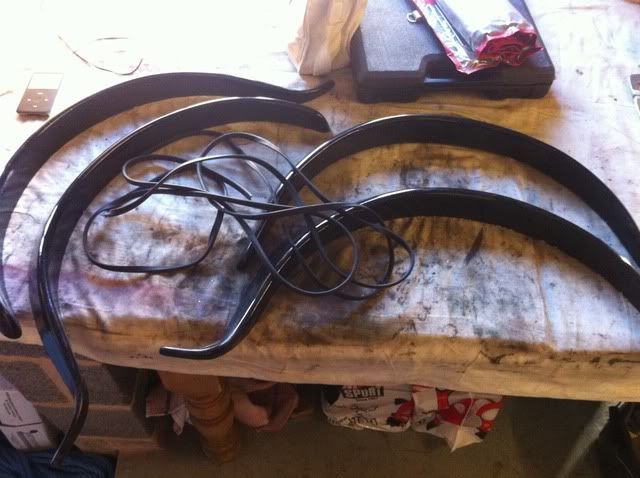

W&P arches, scroll up to see how they will look :dontgetit:

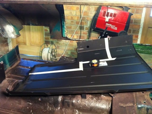

Bit more of the floor chopped out.
Marking up and taking my time over cutting the floor down to size.

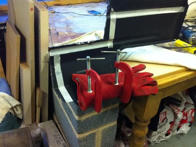

And clamped in place! needs a bit more fettling but I'm happy with that.
Only took me about 4 hours :( but I was taking my time and the good method of measuring twice and cutting once.

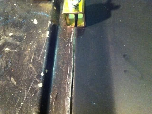

Gaps are looking acceptable.
So next step is welding it in place.. hopefully I'll have the aid of Camp Freddy :P
Unsure when I'm next home.. depends completely on my work load at Uni, it's been heavy lately :lol:
don't want to put a downer on it , but, you'll have a job welding with a gap like that on body panels , you'll
keep blowing through, unless you've got a heat sink of some description , best to try an off cut first..

It needs to be smaller than that?! I can do so.. got enough play in it, I think..
I thought it needed to be that sort of size to allow the weld to drop into it.
you could butt it together touching and it will penetrate, you only need a gap like
that on 2-3mm+ , best to do a test piece...

I've got the rest of that floor left so I can do a test piece, cheers for the heads up!

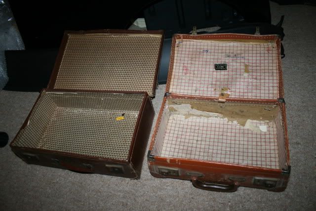

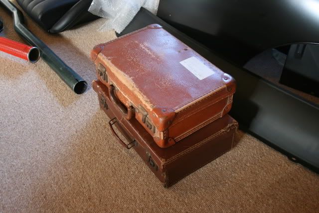

Some small old suitcases that my Grandma has given me, will be using these for my retro sound system :D

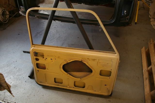

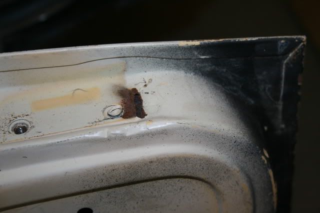

The door, fantastic condition! one tiny patch of rust which looks a doddle to fix.

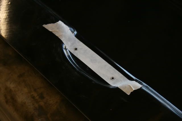

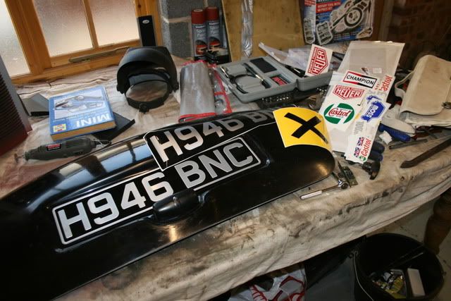

And I dremeled some holes and mounted my boot light. Didn't mount the handle as I can't offer the boot up to see how it all sits as the spit is in the way.

Looks good, much better quality than my 3g.
Although I'd open those holes up a bit more, pushing those threads through will take off any paint around the holes.

Yeah I was pretty impressed actually! I've seen a mount you can buy to attach the Iphone 4 to a tripod, might invest for when she is running etc..
Aye I did afterwards :D Just didn't take another video.
