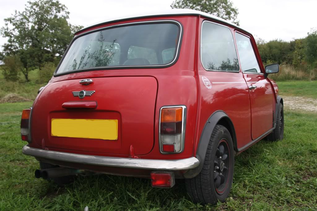

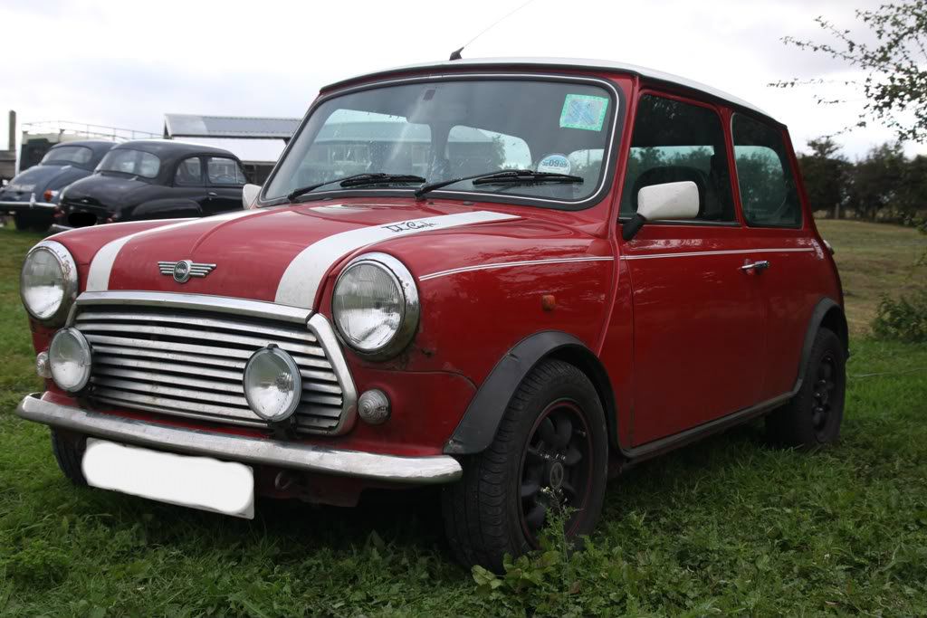

Right, so i think its time i started a build thread for my '98 Cooper. Although i'm not rebuilding it yet i am collecting parts to do so ^_^ . I've used my Cooper daily since i bought it 3 years ago and its starting to show signs of being a real mini, lol. By that I mean its got a bit of rot and the engine is slow, haha. So i'm going to rectify those problems:D
I'm currently running a 1275 with SW5 cam, Stg 3 head, 3.1 FD, lightened flywheel and Maniflow exhaust. Currently standard brakes and suspension, minus the hi-lo's.

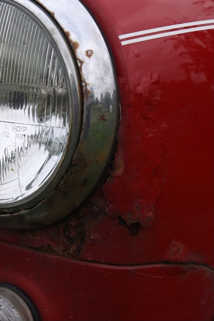

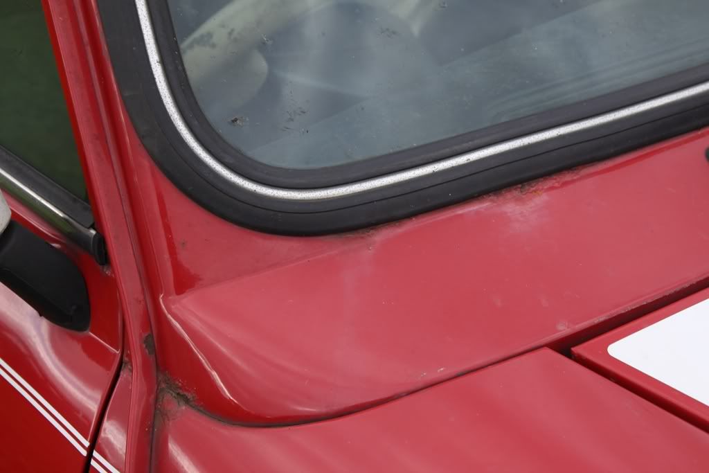

As you can see from the photo's she really is looking a little worse for wear.
Bodywork wise she needs a complete front end, wings, front panel, a-panels, and scuttle. Also needs new sills, rear valence and possibly a battery box, not great considering she has only done 57,000 and 33,000 in the last 3 years! I've managed to get my hands on a new MPi front panel and passengers wing, both of which are genuine- I'm going to use genuine panels throughout for proper panel fit and gaps. Although i could do the work myself i'm going to have Sleaford Mini Centre do the bodywork and paint as i just don't have the time to do a third project!! (I've currently got my '72 1000 engine and front end rebuild, and a moggy minor that has too much rust to shake a stick at, lol) Might fit a fibreglass bonnet aswell.

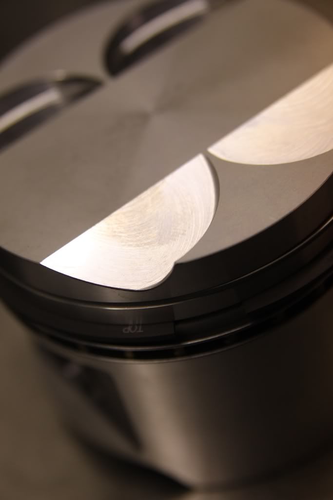

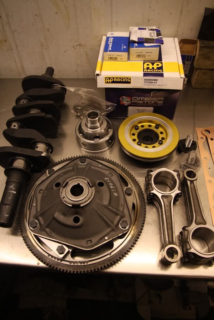

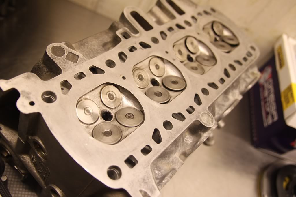

As for the engine, my current set up is just not fast enough :whistling: which means i need to add something, some more valves to be precise!! So i'm going to be building a 16v engine with a package from Specialised Components. I've got a head(thanks Dave/mini93 :thumbsup: ), and i collected a complete rotating assembly from MED yesterday, along with pistons, X-pin diff and a couple of other bits.
The spec i have pretty much decided on is, 16v head gasflowed with LT cams, +20(1293), MED rotating assembly which is an ultralite flywheel assembly(AP plate), N/T X-drilled wedged crank, lightened rods with ARP bolts, All fully balanced. Gearbox and drop gears will be standard helical cut items, diff is a x-pin type and FD will be 2.7. All controlled by the SC Typhoon :whistling: Should be fun.

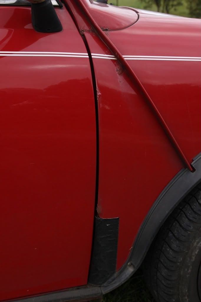

Looking very rough around the headlight.
Yes that is tank tape holding the a-panel on!!

Mmm a little more rust
Stuff from MED

Head

Thanks, yeah the machining work is beautiful on some of those bits:)
