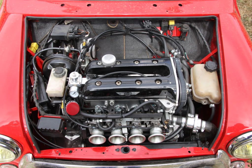

Looks great - what are you doing about wipers/wiper motors. Does it all still package with the overflow bottle position?
I just hadn't fitted the wiper motor yet when that photo was taken, yes header tank in original position as per photo's :-)

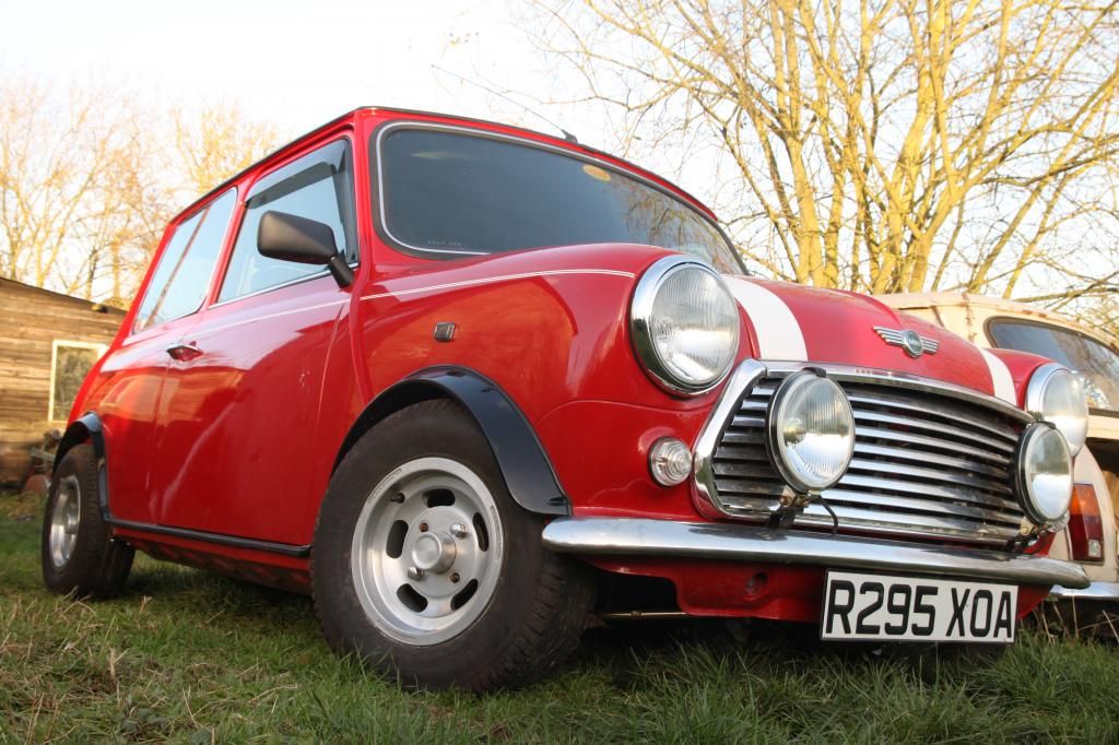

Here's how she looks now..

Yeah Rich a clubby, (as seen in my build link below) so room shoudn't be a problem. Just with the ITG filter set up I can't see how the throttle cable routes. Obviously it does because it's on the one above. Have you had any problems with crankcase breathing? And is yours just breathing into to atmosphere or to vacuum? One last thing where did you locate a temp gauge sender?
I remember reading your build thread, lovely mini! :-)
I'm unsure on the routing of the throttle cable... so can't really comment on it. :P
Mine does breath a little bit, it's just vented to atmosphere through a small K&N type filter, on the left hand side of the head(red circle). I was tempted to put it to vacuum, but I read that this can cause problems with emissions, and as I have enough problems with emissions anyway(due to age) I didn't want to compound the issue.
With the coolant sensor, I used the Specialist Components head outlet and the sensor screws into that, using the BMW sensor.
