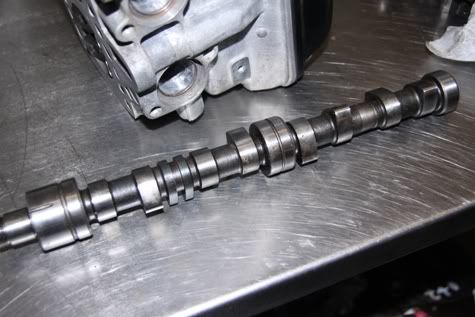

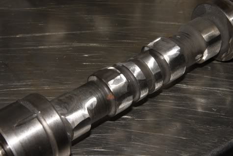

So while the 'old man' was taking the tyres of the rims with a big hammer and a bar, i reprofiled a cam with the angle grinder!! lol. :thumbsup:
Before
After
Just in case anyone thinks i'm mad, (i'm not, really) I've done this as i need a jack shaft to drive the oil pump, doing this has two benefits 1. It saves having to make sure the cam and crank do not come into contact and 2. It saves weight! less rotating mass :P
I'm taking it to work tomorrow and hopefully i'll stick it in either a lathe or a cylindrical grinder(depending how hard it is) and make it nice and smooth :thumbsup:

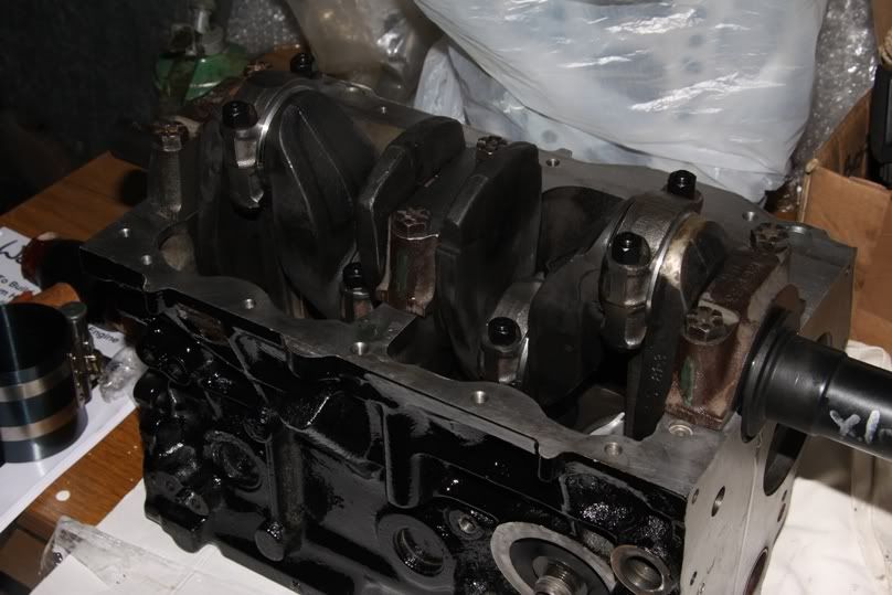

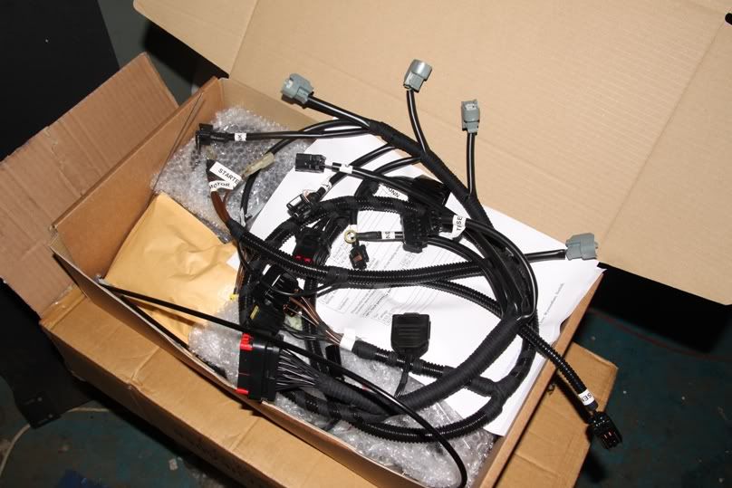

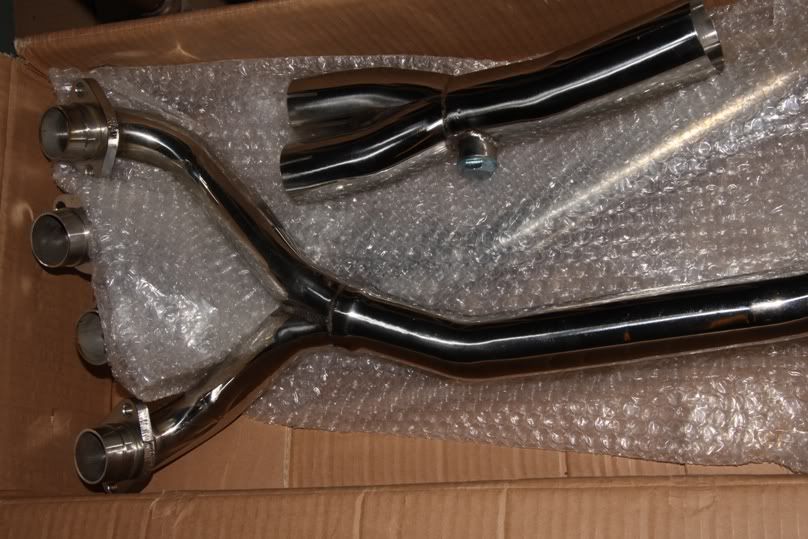

Went to take a few pics of the stuff i got yesterday from SC, but then i got a bit bored and started to build it up :wub:
Box of bits :)
Mmm Stainless

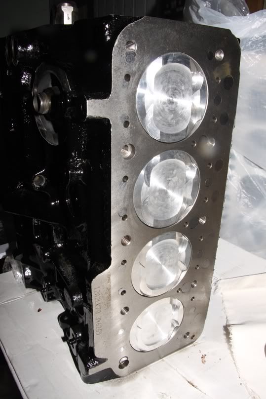

And then....
Pistons with bowls machined to give 11:1 CR

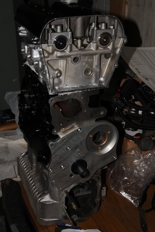

Short engine
Just put on my SC gearbox for my 1380, and put the head on to see how cool it looks :thumbsup:
Posted Image Posted Image

#27 AndrewJ530
AndrewJ530
  • 1,628 posts
  • Location: Middlesbrough
Posted 09 November 2009 - 09:15 PM
That zorst looks gorgeous. Can't wait to see it on!
