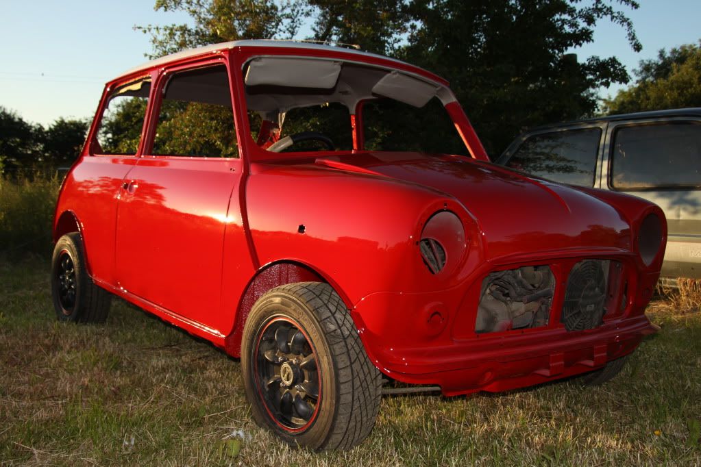

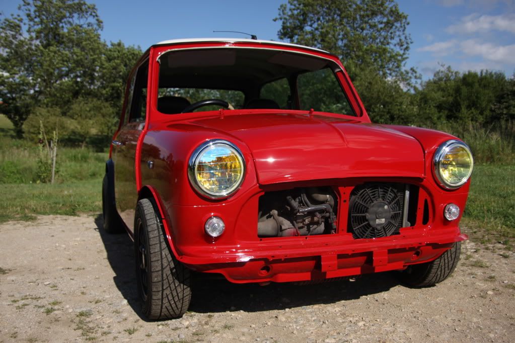

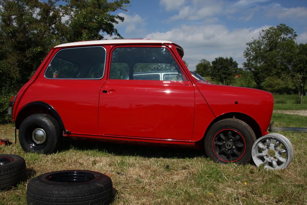

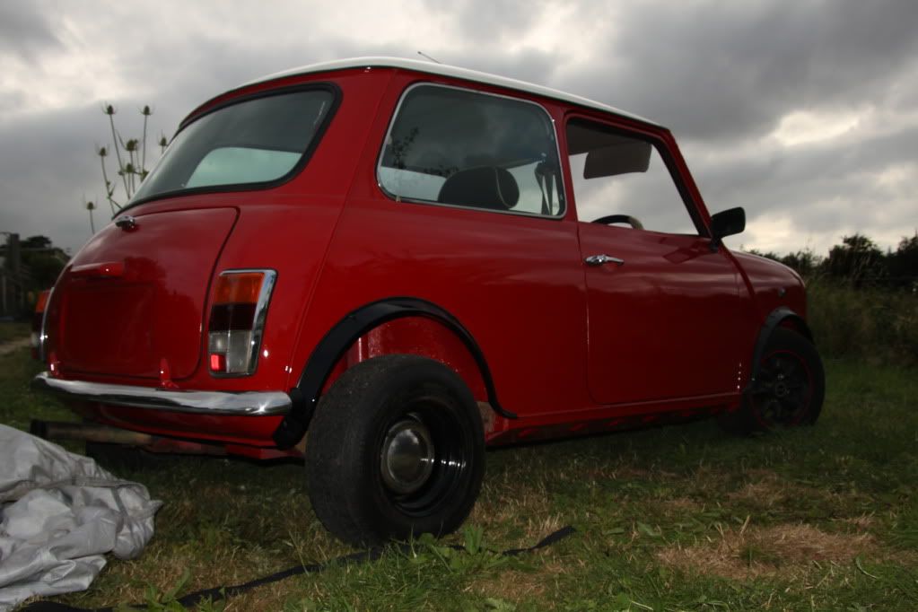

Quick update, its on the road!!! Still pretty much how it was, just the bodywork has been sorted. I wanted to go to a few shows this year and actually in a mini=P
So it's on the road for the next 3 months then its coming back off the road for the engine swap and the subframes to be rebuilt over the winter, a cunning plan i believe=P
In the end it had a complete front end(wings, front panel, a-panels and scuttle), passengers door skin, rear valence, passengers side sill and drivers side inner/outer sills, all heritage and all very expensive!!! Boot and bonnet are both fibreglass from Arc angels.
Current wheels will only be on for a few weeks then they'll be up for sale. I have a set of 5.5x12 Superlites that i'll be refurbing in the next week or so.
Pre paint-
Post paint-
A few bits bolted back on, i was going to put some banded black steelies on but 12's are more in keeping with the look i was after.

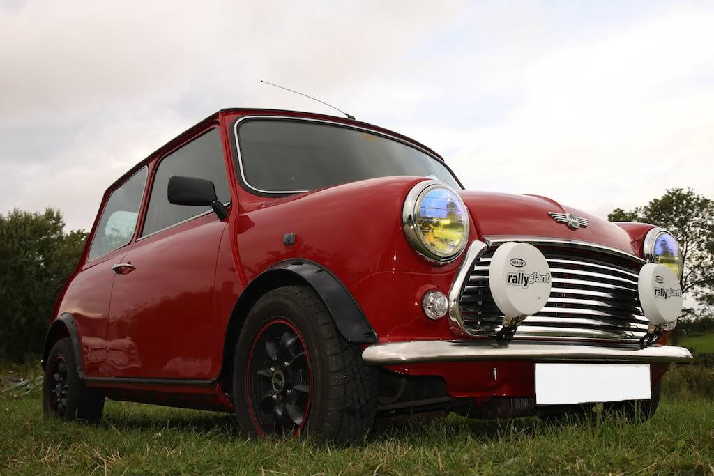

And this is the latest photo, i took this evening -
