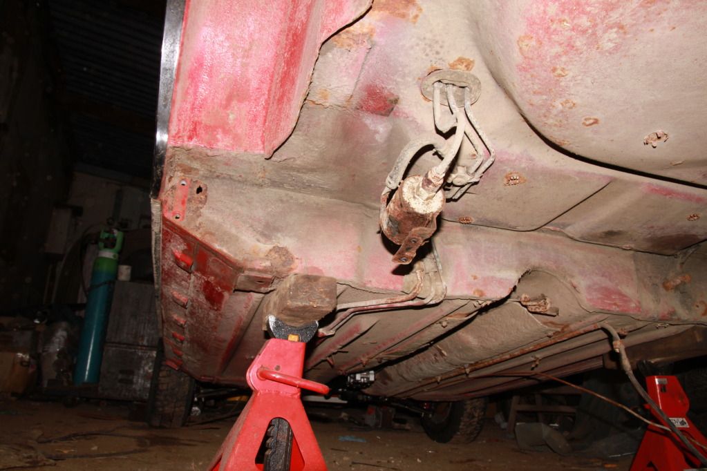

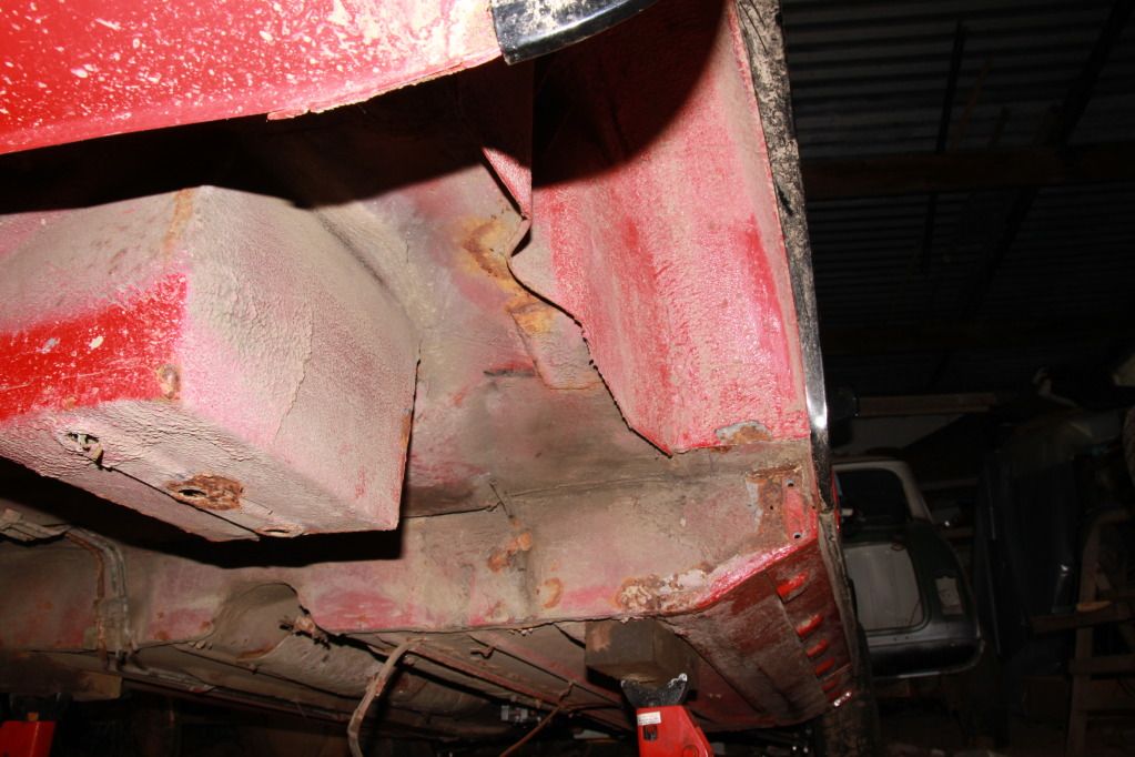

Even if your mini looks rust free it never is!? ha. >_< Aswell as the boot floor being a bit rough the channel for the battery cable is awful and needs a bit of attention and painting.

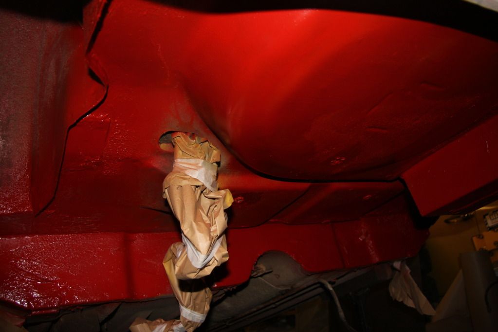

These are just after I removed the subframe, it's now in primer and seam sealing it tomorrow. Saturday it will be painted :D
The subframe is all shiny and sat waiting to go on.

Finished tidying the boot floor, painted it today. I'll get the subframe bolted in, then I just need to take the radius arms to Surf Blue and get the bushes reamed :-)
