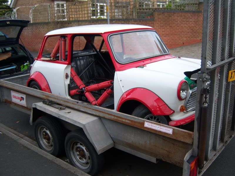

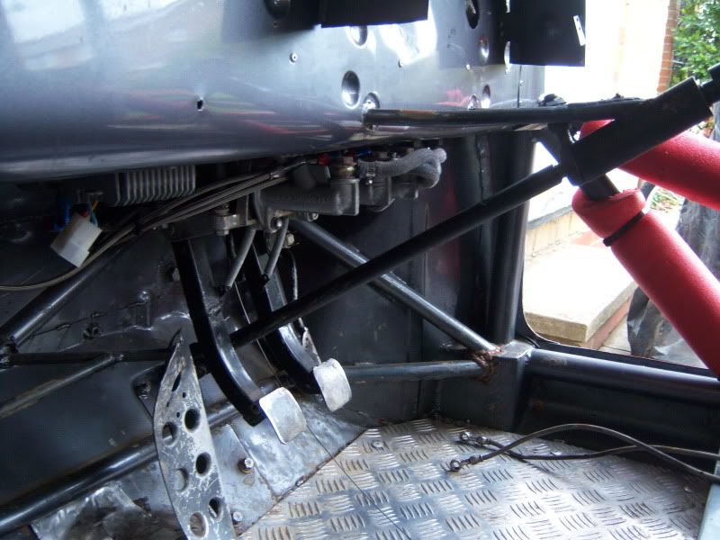

Just been to pick this rolling shell up with Jordie today.
Its a miglia built from a brand new shell by Peter Vickers about 7-8 years ago.I believe it was driven by Malcolm Stapleton before being sold to the guy i bought it from.It needs a few little bits of tidying up doing but virtually nothing at all,i would say the pics dont do it much justice as the inside is full of dust and dirty water marks.
Rough spec for the shell (loads of other small details but heres the main bits);
*Full weld in cage with harness bar,crossed door bars,tied into a and b pillars,through rear bulkhead,ties into front and rear suspension mounts,mount for steering column,seat and harness mounts on cage etc etc.
*Seam welded around suspension mounts and most other panel joints.
*Rear anti foll bar.
*Sealed front and rear bulkheads.
*Full width bulkhead box.
*Custom made vickers alloy boot floor.
*Custom made vickers alloy dash.
*Carbon front end,bonnet & boot lid.
*Mounts for internal gear linkage.
*Carbon fibre parcel shelf.
*Rear valance removed.
Spec for the rest of the car so far;
*Custom pedal box with remote reservoirs.
*Braided lines throughout
*Brake bias controller
*Rear subframe converted to solid mounts but straight to body with no trunnions etc
*Tubular rear section of subframe to replace c section.
*Minifin drums but with fins turned down for weight.
*Front subframe strengthened and extra mounts added to bulkhead.
*Front tower bolts replace to allow direct access for heigh adjustment.
*Heavy duty adjustable tie rods bottom arms etc.
*Hilos all round.
*Uprated cones.
*7x10 mb racing split rims
*Yokohama A032r tyres.
Theres loads of small things i havnt mentioned but i will have a good poke around it tomorrow and see what else i can find.In the mean time heres a load of random pics.
Cheers Ross.
