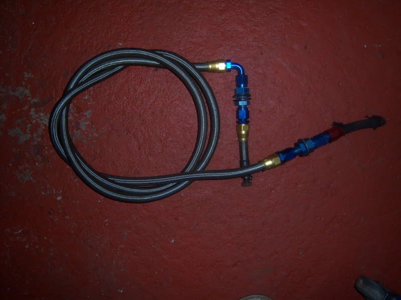

This took a while to do as the welds were a bit heavy duty and took a while to clean up nicely.Bar removing some old rivets,the other job for today was to remove the fuel hose which was riveted into place in some awkward positions.Used a dremel to get in at them as the drill wouldnt have gone anywhere them.
Fuel hose and fittings.
