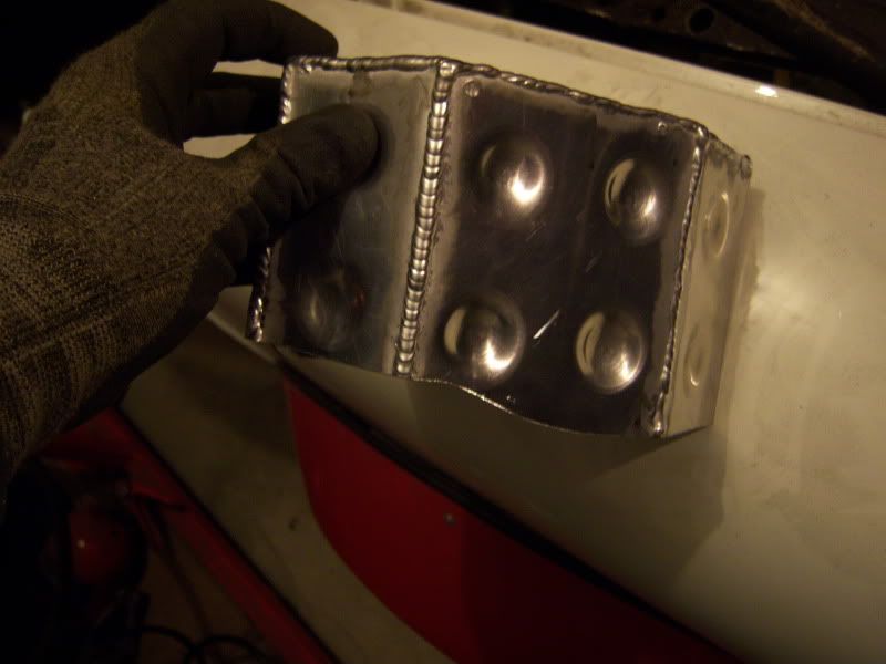

Right,theres been no updates for a while as I tend to work on about 10 things at once instead of one at a time.I have just about finished one bit bar a bit of final tidying up so thought I would pop some picture up.I needed to make something to hold the brake reservoirs in place as I wasnt happy with what was already on the car.I found a tilton reservoir that looked amazing but it was around $700 plus delivery from the states which is just far to steep to me!The others I found were either bloody awful standard looking things that I didnt like the look of.With that in mind I set about making something to hold the small girling style reservoirs and look half decent at the same time.
Heres what it started off with,basically a bracket to hold 2 of them in the wheel arch area and a metal ring to hold one in the bulkhead area.As usual the pics are rubbish so get your specs out!

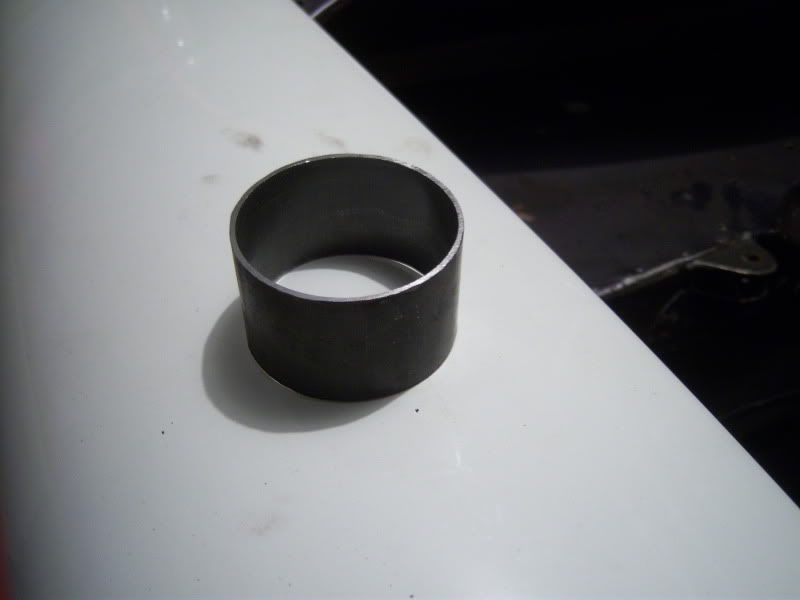

I quite liked the metal ring idea so the plan was to remove the existing one & have three of those in the wheel arch area,first plan was to have the bottom of an oversize tube plated over to provide a mount and catch any spillage.
Decide I didnt like the look of this once the reservoir was in place so plan changed to having 3 rings of the same size as the outside of the reservoir same as the original one in the bulkhead was.However the outside is inbetween readily available tube sizes so bought the next size up and reduced it a bit.
Tube as cut to length.
Cut.
Welded.
Fitted.

While getting on with other bits of the car I had a better idea for the reservoirs that would tuck into the back of the bulkhead and not take up much space.Also means its not going to get covered in crap like it would in the wheel arch.
I didnt take many pics during making it but here it is tig welded up.
Shaped to fit the contours on the bulkhead.
In place in the bulkhead.
In place with an old reservoir.The fit to the bulkhead is better than the photo shows as I had to move it along slightly to get some light into the photo.
Pretty pleased with how its turned out especially the dimples so it matches in with the rest of the car,it will be painted same grey as they rest of the engine bay when the car is sprayed.Also got some rubber trim on order to go round the bottom to stop it rattling once its mounted up.
Will update some more once the bits im making are finished.
Cheers Ross.
Hey great project! just 1 question did you by any chance get the cover you made tig welded up at aliweld in ryton?
#156 rosco454
rosco454
  • 908 posts
Posted 23 January 2011 - 08:19 PM
Yes I did! I presume your the nice blue/green b reg saloon that parks opposite?I keep seeing it knocking about and it looks like a lovely car.
