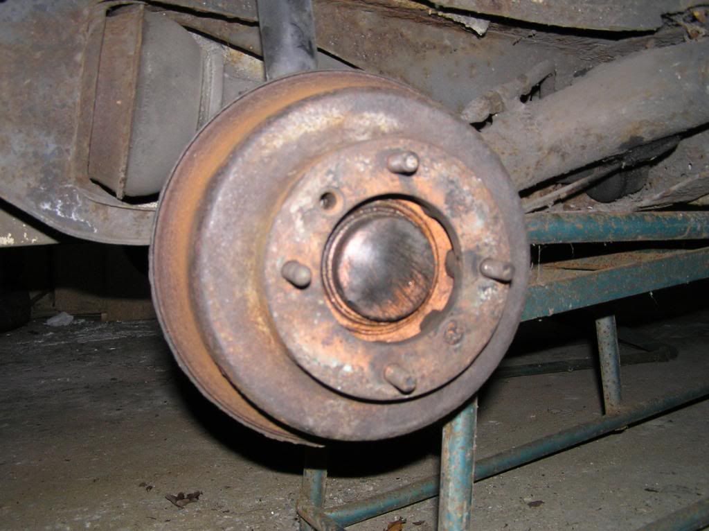

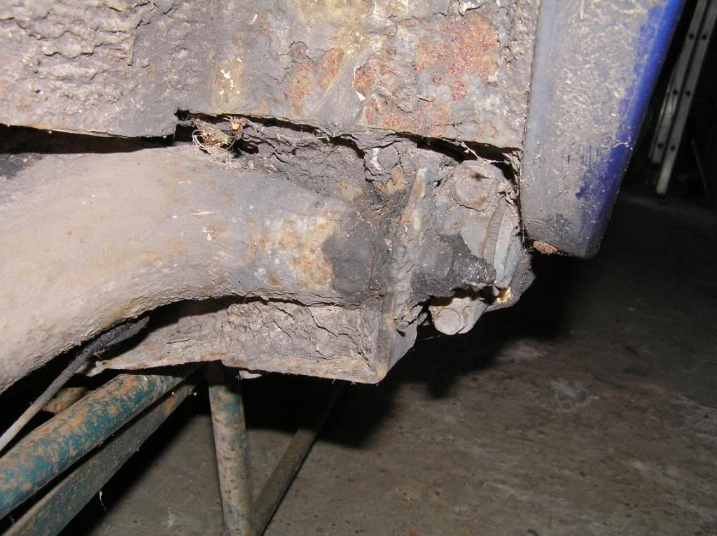

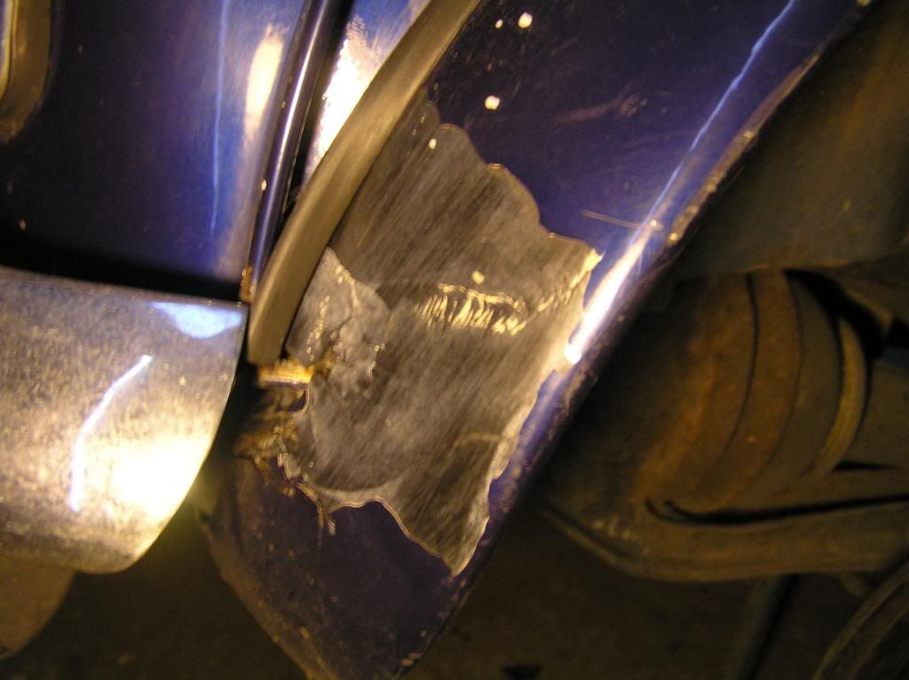

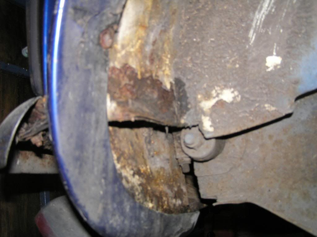

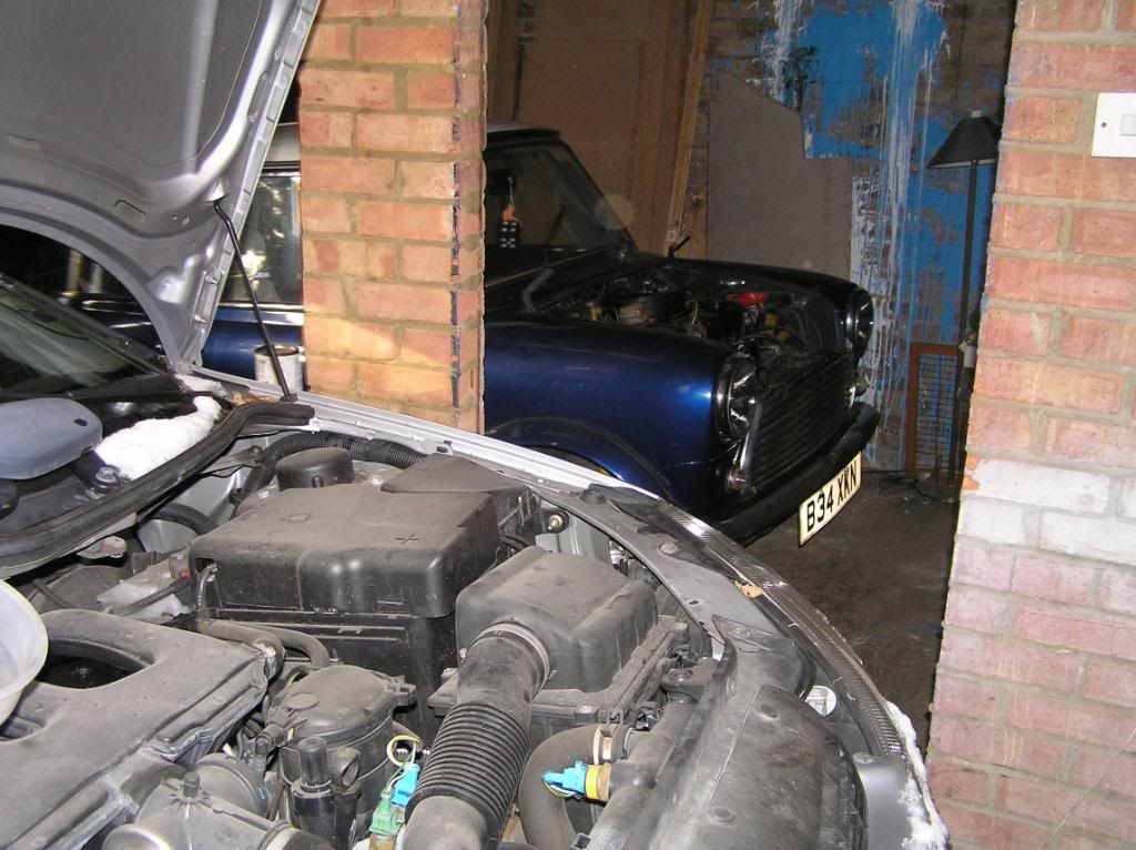

Right, a few pictures I snapped while busy.

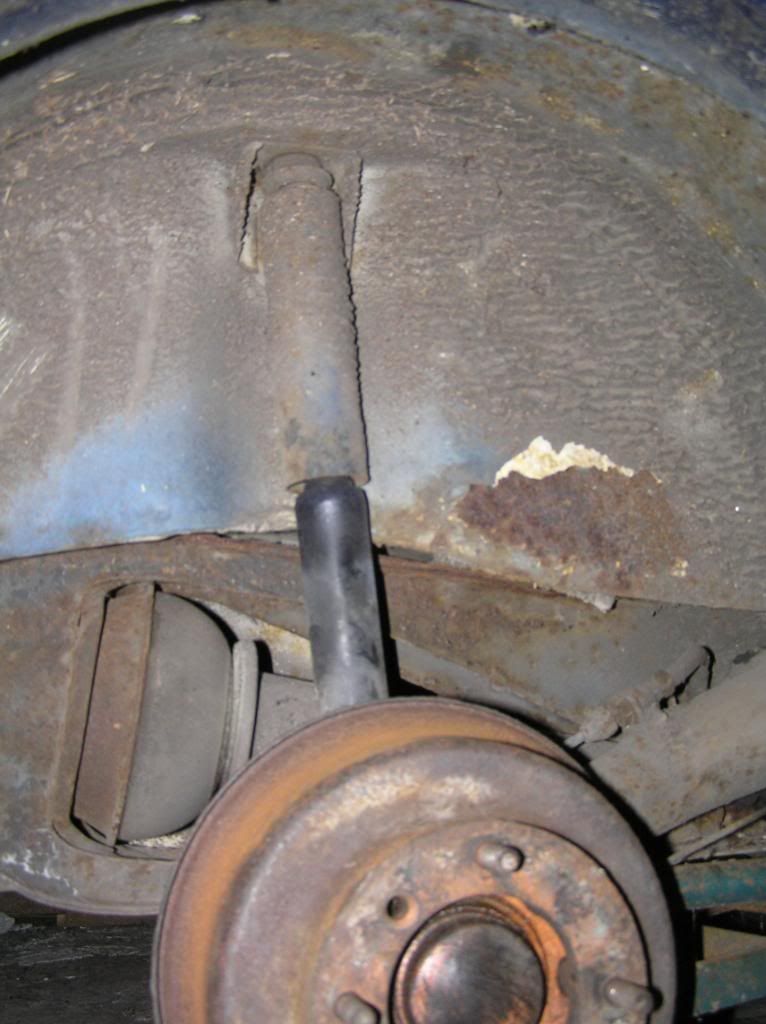

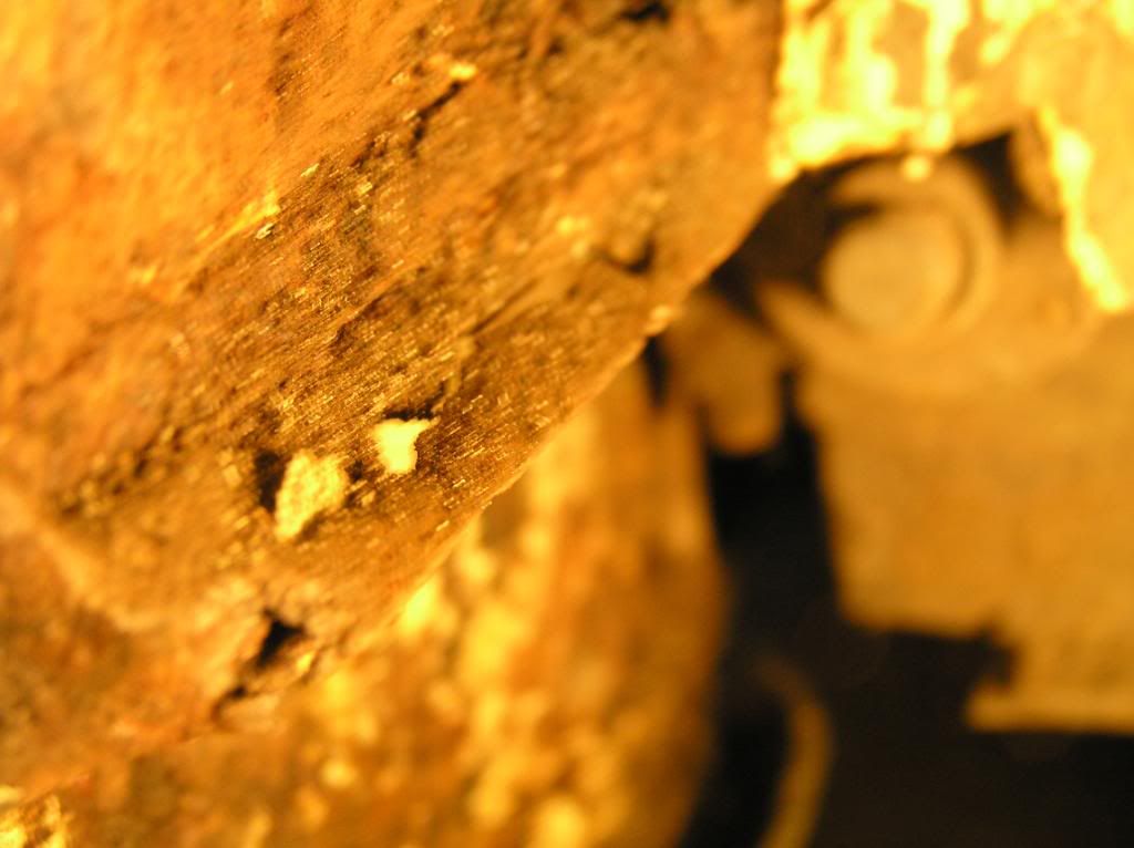

Nasty arch! Paint really flaking off. Will get genuine sportspacks and 13x7 softline superlights with black centres hopefully in the new year :)

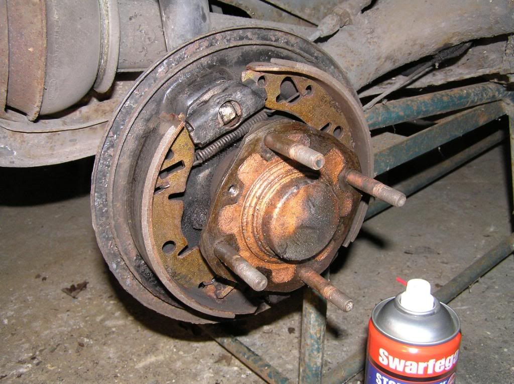

One of the rear brakes checked over, and cleaned up a bit. Handbrake mechanism greased a bit too behind, and at the triangle where it splits from a single cable, to two.

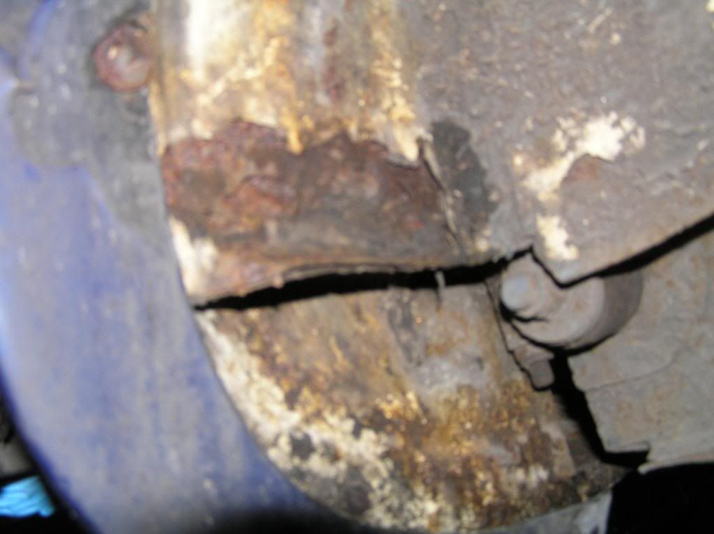

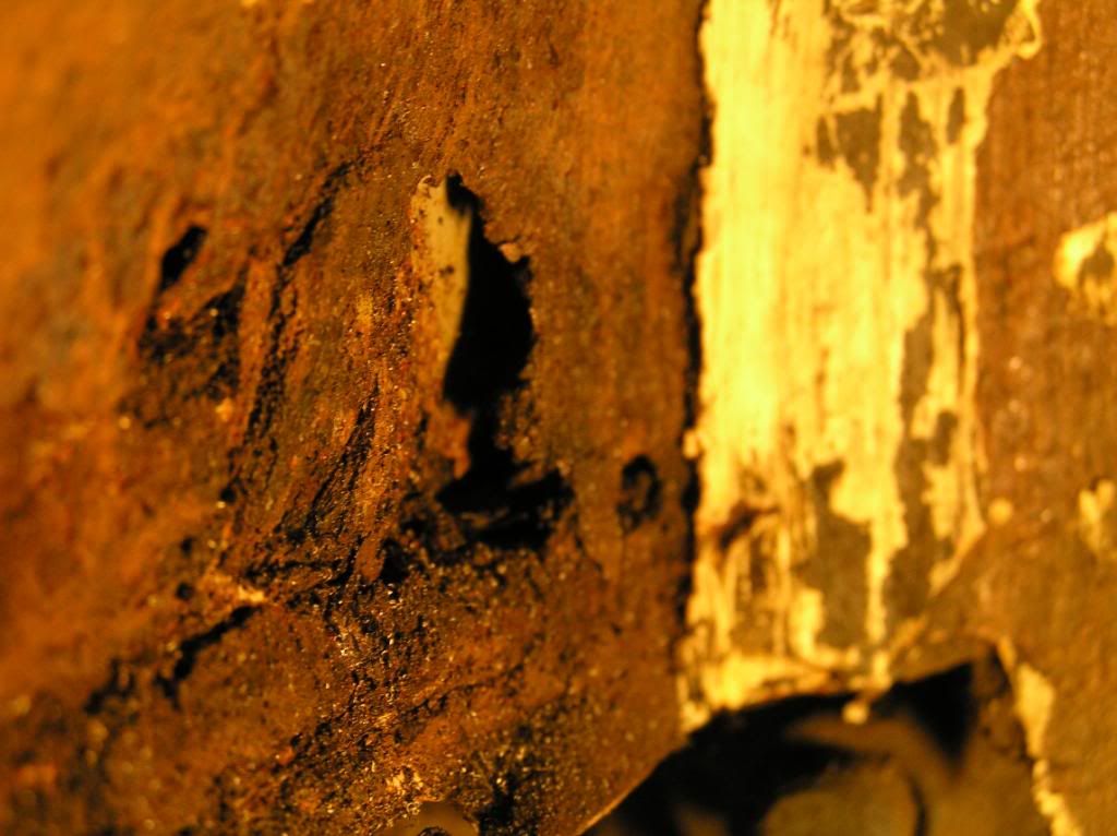

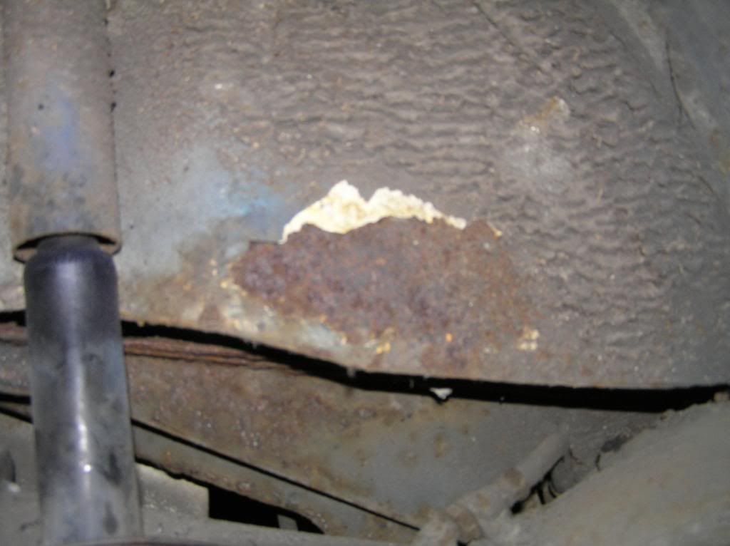

Rust in arch.
A little closer.
And here. Plated these up and undersealed the whole arch. One more coat to go. Pictures of it next time i'm there.

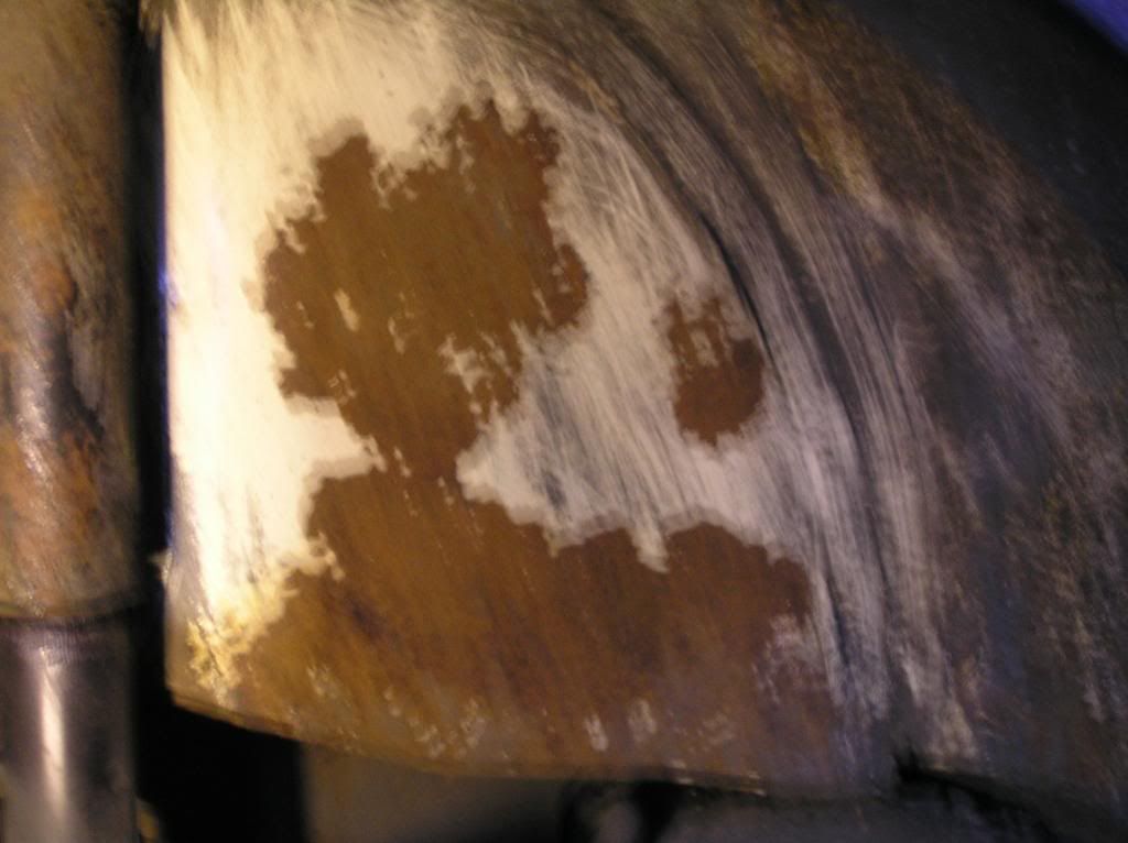

Needed cleaning, rubbing down and undersealing.
Wire brushed.
Was a bit more of the orange stuff over here!
Wire brushed and cleaned the whole arch, after plating the little holes on the left. Now has a coat of tetroseal on it :lol:

Drum all back together. Will wire brush and paint black probably at some point, but i'm tempted by superfins or something in the new year. Look lovely through the spokes of some fat wheels. Maybe silver drums with black centred superlights, or boring black? Red wouldn't suit Tahiti Blue.

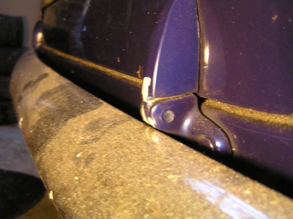

Another cosmetic thing to sort, i'm picky I guess. Does this happen on all mini boot hinges, or is mine adjusted wrong? Will have to buy some Tahiti Blue paint and can fix some chips, spray my arches when I get them, and sort my rust. Might just put chrome ones on so it won't notice, but i'm not sure how it'd look?

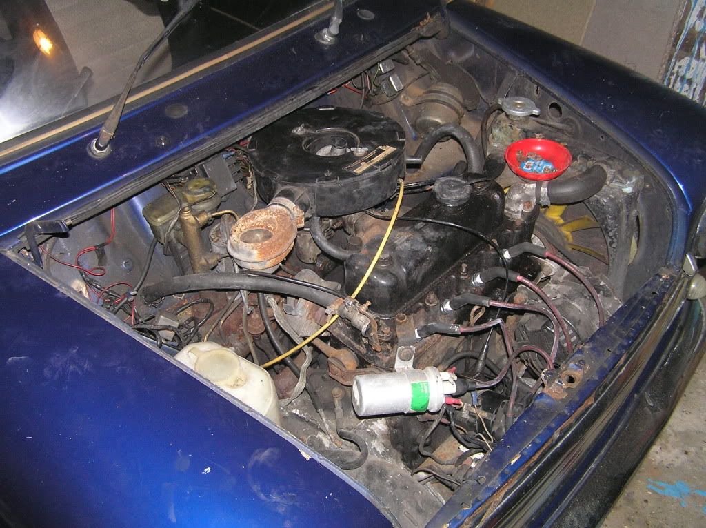

Does look suspiciously like a 998 tho :D Better check that one!
And can anybody figure out why, on a B reg car, there's a 2nd electric fan built into the inner wing? I swear that was only 1996 ish onwards...? Strange! Next time your with the car, run your fingers under the scuttle panel, a little to the driver's side of the carb, on the lip. If the car's a later shell you should feel some numbers there, that's the old VIN number! If not, then it's just me being a muppet! :thumbsup:
Not meaning to burst your bubble mate, still is a bargain for £650 whether it's a 1275 or not!

That shell wouldn't have been a 998 from factory. The shells with electric over ride fans were all 1275's :wub: I'm 99% sure they were all SPi's or MPi's which would make it a late 90's shell, with an 80's reg. No idea why though...
The leccy fan can bee seen in this picture:
It would also match up with the colour too if the shell was late 90's, and the fact it's rusting just under the windscreen. A favourite for the Rover shells.
