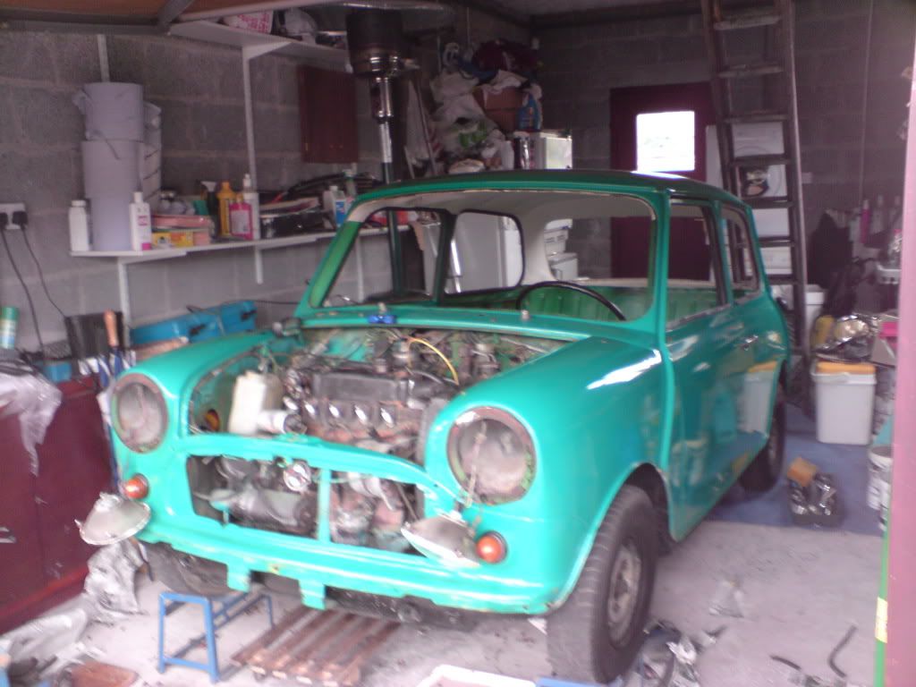

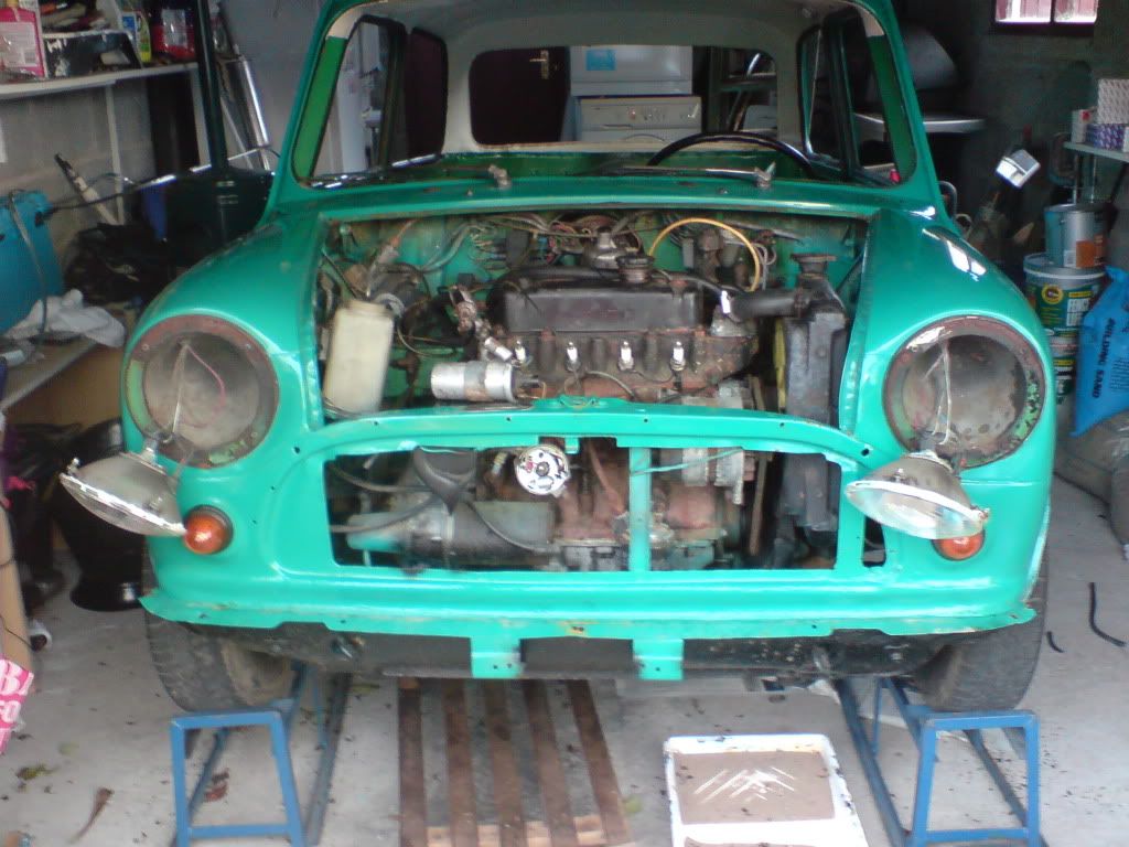

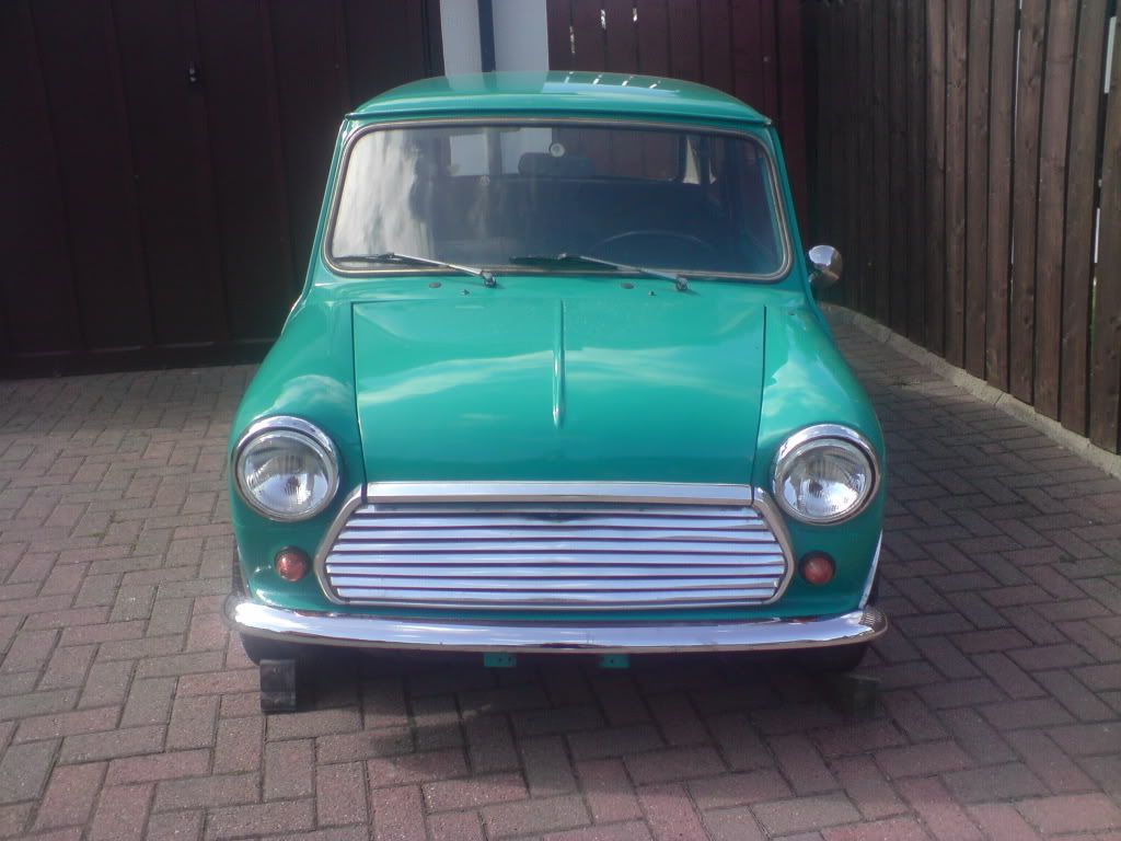

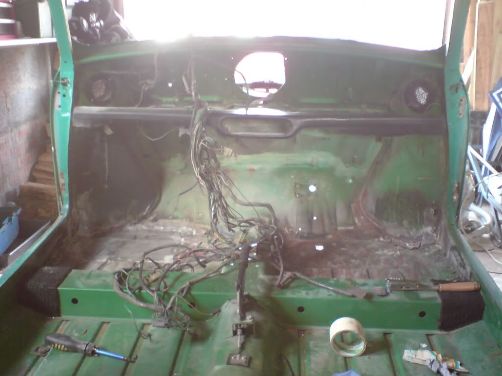

the car when it was first bought:

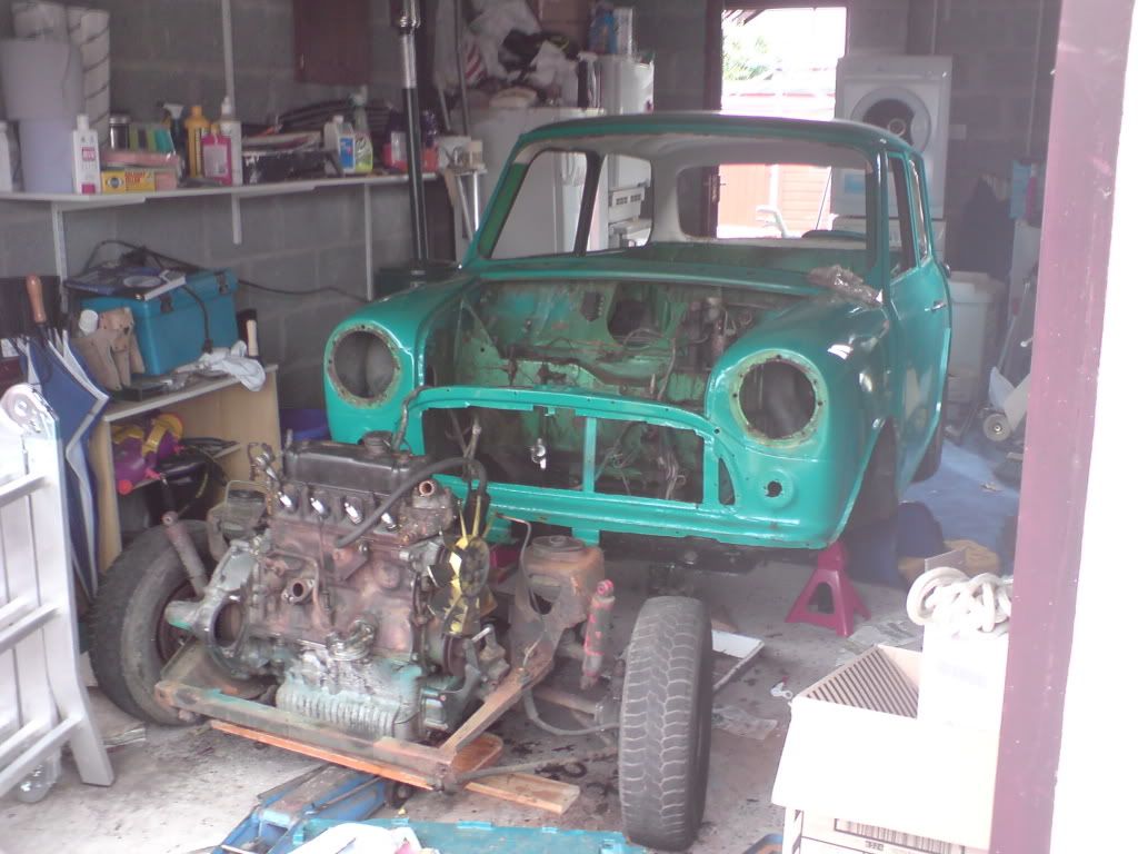

then suddenly the strip down had started and it was in the garage:

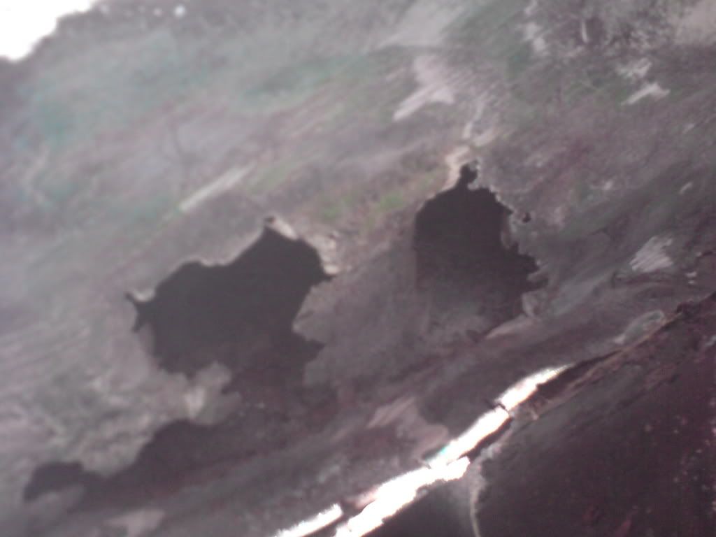

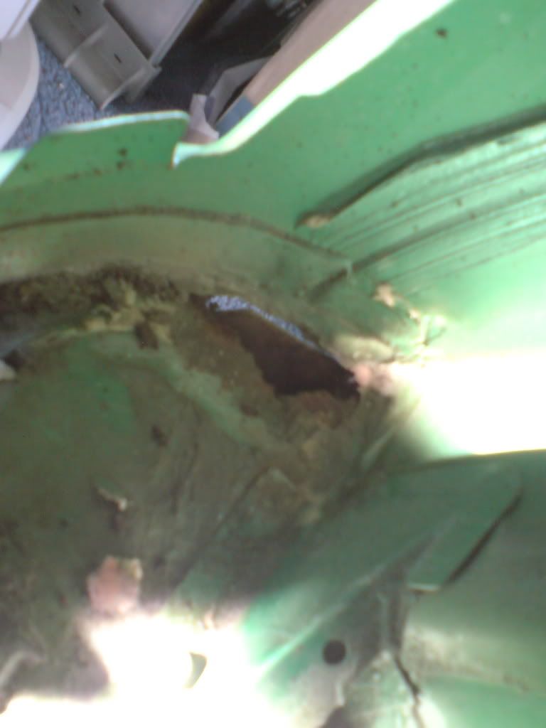

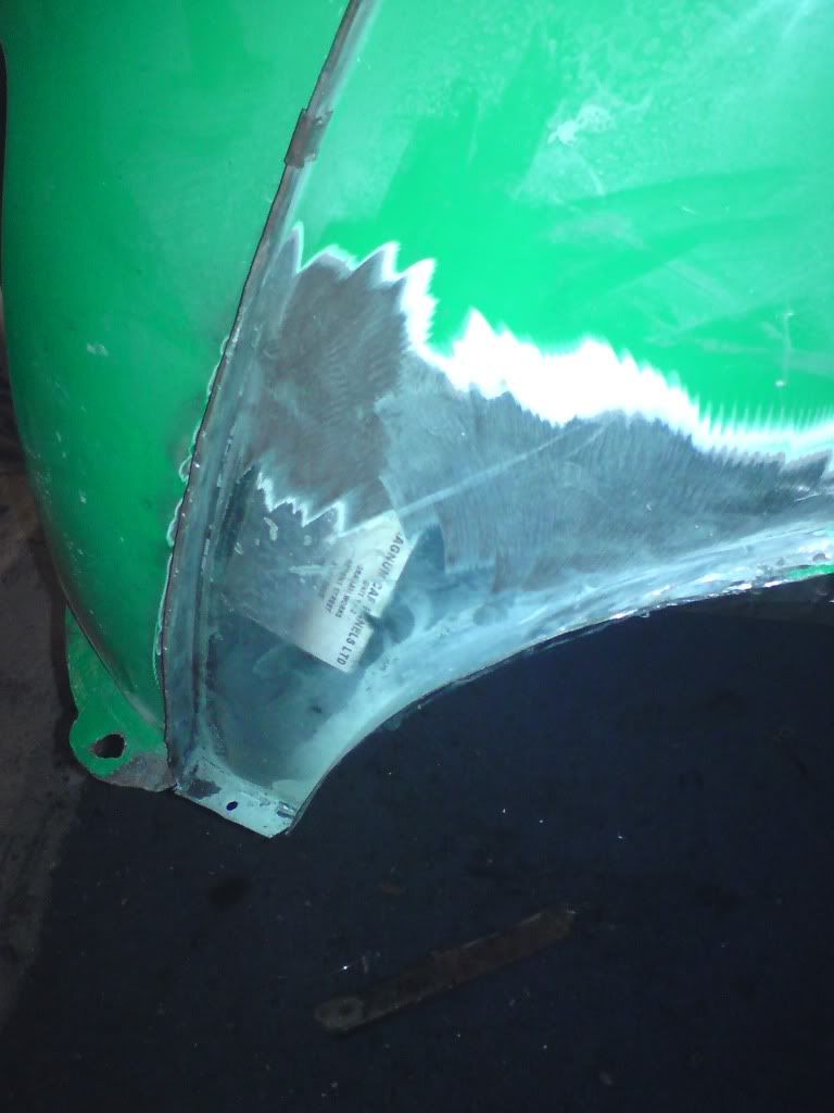

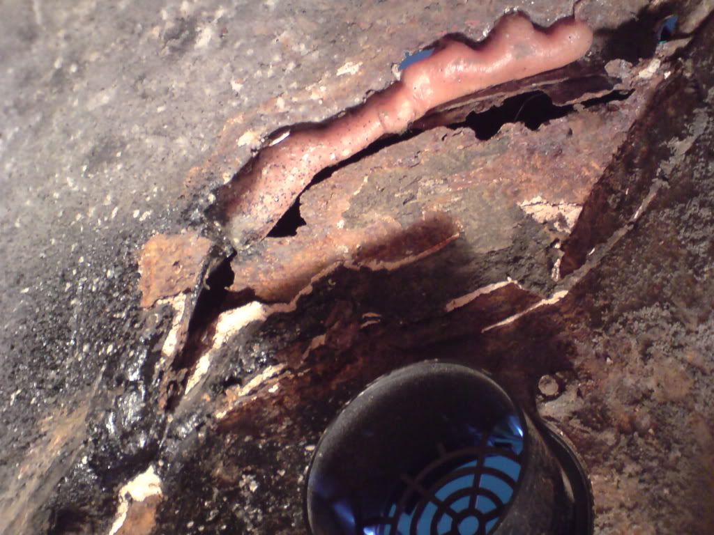

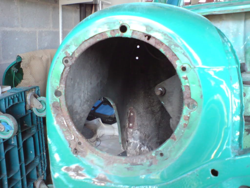

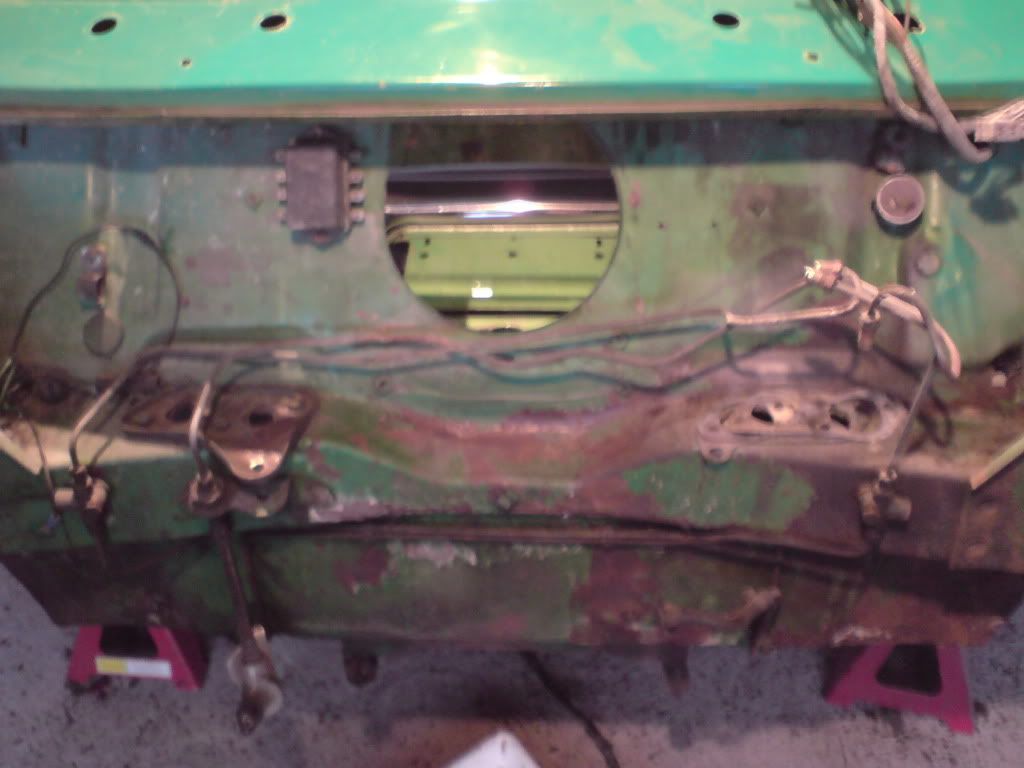

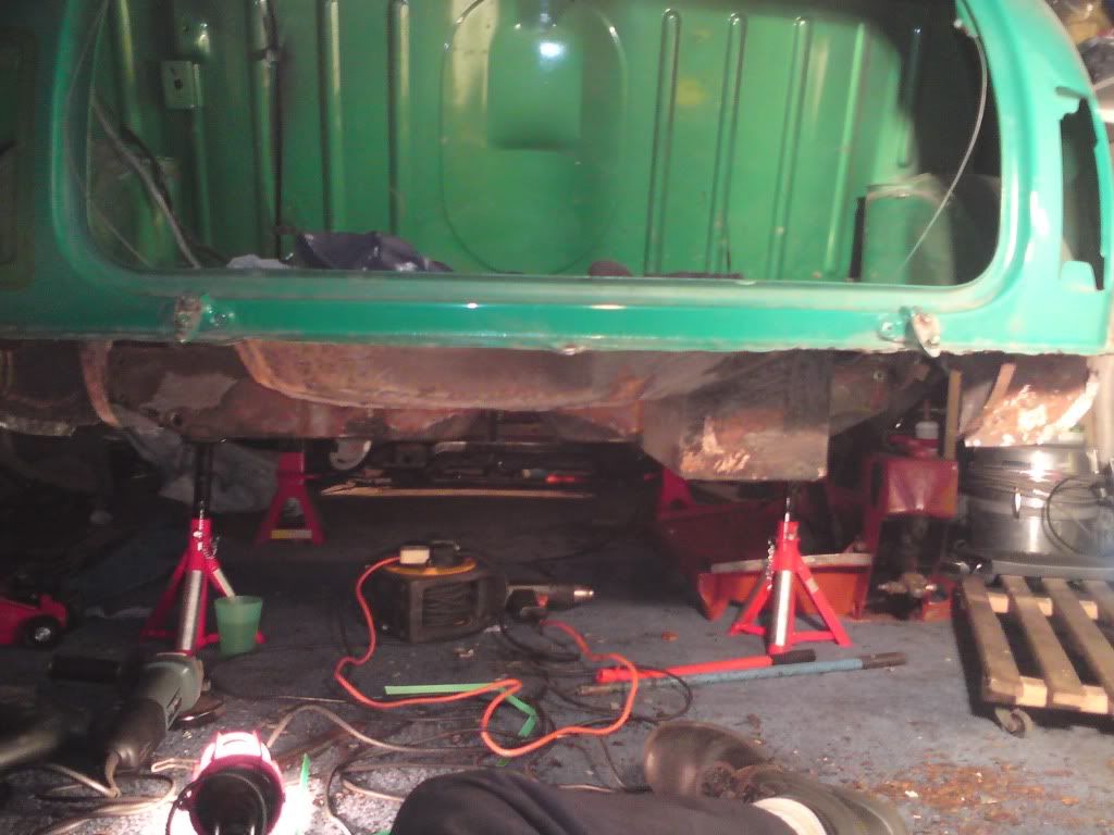

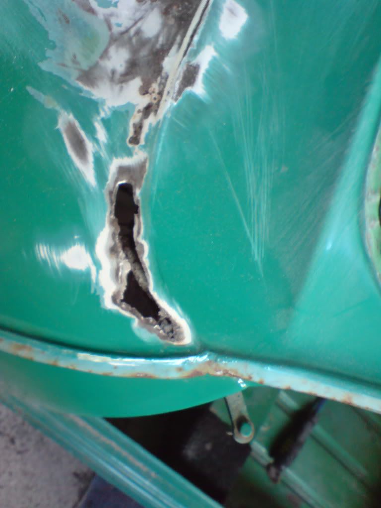

a few pics of the rust and the filler i had found:
the rear valance and closing panels was held together with filler and the stuff you put round windows to stop them leaking
so off with it all :)
once again though after i had done this i poked around with my screwdriver and found more rust holes which i havent got pictures off yet

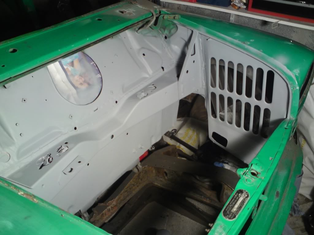

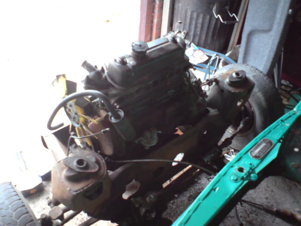

i decided to take the bulkhead down to bare metal and put some temporary primer on it
as he looked a couple of days ago:

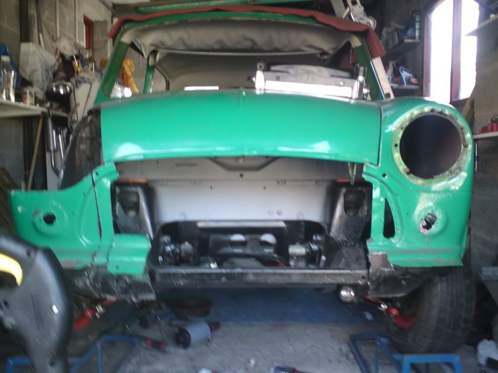

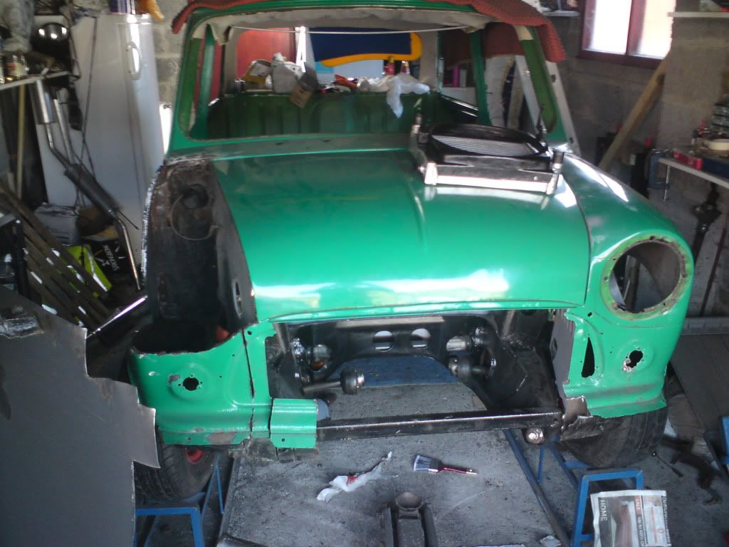

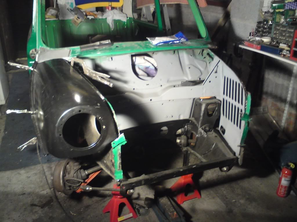

and then the whole front end was took off and the scuttle repair and the wing was mocked up:
i decide i wanted a fred flintstone style mini :)

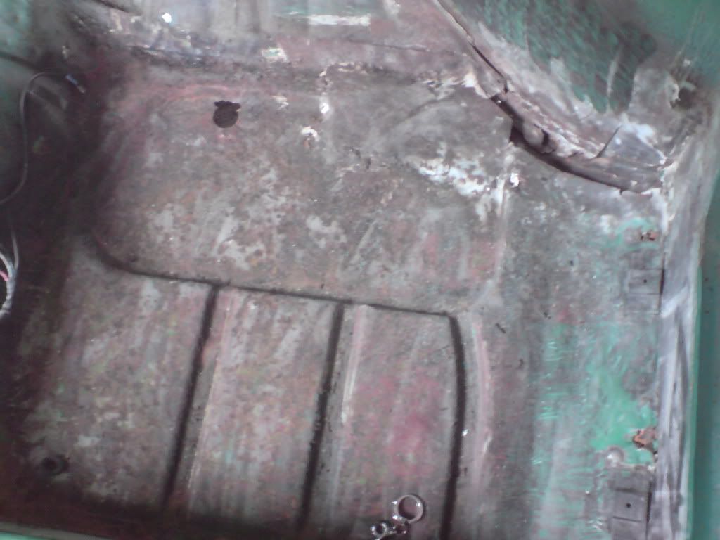

and then i realised it might not work so i mocked up the new floor pan :)
the welding has now started: :thumbsup: :D

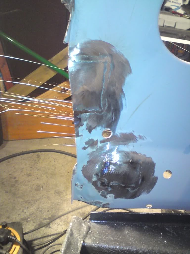

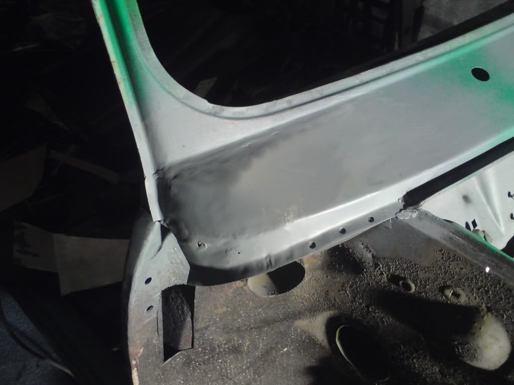

first cut out the rot where the wiper arm had been and welded in a patch and put some poundland primer on it, looks pretty good :)
did the other wiper hole so it looks normal and did the same and it now looks very good :)

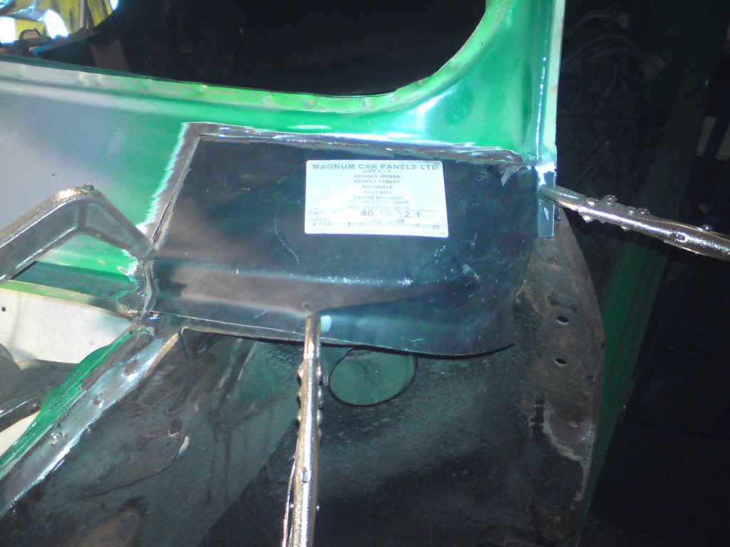

and finally put the scuttle repair panel on before we ran outa gas as we were welding on the underside scuttle :( but the scuttle looks good so far :)
still had plenty of time so we cut off the other side scuttle and mocked up the repair panel and the underside closing panel and the magnum repair panel is alot better fit than the other one :)

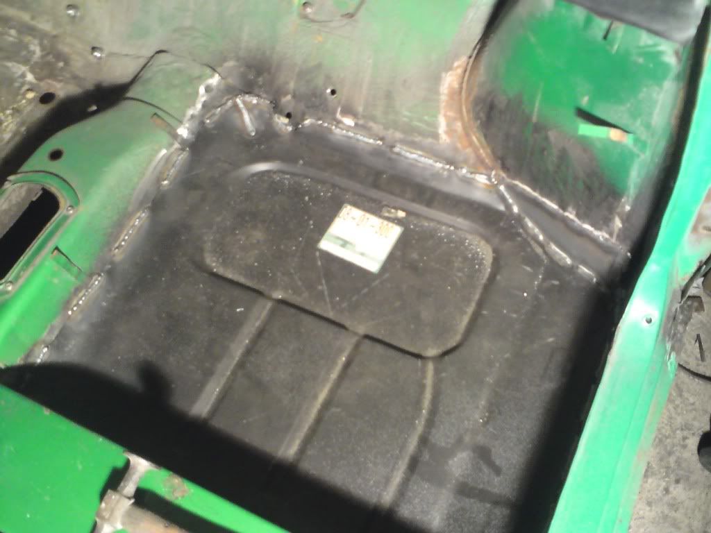

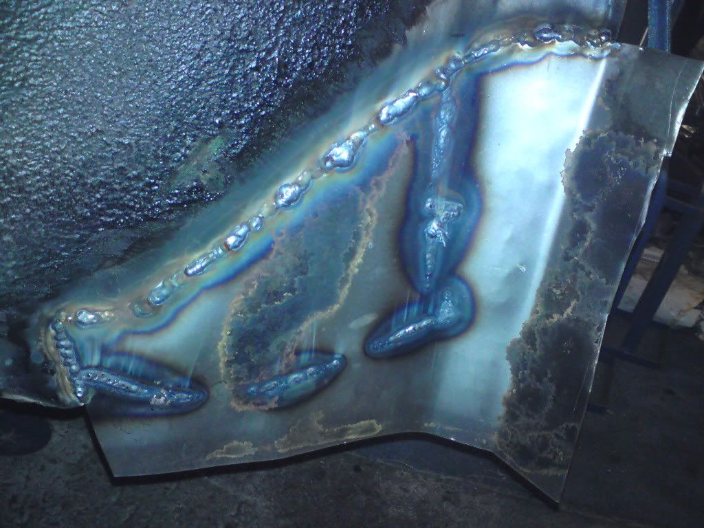

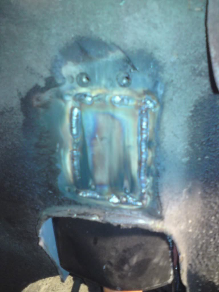

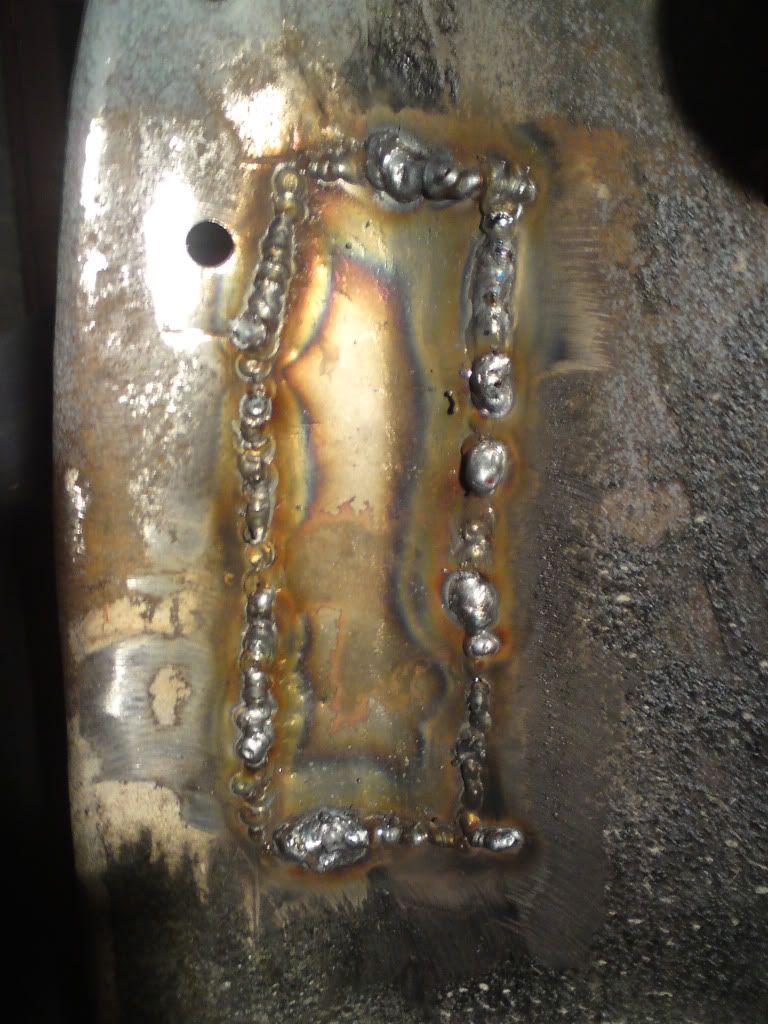

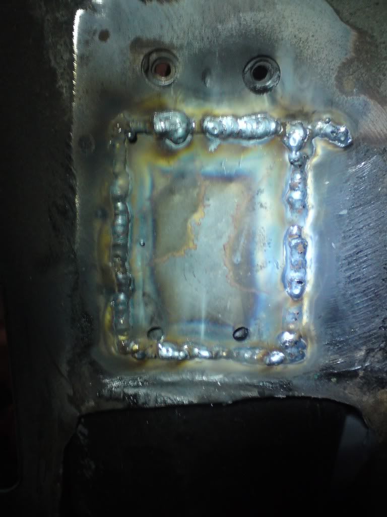

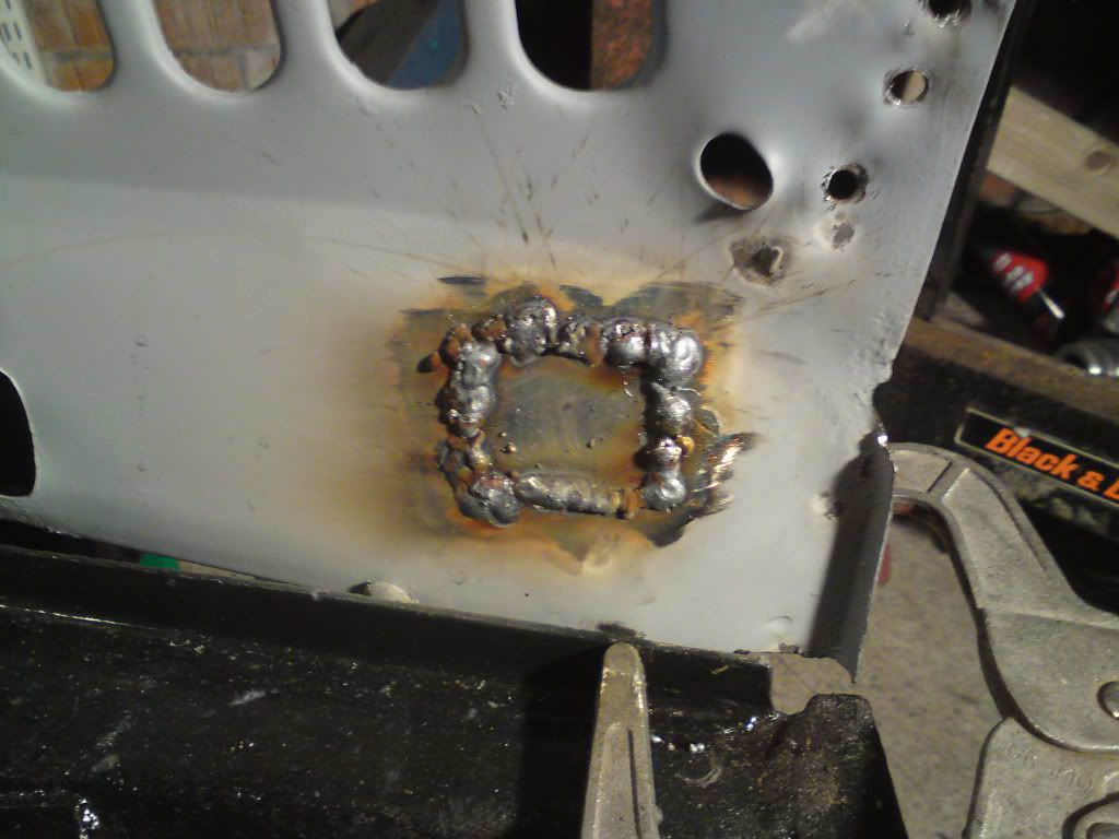

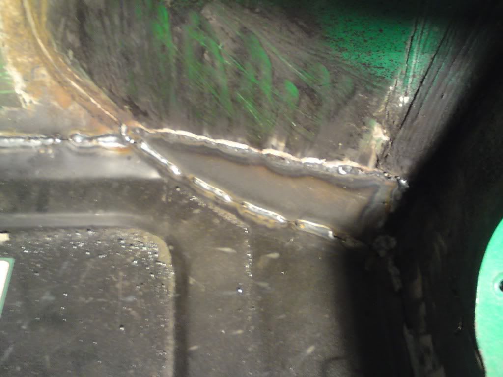

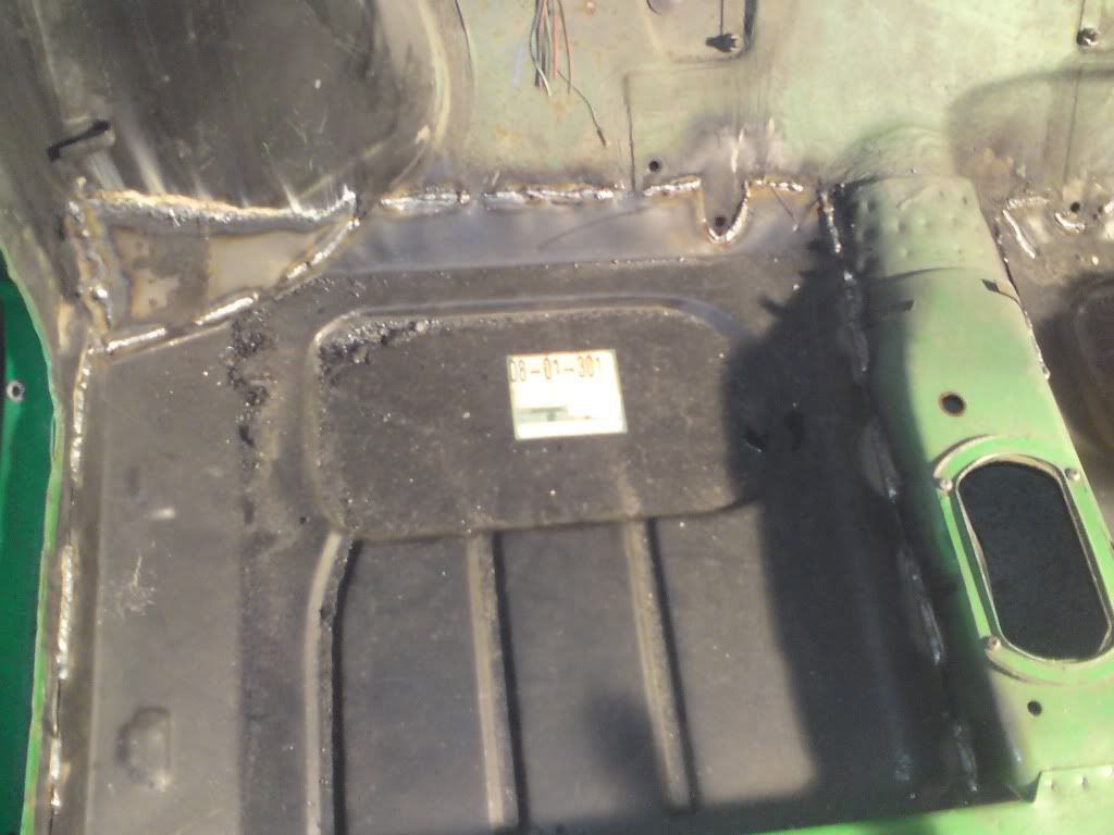

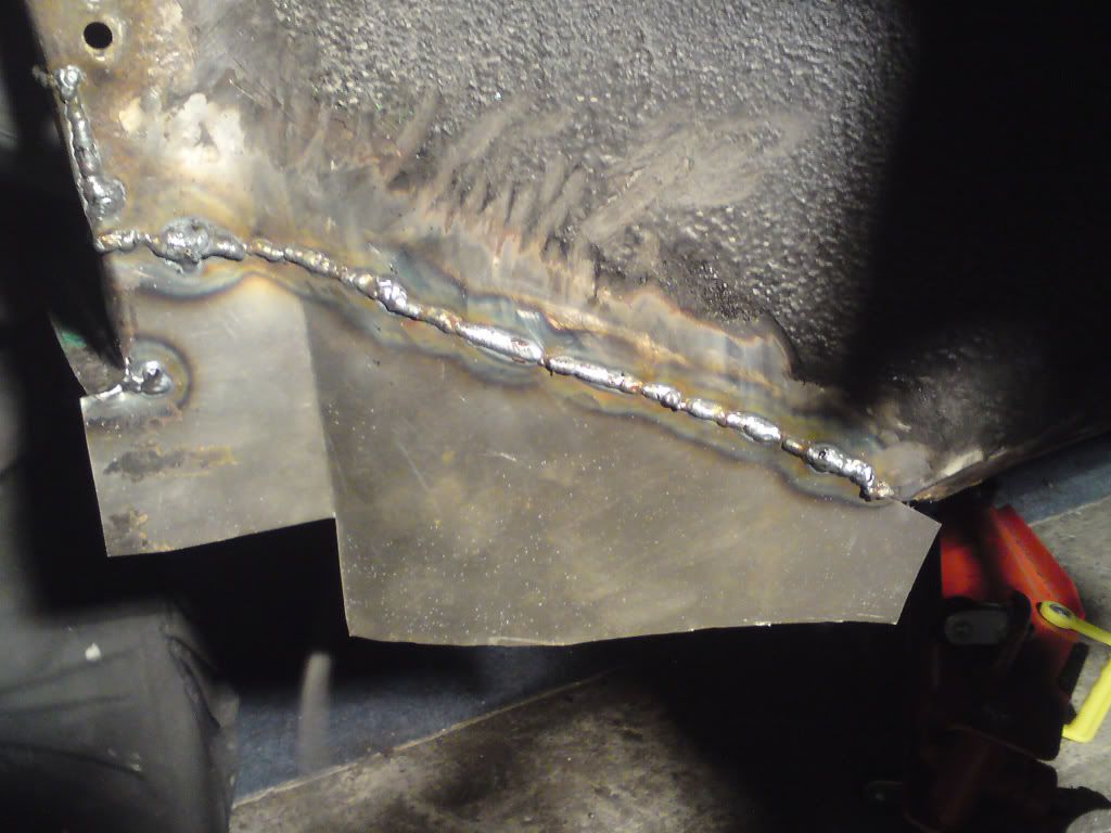

an update of tonights progress with the welding :xmas: we got the inner wings solid, both scuttle repairs and underside scuttle panels welded in, a few patches on the flitch panel and the front rh floor welded in :xxx: il let the pictures speak now :thumbsup:

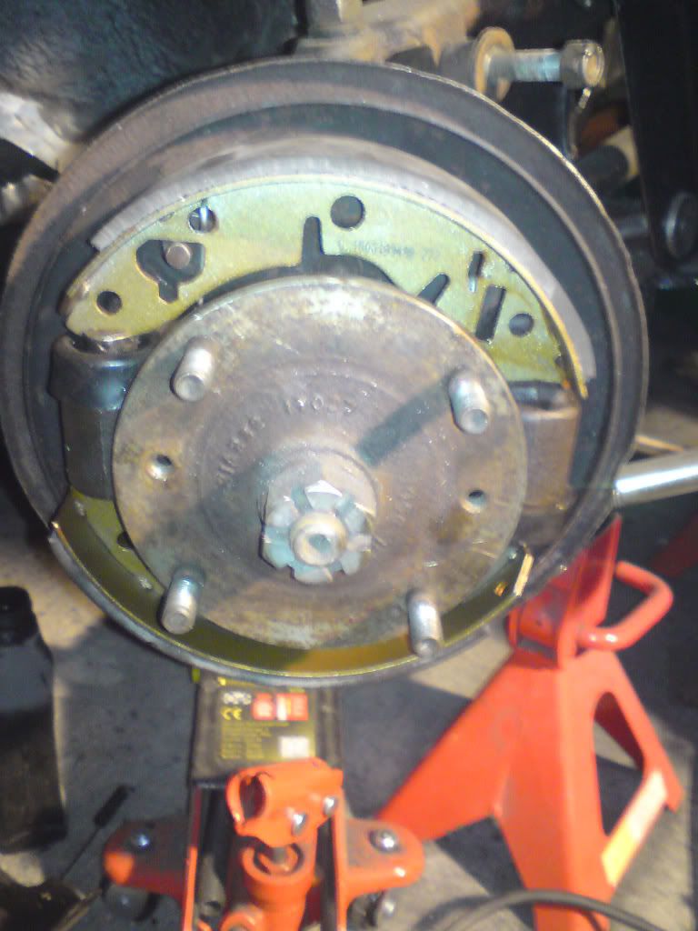

i unsiezed and refurbed the front right drum brake, what a ******* of a job lol
the welding photos:
a few of the welds really arent pretty because some metal was thinner in places than others and kept blowing holes especially you can see on the inner wing, just need to grind them all down and they will look alot better ^_^
and do the floors need to be fully seam welded on the inside, we just did intermitant welding because its on the inside lol :ermm:
all comments welcome, Adam :)

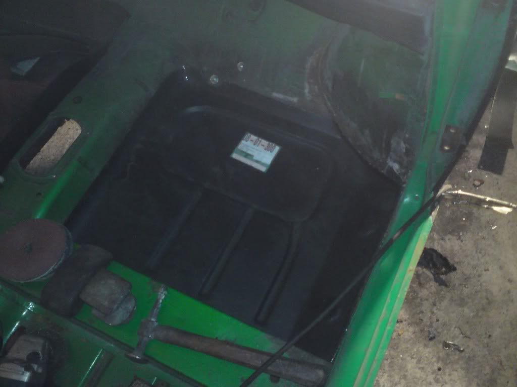

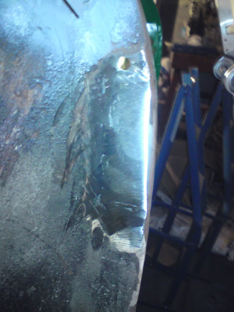

got the left side floor cut out and the new one welded in and a couple of patches to the flitch panel ^_^
just need to grind back the welds and re-drill the hinge mount holes and that will be the front end solid (minus wings, a-panels and front panel obviously) next week is getting the areas on the back and boot area solid and then it can be turned on its side so everything can be seam welded and the patch made for the outer sill and patches to the boot :(

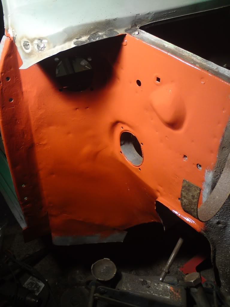

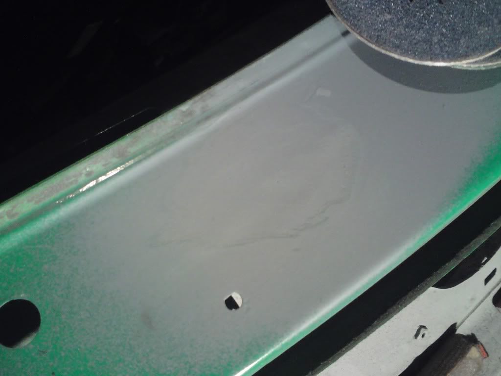

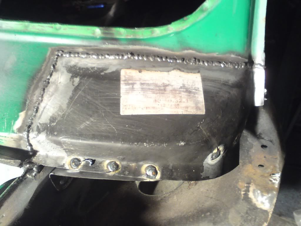

a small update, not got as much done as i would have liked due to tech assignments :withstupid: but ive got the rear quarter repair panel welded in and the rh side flitch panel to back to bare metal, etched and then red oxided
the magnum panel fitted quite well but im finding they use crap primer compared to hadrian panels
painted:

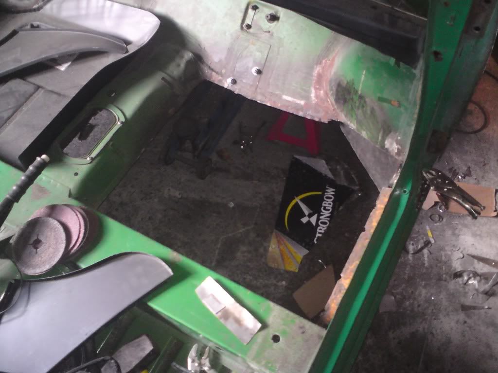

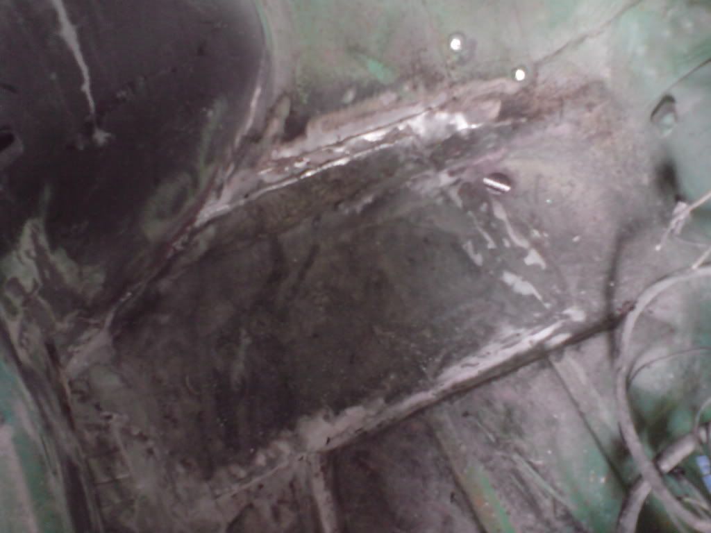

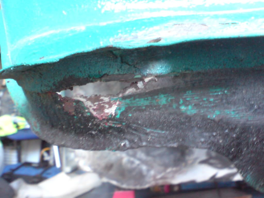

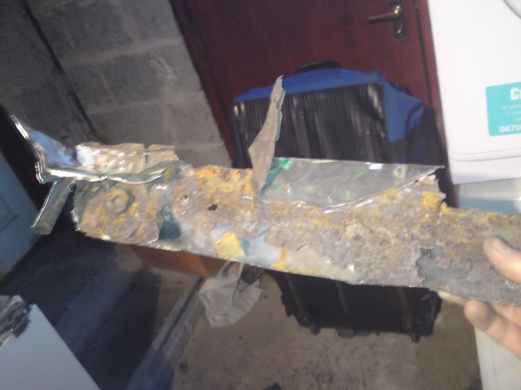

hi, not really an update just took a picture of the remnants of the front left sill when we found the dodgy repair and did a job i had been meaning to do since i first got the car, i took the seat covers off to see how bad the seats really where, il let the pics speak for themselves on that one

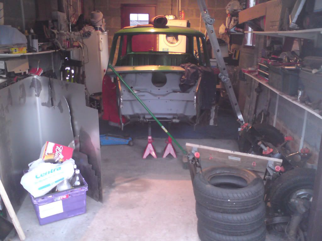

after long last i had the inspiration to clean the garage for thursday
its alot cleaner than it looks in that picture but its clean enough to be able to do what we want on thursday >_<
