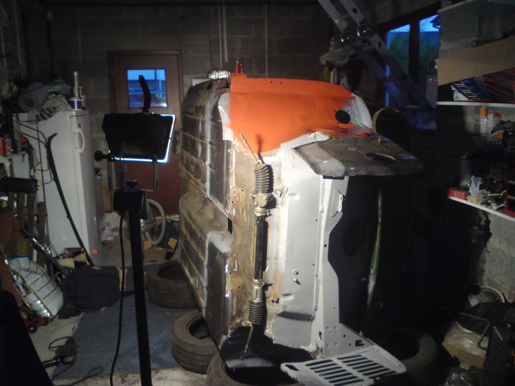

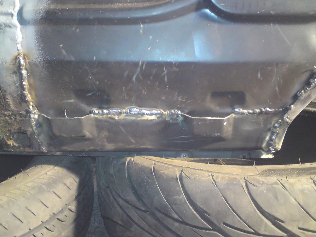

heres a wee update of tonights work :

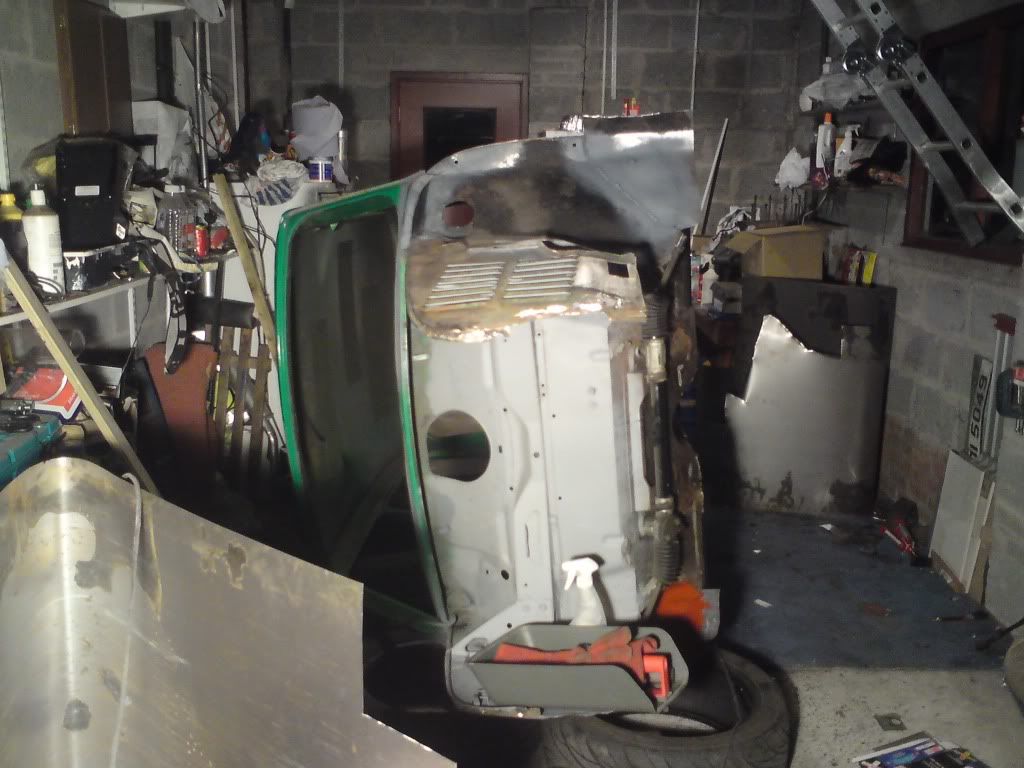

tee brought some big assed tyres from his work and wee flipped the mini on its side :xxx:
then started seam sealing the floors
my welding
tee's welding
quite a difference in the proffesionals welding and mine :lol:

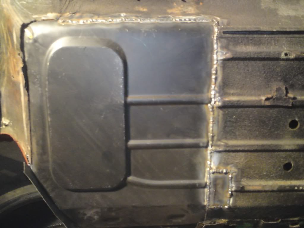

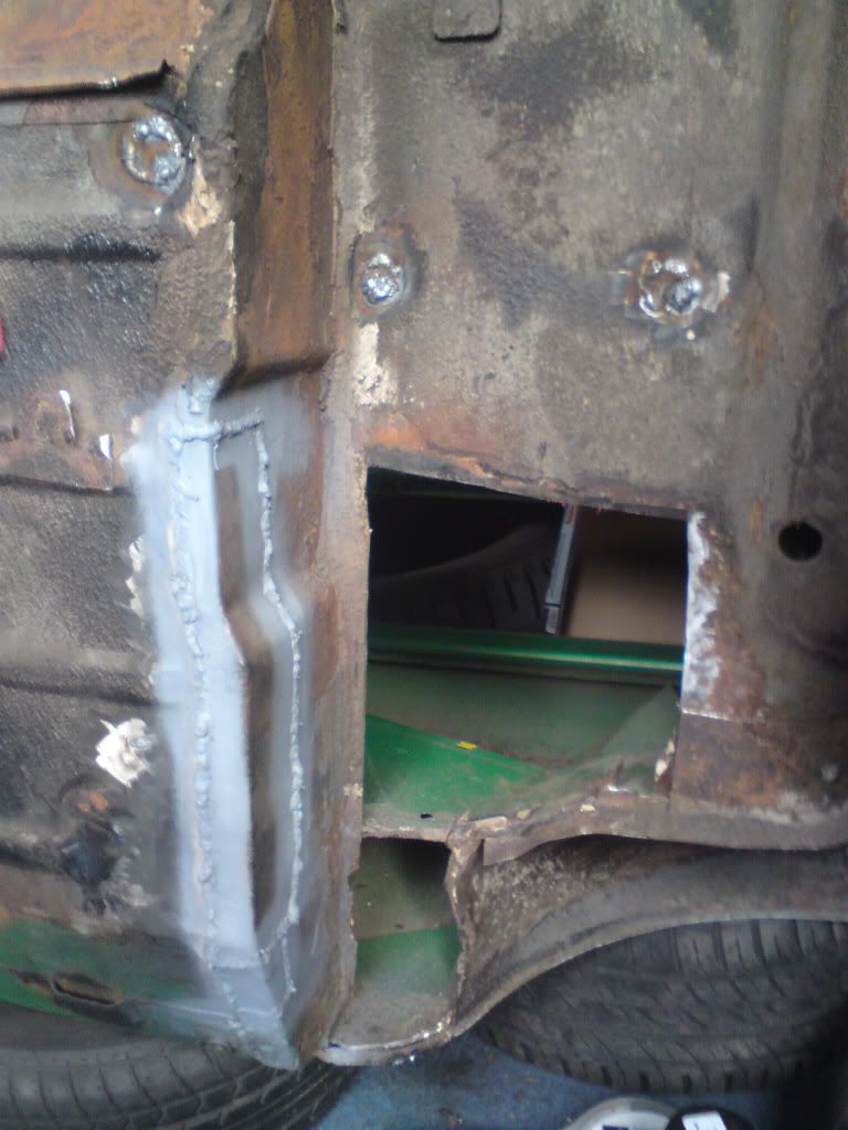

repairs to the rear floor pan

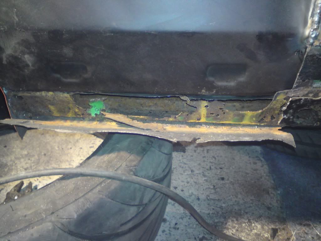

got a couple of pics of the front right sill and the left hand side that ive partially cut out now
whoever last did the repairs on the sills needs beaten round the head several times, not even welded on in many places and i could basically just tear it off and they didnt even remove the old sill ffs, aww well im probably just goin to buy one sill and use it to repair both sides :cry:

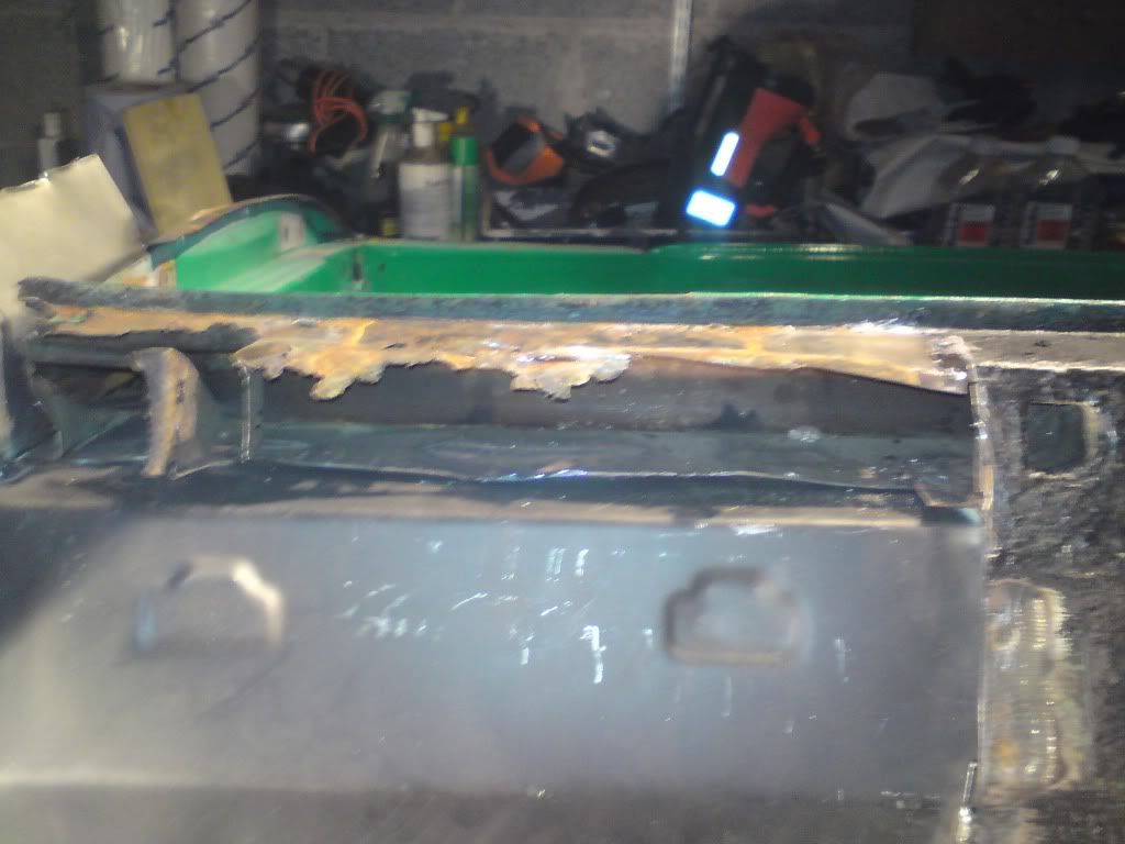

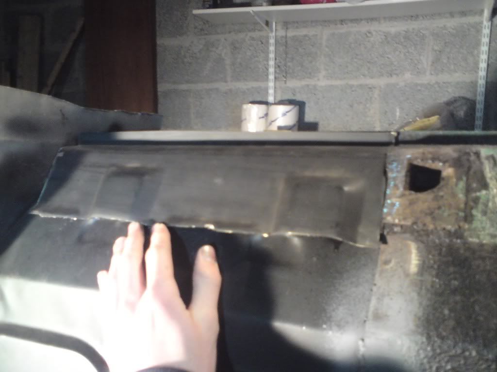

a little bit of an update, tee has left his welder over since he is away helping set up a show for a couple of weeks so ive tried to get a bit done but not as much as i would have liked, ive got the rear seat bit repaired as the was a small hole and all the surrounding metal had alot of surface rust and was a bit too thin so it was all cut out and i spent a couple of hours attempting 3 patches until i was happy with the last one :(
then cut out a couple of sections of the floor as they were just rotten and started to patch them

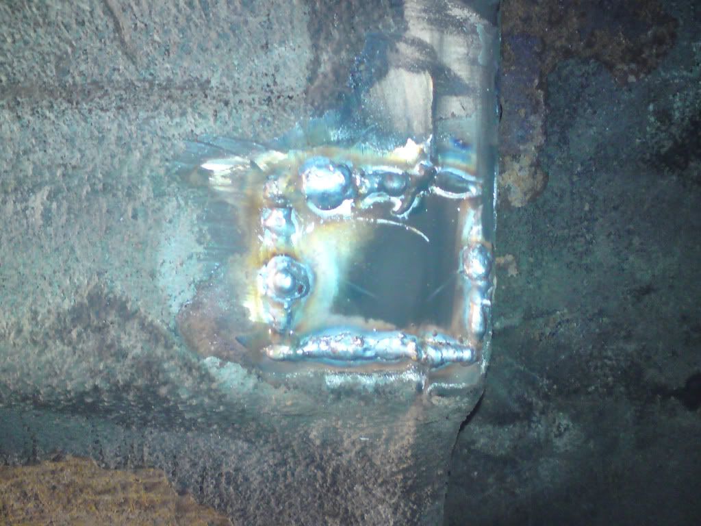

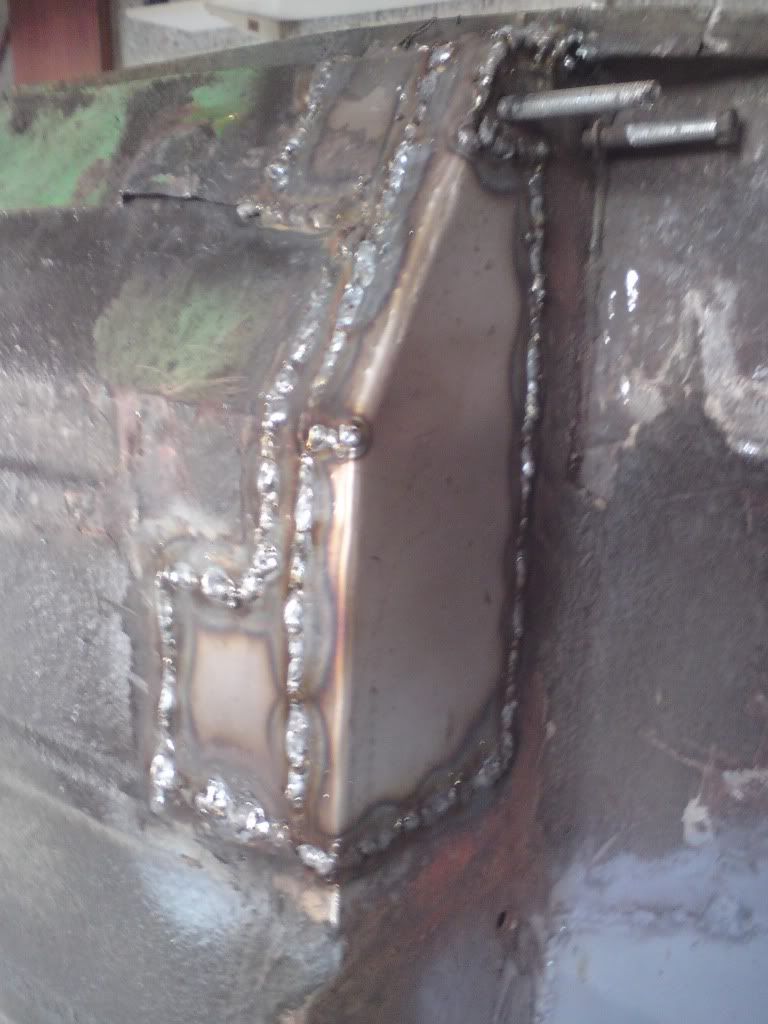

a bit of an update of what ive got done over the last couple of days:

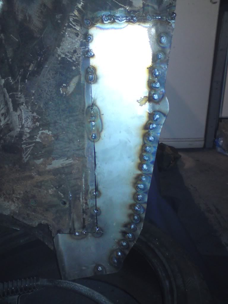

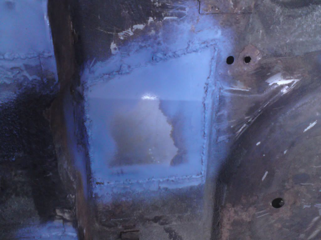

finished patching the floor to heel board area and that patch was a bit of a pain, had to weld it before it was even on the car so i could keep everything looking original underneath even though no one will see it really :xxx:
the next patch took 5 little patches to keep it looking original and proper and i had to cut out a previous patch to do it properly
started this patch on the boot floor, got it plug welded on and tacked on
the i ran out of gas so thats me bugered till tuesday cus of work and bank holidays when my dad can go get the bottle re-filled while im at tech :)

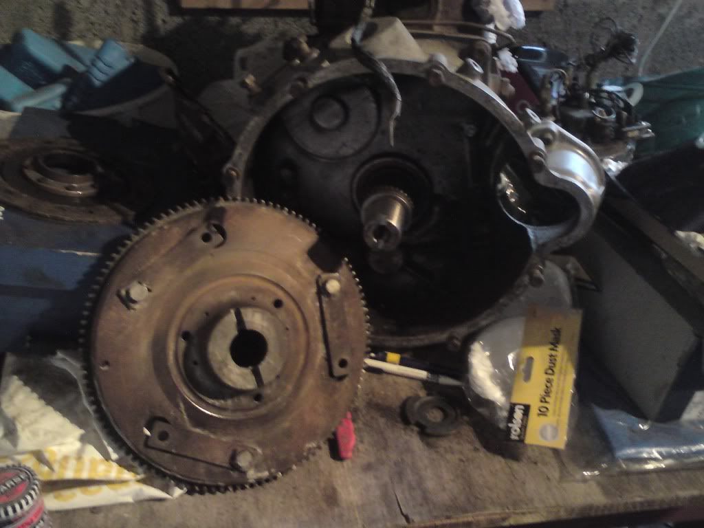

not really got alot done cus ive been stuck in bed since tuesday when something hit me hard, wednesday the local company thats was getting in my flywheel puller foned me and i was feeling a bit better so cycled down and that wasnt a good idea but got the flywheel off later that day :) it only took 2seconds to do surprisingly, it just popped off and im glad im replacing the clutch on it :P

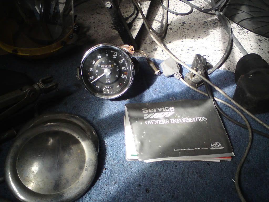

went last night to try get some parts off a few scrap minis a mate has, didnt have that long but managed to get a mph speedo, front wiring loom and a few other small bits, wiring loom and speedo wer a pain to do but also found and original scissor jack :) not sure if its from a mini but still and i also got an original owners service manual which i was quite surprised at :P

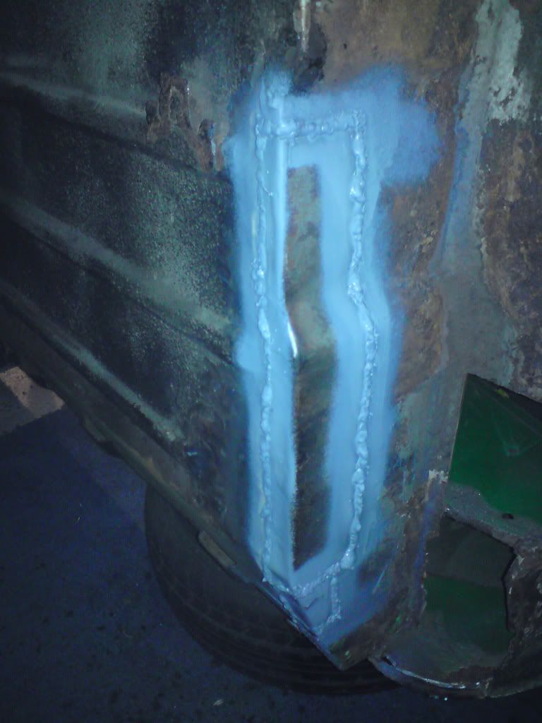

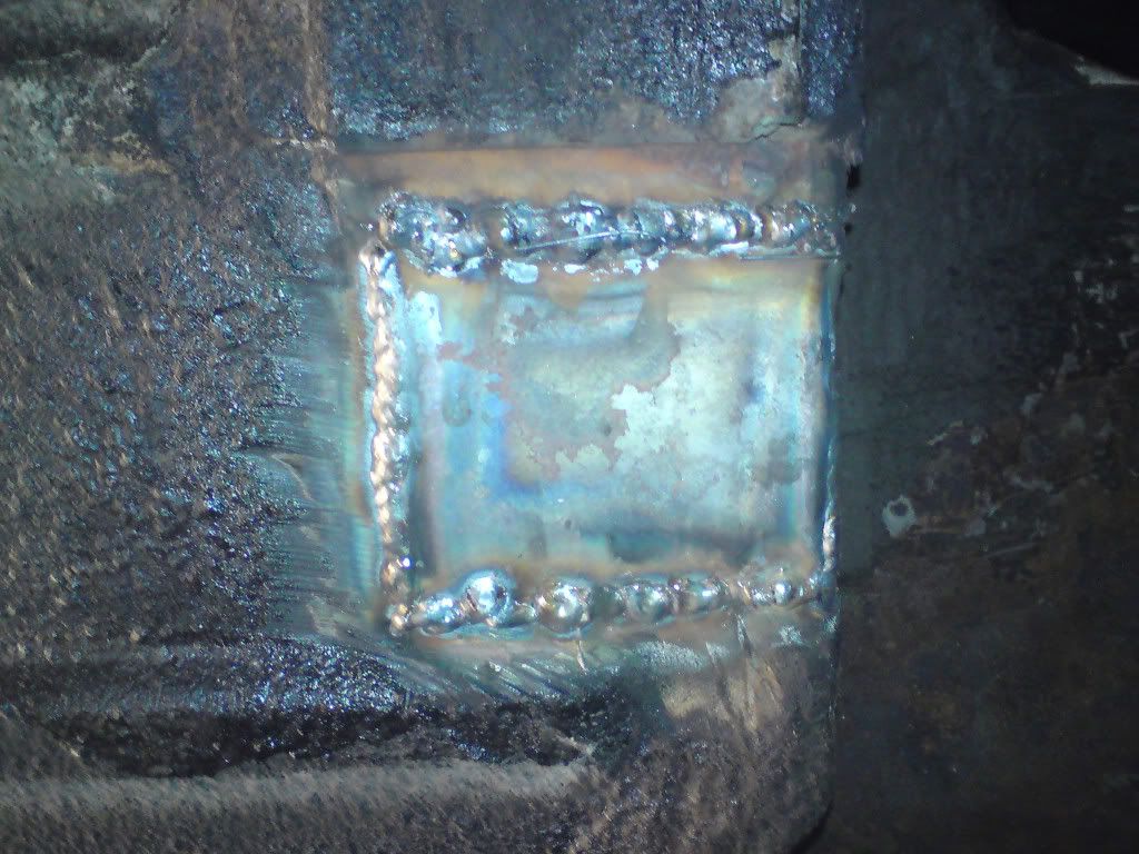

made this hole alot bigger cus it started a little small patch and then i wasnt happy with the metal around it so i cut the rest out ;)
finished welding in this patch

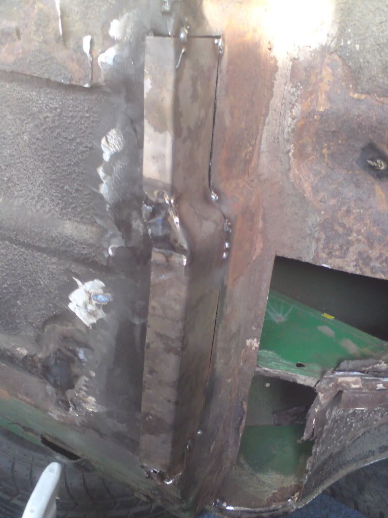

did 2 patches here on the wheel arch and on the boot floor, unfortunately due to me being very stupid at the time i cut off the bracket that the petrol tank screws onto ;) just gona have to be careful and weld in on again :)
i then started cutting an oversill i had been given into a proper sill and mocked it up abit :)
still needs some cut off so it will line up with the original :)

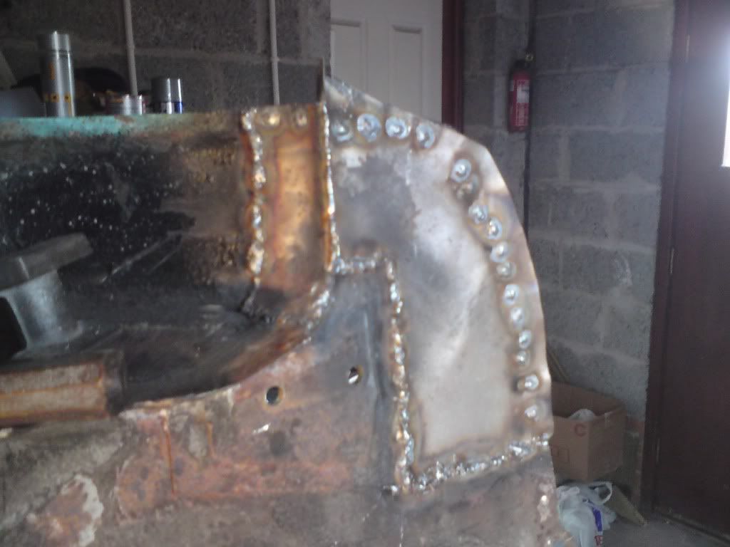

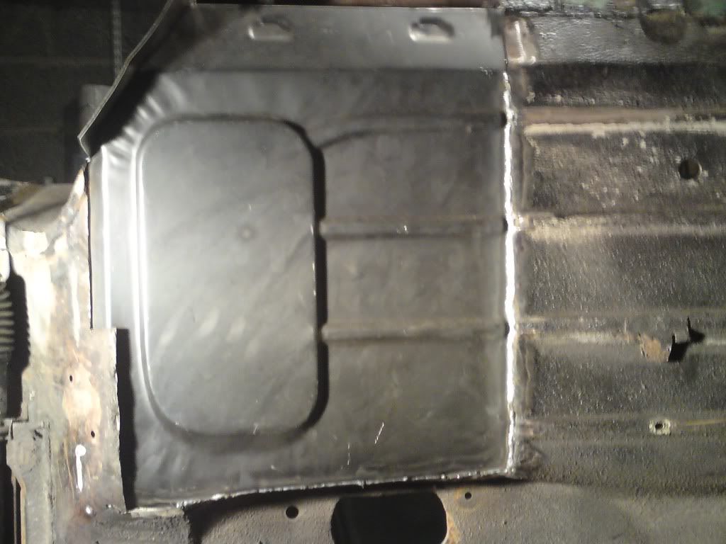

got a pretty big patch done in the wheel arch/heelboard area that was a pain to make and get right but its all welded in with only a few small fires :mrcool:
welded on the sill repair patch and cut it down to the proper size :)
