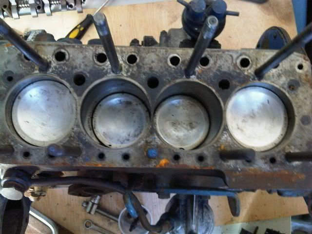

Hey i have just bought this off someone on ebay claiming that the engine is a 1380cc metro engine. I have stripped the head off and have come to the pistons.
are they bored out?

What size is the bore of this block.... ?
Er roller tips ?? you have to be kidding, they are standard sintered off any later Mini from the early 80's onwards worth about £2.50 at a push
The gap between no 2 & 3 pistons looks really tight :D can you measure it ?
Also a1380 running off the standard mechanical pump woul dnot be a very good 1380 :thumbsup: just can't supply enough fuel.

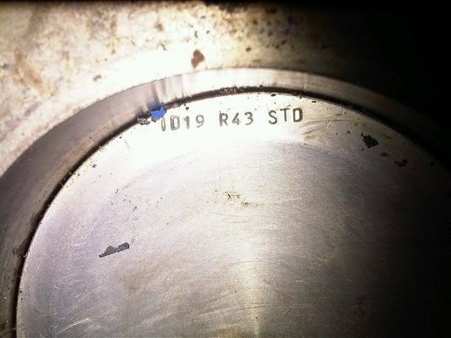

Wouldn't the "STD" on the piston top mean standrad bore ( 1275 )

As above, measure the bore diameter. If its 73.5mm then yes its a 1380. As Martin says the gap between bores 2 and 3 does look tight so it may well be. Also why the pic of the standard rockers? Did you post the wrong IMG code?

As Martin says, the wall thickness remaining between cylinders 2 & 3 looks very thin. It may be that it's been bored out to 1380 without the bore centres being offset to cater for the much larger bores. In which case you could have head gasket issues and the block can never be bored any further should it need to be later on.

Is it just the pic, or does the gap between 1 and 2 look way smaller than between 3 and 4?

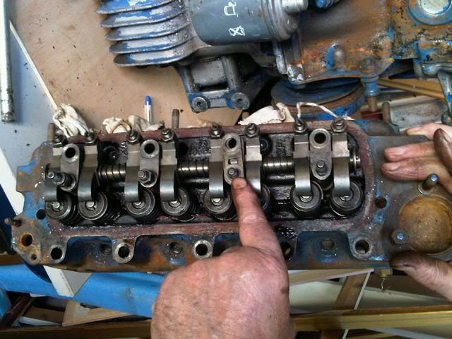

yeah i think i did, here are some pics of the roller tips,

it is 1275cc block and i cant measure it till tomorrow, but will measure and see if its 73.5mm
and yeah they do look tight.
What I was thinking

i think it may be the pic but you do have a point with it being smaller.
ill get some better ones tomorrow
Those are not roller tips, they are standard late A-series rockers.

Indeed! Roller tip rockers have....ER...rollers at the tips that press onto the valve stem.
cool, was going to purchase some Mini Billet 1.5:1 rocker tips but havent gotten them yet.

Also going from the alternator bracket in the first pick, its an early a series engine. Plus that’s also a early 1275 head with later a+ rockers.
My guess is its an a series, standard 1275, not a metro 1275 with no special extras.
