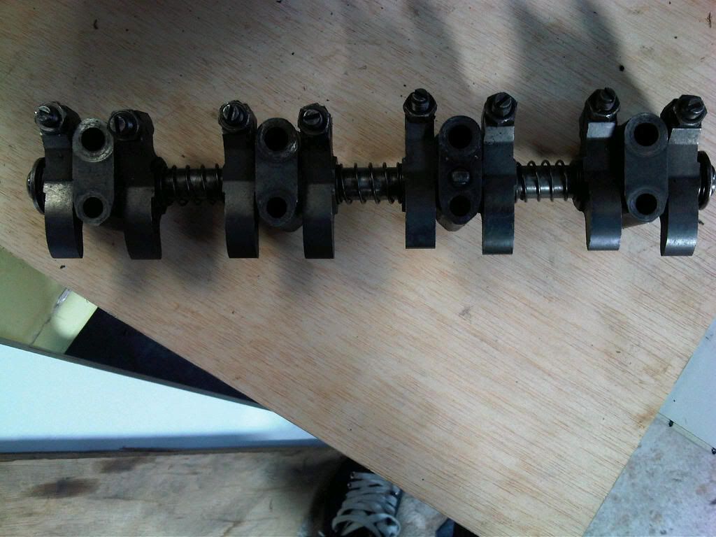

Also going from the alternator bracket in the first pick, its an early a series engine. Plus that’s also a early 1275 head with later a+ rockers.
My guess is its an a series, standard 1275, not a metro 1275 with no special extras.
is it just a standard 1275 and not a metro, im new to engine building so thanks for your input
Well I’ve always thought of the A+ engines being the metro ones, being as that’s about the same time the metro was introduced.
The sintered type rockers were also on late A series. ( at least the ones that were sent over to CA )

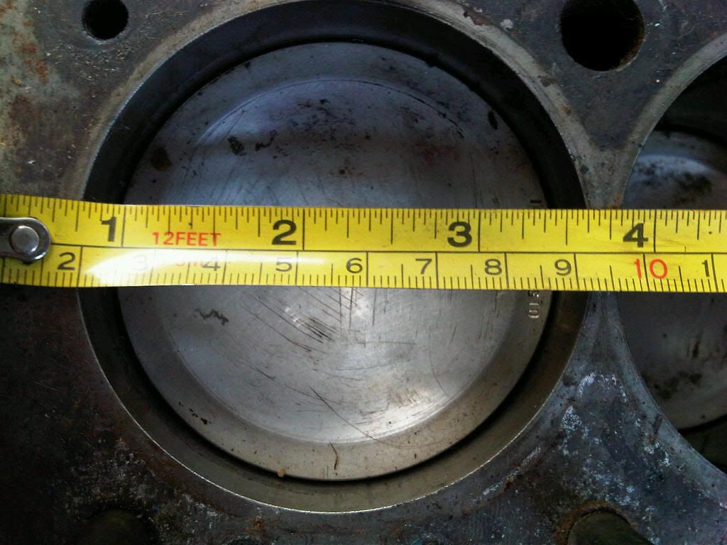

I'm still thinking that the block pictures is a standard bore. How could a 1380 have "STD" pistons?

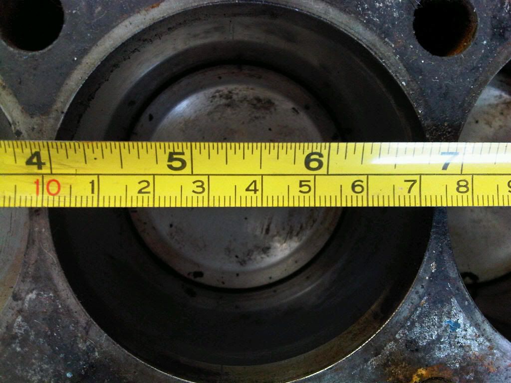

The AE 20659's which you use for 1380's have STD stamped on them aswell so don't dismiss it for being a STD bore size. I would say by the looks of those pistons they are an old set, most likely Hepolite ones. The bore does look rather close to 2 and 3 so it may well be bored to 1380 you just need to measure.

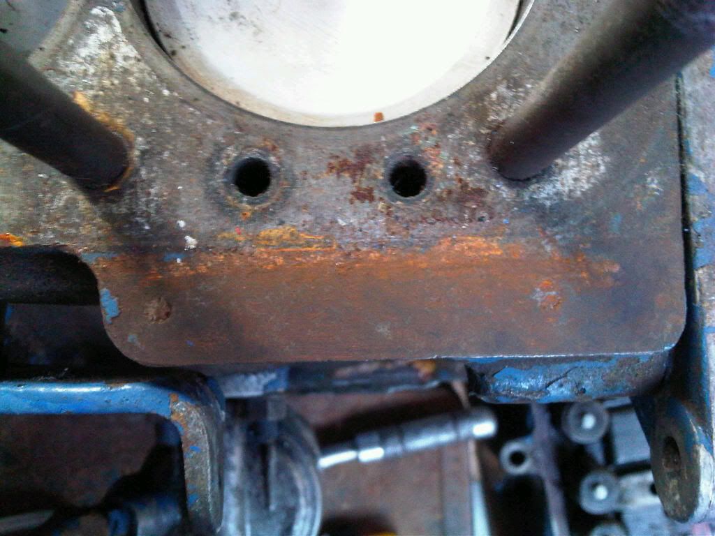

anything stamped into the block where the engine number used to be? this would help id the builder.

It is an Aseries block, with an A series head...... the rockers are sintered....... The pistons can quite easily be form another vehicle as well, triumph 2000 or 2500 pistons being that much bigger, however they would also have standard stamped on them as well as the 73.5 AE pistons.
no there is nothing stamped... it looks like it has been filed out..

i measured it earlier today and it is a bored out 73.5mm piston but it has standard pistons in them it looks like.

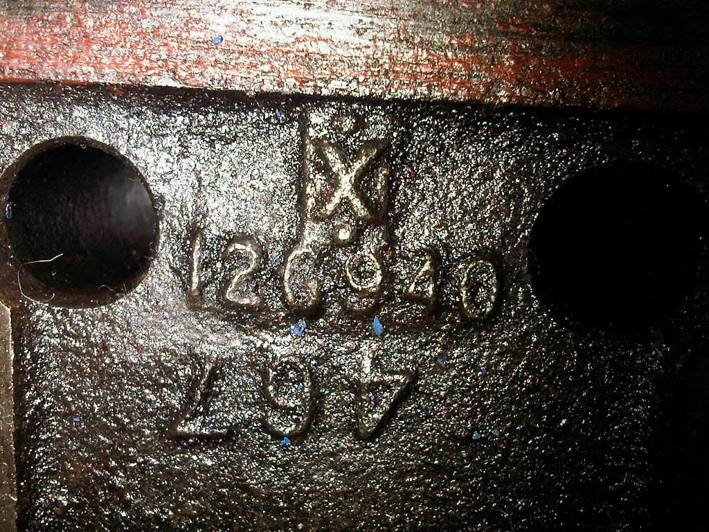

the head looks like it has had better days and is stamped
12G940

here is a pic of the head

All looks good! Big valve head on a 1380. NICE!! Should get the chambers measured and see if it will take a slight skim.
Edit: Cant really tell because of the carbon, but it looks like those chambers have been smoothed . You may well have a very nice head there.
