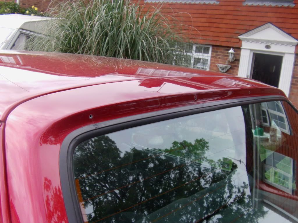

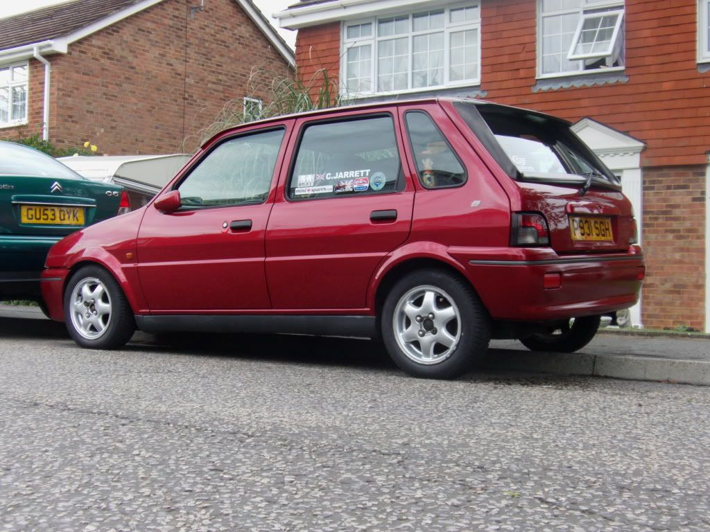

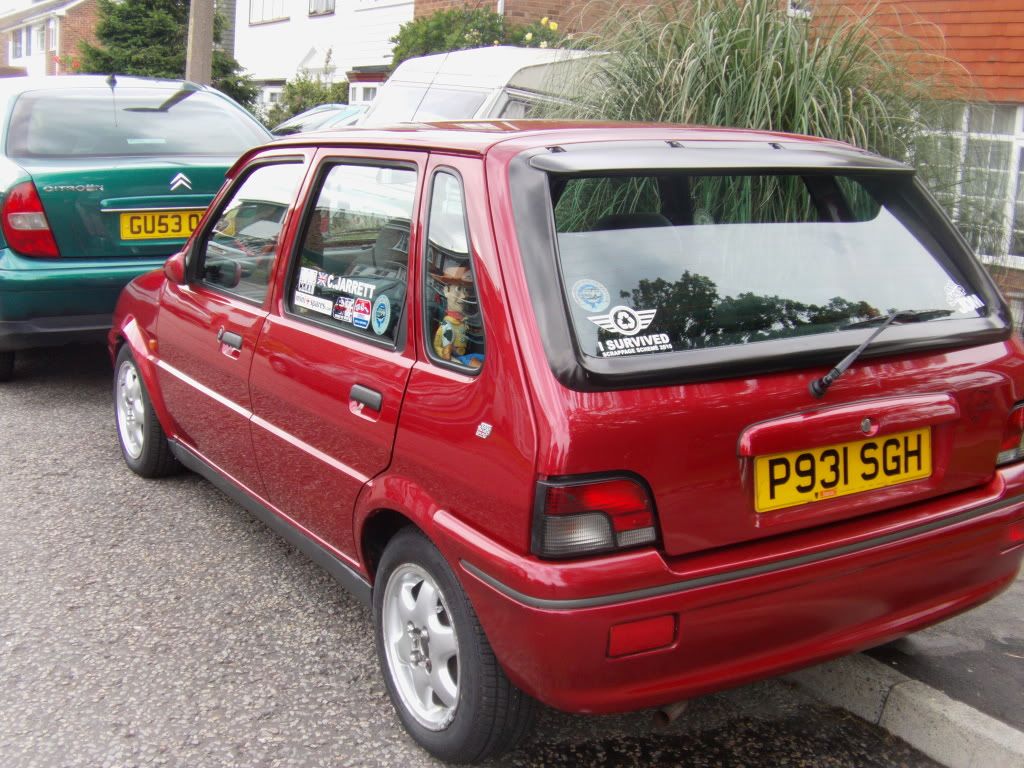

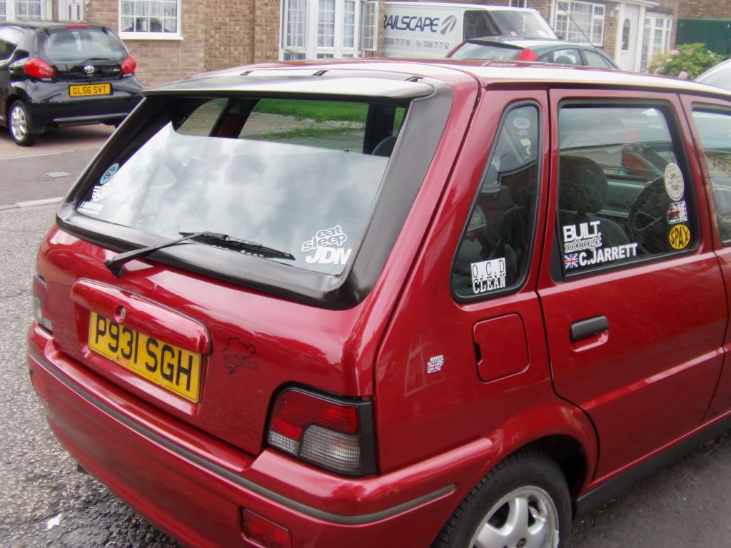

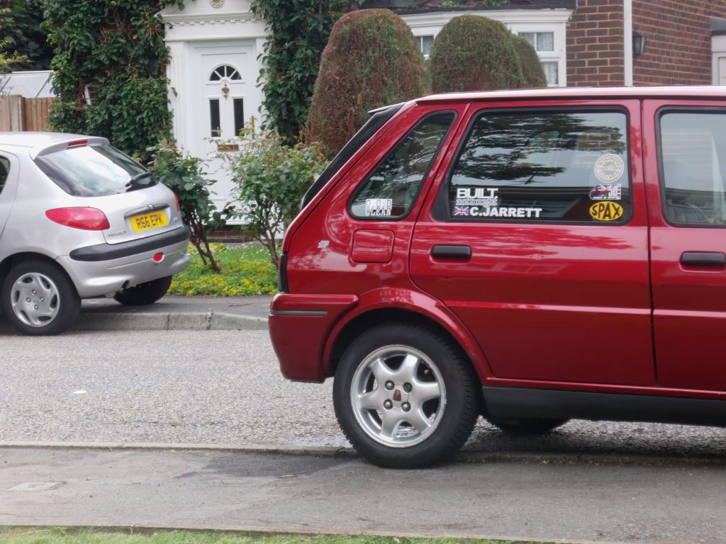

So with the spoiler ready to go on and sitting in the car redundant, the sun made a short appearence this morning and that was enough for me to decide to fit it today.
First step was to give it a quick clean and looking nice, done. :P
With it mocked on the car I drilled the 4 holes at the top that hold the spoiler in with self tappers.
With those holes drilled I masked up the bottom of the window with tape and then fitted the spoiler. Underneath, there is 2 screws which locate the spoiler to the bottom of the window. In the factory on the GTi's and GTa's they would drill the hole on the outerside, and then a bigger hole on the inside of the boot with a securing nut on the other side to hold it tight. I opted not to do this and to do drill a 3mm hole either side, and with a needle file just file enough for the spoiler to need to be 'pushed' into position with some force on the bolts. The hole would need to be drilled very very close to the window on the inside, and I assume in the factory it'd obviously be done before the window was fitted, before paint had even been applied in fact. I didnt trust myself with a drill 4mm from the window.
With all of the holes made, I gave the car a quick wash down with a watering can because I dont want to be re-arranging bits of metal all over my clearcoat next time I wash it.
#266 Mini-Mad-Craig
Posted 25 July 2011 - 04:16 PM
So pending Silicone adhesive and spoiler caps, here is the finished product, thus far.

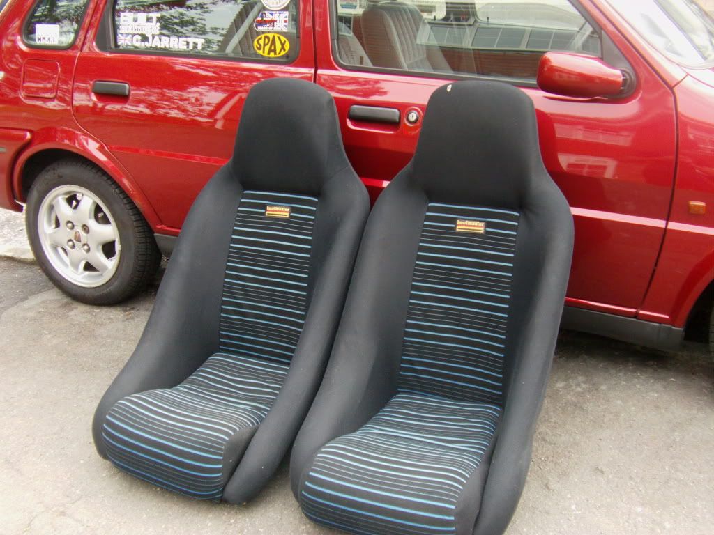

And my new seats, Huntmaster from the 80's. Never seen another set like them.
