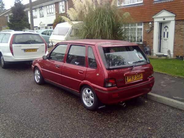

Suspension! :) The front and rear Hydragas units are linked so that when you let the gas out you end up with a huge nosedive. In order to run suppper low and stiffen up the ride a LOT you individualize the hydragas cans so that each can is independent rather than fluid traveling from front to back :)

I thought your photoshop pics were just that, just for show, I didn't realise you was gonna actually lower it.....
Interesting
#649 Mini-Mad-Craig
Posted 28 October 2011 - 10:39 PM
It'd sagged a LOT anyway so it needed a pump up. The front has been raised half an inch from how it used to be and the rear has been brought down a LOT to sit level. Its a much better stance, makes the car look a lot smaller (not unlike a Mini... :P)

This is the best best guide to Hydragas really. It's a great system because its SO smooth if you have it at the height Rover intended. If you let the fluid out you get a sloppy can that rolls all over the road... now let the fluid out AND individualize and you end up with a super stiff car that holds the road very well. http://www.mgf.ultim...on/hydragas.htm
The picture makes it look higher than it is but this is as low as I can go until I get the 14's on. The rears are prone to rubbing on 14's. I'll probably end up getting the arches rolled to accommodate the extra width.

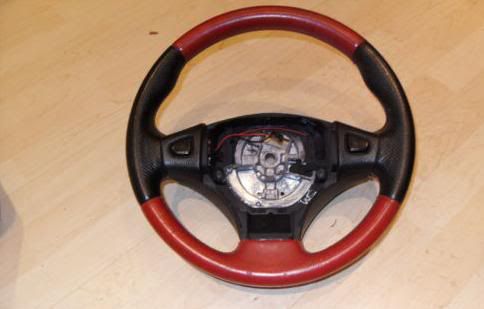

Currently winning this on the bay too.

Is that an MPi wheel or off another MGRover? It has the droopy bit like an mpi. Either way it's nice :D

I've been looking for a BRM wheel but can't find one. :( This is from an MGTF but the wheels are exactly the same as MPi Mini wheels :)

Yeah it does look the same as an MPi, some of the ones I've looked at from Fs are more droopy across that bit where the horn buttons are, maybe the TF is different again and the same as the mini. My car would like a new wheel too :D

That will look proper good with the red.
