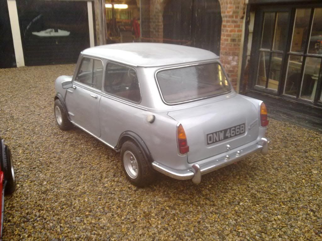

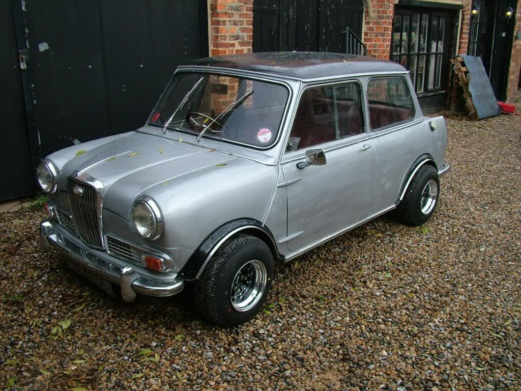

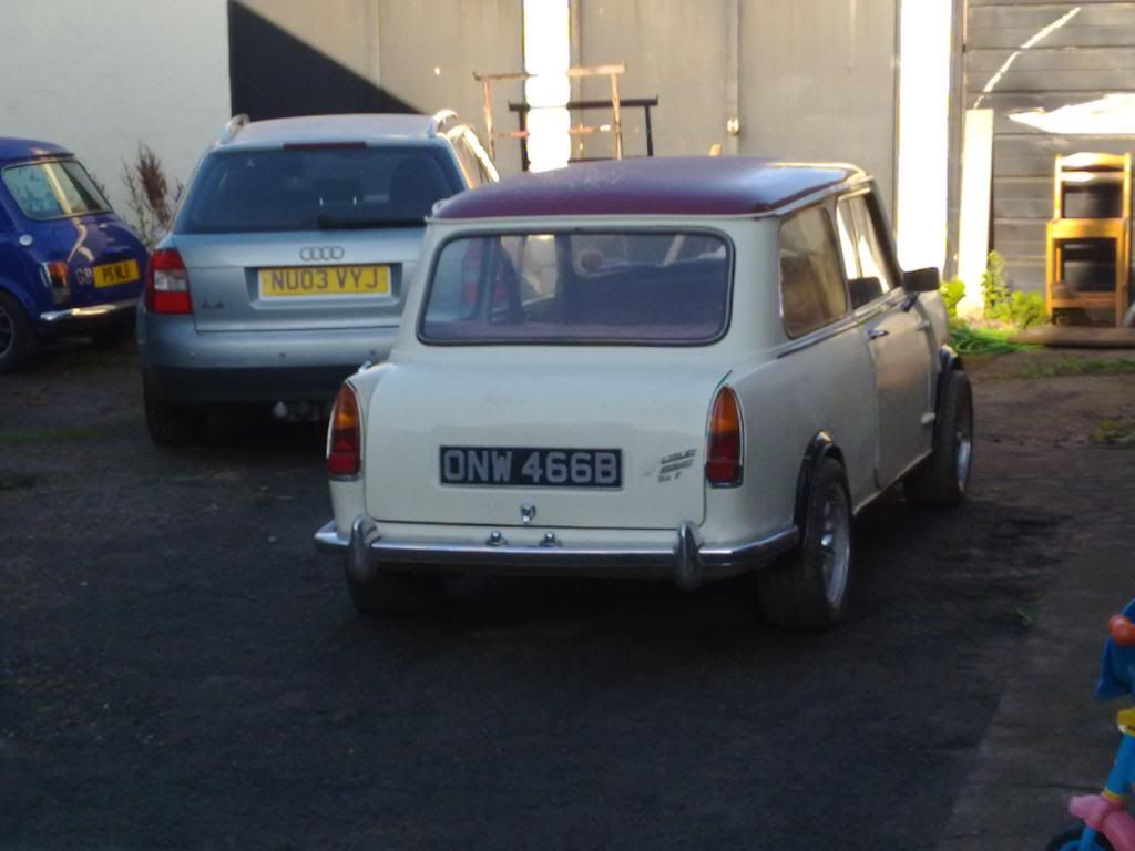

Well got this car a couple of years ago and patched it up to get it through the mot, I have also got a MK1 project that is getting rebuilt so this is one that is just patched up each year to keep it on the road.
Heres some pics of its facelifts over the past few years.
If your a purist look away now!!!!!

More pics

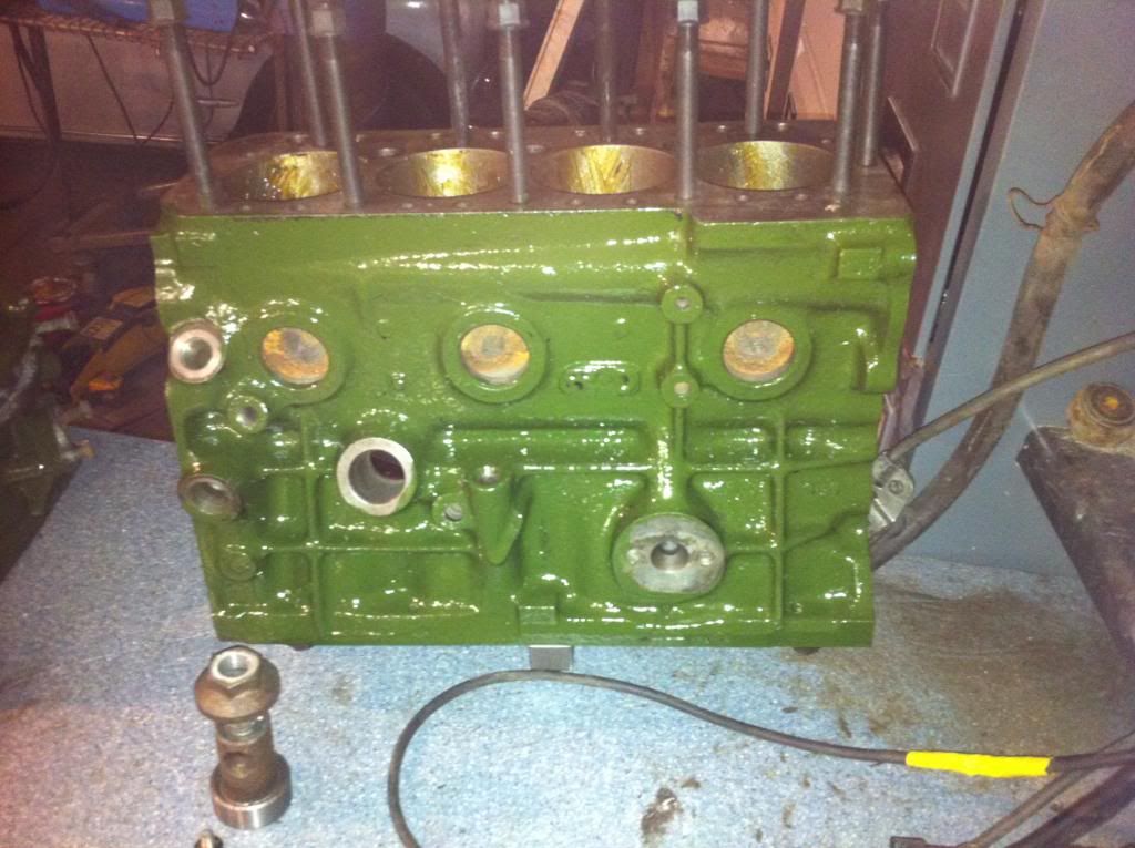

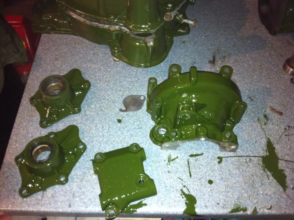

Well got a bit more done started painting engine bits, nearly ready to start and build.
Decided on green but am worried this may of cost me about 10BHP with it not being red?

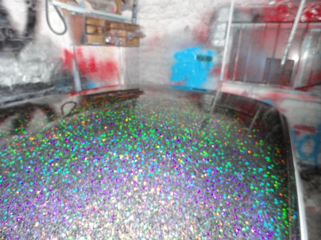

Posted 04 July 2011 - 04:50 PM
Looks good love the metalflake roof

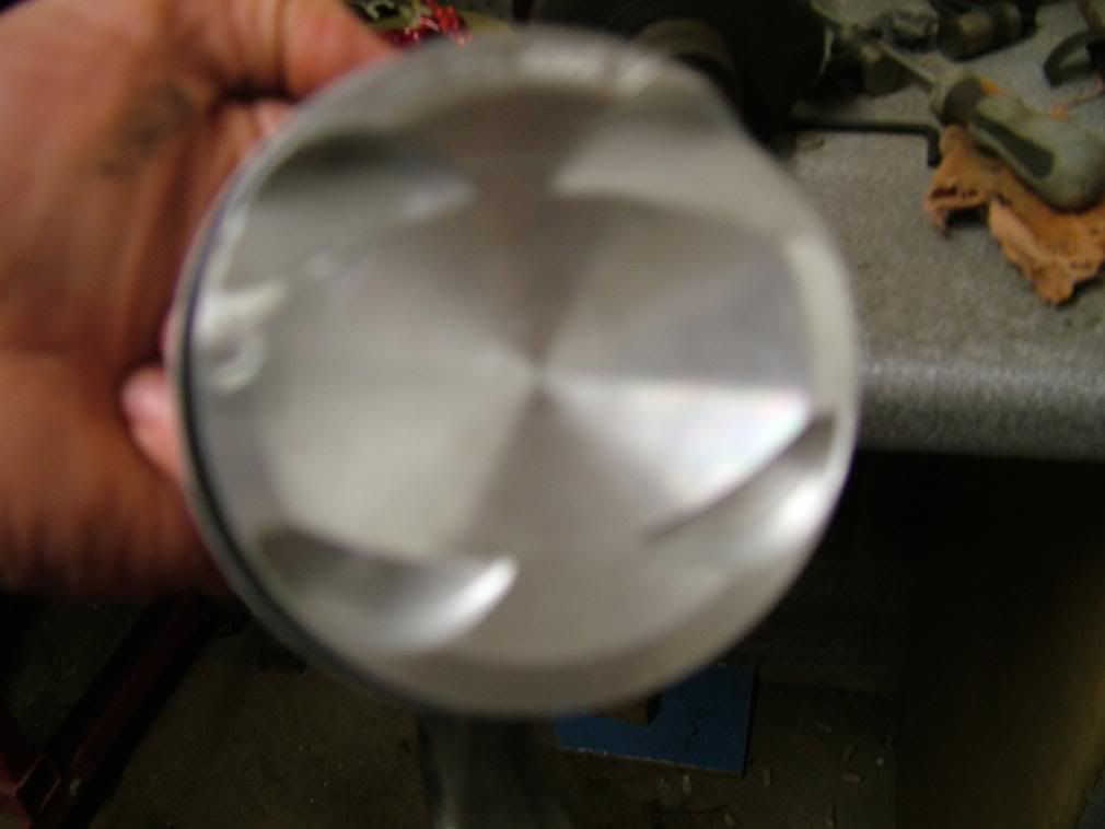

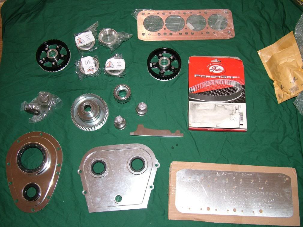

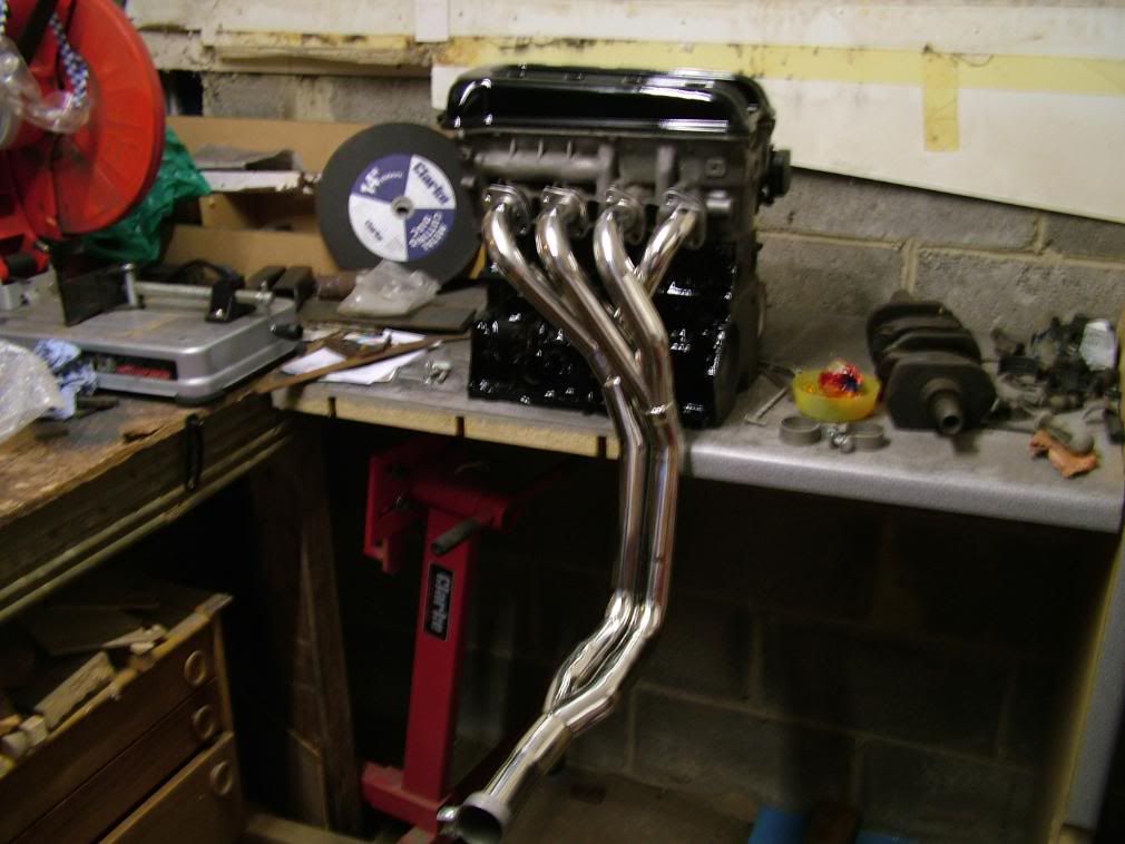

Well theres been a slight change of plan, I have decided to keep the green engine for the mk1 as it will be more inkeeping with style, so the wolsely will have to keep its 998 in for a little longer while I save up for some more bits.
Bits so far for the wolseleys new engine
Block bored to 73.5 mm to give 1380cc
centre main fitted
block converted to accept 16v head
pockets machined in pistons to stop them coliding with valves
Stainless exhaust
standard head
conversion kit
Time to start saving pennys again

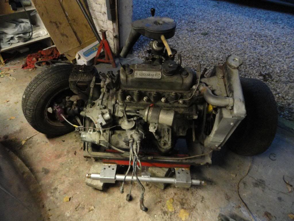

MK1leg yes it is a bmw head this was the engine planned for the wolseley but going to put it in the mk1 now and put the 7 port in the wolseley as they are both ready to go and iam impatient lol.

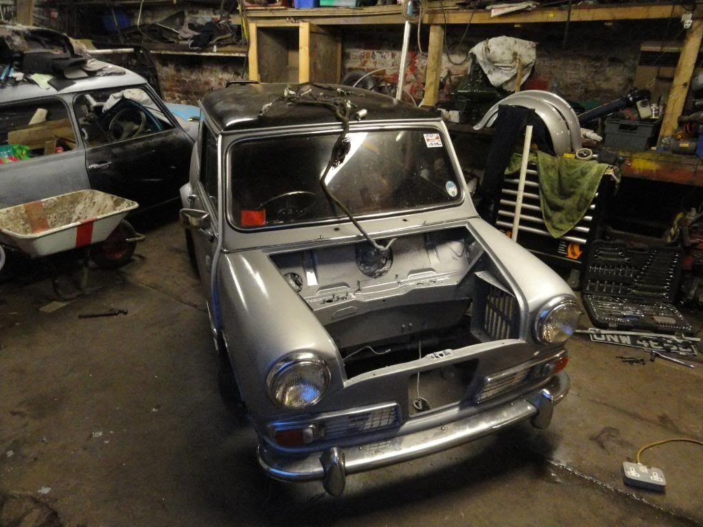

so wolseley engine has been pulled out and engine bay had a quick clean up and paint
