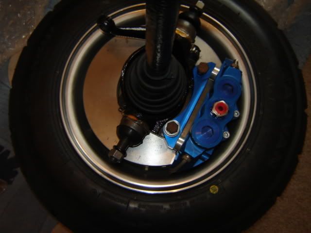

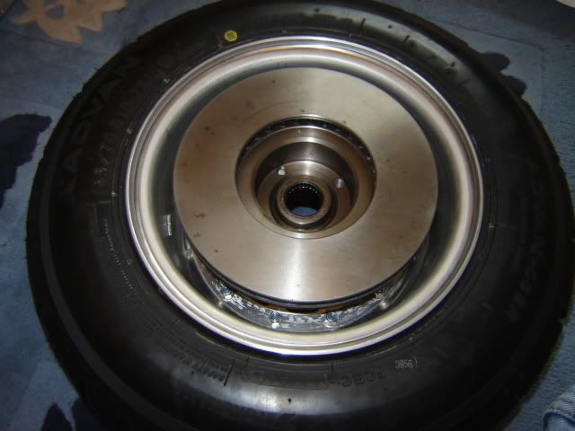

this week i am going to try and do a few bits of machining like modding my vented discs to fit and grooving them, taking some more metal from my hi los and finishing off my custom brace bars.

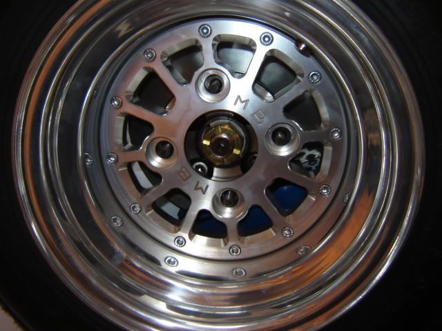

i have also decided that i am going to run my 6 pots with 8.4" discs under my MBs they fit with about 4mm clearance. they look absolutley mega aswell when you see how big the discs are.
#831
Posted 13 June 2007 - 05:42 PM
You may have already found this out, but with the Kad 6 pots, vented disks and mini drive flanges you need to turn approx 600 thou off of the face of the disc mounting bell(where it bolts to the drive flange)

I just remembered that my 6 pots are on METRO hubs, I dont think this makes a difference but I could be wrong.
I seem to remember that the 6 pots use cooper S caliper spacing which is different to an 8.4" mini?
Anyway I had to do it on mine as with the Mini drive flanges (not metro ones) the disk was way to far back against the hub.
If it helps your more than welcome to drop round and take a look/measure up.

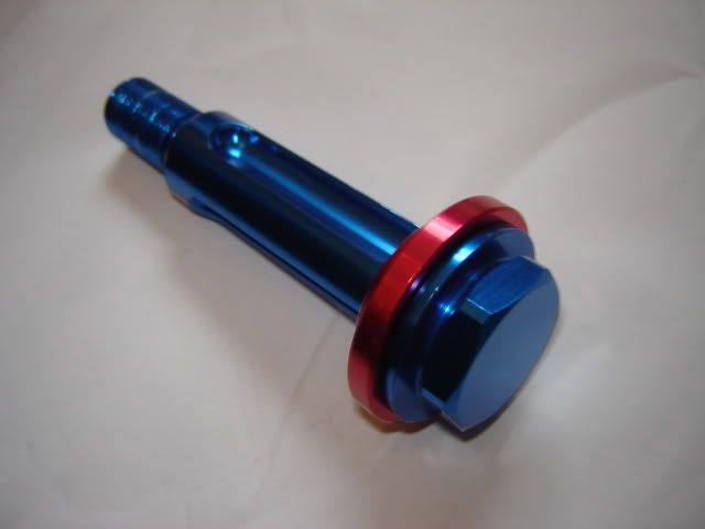

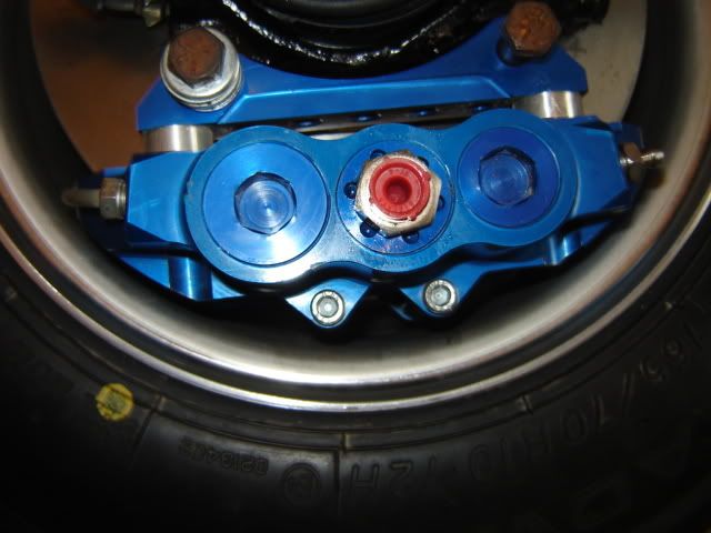

i have just been up and dug the parts out. i it is just the inside of the disc that needs machining and the steering arms, i cant see where the paint leaves marks!
im loving all my parts now the front subframe should all tie together nicely, the tower bolts match the callipers and also my hi los are going to be anodised blue!
see what you think

Those calipers look great in blue, mine are gold, I didn't know they did other colours....

rear brakes i have got mini fins and standard shoes, my thinking is that with such a light rear end i wont wont mch braking at the back, im also going to have a biased adjuster on the pedal box so i can fiddle it to suit on the track.
as for the discs taken from the mini performance manual
"the discs need to be machined internally to prevent fouling the dust seal on the hub upright. the thickness of the part of the disc which bolts to the drive flange should be 0.660in when modified."
